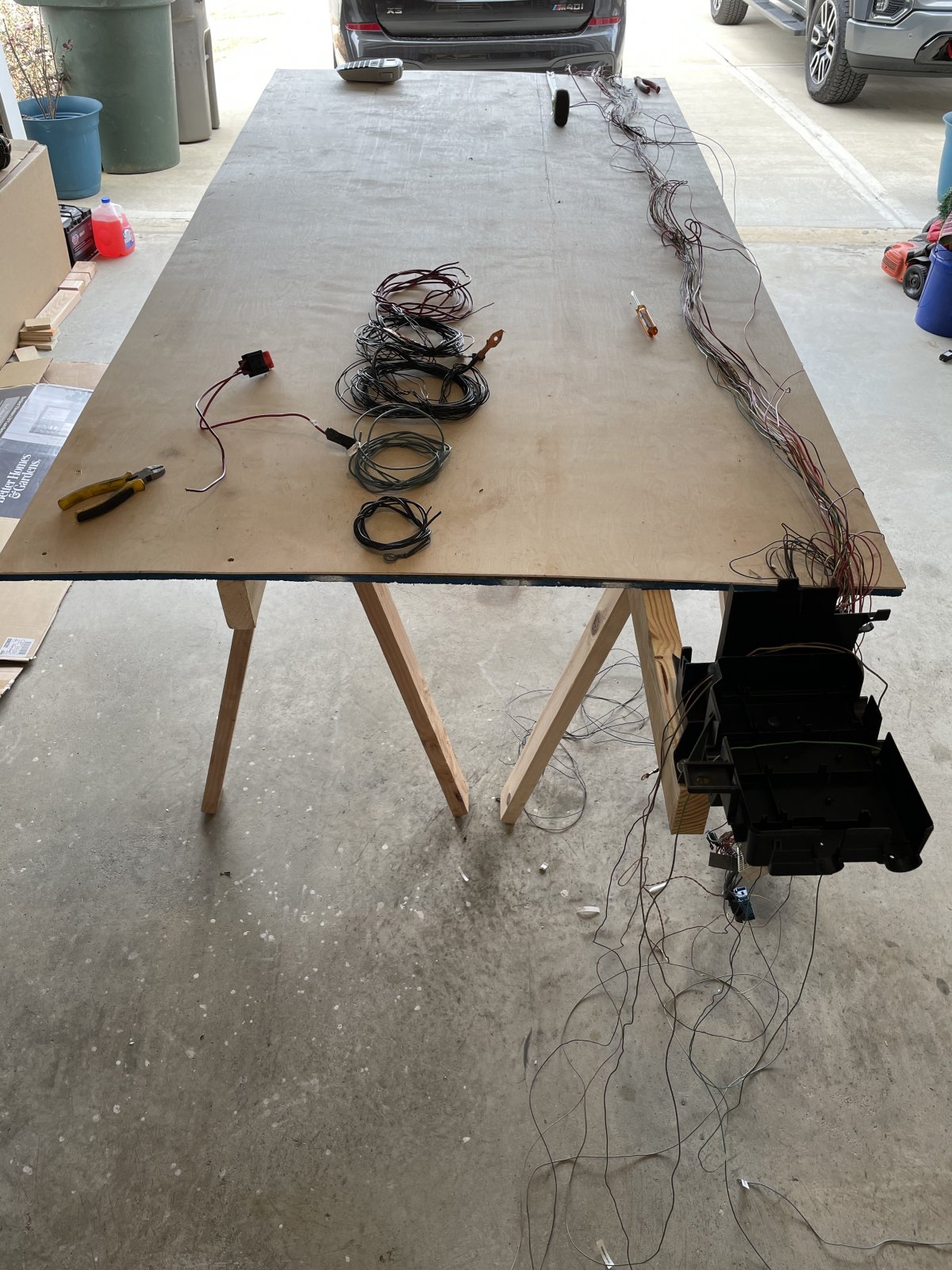

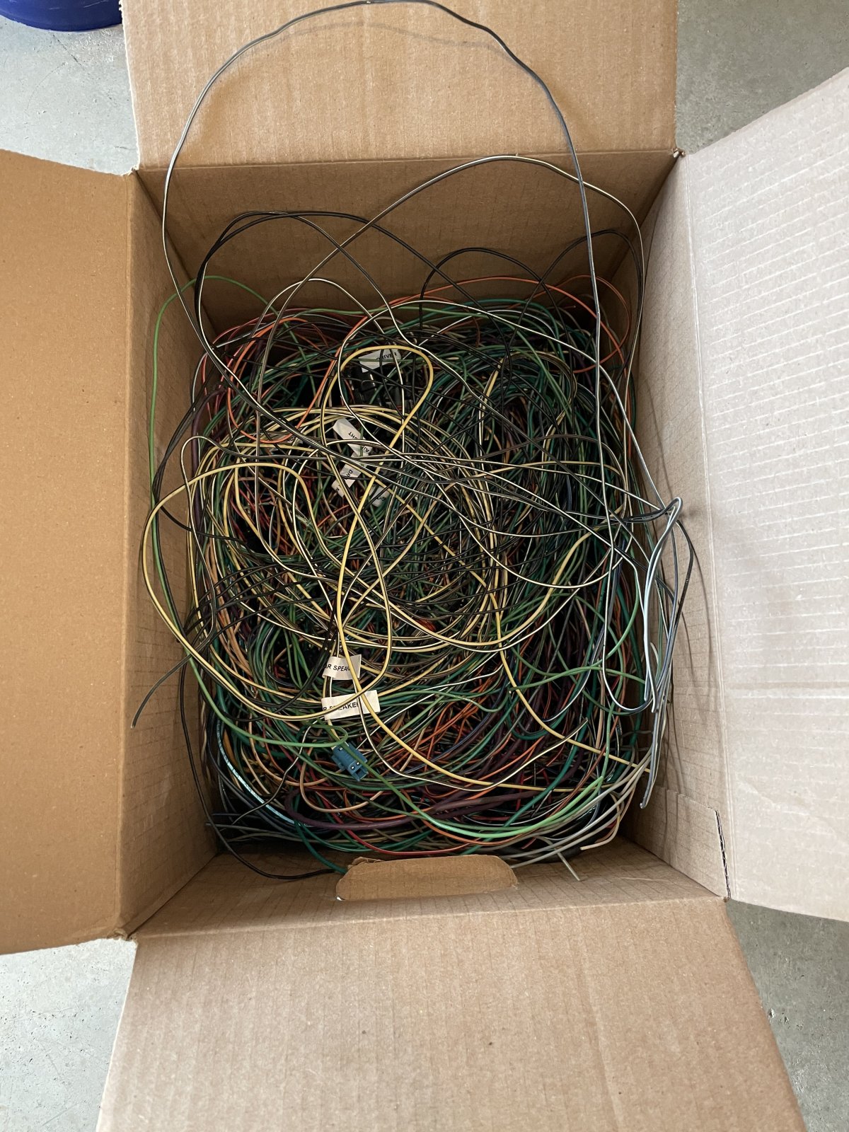

Harness is thinned. Now to extend and combine harnesses

I was hoping to have it finished this weekend, but family has been needing my attention so had to stop on the harness
I underestimated the length of the wiring videos severely.

As I stripped the harnesses, I relabeled the wires /connectors of what they are/were and where they came from as I pulled them through. Being colorblind, when he says “pull the yellow and green wires from the BCM to the fuse box,” I was looking at the wires I had pulled over the end of the table laying on the floor, found what looked to be yellow and green and read the label. Yup, the tail light wire goes to the back and so does the coolant connector. It’s been helping me so far... until he said “you should have 2 wires for the fuel pump draped over the fuse box,” ... but you had me pull 3 to the fuse box in earlier videos? Soooo I have an extra fuel pump wire by the fuse box at the moment haha. I’ll address it later

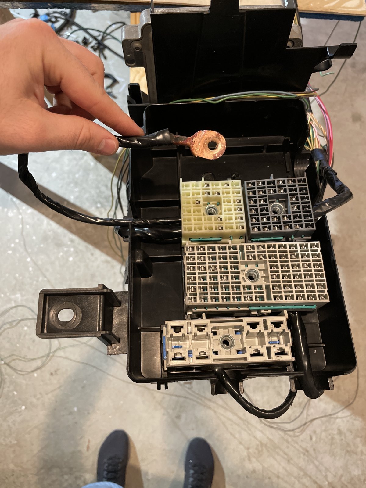

Working on part 6 of the wire harness videos, step 6 says to solder the 4 ground wires together (ground lug, fuel pump, coolant tank, and fuse box). Problem is, I’m not seeing a “fuse box” ground anywhere in my bundle, at least not one that is black. Is this supposed to be the black extension wire that was laid out in step 2 of the video? Step 2 said it was for the intercooler water pump, but that’s the only other black wire in the bundle near the front without going into the headlight harness area.
On the fuse box, I have a ground plug coming off the headlight block that’s 1ft long (taped just like the previous video said to do, but I didn’t have anywhere near as much cable length in total that the video showed).
Go and read through my thread, I had the same problem.

Thanks, so lonny said 3 of the extended wires stay at the back of the goblin (fuse box side) for tail lights and license plate light. He didn’t mention that forth extended wire, which I’m assuming for us is what he was referring to since we don’t “need” an intercooler water pump ground (being SS/SC, we are already wired for it in the harness). Regardless, so long as I don’t have any loose/ungrounded black or black/white wires in the harness, where they are grounded does not matter (frame or to the engine).
Basically I could grab all ground wires at the front and solder them together right now if I wanted and it’d work.
R
And those 4 extended wires came from that white/square fuse block in the previous video which I’m guessing is the “fuse block ground”
