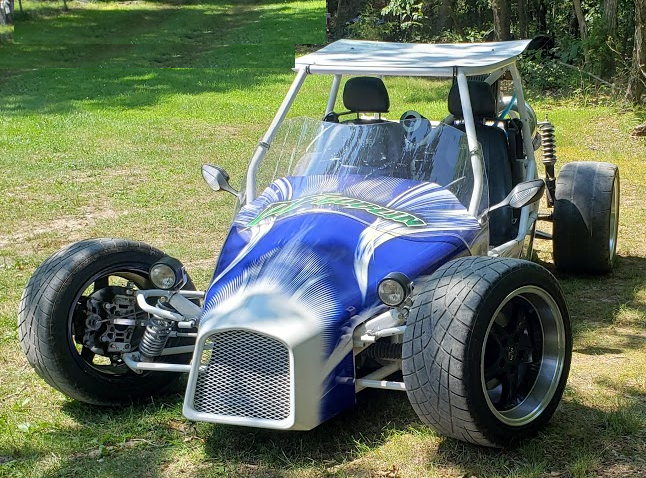

My wife & I went to the farmers market this morning, and caught a little rain on the way home. With the new windscreen and roof panel, we only caught a little rain on the forehead & face area. The rest of our body didn't get a drop. Wow, that was different.

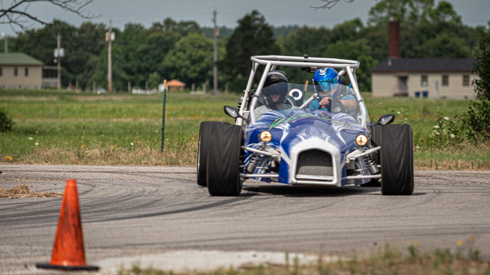

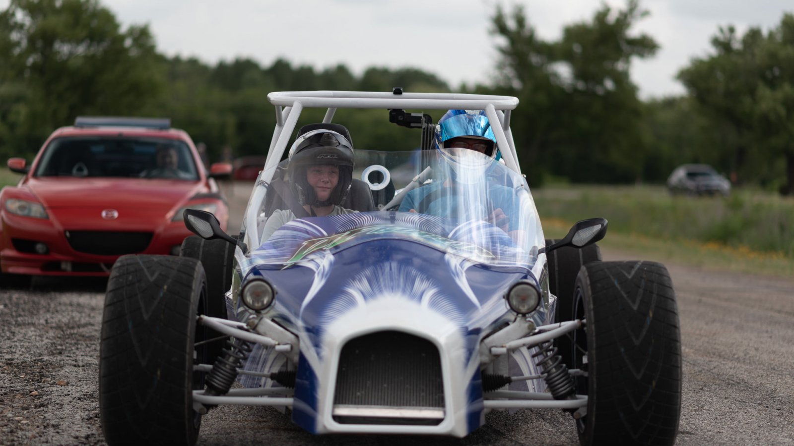

Camber on the tires looks spot on, nice and flat to the road in the turns. :)

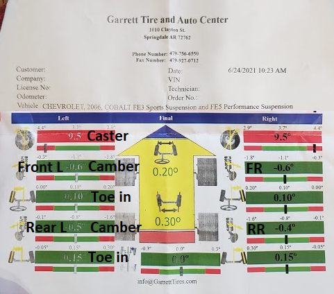

This last race I changed the wheel alignment, lowering the camber to -0.5 degrees so I can plant the whole tire on the road during the corners.
Also raised the caster to 9.5, so that the car will track better at highway speeds.

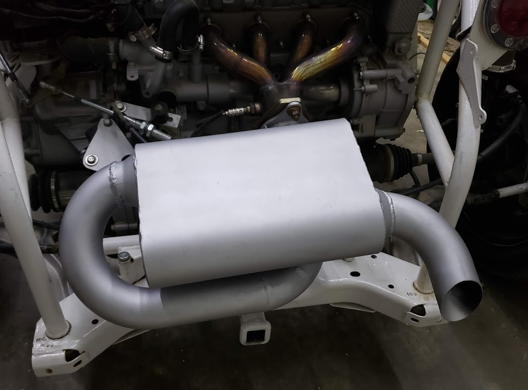

I only have to fix the air leak in the exhaust before I can start tuning again. I think it has been a year since I last tuned.

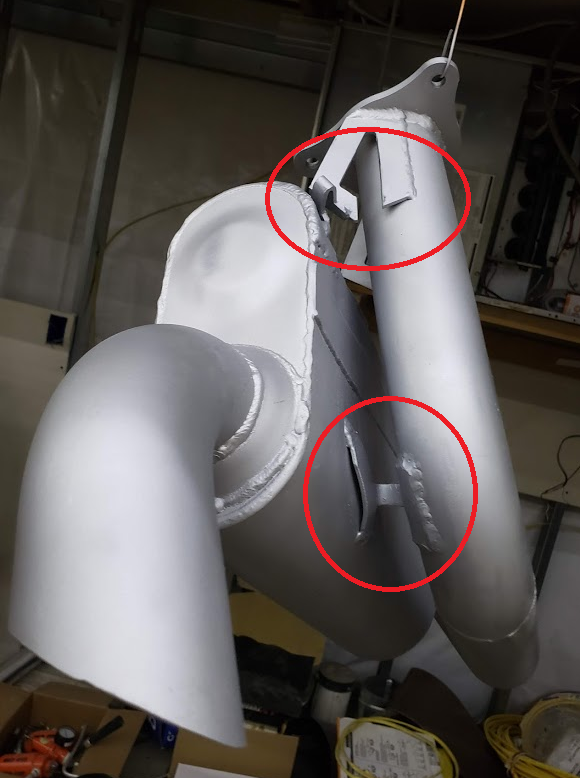

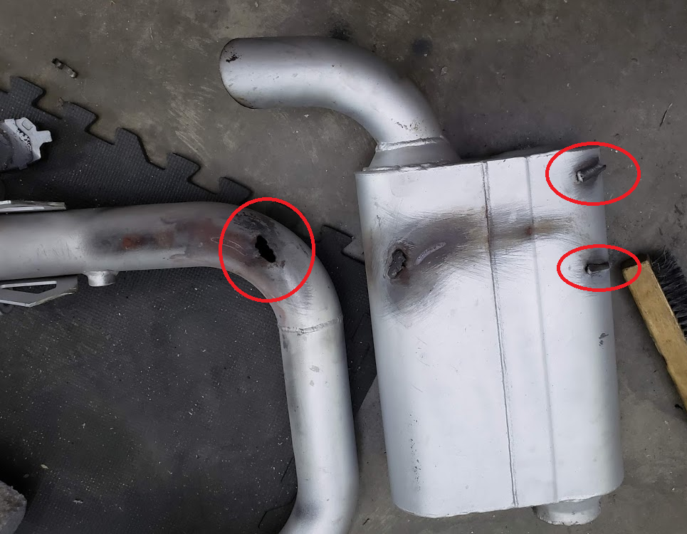

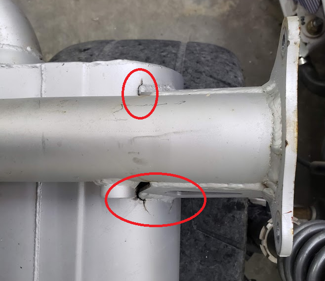

The muffler has 1/2" cracks top and bottom of both support flanges.
25261
I cut the muffler loop so I could get at the biggest leak, a big hole near my wideband bung.
25262
I welded plates over the cracks and hole, and when I rewelded the 2 pieces together, I left them about an inch apart.
I weakened the original braces, and added an expansion loops between the muffler and the pipe.
25263
A fresh coat of VHT paint, and we are ready for tuning. Oh, and the narrow band will work better, as the engine was running a little rich with the extra oxygen getting in the exhaust, and messing with the fuel mixture.
25264

The muffler is pretty thin metal, in order to keep it light, so no surprise that you can't just weld anywhere when mounting it.
Heat expansion also stressed that thin metal too. I probably have over 6000 miles on mine so far... 3 BCM's make it hard to keep track of the actual mileage.

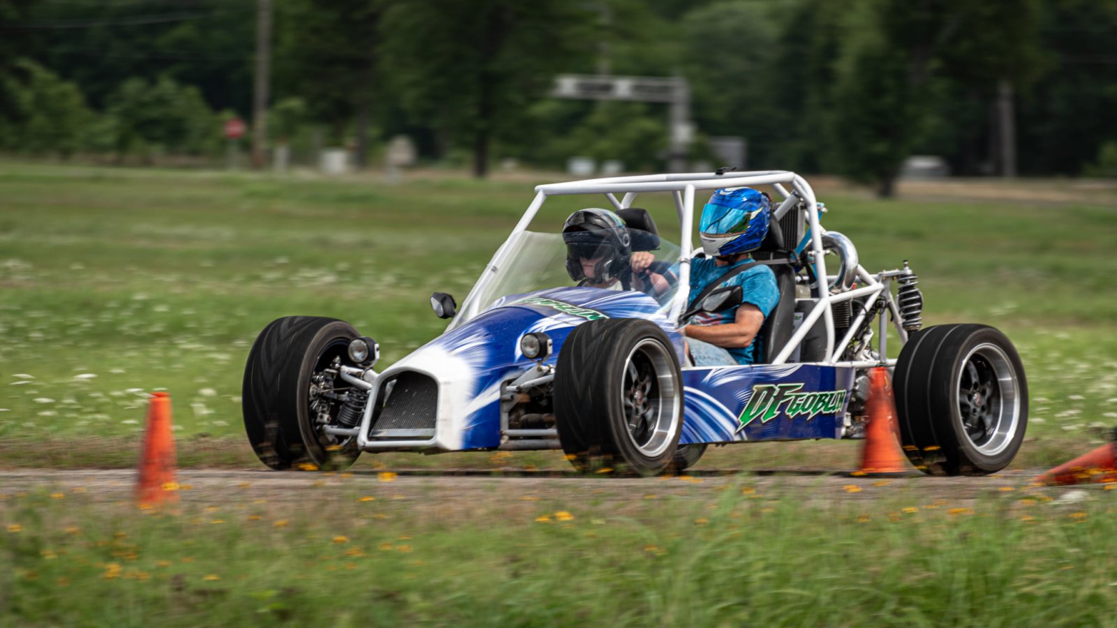

Yes, the pics of my last autocross had the new alignment numbers with the 0.5 camber.

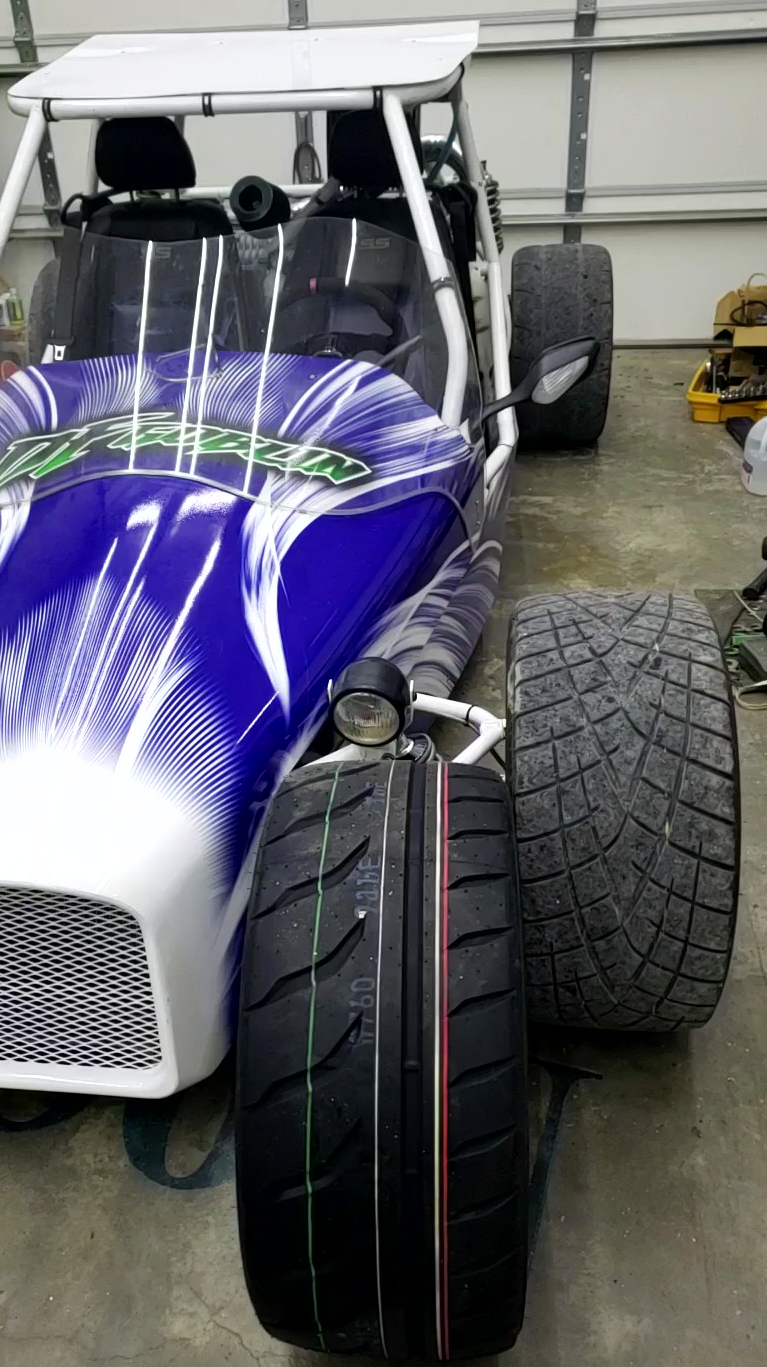

Driving on the road, with 0.5 camber on Toyo Proves 275mm tires, I don't plant the outer edge of the tire. I have to be doing hard cornering, like autocross. It is much better than the 0.7 camber that I had earlier. I have last years 315mm NT05 tires on the rear right now. Waiting for the rest of my new tires to arrive.
25420
Was this with .5 degrees camber and what are your rear tire sizes? Any noticeable improvement im thinking of reducing the camber from 1.5 on 275 tires.
Concur.
I reduced camber to 0.5 as well on 275 Proxes.
The wider tires just do not deform enough under our light load to get the tread face to the road surface.
Great thanks for update I’ll give it a try with .5. Did you also notice an improvement with the caster adjustment at highway speeds?
Yes, big improvement. It is a lot easier to drive at speed than ever before, but still the hardest to drive on a highway of any vehicle I have here (Dodge, Nissan, Mazda, etc). I'm really hoping that Lonny's new rear suspension gets rid of bump steer, and improves rear roll center, as highway driving isn't relaxing in mad Max. Not yet.

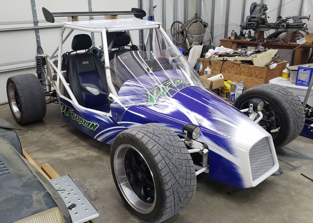

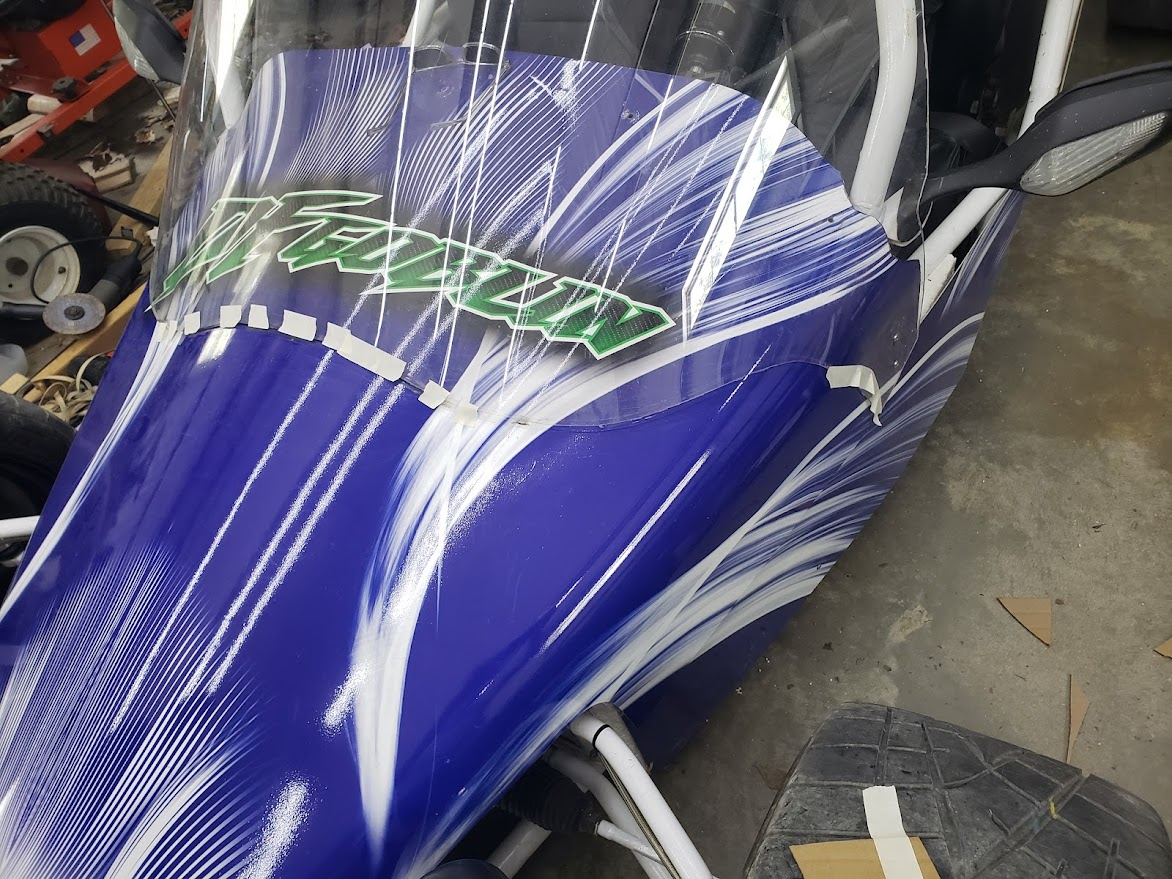

I would like to secure the new windshield to the fiberglass hood, as the prototype will shimy left/right under high wind loads. I could bolt it, like DF did with the stock windshield, or maybe run caulking, which would block small rocks from getting stuck on the sides. What would you guys do?
25685
I have taken the prototype window off, and adjusted the bottom edge to fit better. now it fits within an 1/8", and I reduced the stress at the sides of the windshield. This is important as the new Tuffak AR2 polycarbonate is about 1/3 thicker than the prototype.
Waterdriver
Maybe one or two center attachment points to reduce the shimmy effect.
Additionally use a rubber self adhesive edging strip on the bottom edge of the windscreen to take up the gap and help seal it to the body.
