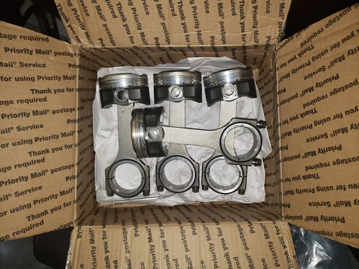

Took a chance on these ZZP forged pistons and connecting rods. They are used, but the seller didn't know much about wear, and didn't describe them well... so I was only willing to pay $400 for them, and I crossed my fingers they weren't damaged or worn out.
26245
They arrived today, well bubble wrapped, and on close inspection, they have barely worn the coating on the piston skirts, a bit of carbon on them, so they do have some hours on them.
New, ZZP wants $775 for pistons and 550 for the connecting rods.
I need to purchase LNF/LDK tube type Gen 2 oil squirters, main bearings, and new rings.
Looks like ARP doesn't make connecting rod bolts for the LSJ.
I don't have the top end parts, but building a forged bottom end is a good start.
So now I'm looking for LSJ cams, rockers, valve springs, etc.
I have abandoned my idea of twin charging the LSJ, as modern turbos can be set up to have little lag. So add a turbo to the wish list. Borg Warner S257SXE ?

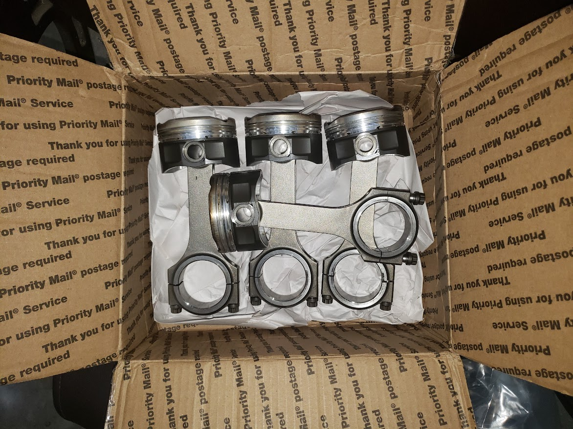

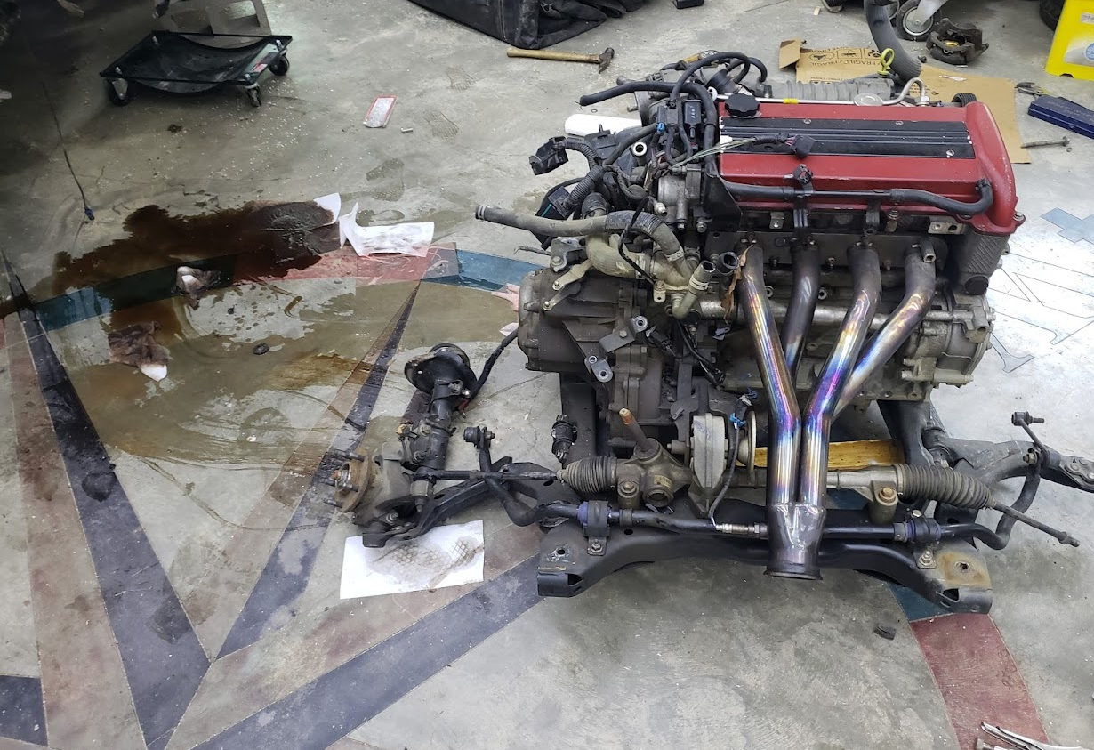

I did drain the oil and the antifreeze, but somehow when you pull an engine...
A little oil out of the shock, a little antifreeze, a little oil out of the AC, a splash of gas, a bit of clutch fluid, even skinned a knuckle and added some DNA stuff.
It is like cleaning up a murder scene.

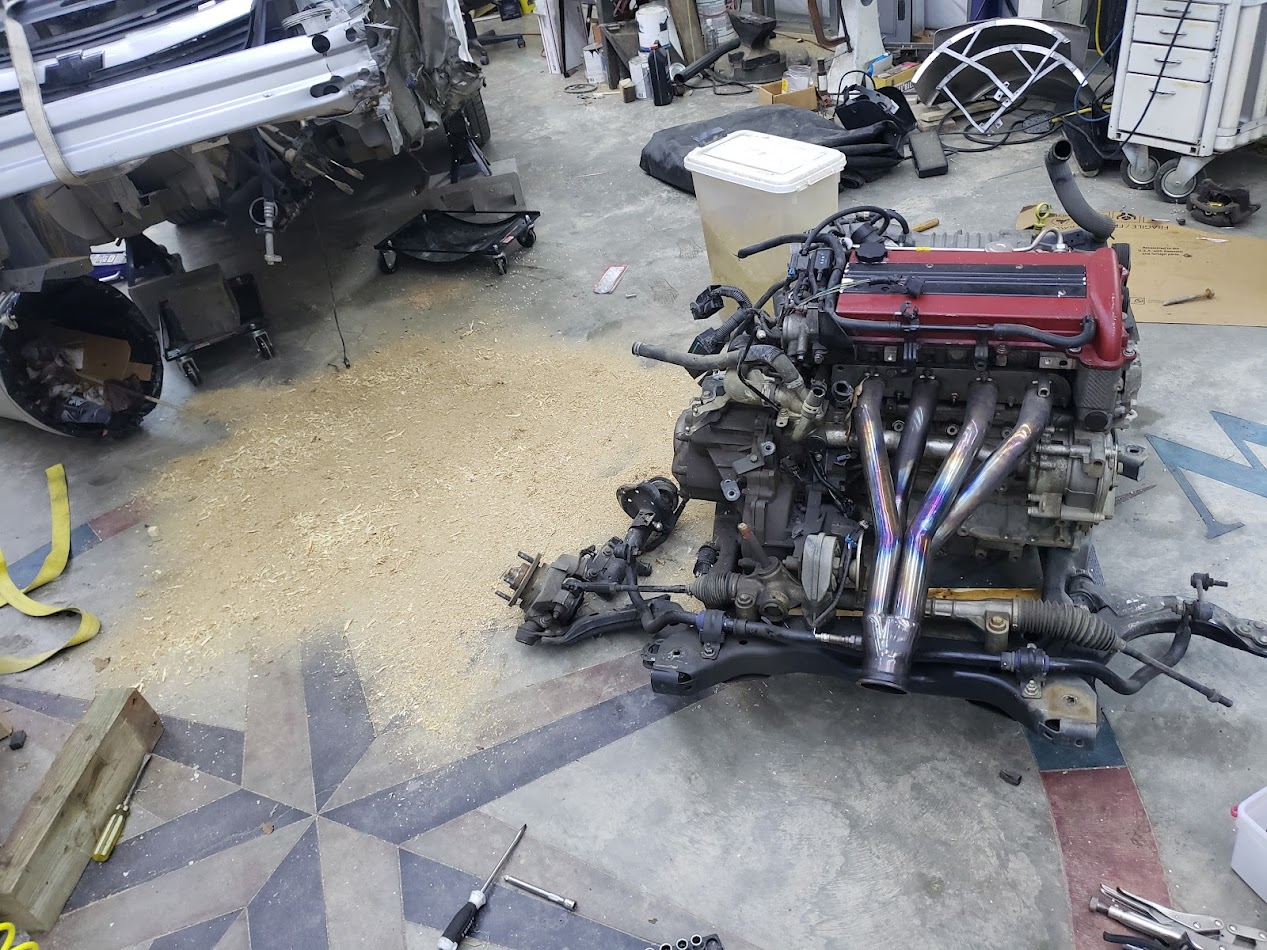

26413
All wiped up, and a little sawdust to soak up any residual.

Time to learn this engine. I need to pick one to tear down, and build up.
Yes, back in January I bought a second donor. Took me until September to pull the motor!
I did use the Recaro seats, pull a mid shaft, a power steering motor & controller, and a starter motor off of it. It is nice to have spares, but I really bought it to build one engine while having something to keep in mad Max.
That’s what I have been looking for, for a while. Basically, I’d like to have a few spare parts around, but mostly to build an engine, then swap when need be. An extra lsd trans will be useful one day too.
