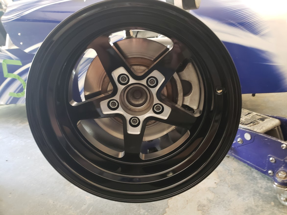

I do need an event! But the 25th of this month is the same weekend as the Reaction Motorsports event that I am missing. I am in Dallas that weekend. Hopefully my tires don't take 5 orders, and 4 cancellations due to not actually in stock like their website said. (The Proxes R888R did, took 2 months!) Right now I just have 15" wheels.

I don't use the year/model search feature, as I don't want my tire selection to be limited by the fenders on a 97 mustang car. (What the 17" wheels were made for.) I don't know what my new 15" wheels are made for.... I doubt it was mad Max.

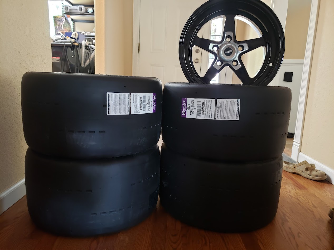

Jegs has the Hoosier A7 tires in stock.
The 295-35/15 are actually 302mm wide, 22.6 lbs.
The 275-35/15 are actually 291mm wide, 20.8 lbs.
The break in proceedure says I need run them, and scuff off the shiny surface, and then let them sit for a week.
So I have my "work" cut out for me.

The best way is to use a 80 grit dirt track tire grinding wheel. If you do as most do you will push the unwanted chemicals deeper into the tread. By removing them cold the tire is ready first turn first lap. Learned this circle tack racing on asphalt.

Remember Ross, those tires will pick up some large stones from your gravel/rock driveway. You will have to get the vacuum out to clean your interior and seats. Get your heat gun and a scraper ready for after the autocrosses, since you will need to shave the tires to get rid of the rubber blobs and curls you build up on them. Wear goggles!! Or your full face helmet!. You should pick up a couple seconds pretty quickly from what you were using for tires.
