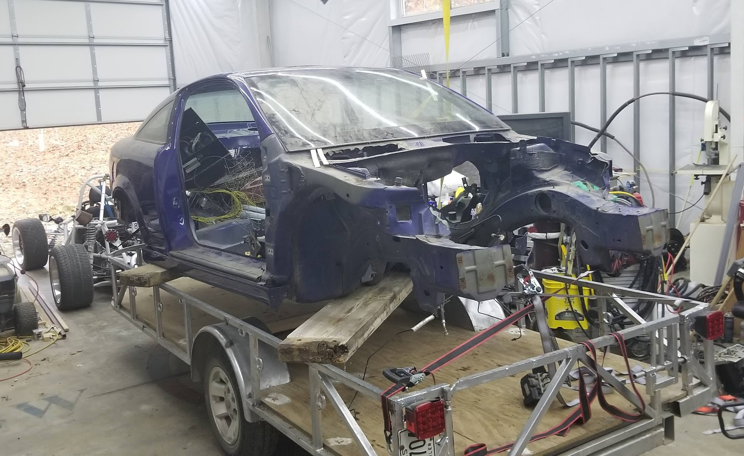

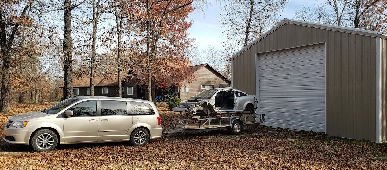

Wait one darn second.
You have a trailer hitch on Mad Max and you did not hook up to that carcass on boards on a trailer with it?????..............
Photo OP missed............ :(
But I already posted that pic with my first donor....
In with the trailer,
28814
Out with the Cobalt shell.
