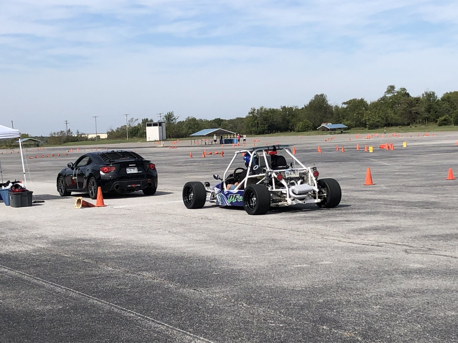

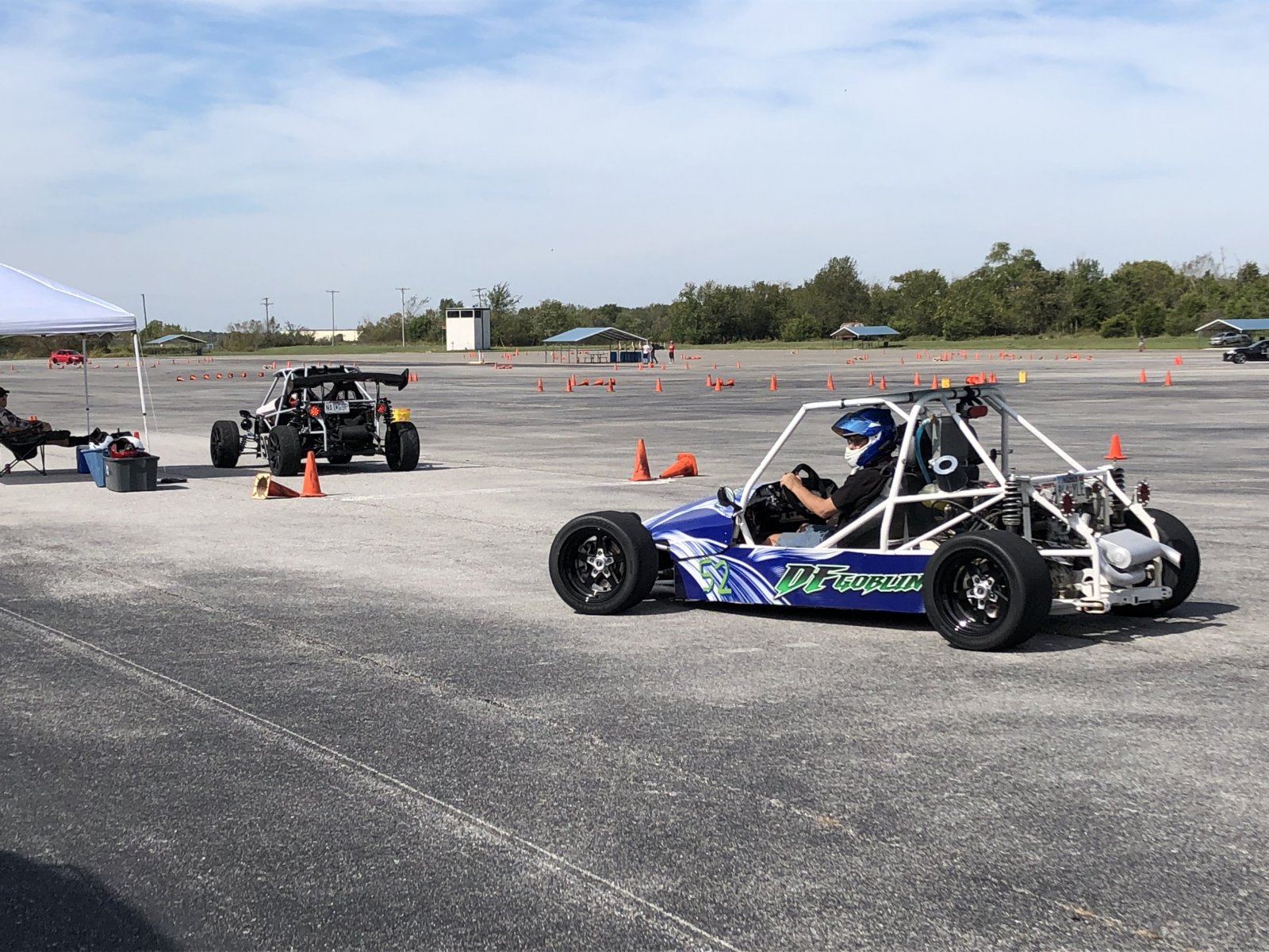

Definitely a fun day with a twisty course!

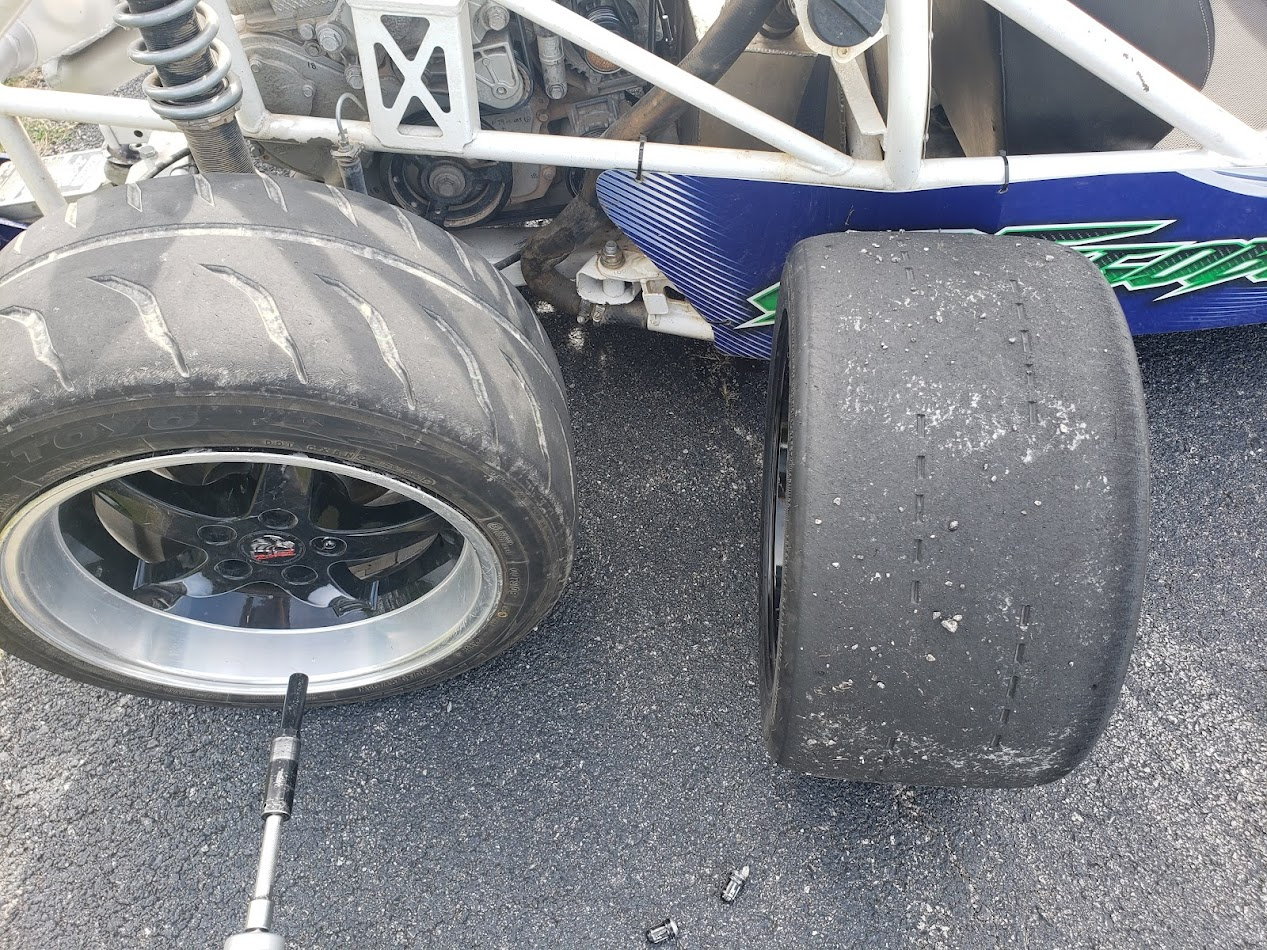

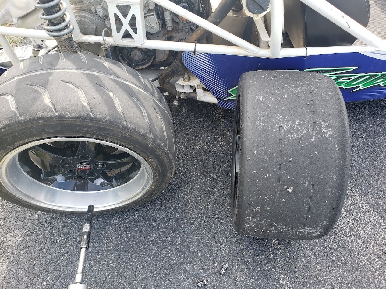

So I bought a Longacre tire pyrometer, and tried to get my Hoosier slicks up to a normal 170F temp. Gave up after 5 laps.

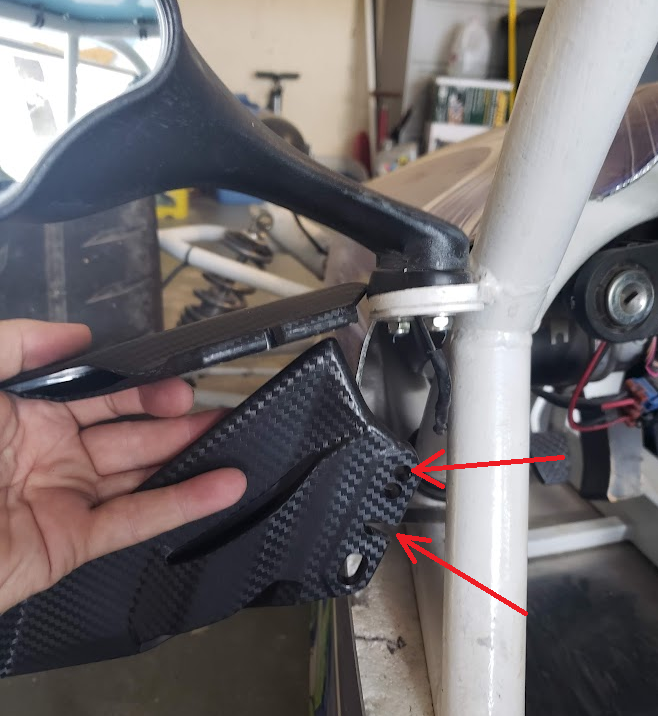

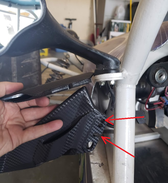

My kick guards arrived, I needed to drill one hole bigger, and notch the electrical hole.
Then I discovered that mirror bolts aren't long enough, as I had trimmed them when installing the mirrors.
Guess mirror set #4 will be the ones to get kick guards with aero wings.

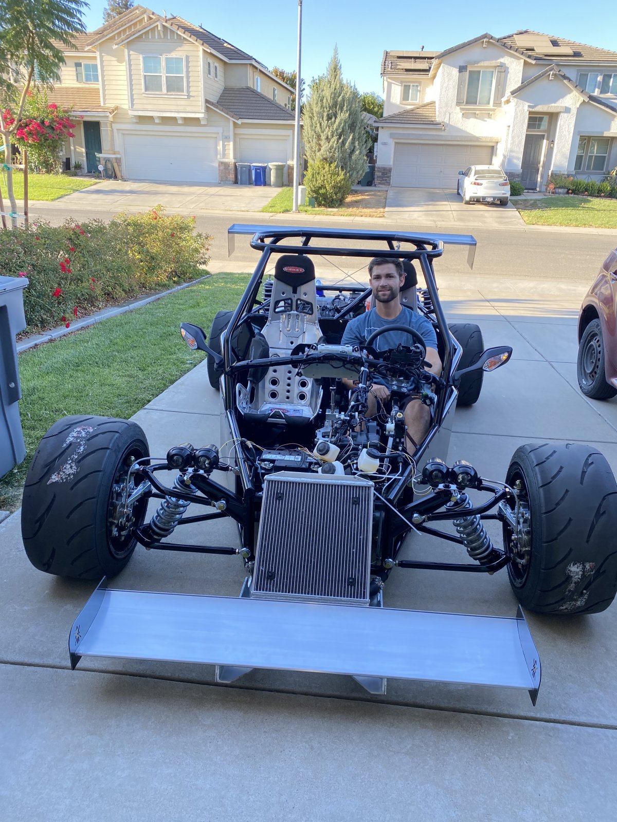

So I had a pretty bad wheel hop episode the other day when I panic braked. I have been kind of testing the brakes since to see if I can recreate that. I think it happens when I jab the brake super hard. It’s almost like I have to gradually load the front before I mash the pedal in order to not get a slight wheel hop. I’m trying to solve the issue now. I wonder if it has something to do with me being over sprung on the front with 500’s. I have a manual brake setup so not sure if that has anything to do with it. Brand new hubs and brakes. I also wonder if it has to do with having some drastic offset on my wheels. Justin Reed has the same wheel setup but with 5.5 in backspace rather than 4.5 in. Not sure if he had any of those issues. Probably going to start by switching to 300’s on the front and reduce negative camber. Wheels would be my next guess.

Just looking at the picture makes me think it has to be the wheels sticking out that far past the caliper/rotor causing some funky torsion under hard braking. Thought I might gain some track width by going with a higher offset but maybe not the best idea.
