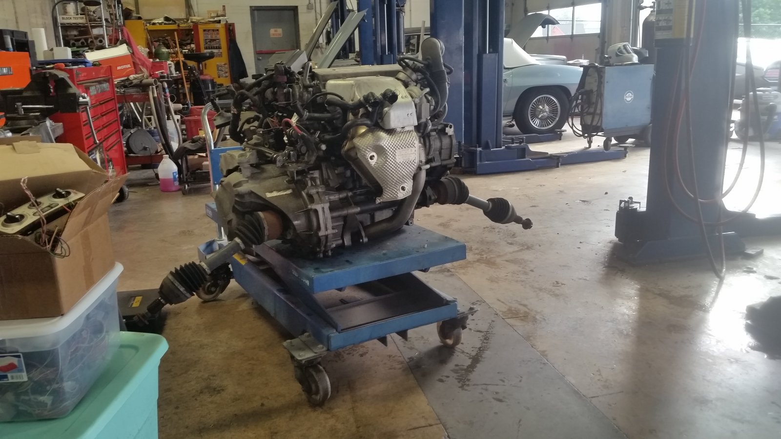

Started Friday evening with the tear down, complete to day at 5pm. the car is a 2007 Cobalt SS supercharged.
Next step is to rebuild and modify the parts. Other than the fitment of the front wheel bearings is there any other reason not to run ABS braking?

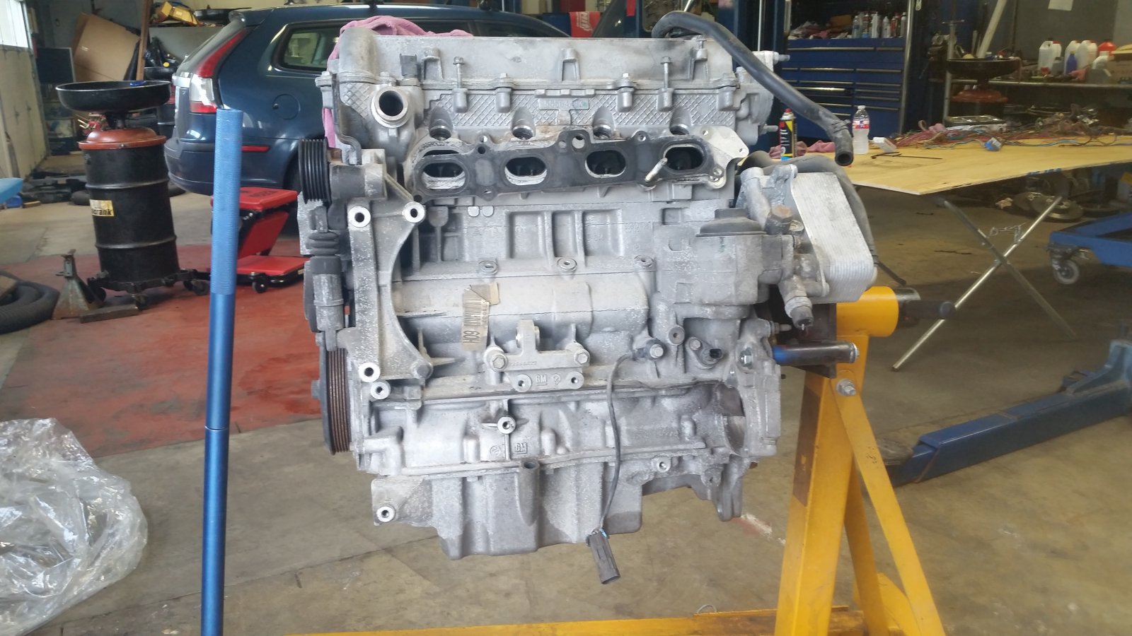

This week got ride of the shell, put the engine on a stand and gear box on the bench for tear down. This week end will work at video #9
Brad
Mine works nicely on the bench. Sits on the oil pan very well.

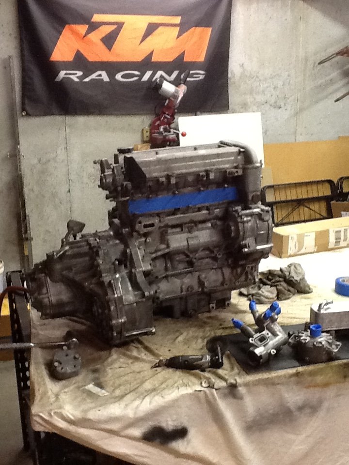

Disassembled transmission to install limited slip, ordered some bearings and syncros. Will not be working on wiring this weekend as planned. Bought a 2006 SAAB 9-3 with six speed manual.
Will use the SAAB engine because it is sand cast not foam making it a little stronger. Not going to use the six speed transmission at this time as already have limited slip for the 5 speed.
If I wind up with a highly tuned engine with a narrow power band may use the 6 speed.

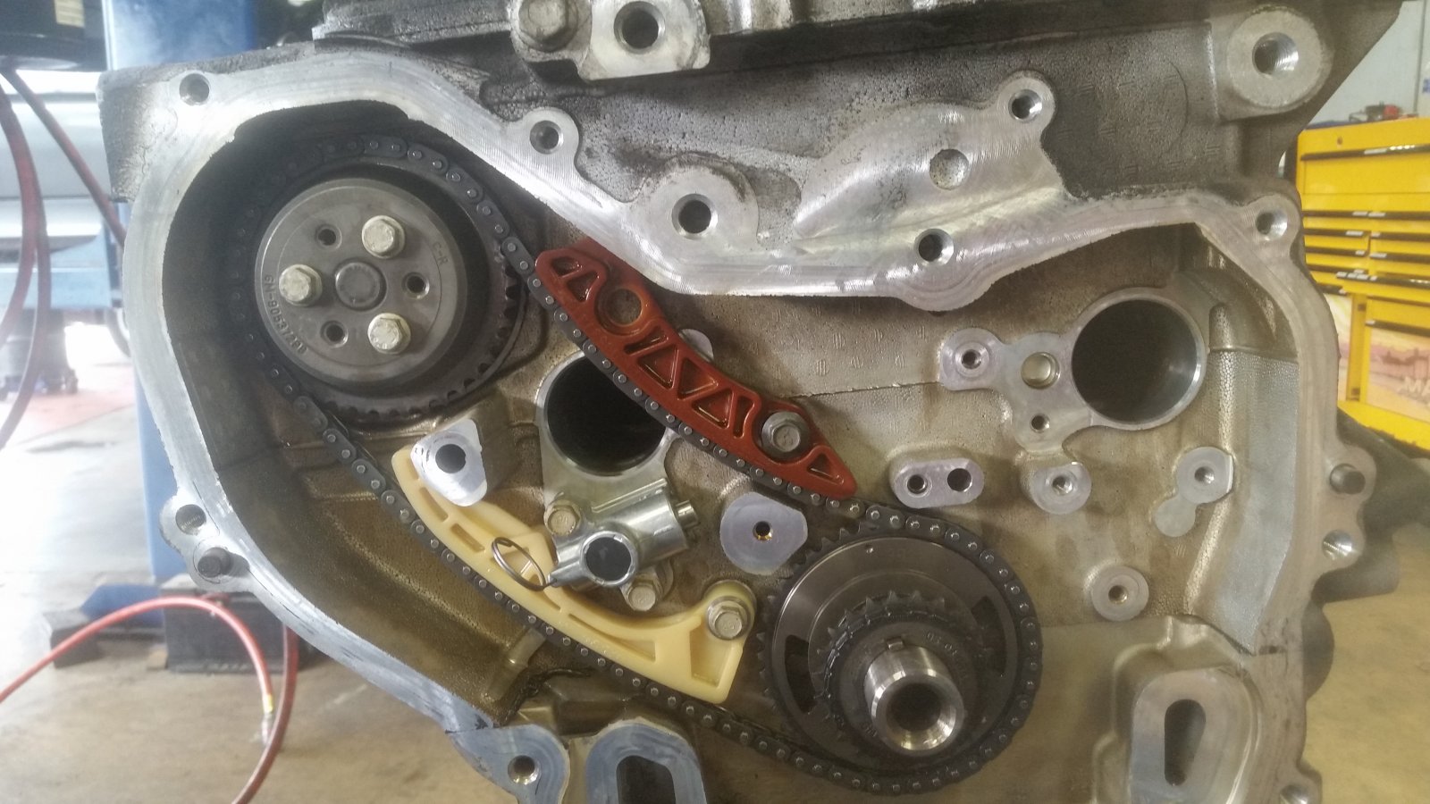

Disassembled engine,cleaned pistons. Install ATI balancer, aluminum flywheel and better clutch. Going to have everything balanced since the balance shafts are removed..
