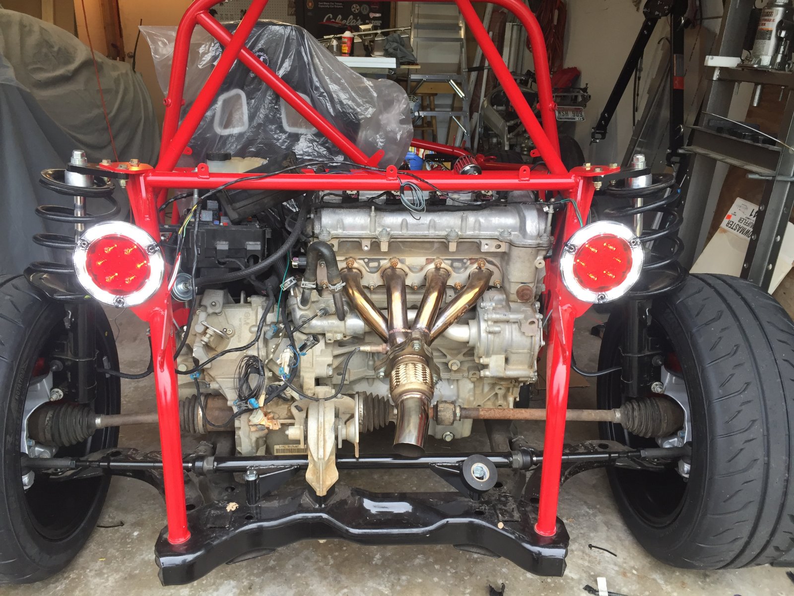

Got rotating mass cleaned and sent to be balanced, including aluminum flywheel. Ordered more transmission bearings. Worked on wiring again this weekend, should be done next week. Not confident it has all ben done correctly so I will not wrap harness until every thing is working.

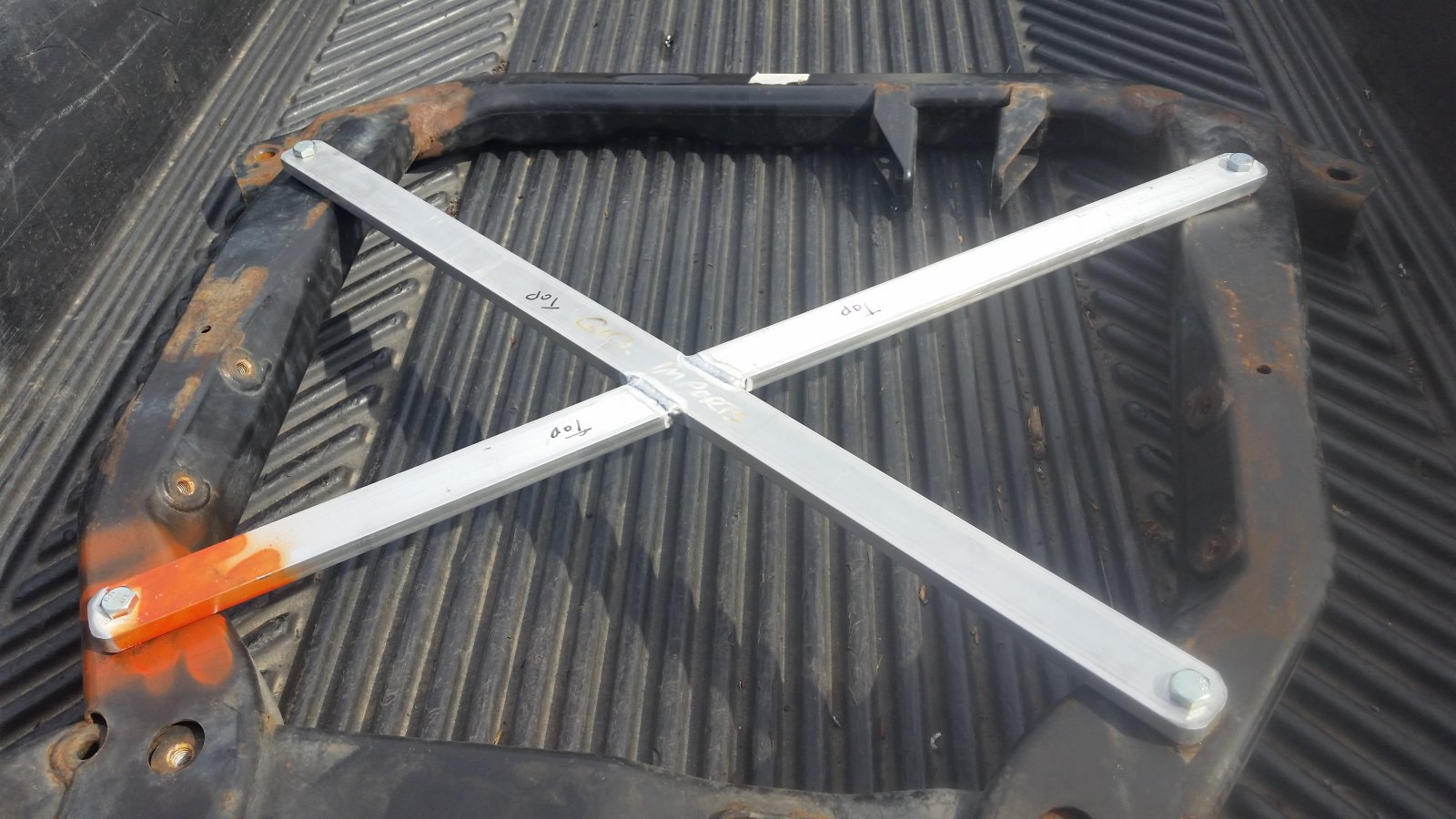

Finished gearbox overhaul and limited slip install. Solved issues with the wiring harness, but still not going to wrap until everything is working. Welded in threaded lugs into sub frame in preparation
to install cross bracing to keep it from deforming under hard cornering. Install oil block off sleeves for rear balance shaft bearing area.

Finished the front oil block off for the removal of balance shafts, got rotating assemble back form being balanced took to have coatings applied. Cleaned parts and modified some. Researched wheel and tires. Saturday morning went to a Monolithic doom home that had an open house. All and all not enough

Finished subframe cross brace. Cleaned and painted more parts. Ordered more patrs,missing the 82# valve springs. Wheels and tires will arrive next week. Fronts 16x7 with 205/55/17
Rears 16x8 with 245/45/16
Sent hubs to Texas for bolt pattern change.

The offset is +38. Will not know until January if that is correct. I measured the back space of the 18"that came on the car then went to tiresize.com to find offset

Is there going to be an issue on rear wheel to strut clearence? Or tire to strut spring seat?

I do not know if there will be a cleance issue, I am sure it can be solved.
