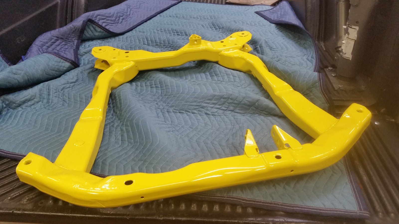

End of another week. After the failed attempt to anodize pis tons decided to measure and make sure they had not been damaged. They were no longer the correct shape. Ordered forged piston and connecting rods to match. Had to order the super tech valve springs as the others were not available. Picked up subframe from powder coating. Clean,paint,and modify more parts.20171101_105316.jpg 20171101_133420.jpg

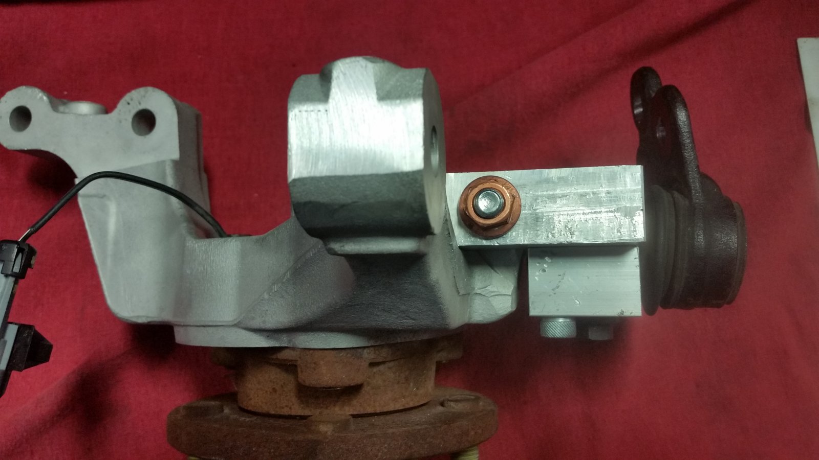

George

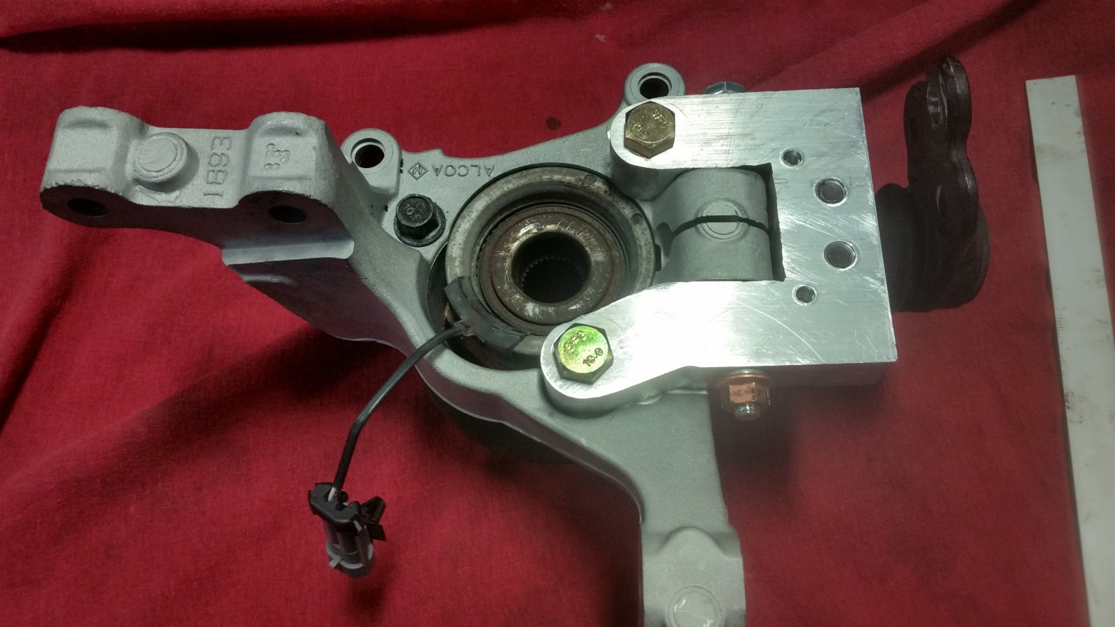

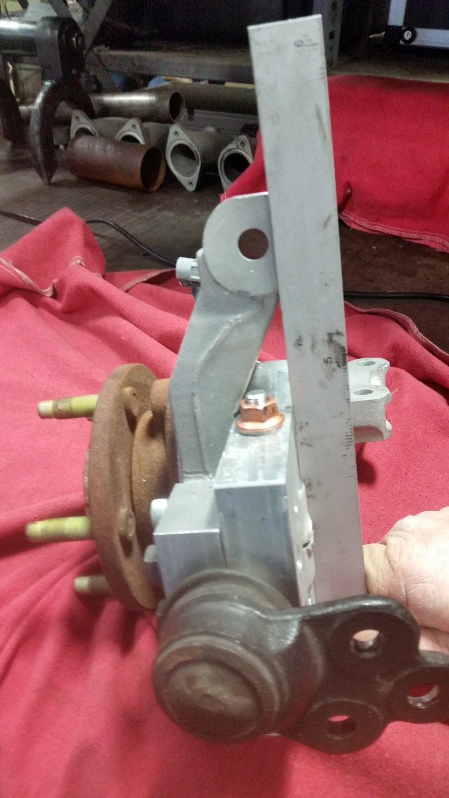

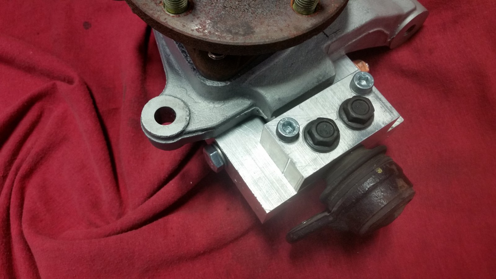

Completed my lower ball joint extenders for the rear suspension. These will allow for better camber gain when turning to keep the tire in better contact with the road. Will have to move outer tie rod end down to adjust rear roll steer. Will also may be able to lowet the car.

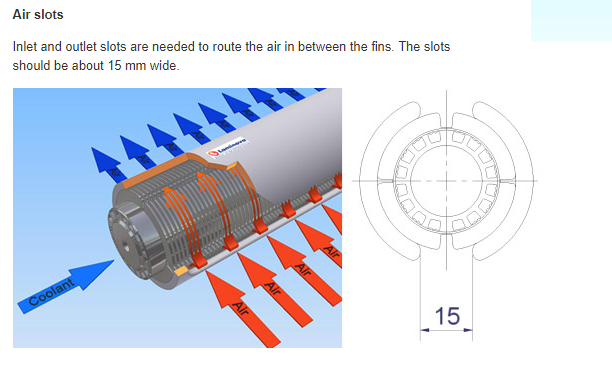

Brad
When you installed the Laminova tubes (inner cooler tubes), did you clock them? I had seen it somewhere where they are to be placed in a certain position but then couldn't find it again when I was installing them. I emailed the the support of manufacture of them and they didn't seem to know. Later I was able to find the information and sure enough, there is a correct clock position when putting them in.

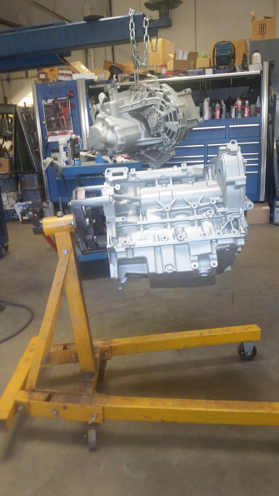

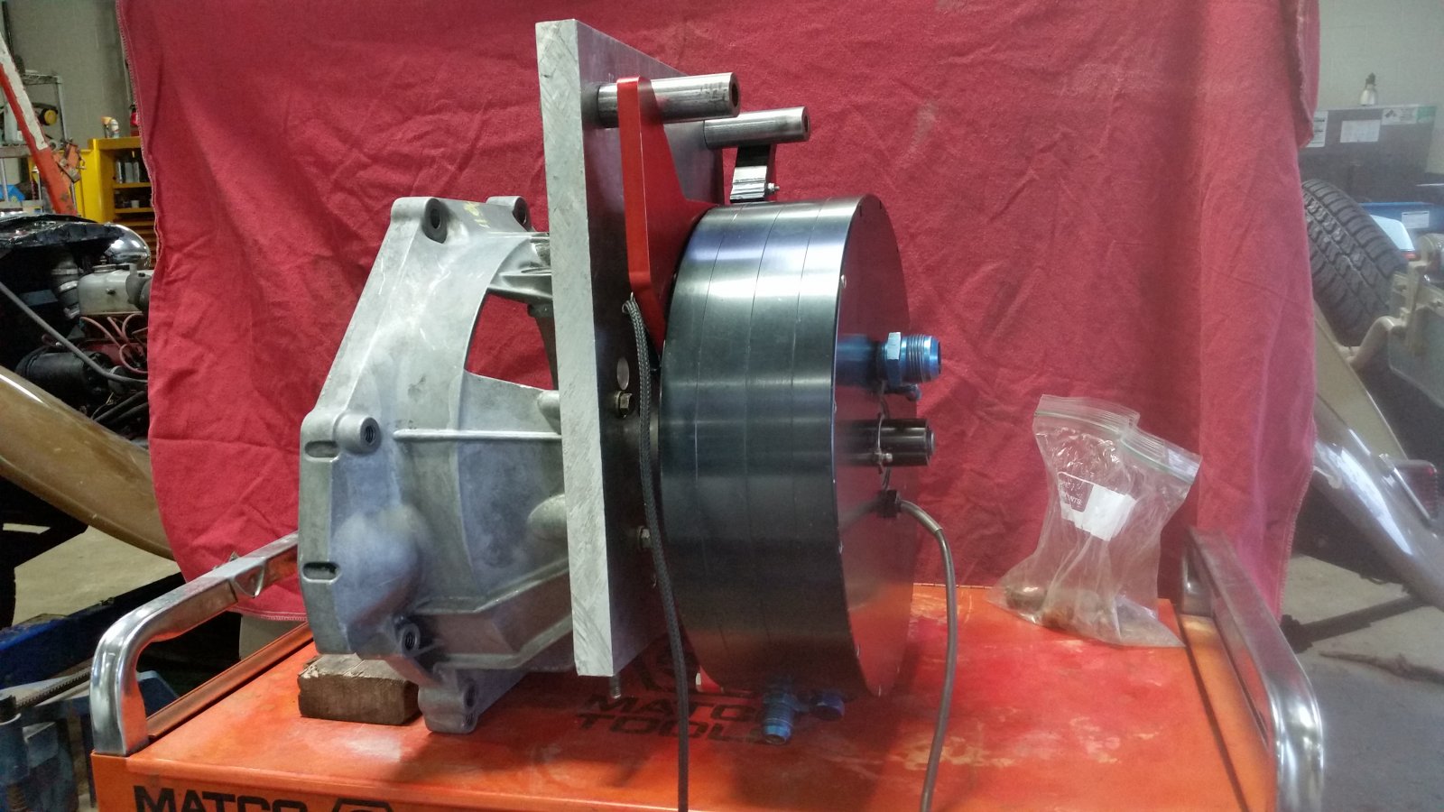

Dug out my ecotec dyno engine adapter.
Picture is bellhop sing adapter and absorbsion unit. This bolts to the engine.
Hoping it will fit in the chassis

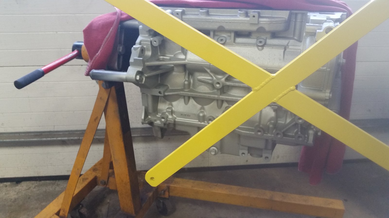

George
Did very little this week, clean and tested fuel injectors. Thought about how to add anti squat to rear suspension.
Waiting for pistons to comeback from coating and kit to be ready for pickup.

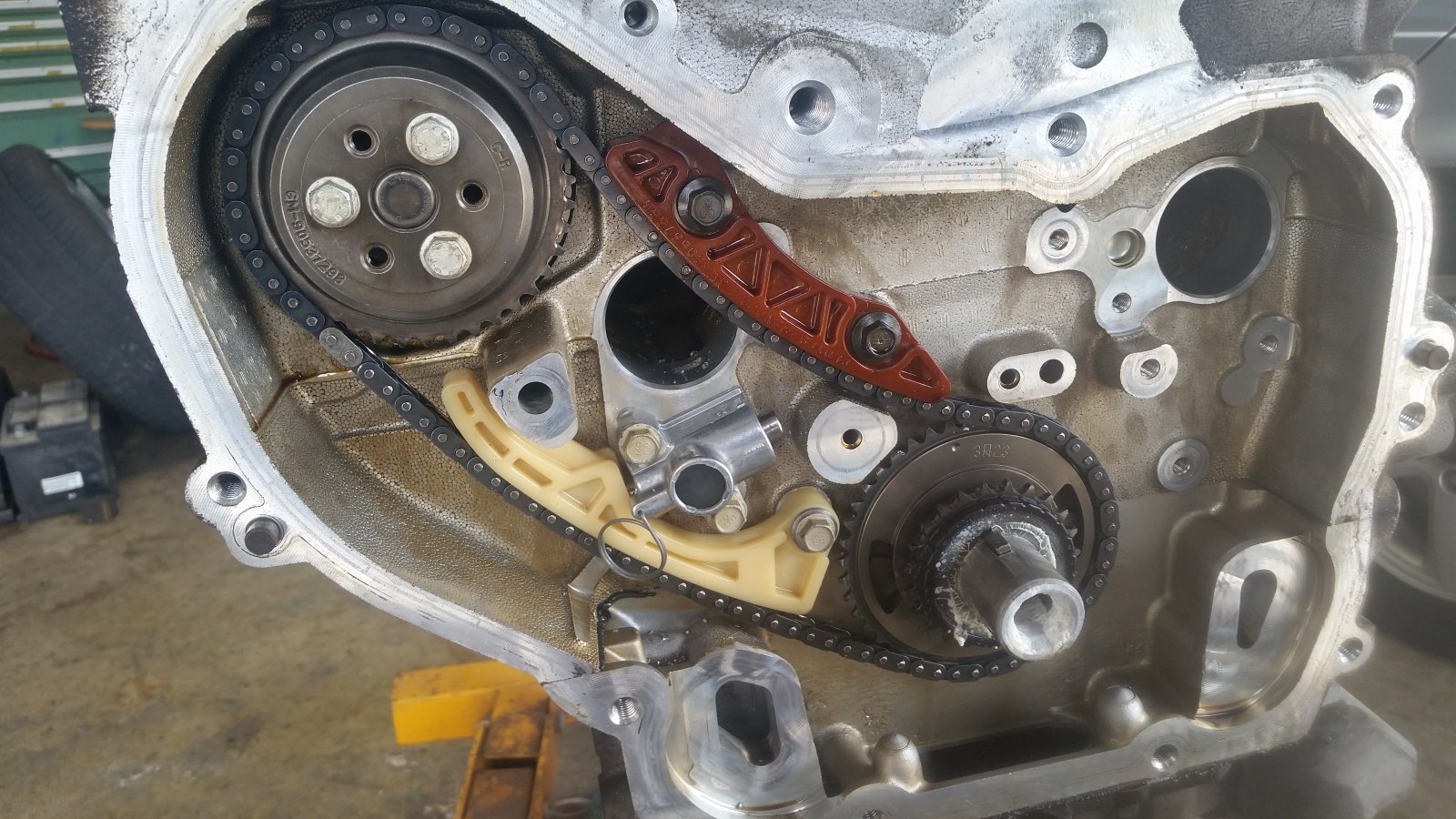

JSATX

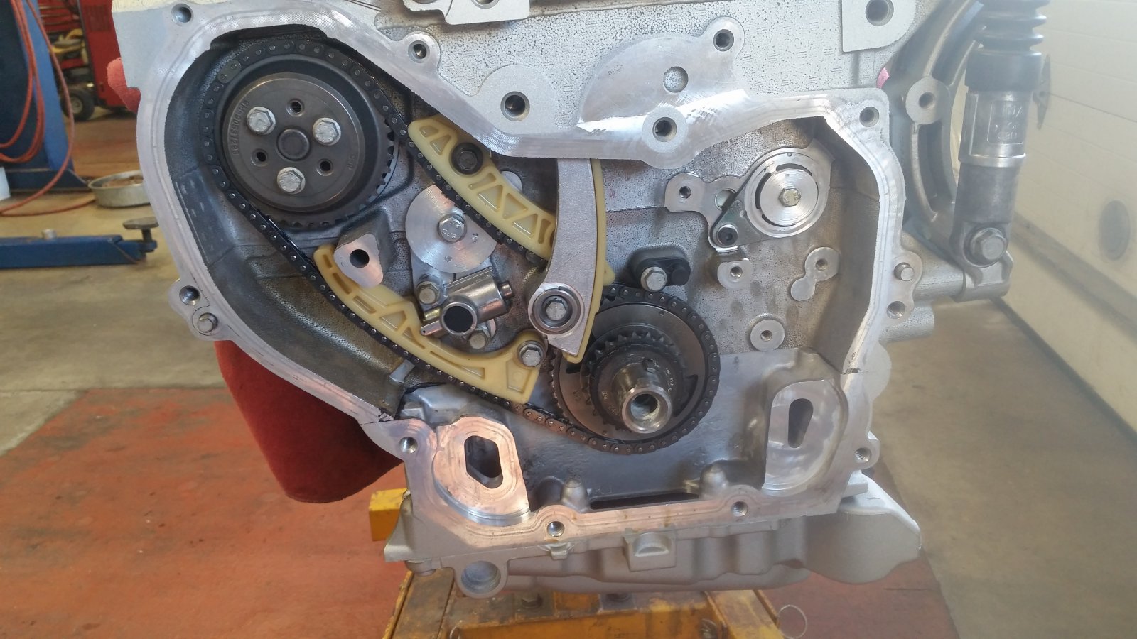

Instead of buying the neutral balance shafts, I was thinking of having a machine shop chuck the stock shafts up in a lathe and lop the lobes off. That way the original bearing surfaces are still there and you won’t have to worry about Blocking the oil passages off etc. Think that would work?
George
Yes that will work, but you are still running the long chain and turning the shafts twice engine speed.
To make it so that you only use a short chain the balance shaft next to water pump

George
The balance shafts do make the engine smoother at idle and low speed mostly. By installing the neutral balance shaft the engine produces a littLe more hp and acclerats quicker. By totally removing all the shaft altogether and using a shorter chain you will gain more
Note the balance shaft turns twice crank speed.
