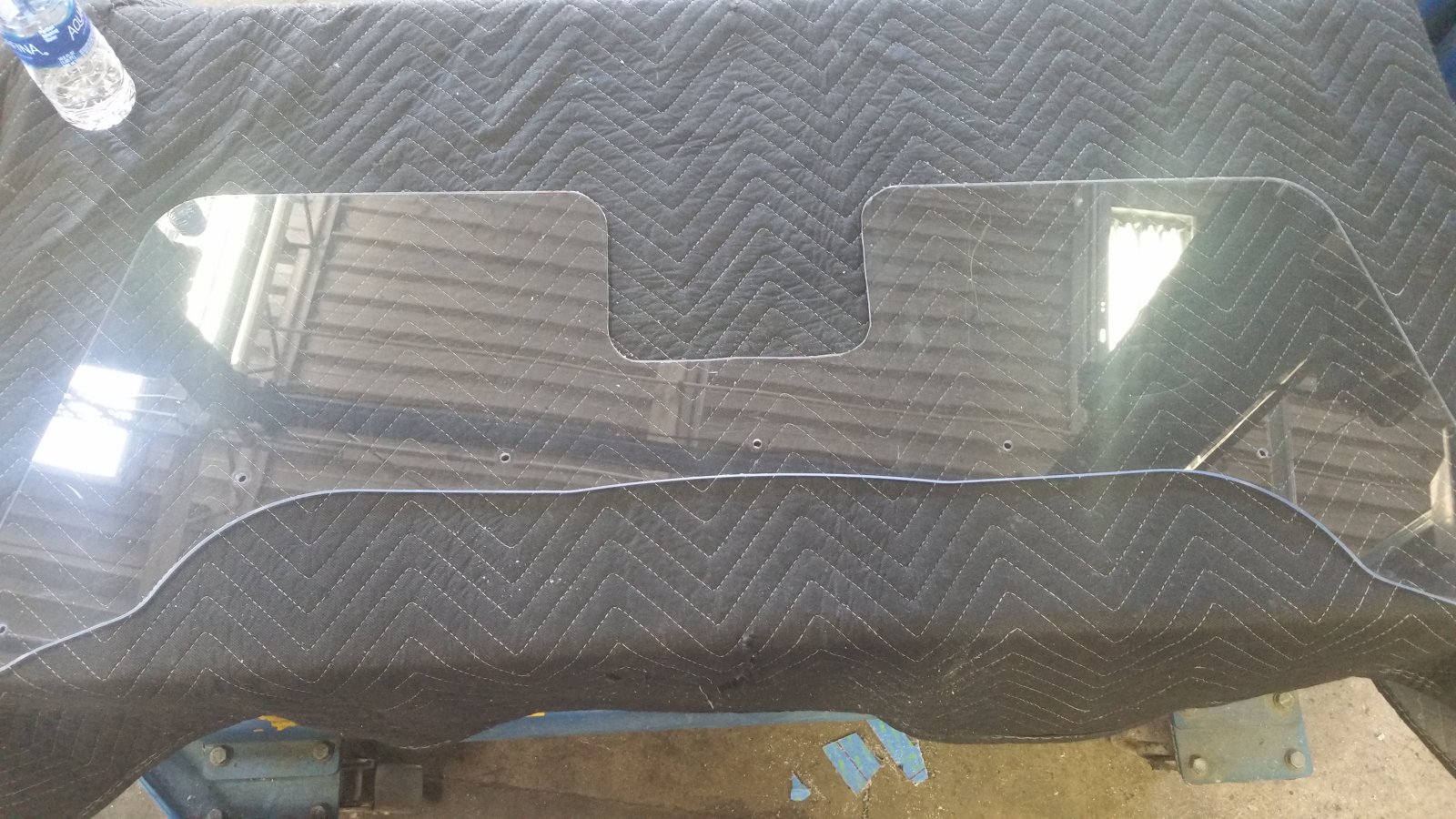

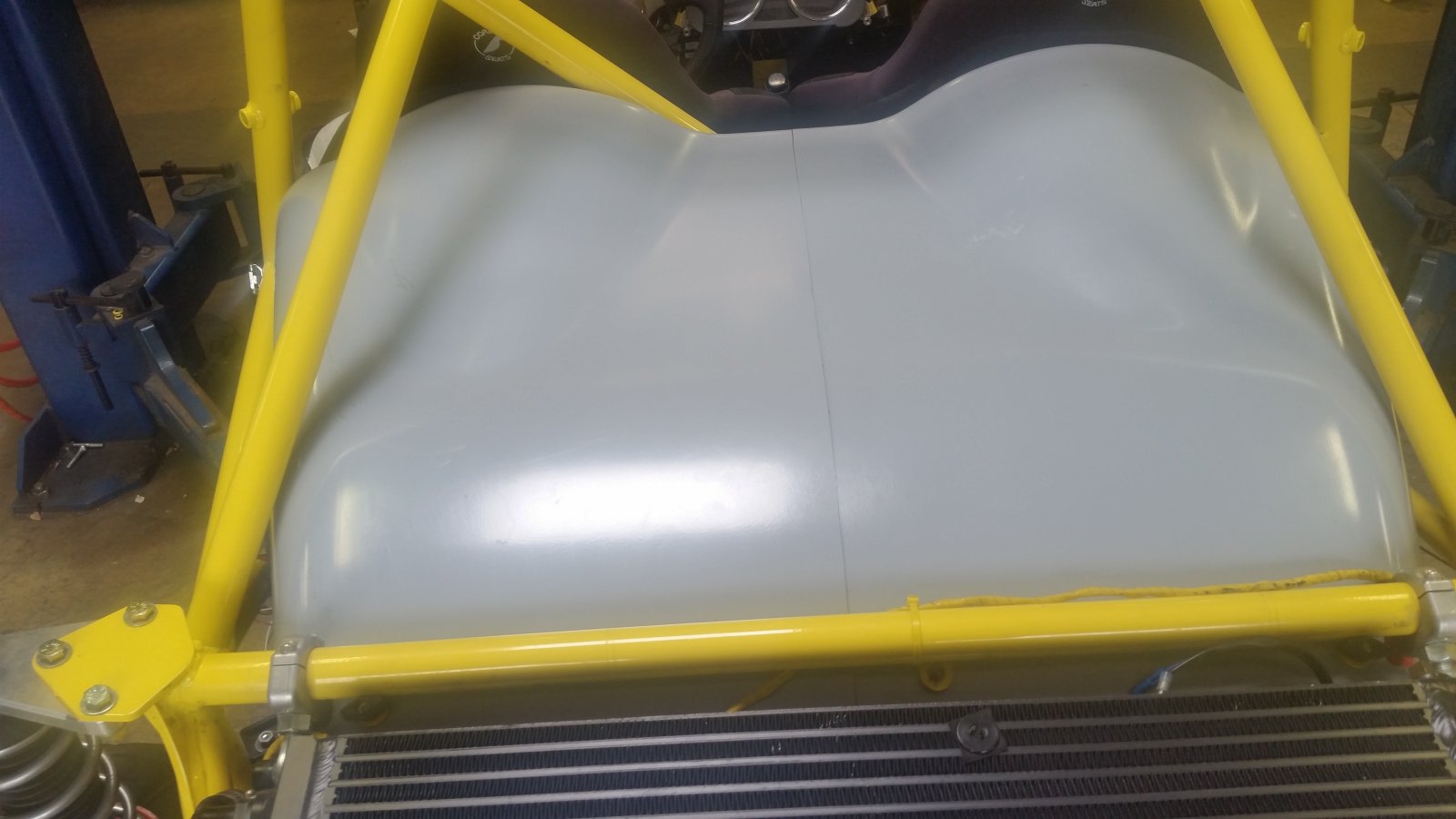

Cut a bigger slot in the windscreen. Will not be able to test for over a week waiting for cylinder head and modifI'd intake manifold.

George that's a nice idea. Curious if it would help as well to taper it too? With a slight angle like the outside edge of the windscreen. Granted you might need to have someone look at where you sit in the car. So you don't take off to much with the taper.
George
Since I have the track frame I would want the windscreen to cover the uprights so the most that could be trimmed is about an inch.
Brad
Silverback

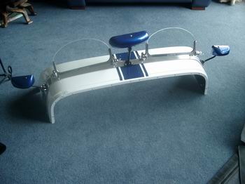

By the time your done cutting that windscreen you could just go with a brooklands windscreen setup.
'been thinking about Brooklands too. Adjustable and so classic! Would go perfectly with a Lotus Seven style nose and headlamps. Probably have to wear goggles or worse, a full-face helmet to deal with bugs, rocks, tire spray, blown radiator coolant or low-flying birds :eek:
Here's a relevant discussion:
www.lotus7.club/forum/techtalk/brooklands-screensaeroscreen-advice

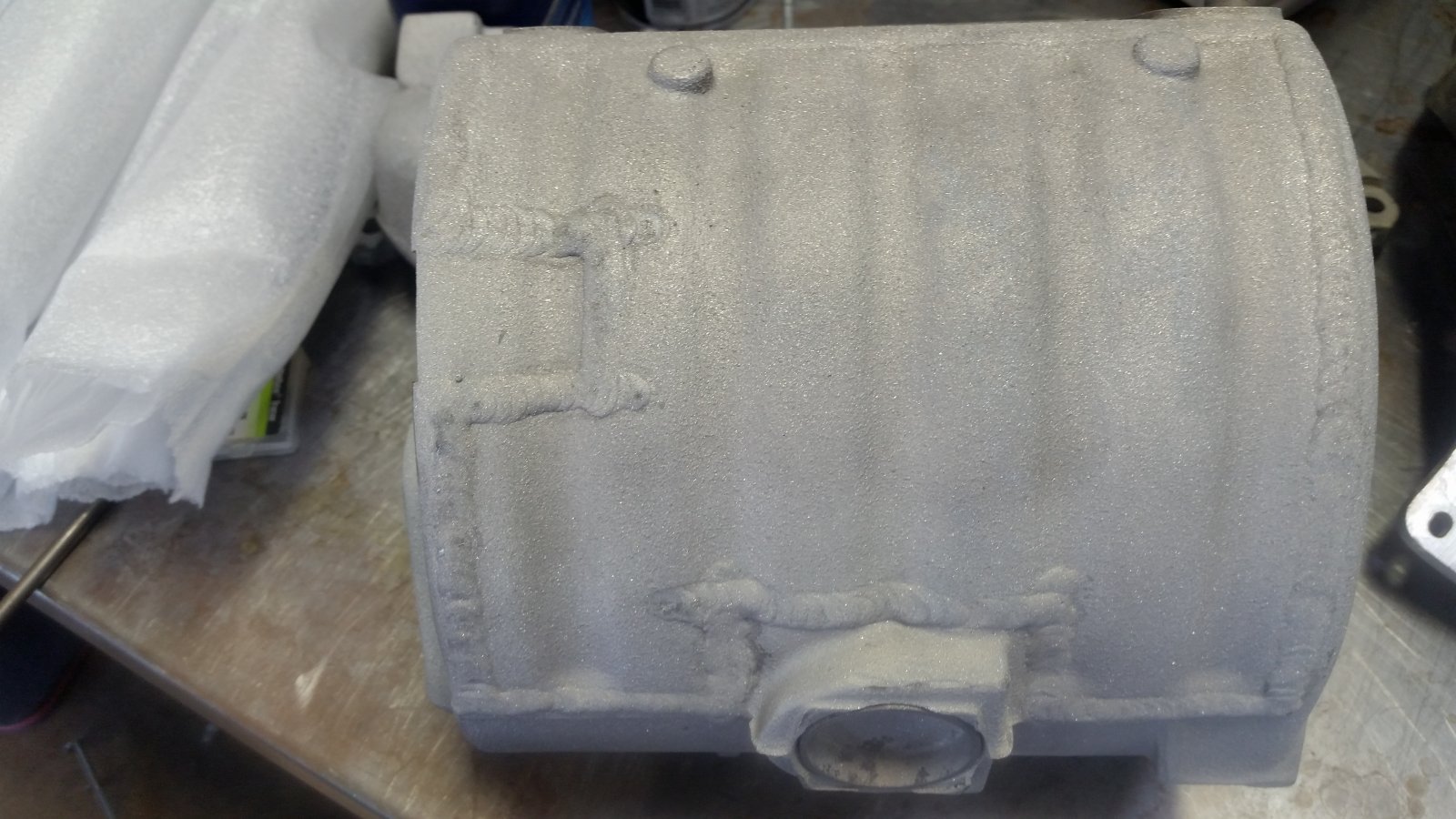

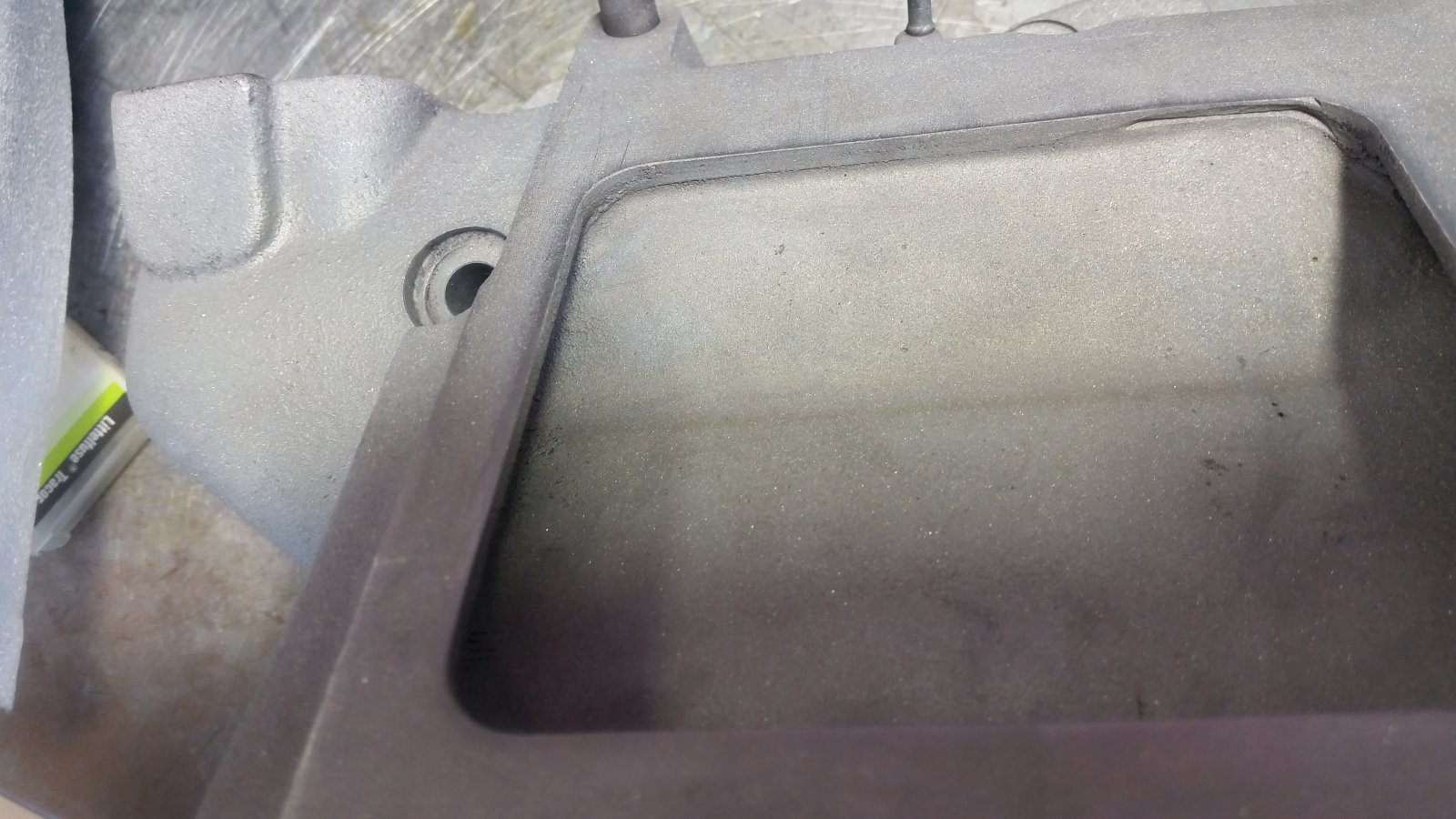

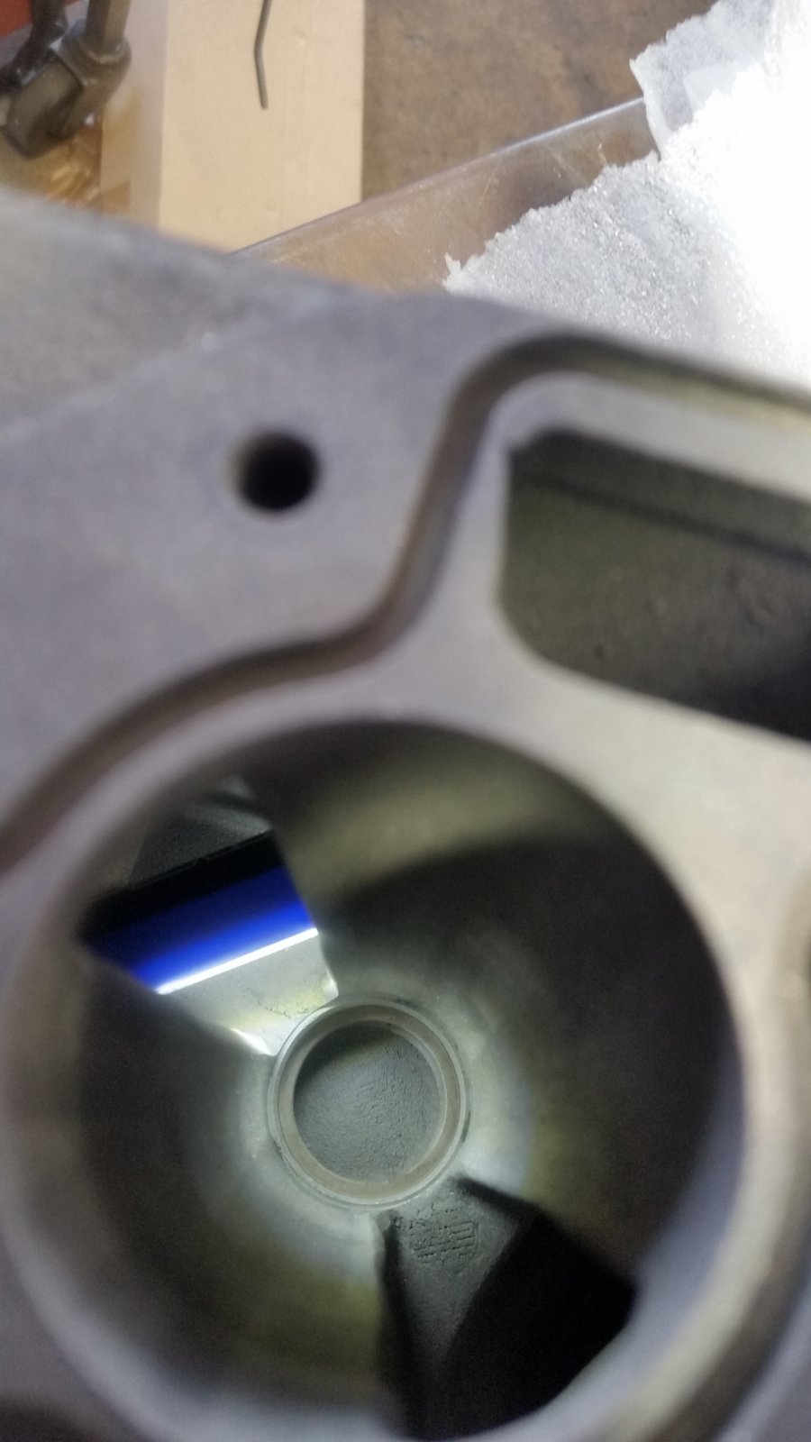

Received my intake manifold back from being ported. The open up the intercooller tube slots to 15mm and radius them, remove the bump for crankcase vent that has been plugged off since the start. As a modification it is not the most power increase for dollar spent. Just inceases air flow. And reduces power needed to make boost.

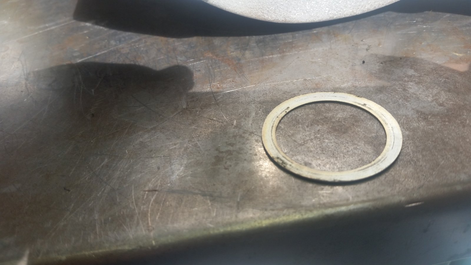

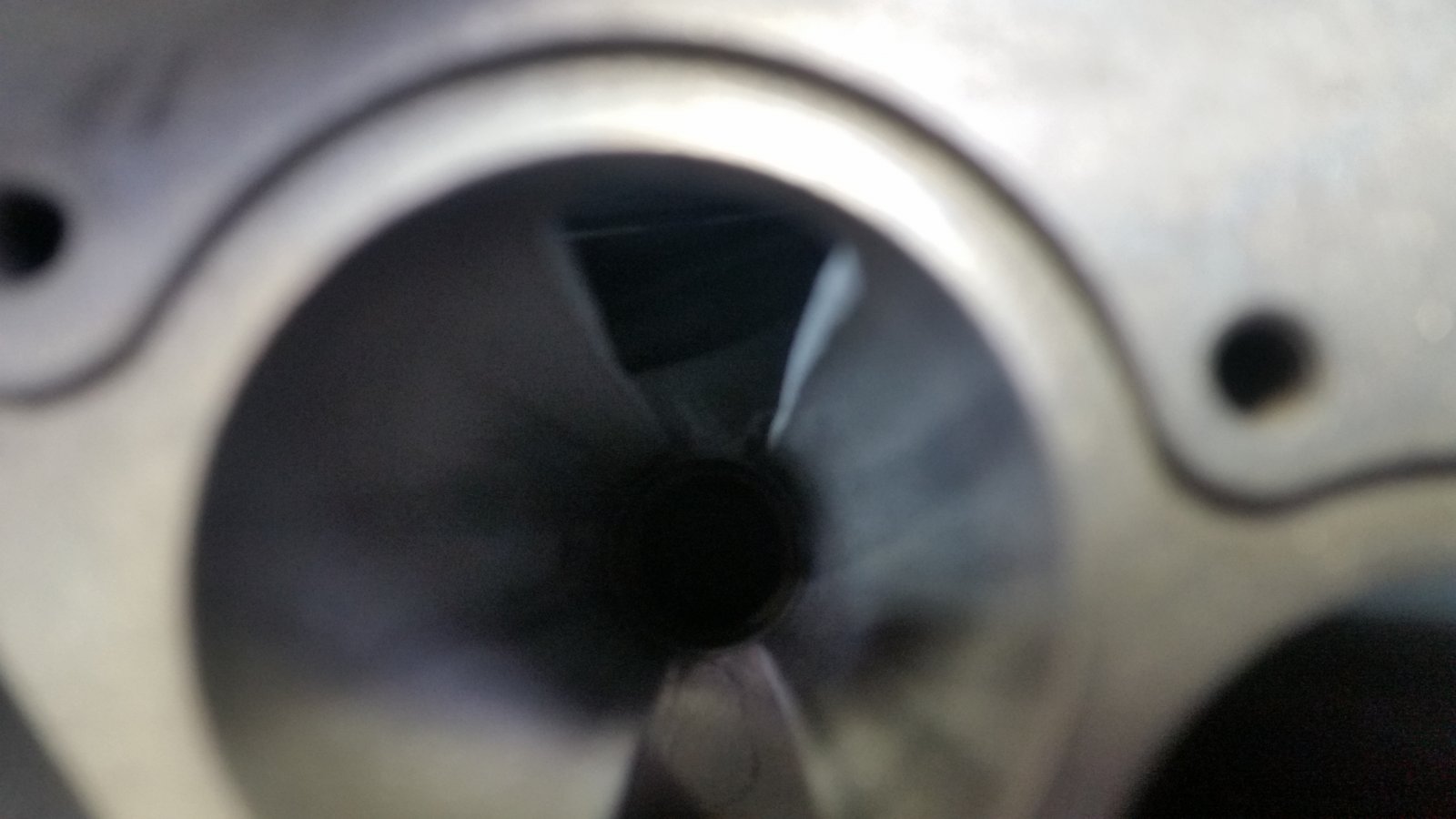

Thought would have Goblin up and running this weekend but issue have con me up. On the intercooler it came back one lare washer for intercooler tube. GM says it only comes with a new manifold if I do not find one will have to make something.

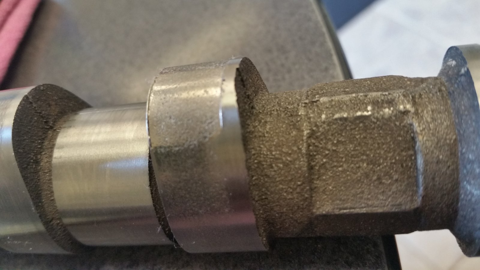

When installing cylinder head found one exhaust lobe failing,contacted ZZP about warranty they have responder but no word back.

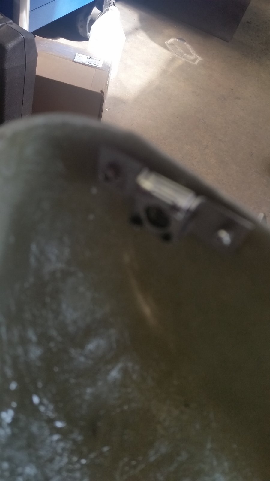

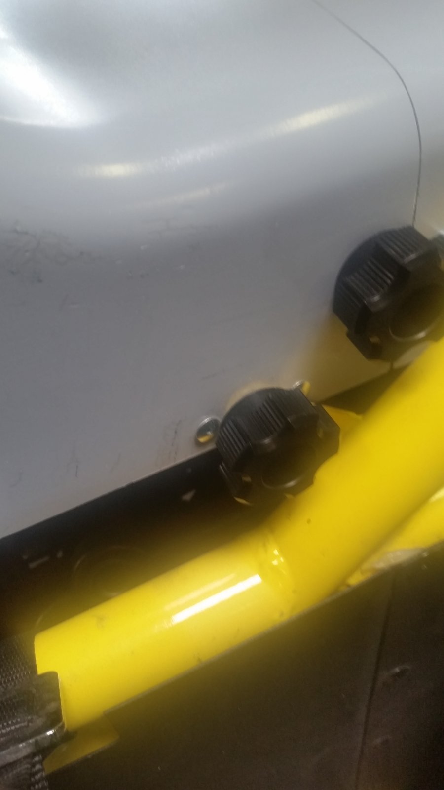

Since having issues with reassembling engine I worked on rear engine cover. What I have not liked about the covers is it takes tools to remove it. So install nut plates at the front and used threaded knobs to hold in place. front is done still engineering the rear. Cut about 3" off the end of the engine cover at the back to make installation easier. Knobs are maybe a little large but do the job.

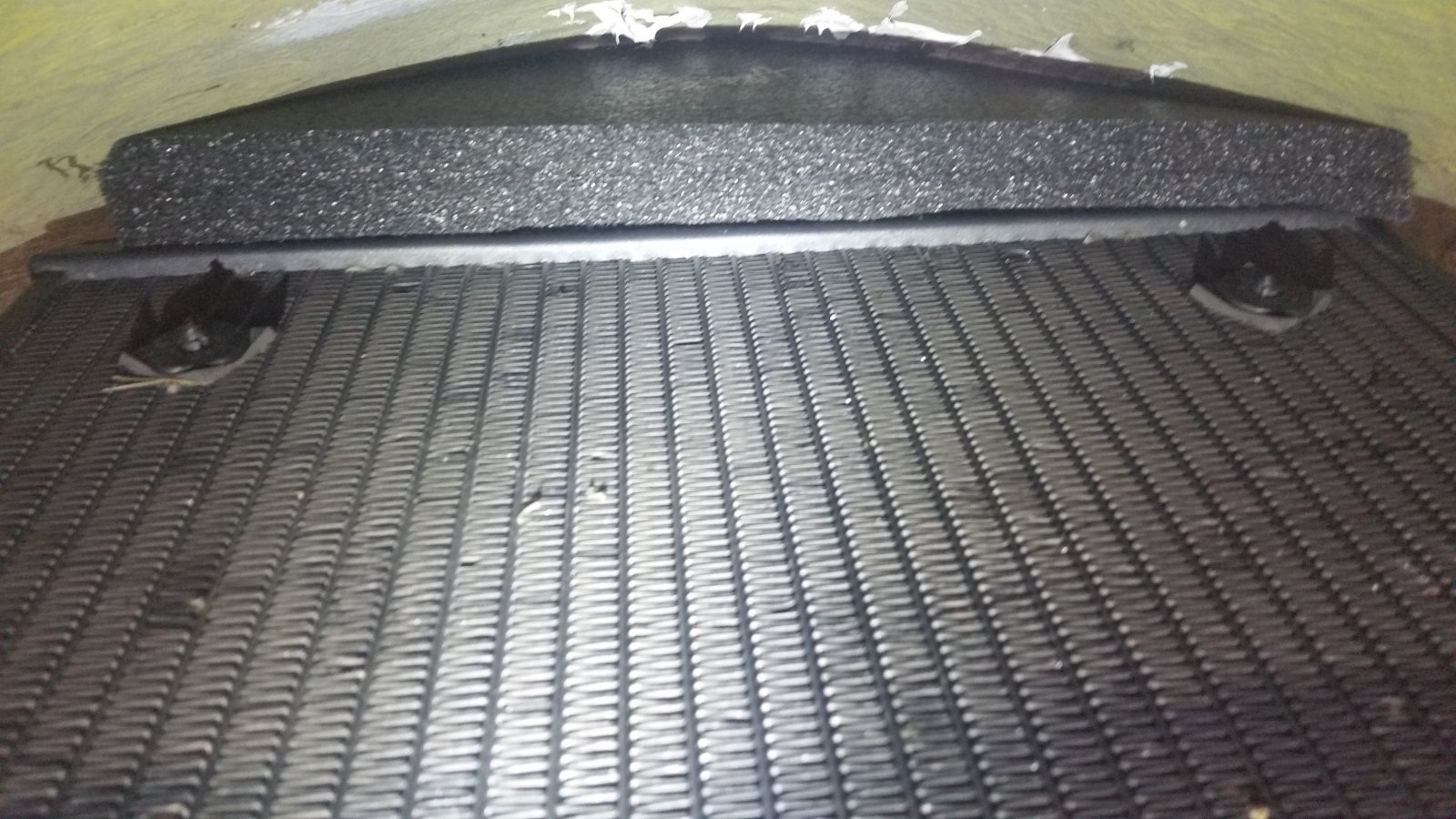

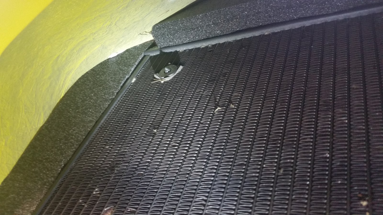

Still waiting for my cams so made an air blocker for the top of the radiator. Glued it to the hood. It is designed so that the hood can be removed with the air blocker attached to the hood.
Brad
That is almost exactly what we are planning to do with foam! We are debating between 3" and 4" and to have it in 2 places - around the radiator like you show, and the front foot wall (firewall?). One to force the air through the radiator like you and the 2nd one to prevent the hot air from going straight through to the driver/passenger feet area.
What thickness foam did you use?

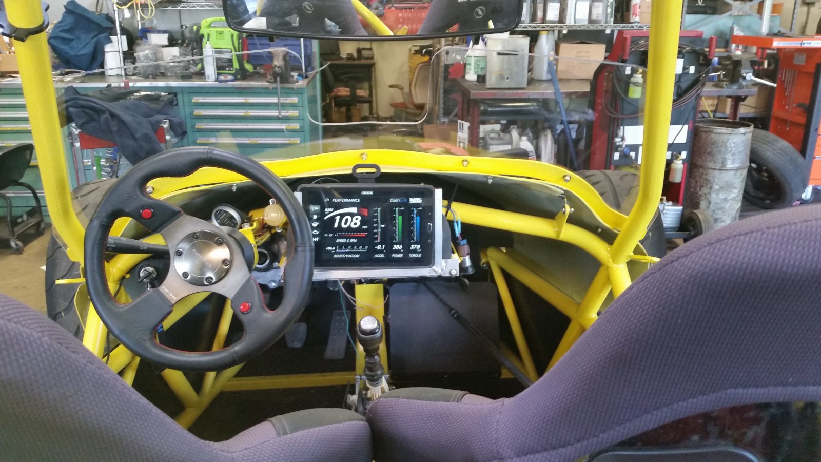

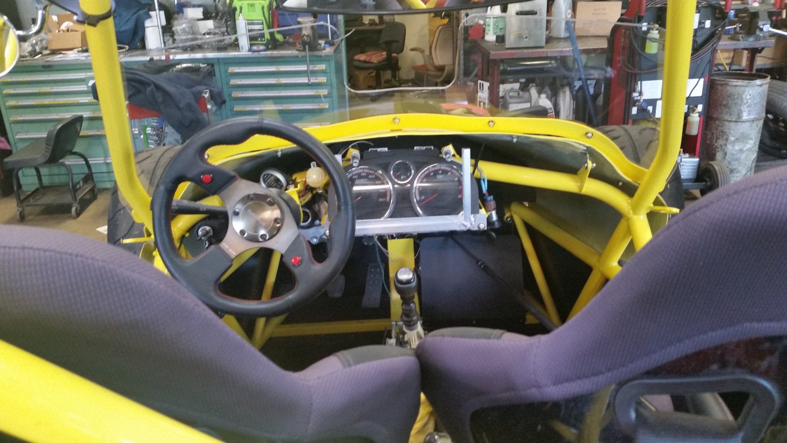

Finished mount for tablet to run Auto meter Dash Link. The tablet just slides in and out
No fancy just usable.

The cut in the windscreen worked well good air flow through the center, a little less engine heat, will install engine cover later this weekend.
