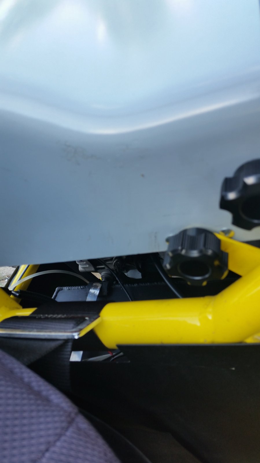

Test drove long way home with engine cover in place. Not satisfied with results. Back ground have front firewall and cut down windshield (ckeck earlier posts)
Hot air comes out the slot in picture. Will have to make a filler for gap.

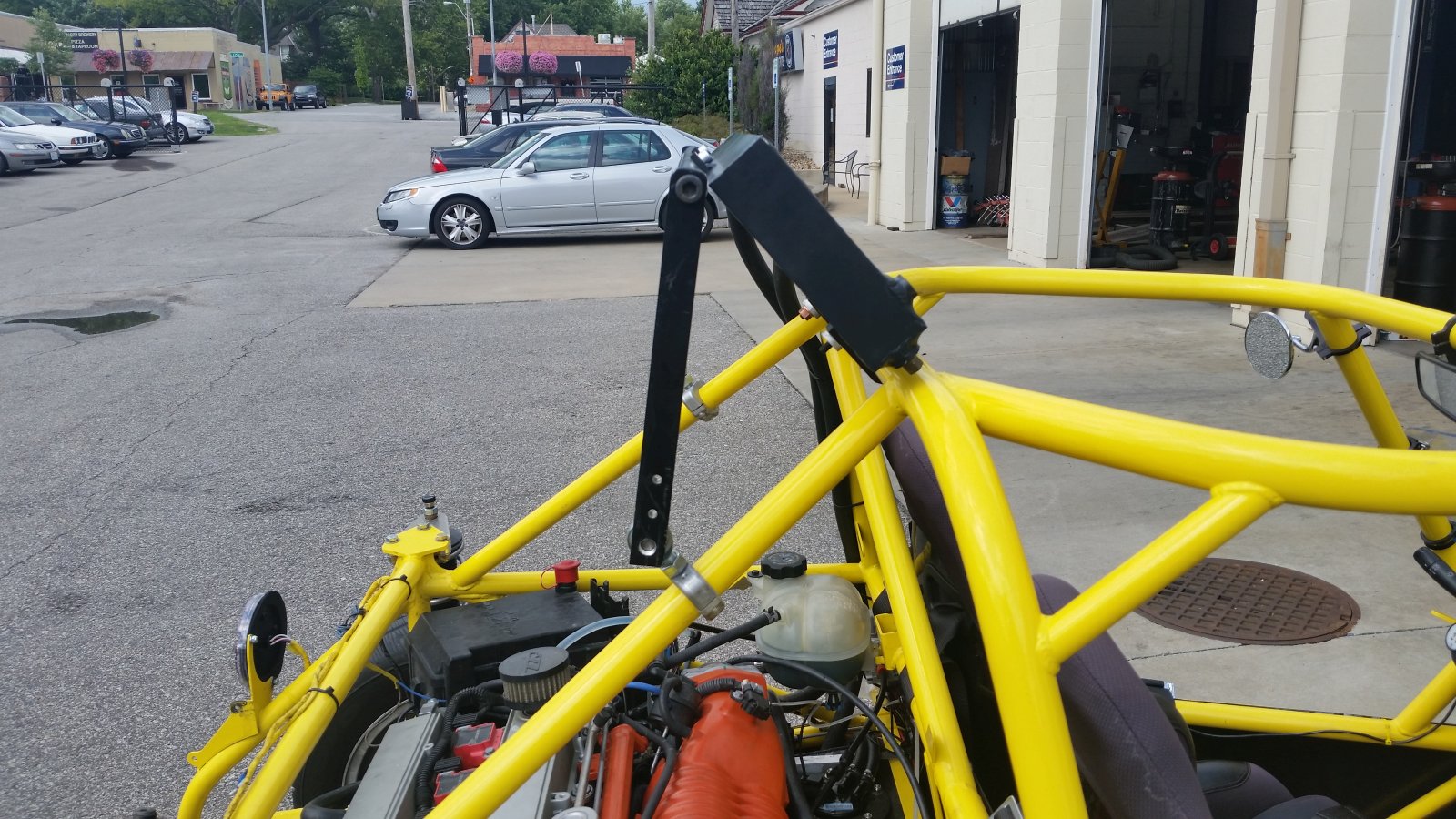

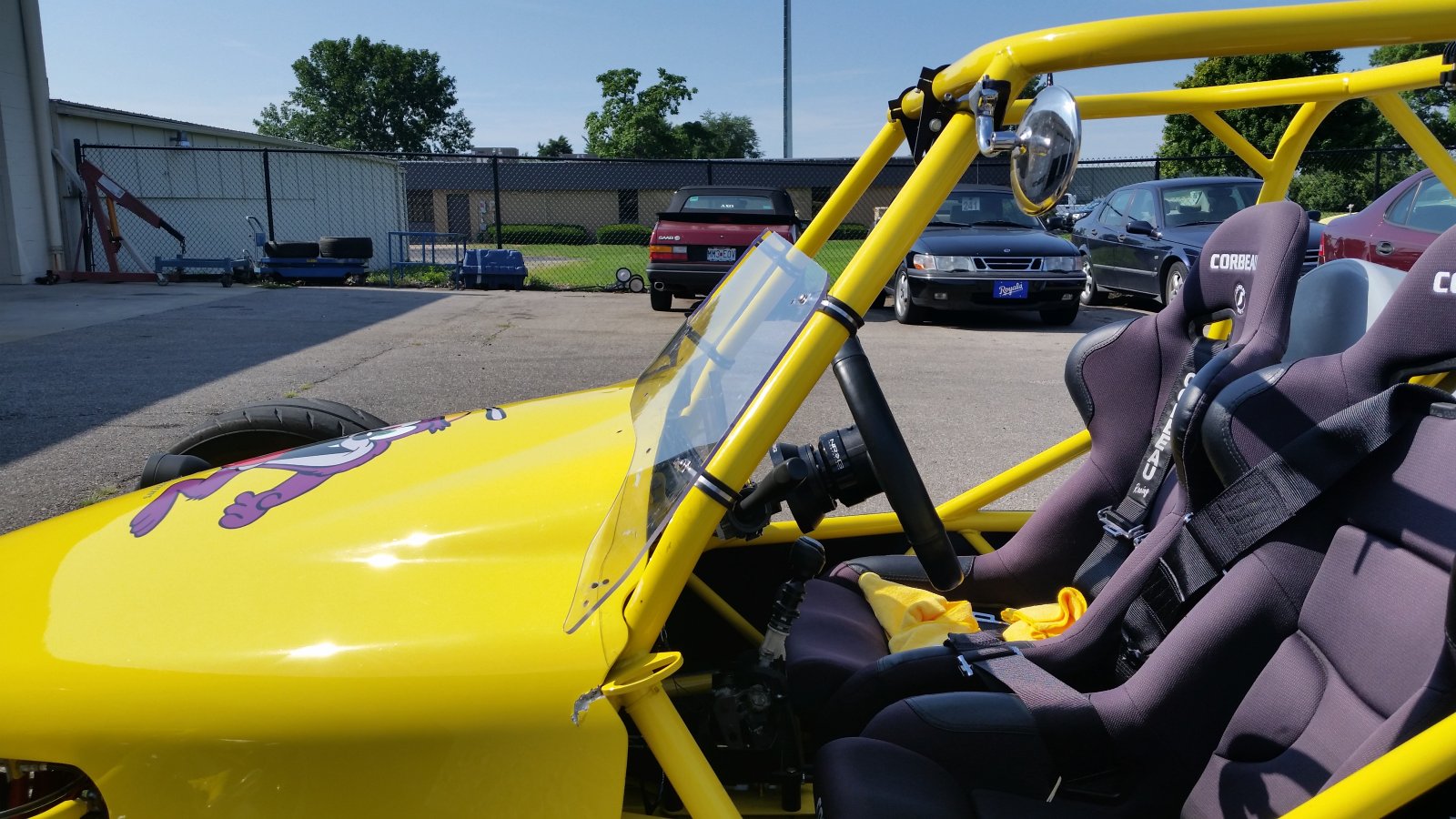

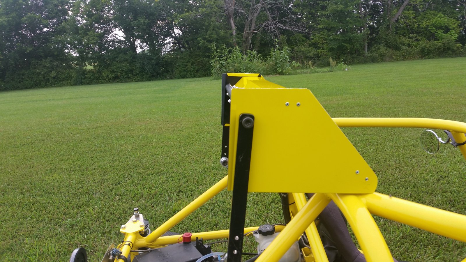

I have been struggling to get the windshield at a better angle for aero dynamics. When installed as designed could not touch the air stream with my arm extended as far up as I could reach. bent the mounting bracket back as far as possible better but still to high. This morning attached windscreen directly to the roll cage. The air stream is now just above the top of my head. This is better for me.

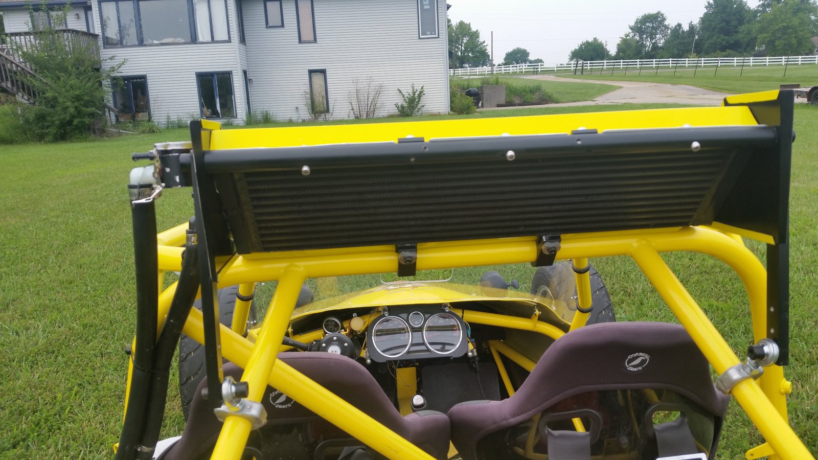

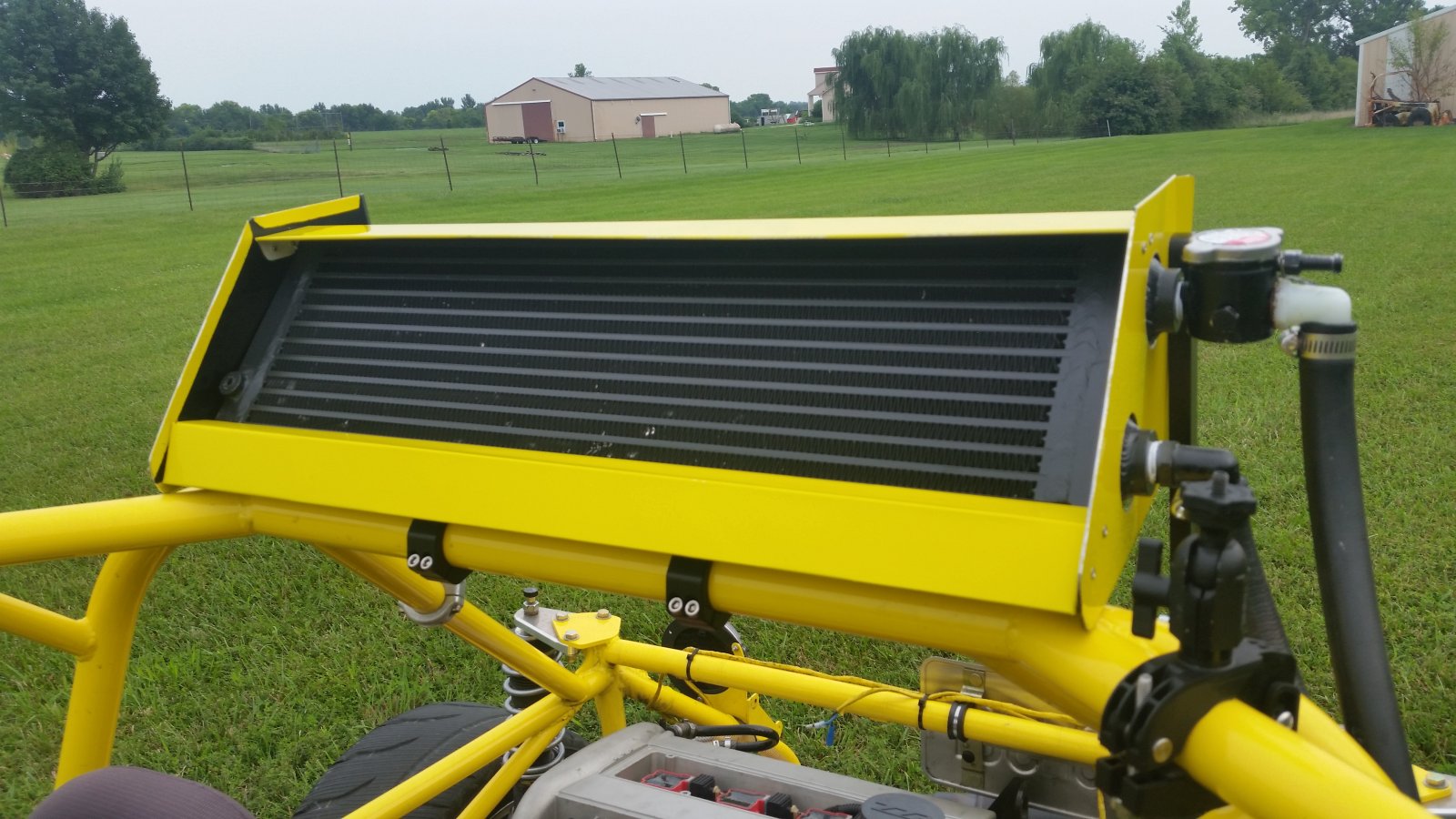

This is wrong on so many levels. After i put the engine cover panels on attached tuffs for yarn to see the air flow. The air was flowing from the back for the car forward that meant heat from the exhaust was heating up the heat exchanger.
I do have water injection so no damage done. The heat exchanger is now in the full air stream. This does create more wind drag but will try it this way for a while.

The rain let up enough to drive the long way home that includes twisty county road. The new windshield angle reduced the engine heat coming from the back forward. Next will reinstall the engine cover and retest.
Tested heat exchanger temp got to 130F with air temp 90F at 8000rpm full power. Will make fences for the heat exchanger to increase efficency. I am sure the potion of heat exchanger will effect top speed.
Installed 125# springs in rear had 150's.
No bad effects seemed to hook up a little better on a hard 2nd gear hard turn with power.

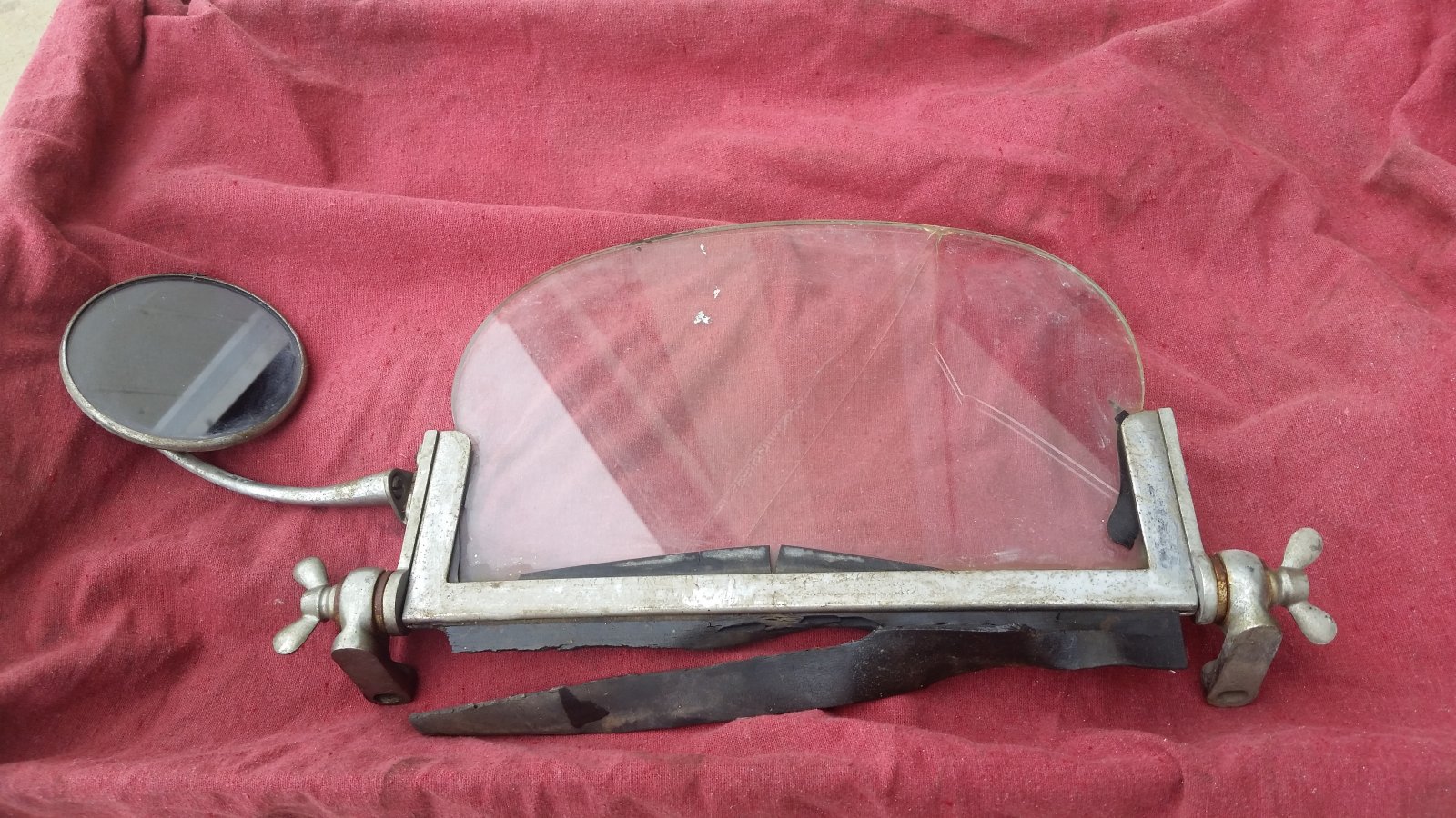

Did some clean in my barn and found the Brooklands windscreen. It has to be at least 50 years old.

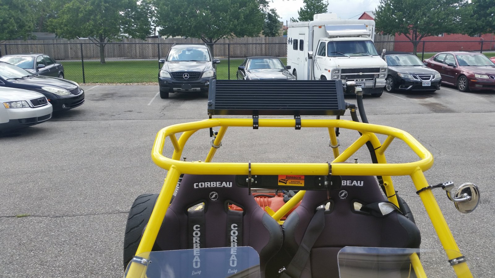

My neighbor made me some air ducting for the heat exchanger.

Yes, It helps direct the air through the heat exchanger. It also increases wind drag.
Brad
What about flipping it so it leans forward? I think you'll get cooling and a bit of downforce since the air will be directed upwards. Might need a scoop/shroud to gain significant downforce. Or a (very) high-mounted rear wing with an incorporated heat exchanger might be an ideal solution.
George
Thought about that. The way it is help put air down ward the engine to help fill the backflow from the exhaust. On as designed there is a large air backflow.
Brad
Silverback
My knowledge of aerophysics is limited, so this is entirely conjecture. I suspect that with the heat exchanger leaned back - and very dependant on the angle of attack - it has the effect of a downward focused nozzle, adding more air velocity below the HE. Despite its winglike orientation, unlike a wing a low-pressure area is created on the front surface, reducing downforce and sucking heat forward into the cabin. With it leaned forward, it would suck air (but not engine heat) behind it and away from the cabin. I'd love to see a tuft test.
