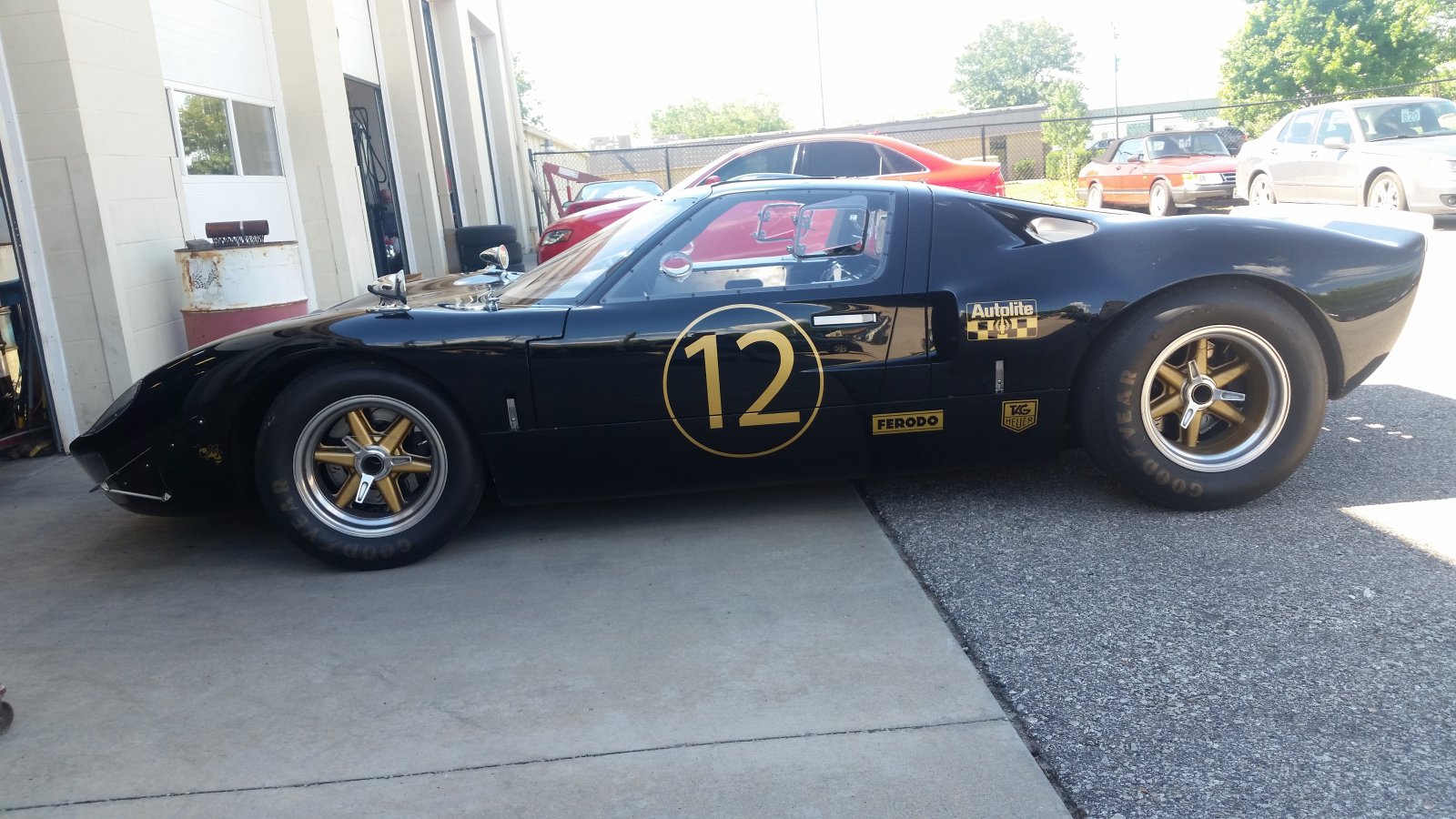

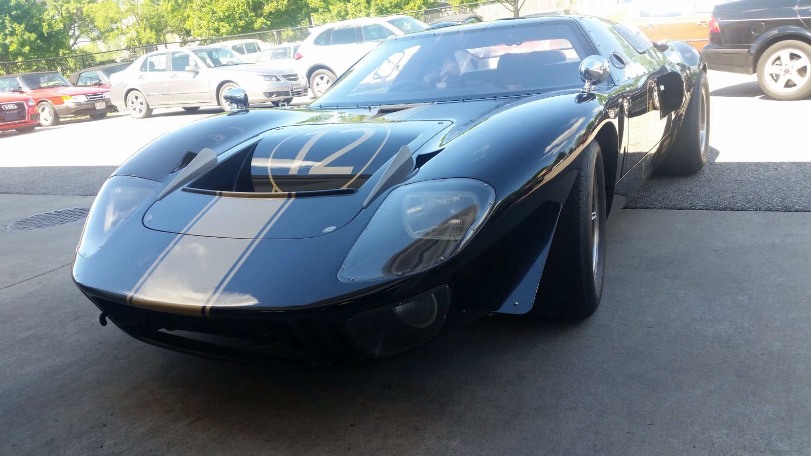

This little black 1966 Ford came in for service today.
Brad
Holy Moly!!!!!!!!
You cannot just leave us hanging like that. Did you get to drive it? Ride in it?
Who owns a vehicle like that and does not do the service them self?
What "service" did you do to it?
More pics?
George
I am sure it is faster than my Goblin. Most likely will not drive it (not flexible enough anymore). Just doing fluids and check over for a track weekend. The people that own cars like this spend their timing making money to have a stable of cars.

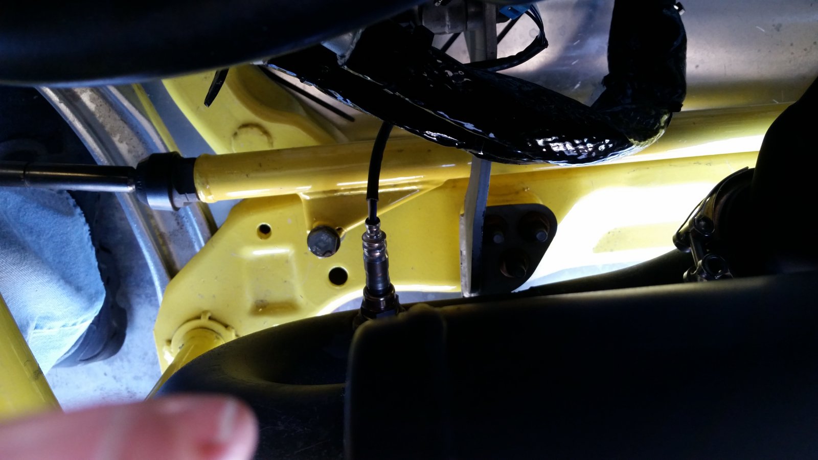

The foreward and back shift cable locked up making it non shiftable. The cause was heat from the muffler melted the inner liner. The reason it got that hot was I installed the engine cover, rear 12x36 spoiler and the lower air shield. All upset the flow of air.
When the cable is reinstalled will add a heat shield on the shift cables.

In the back of my mind that was of concern with the shifter cables. Sorry I didn't share that thought and you ended up verifying it.
George
Got to drive Goblin today. Shifter is 100% better that it has been for over year. Will see how long it stays that way with the heat shield. I would suggest any one building a new car put covering on the shift cables. and any one who seems to feel their shifter is stiff get new cables and cover them.

The more I think about it the cable may have been damaged the first dyno tune when car was first assembled

Melted another shift cable so going to remove rear lower air shield for now and replace cables. May do something different
over the winter.

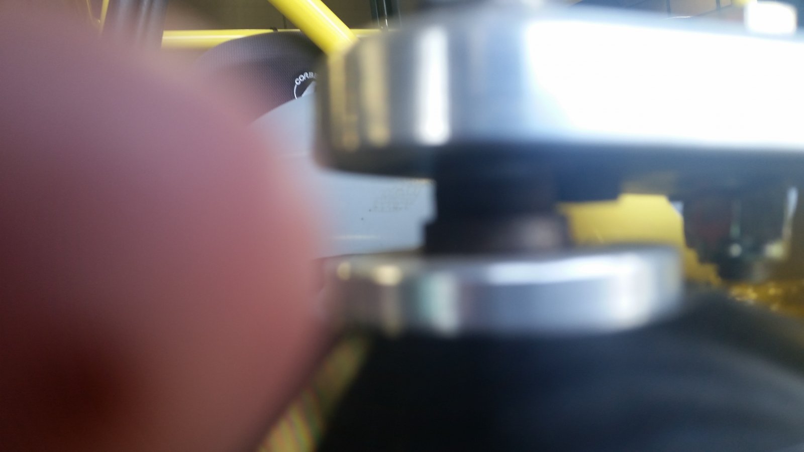

Waterdriver
over the winter.
Brad
Curious, what brand and size shielding had you used? Maybe needing a thicker material? Like what's used for fluid lines, adding a reflective heat shield covering over it?
George
I used some for lines and spark plug wires. the lack of air flow may be the issue. Over the winter going to make a stainless steel heat shield lined with heater wrap for the muffler that is next to the cable and add and air dust to supply air to the cable before reinstalling lower pan.
