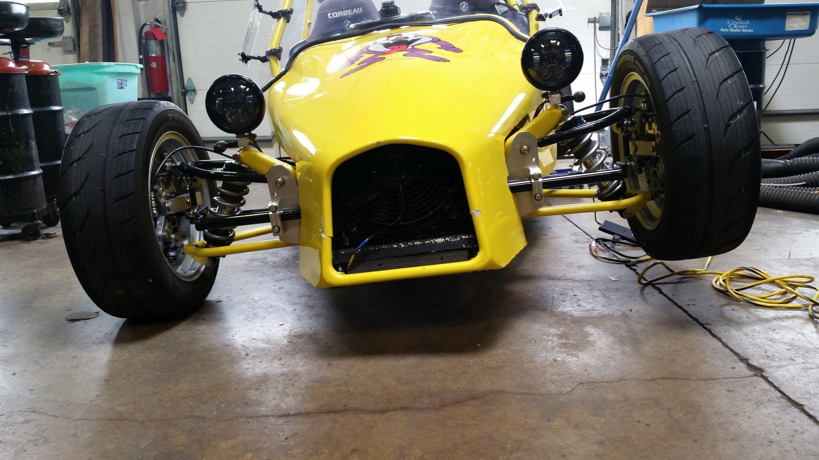

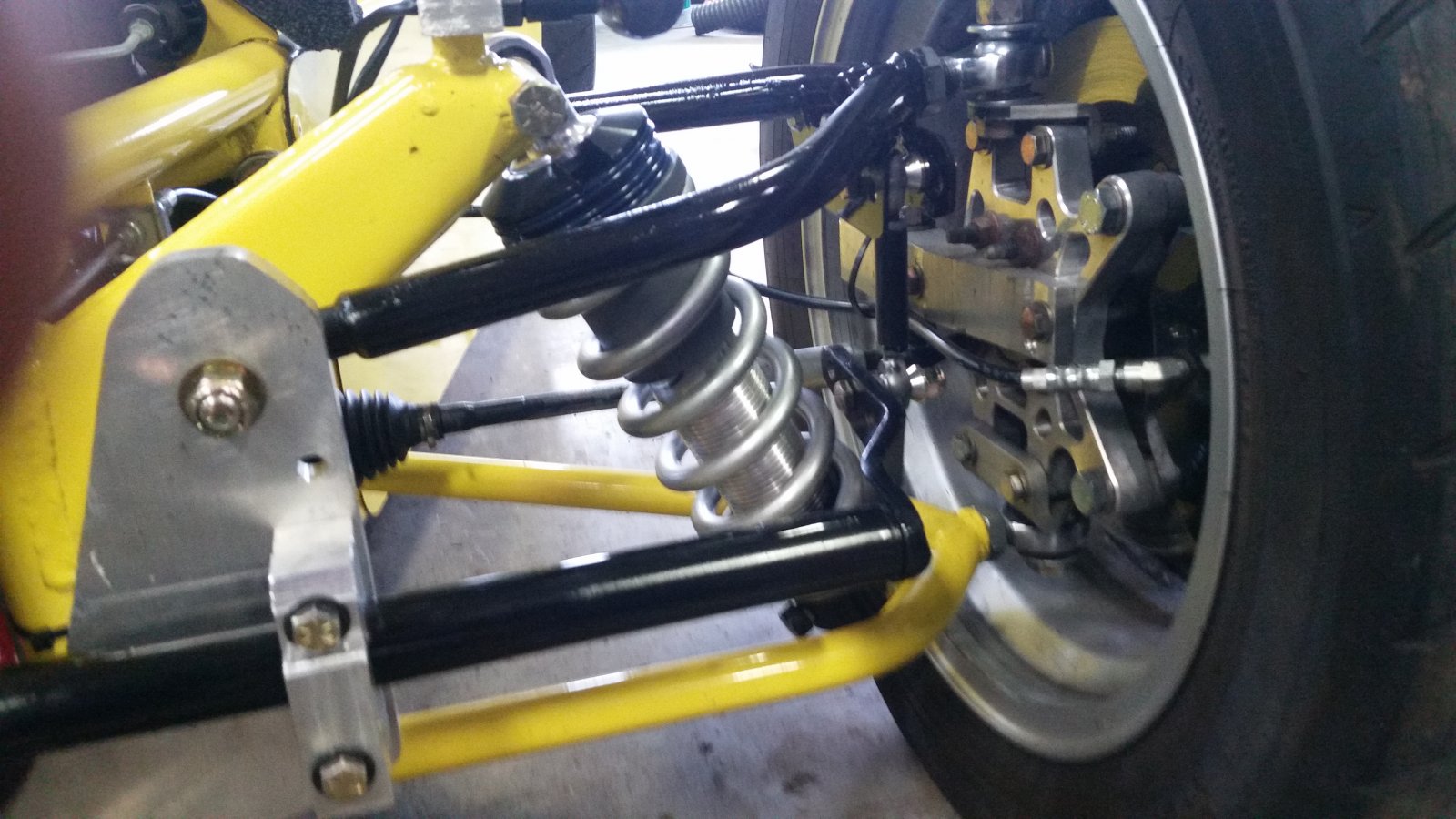

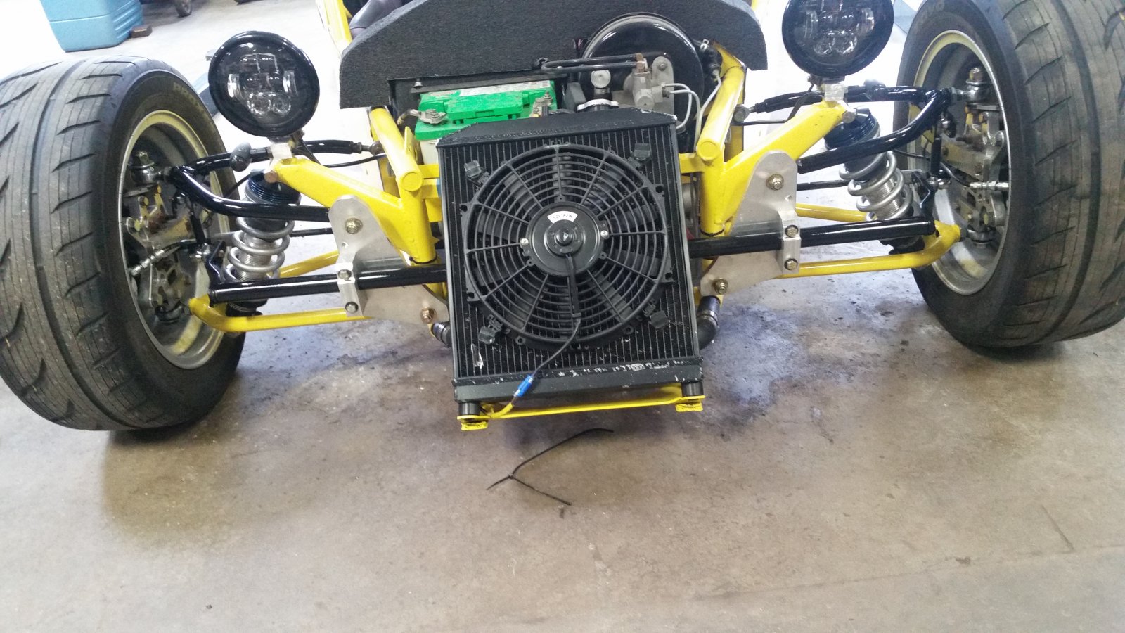

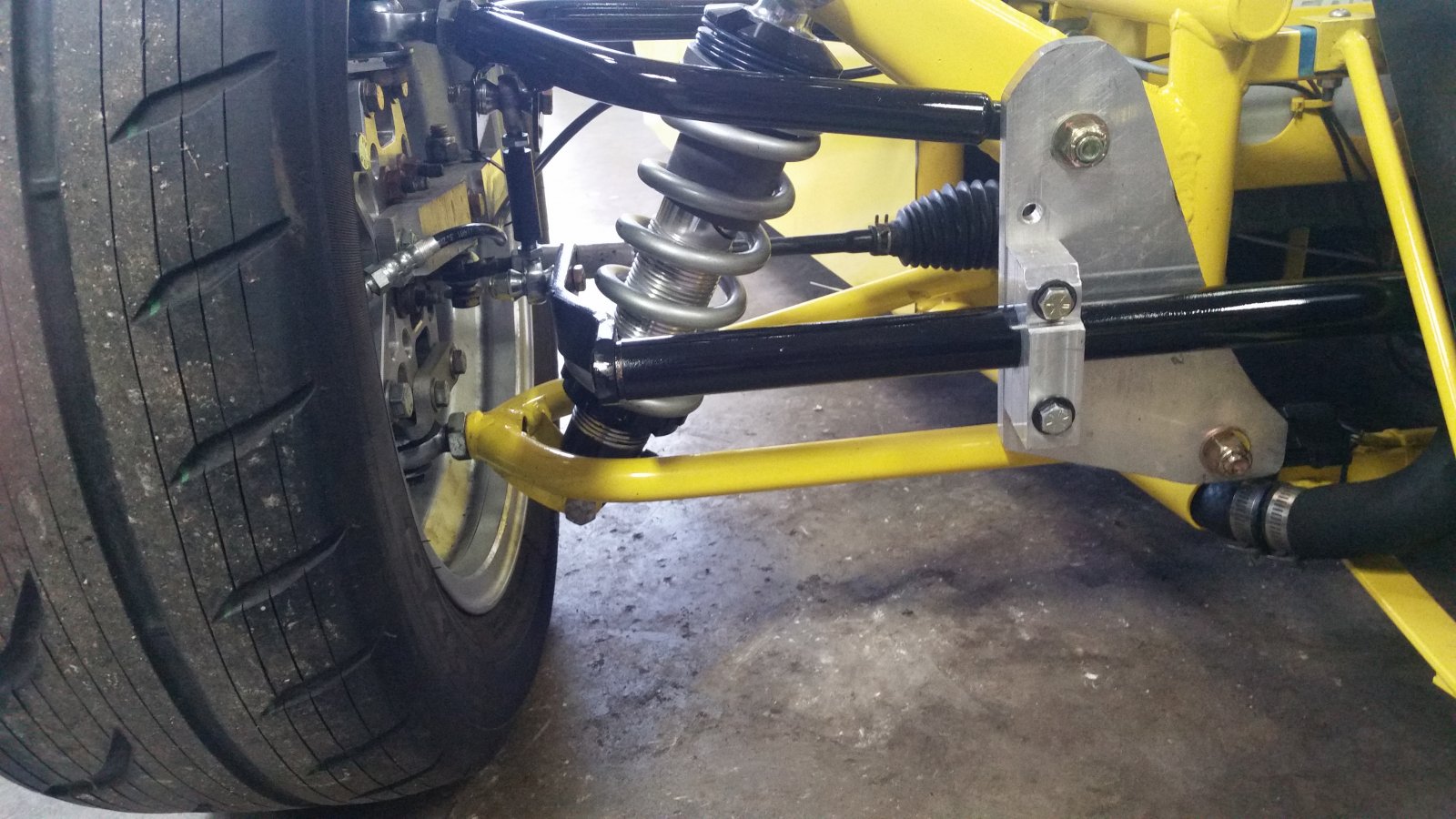

Redid my front sway bar for better wheel clearance, Shortened bar and made off set arms. Need to do a little work on brake line clearance. The bar is 3/4", 43" active length with arm length settings of 6", 5", 4". This gives me a WHEEL rate of 172# per inch of wheel travel at the 6" setting. 247# for 5" and 383# for the 4" setting. Last year I ran about 150# per inch setting this year will start with 247#. The front springs are 500# to keep it from bottoming out on hard braking with autocross tires.
Also redid the rear suspension. removed the extended length rear uprights that I had made for better camber gain at
a lower ride height. Installed stock ones keep the ride height but lost camber gain. This will give me a lower roll center that may help transfer more weight to the outside rear tire when cornering. With the heavy sway bar it may lift the inside front tire off the ground so may have to increase rear wheel rate to balance the car out.

Brad,
No contact with inside of the rim at steering lock? No interference with the bottom of the shock or spring at full droop of the suspension? I noticed the swaybar is moved lower than it was before (I think from earlier photos?) to below the centerline between the upper and lower control arms - does this make a difference in performance? The bracket mounting plates look pretty stout, are they 1/4 inch aluminum plate? I have been trying to keep track of everyone's suspension setup and interested how swaybars have been helping (or not) with suspension performance. Keep the info coming, please! :)
George
No contact with wheel rim now.,, car has 16" wheel with 18,s it would have cleared. And no other contact other than brake hoses. The plate is 1/2: 3/8 should be enough.
The bar height has not changed. Earlier in this winter had move the bar behind plate to clear the rim but it did not work out.
Brad

On making of my front sway bar. The mounting plates are mounted to the upper and lower control arm mounts. Had to use spacer washers between place and heim to clear control arms.The plate is 1/2" aluminum. I wanted to attach the bar to one of the control arms as far to the outside of the control arm as possible to keep form bending the control arm. Since the bar is 3/4" it needed support at the outer end, to keep bar from flexing. The tube the bar sets in is 1.25" tubing with bronze bushings on the outer ends. Used bronze because the arms are welded to the bar, plastic would have mented. The arm are 3/8" hot rolled 1.5" wide and bent to clear the the springs with adjustment holes 1" apart. The upper arm attachments of 1.2 X 0.125 plate with three adjustment holes 1" apart. The links are 3/8" heim with aluminum adjustment links.

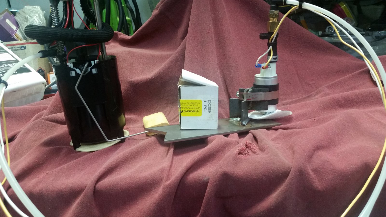

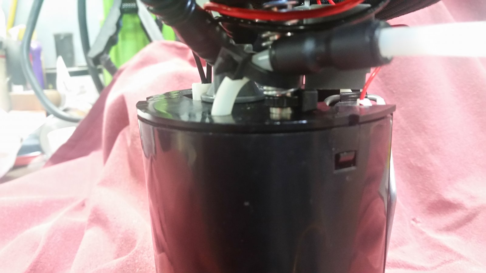

When my Goblin fuel tank gets down to 4 gallons and making a hard sweeping left turn the car starves for fuel.
So I am adding a prepump to keep the fuel pickup canister full. Now to install and test

With the pump on the driver side, it makes sense you would see it in a left hand sweep.
Airplanes setup for acrobatics use a"flop tube" so they can suck fuel inverted from the top of the tank. Probably not a simple solution like that for us here.
I guess having a long skinny tank mounted transversely like we do in the Goblin is not the ideal shape for this acceleration case.
I assume the prepump has enough capacity within it and the feed hoses to get the engine through the momentary starved condition. Did that affect your choice of hose length?
Or, your choice of position in the tank?
I would love to hear how this addresses the problem for you, George.

Our 2005 mr2 did that if we ran it under 1/2 a tank right after a hard long sweeper it almost felt like it was going into limp mode.
How are you going to mount it? Is it going into the same hole as the fuel pump and pushed over to the right side of the tank ?
George
The pump should have enough to keep the canister overflowing as long as the pickup has fuel. the pump will only be moving volume so it should keep it has on other cars it has been used on. The tube length and size should work for what it needs to do.
The pump plate will set on the floor of the tank. Will slide it to the far right and use a 35# magnet on the outside to hold it in place.

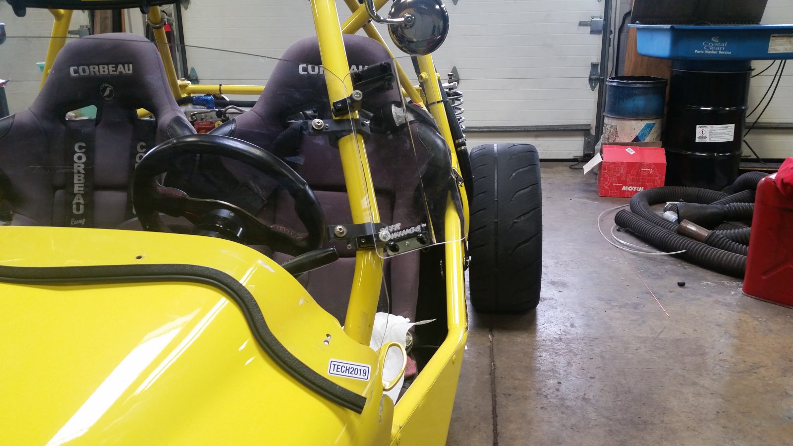

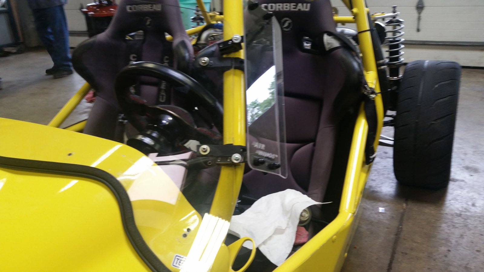

Have added some Air Wings to the windscreen to block air flow into the passenger compartment or add air flow

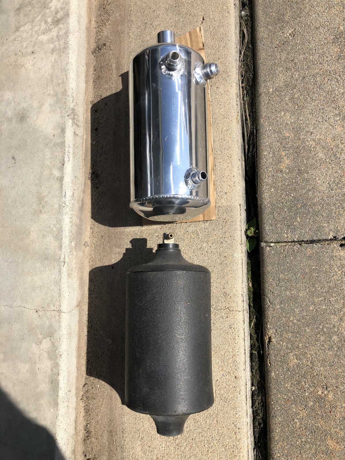

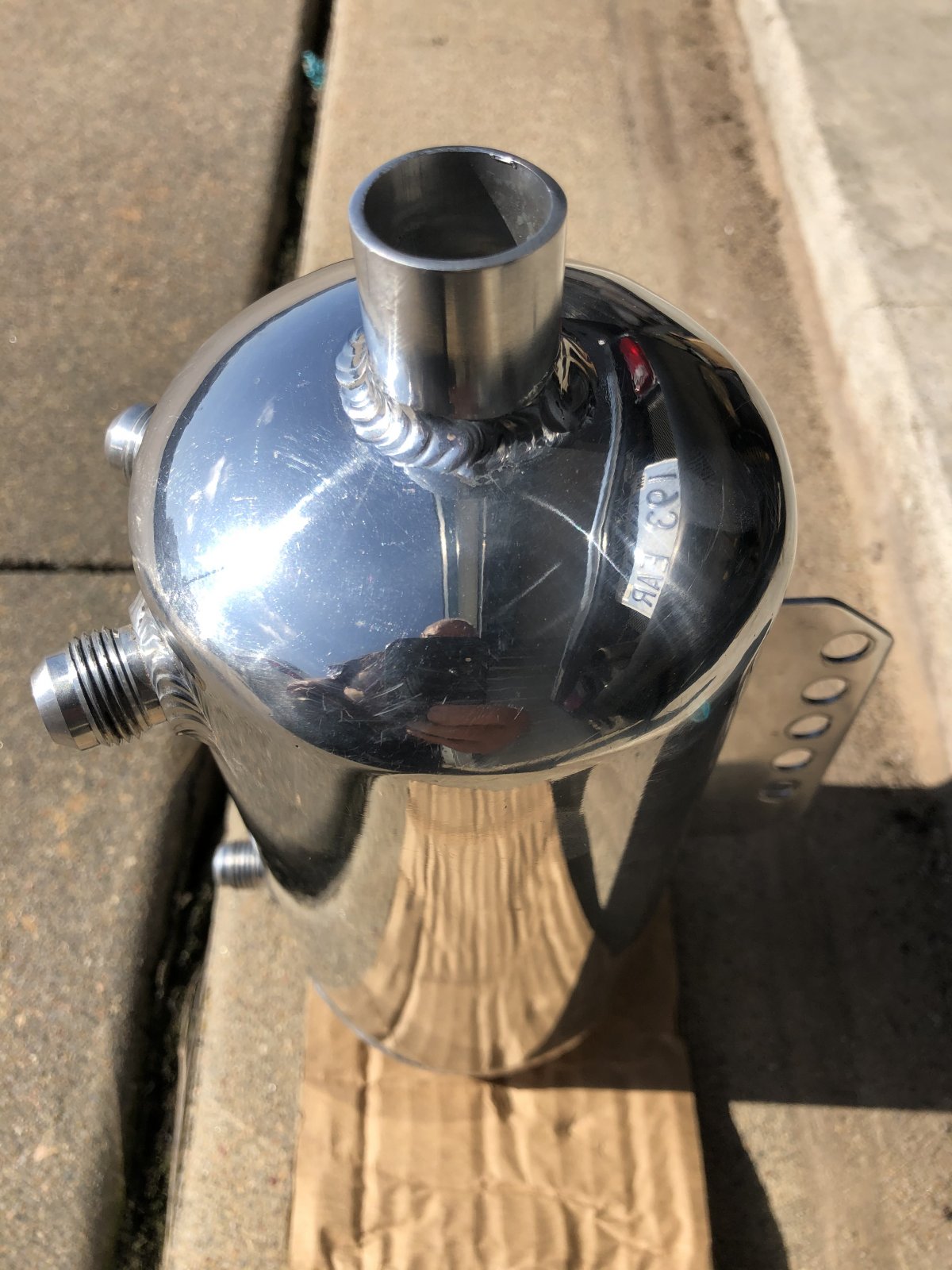

George, I have a small catch can/surge tank if you would like that I can bring to the Arkansas meeting. Would this hold enough fuel to get you around the turns.
