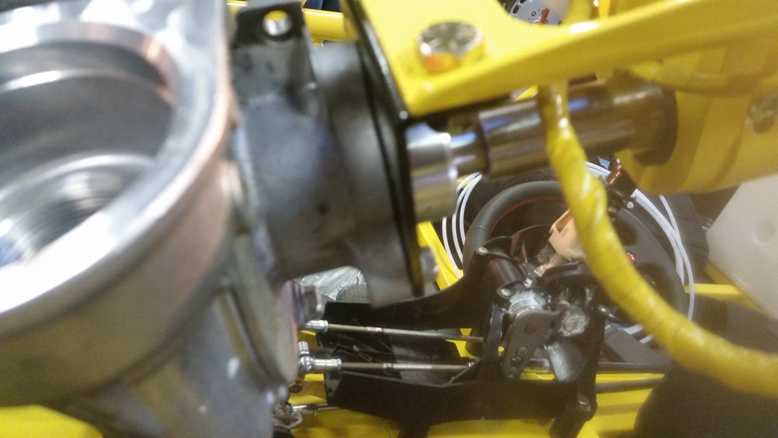

Brad,
Your fourth picture of the solid transmission mount looks like it has been cut and doesn't line up. Am I looking at it correctly?

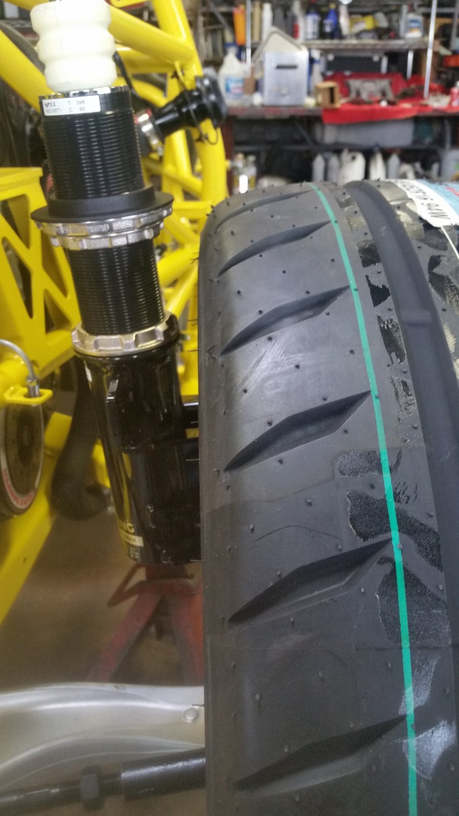

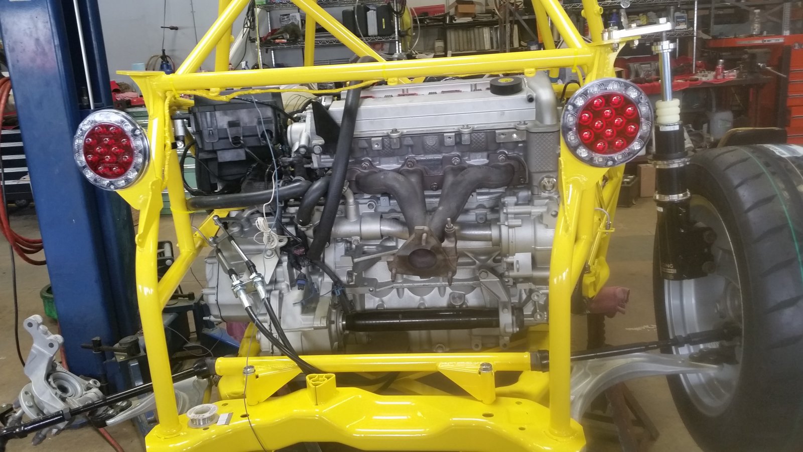

End of another week. Not much progress finished hooking up and adjusting items that had been installed. Installed and wired tail lights. Received brake rotors and other items. Mounted two rotors and wheels.
Brad

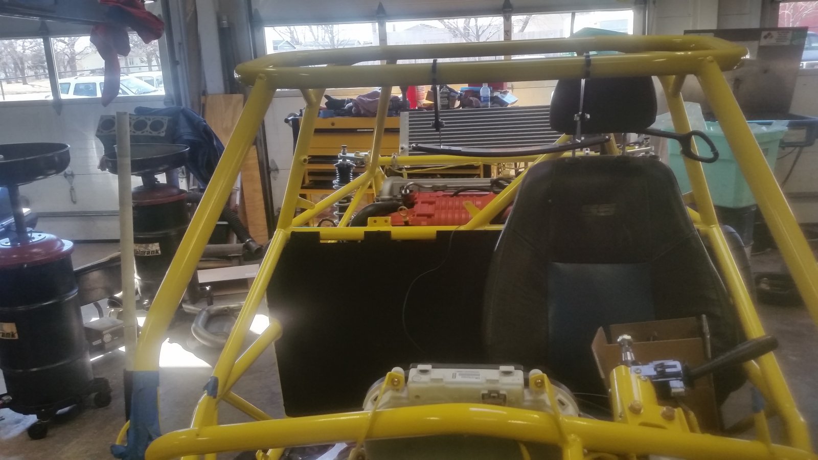

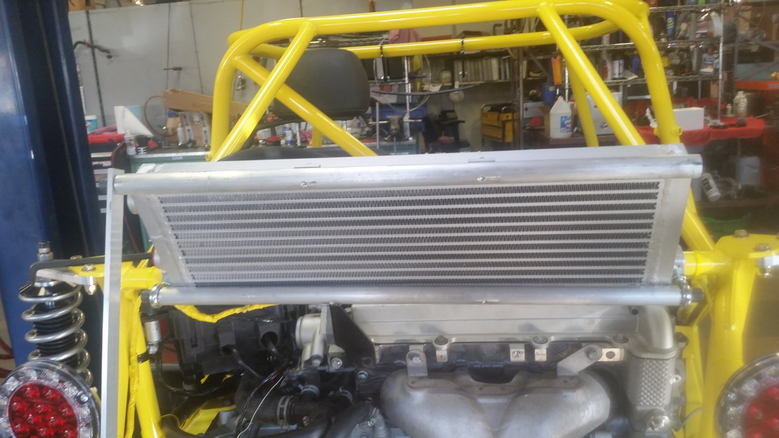

Question to the collective. Thinking about using a 24" x 12" heat exchanger mounter on the rear bar as a whale tail.
it would not function a 100% for either function but might do a good job of cooling and give some down force. Air fences and air dam could be added. also make it adjustable for angle.

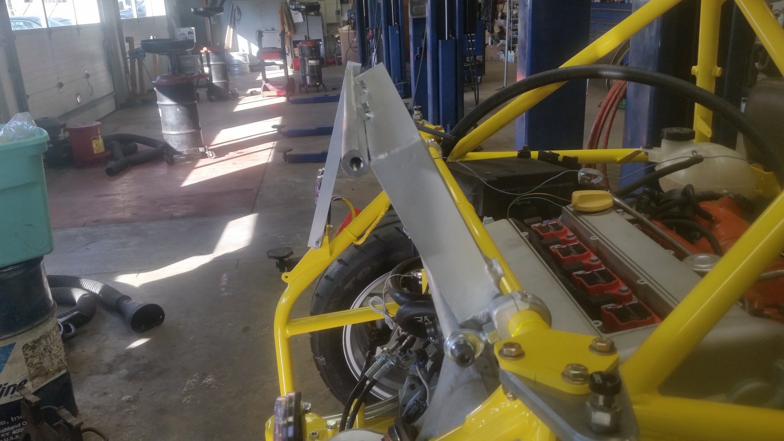

Worked on mounting heat exchanger, it is adjustable for angle.

I REALLY like that intercooler! I know it may be in the way but this car doesn't have a windshield mounted rear view mirror. I don't normally look over my shoulder as I back trailers and such using only the side mirrors. Where did you get that intercooler, part number? How are you addressing the issue of the cooler being higher than the fill cap?
George
The heat exchanger is adjustable for angle which also changes the height of the rear edge. I found it on Frozen Boost. About $150.00. The fill will be on the upper cooler inlet
To add air flow a sheet metal fence could be added.

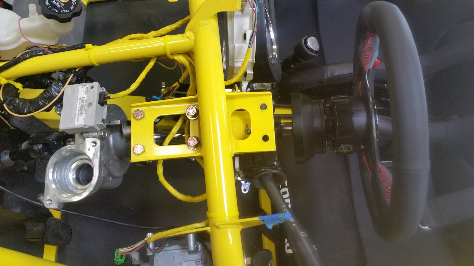

Install removable steering wheel. Felt the steering wheel was to close so moved it forward 3.75". Like this a lot better. Waiting for radiator and heat exchanger from being coated.
