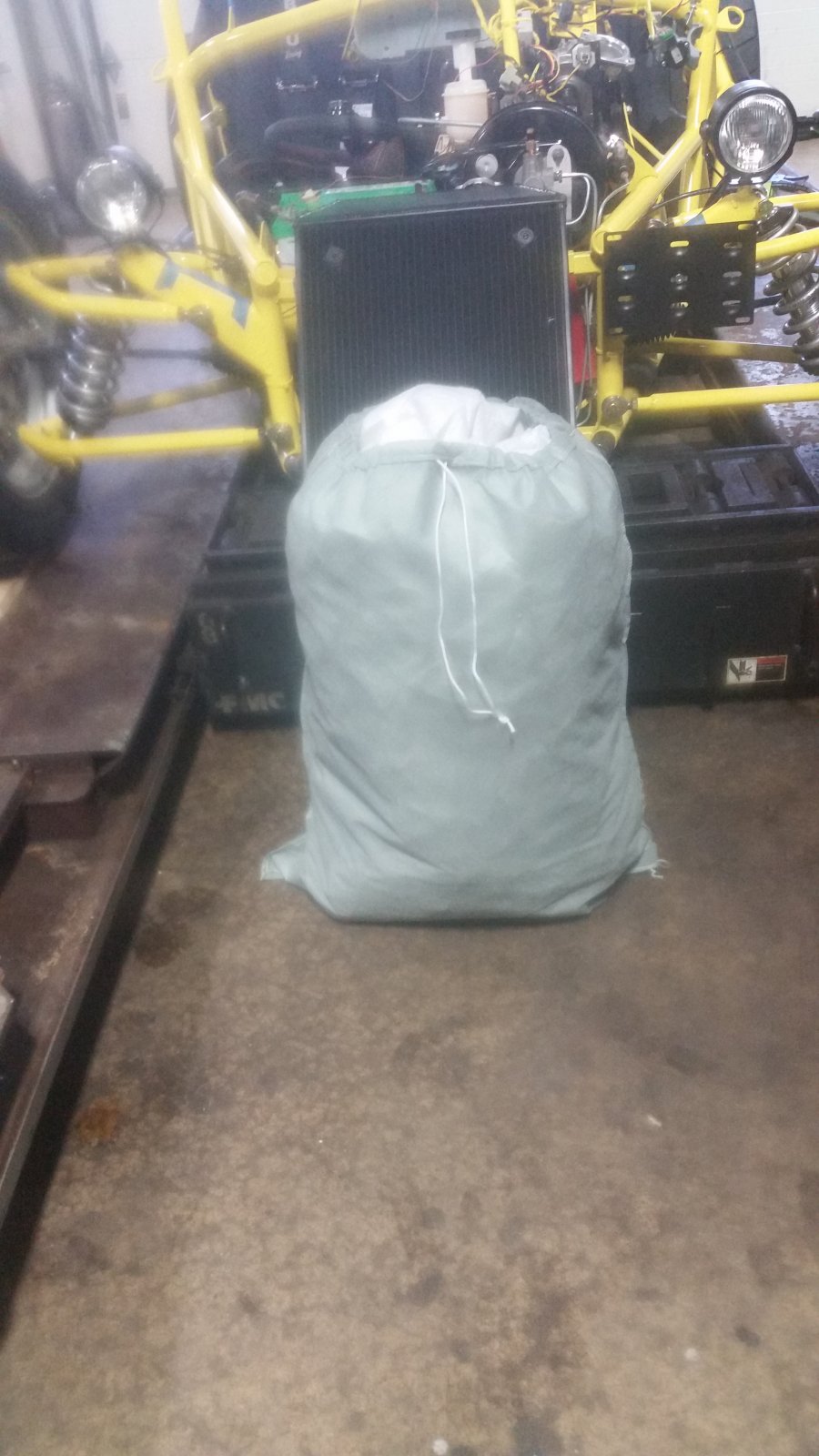

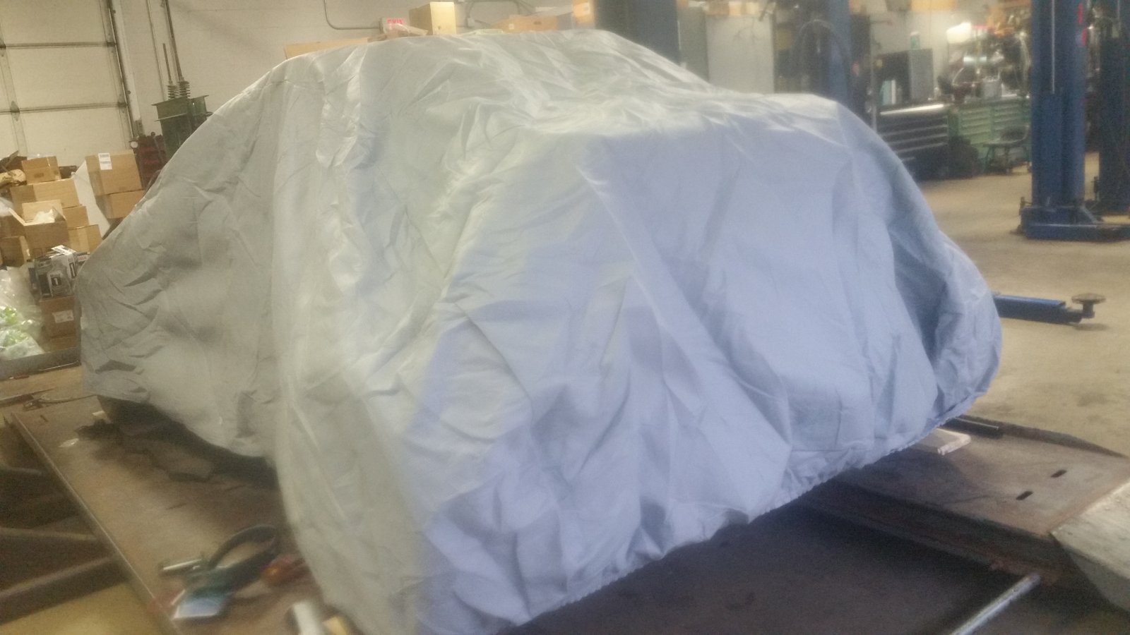

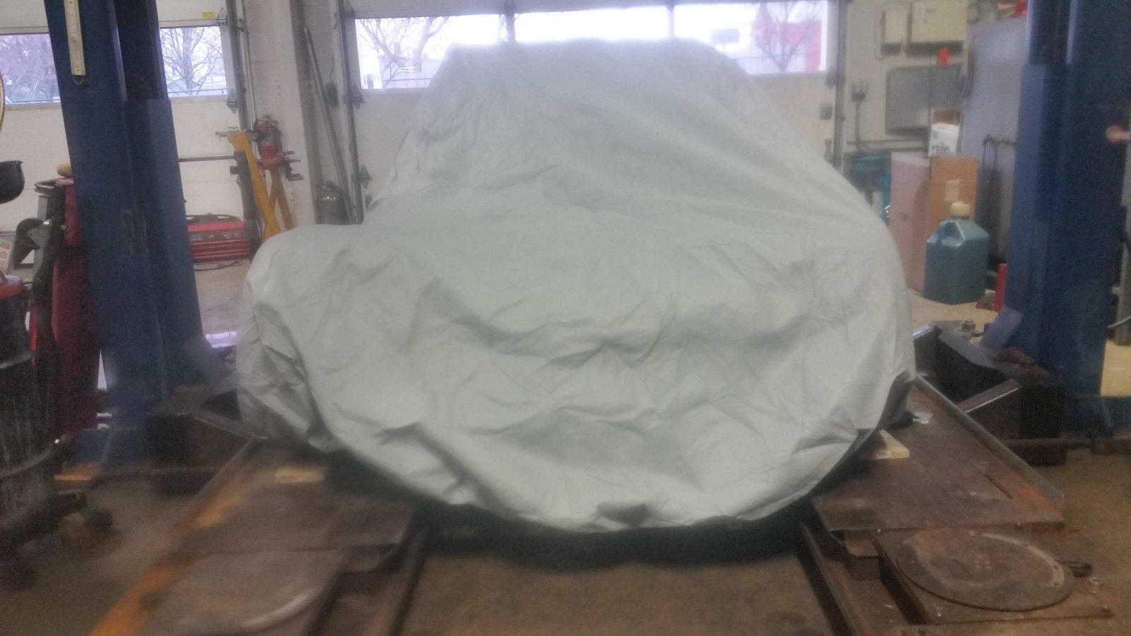

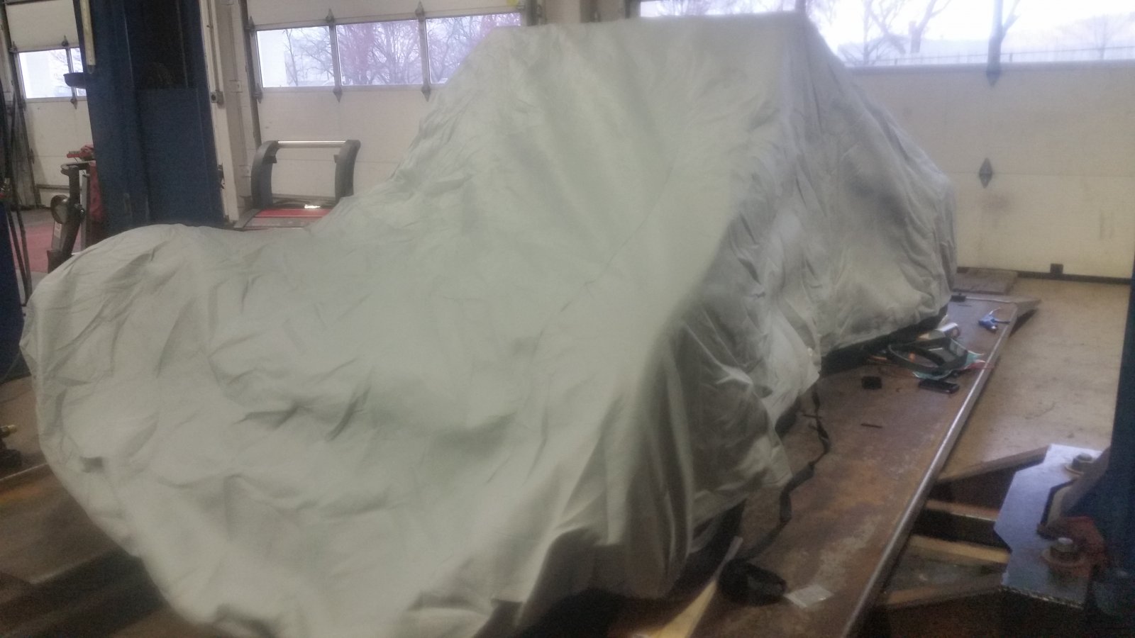

Bought a car cover for a Triumph GT 6 to cover the car at work.

It fits tight around the tires as it is made for a car 60" wide my Goblin is 68". It does have a strap for under car left to right. All that said time will tell.
