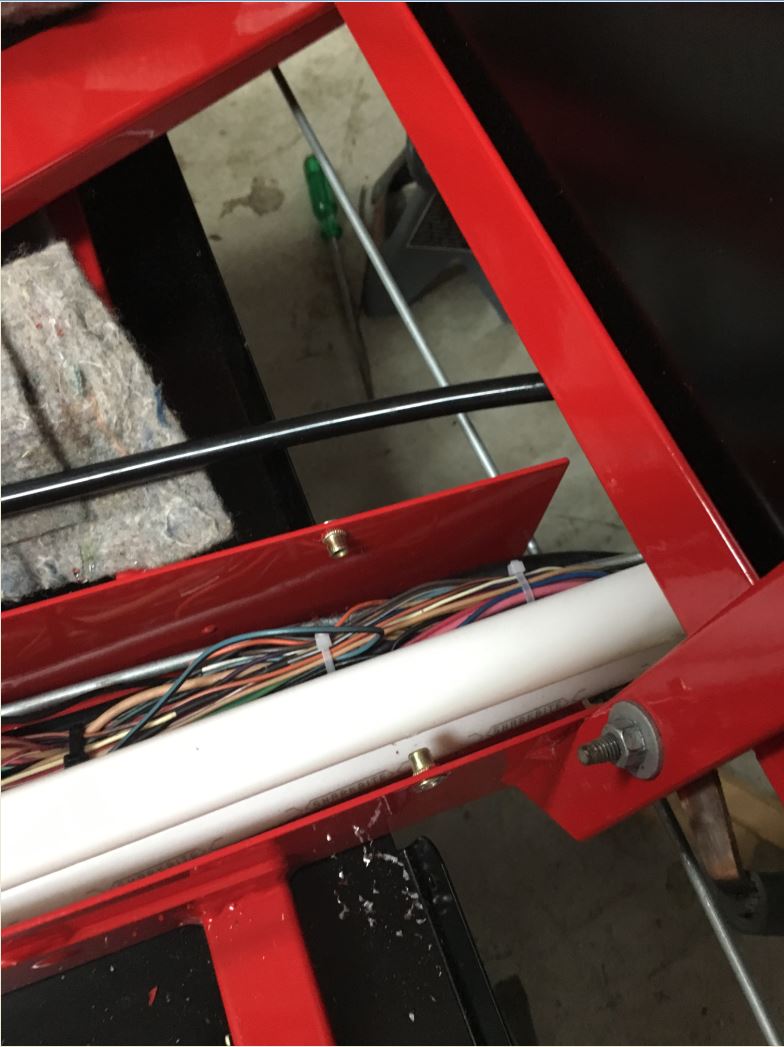

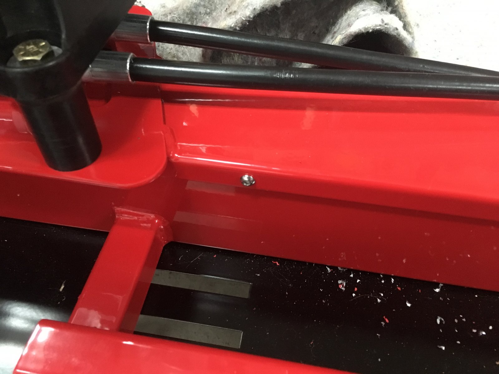

I decided to attach the tunnel cover with rivnuts and SS M4 button head socket cap bolts. I knew it was going to come off again to finish wrapping the harness and this method was easy and worked great for me. DF's pre-drilled holes for the rivets worked great as starter holes and everything lined up very well.
jennam
Those rivnuts look really good. I like that a whole lot better than riveting the tunnel permanently.
Did you use the special tool to install them?
SliderR1
I did not. Since these aren't a blind installation, I just used an old M4 hex bolt in my 1/4" impact and kept the rivnut from spinning with a small pair of channel locks. Worked great.
jennam
Glad to hear they are easy to install without the tool. I found some smaller quantities on Amazon that weren't badly priced so I may give it a shot.

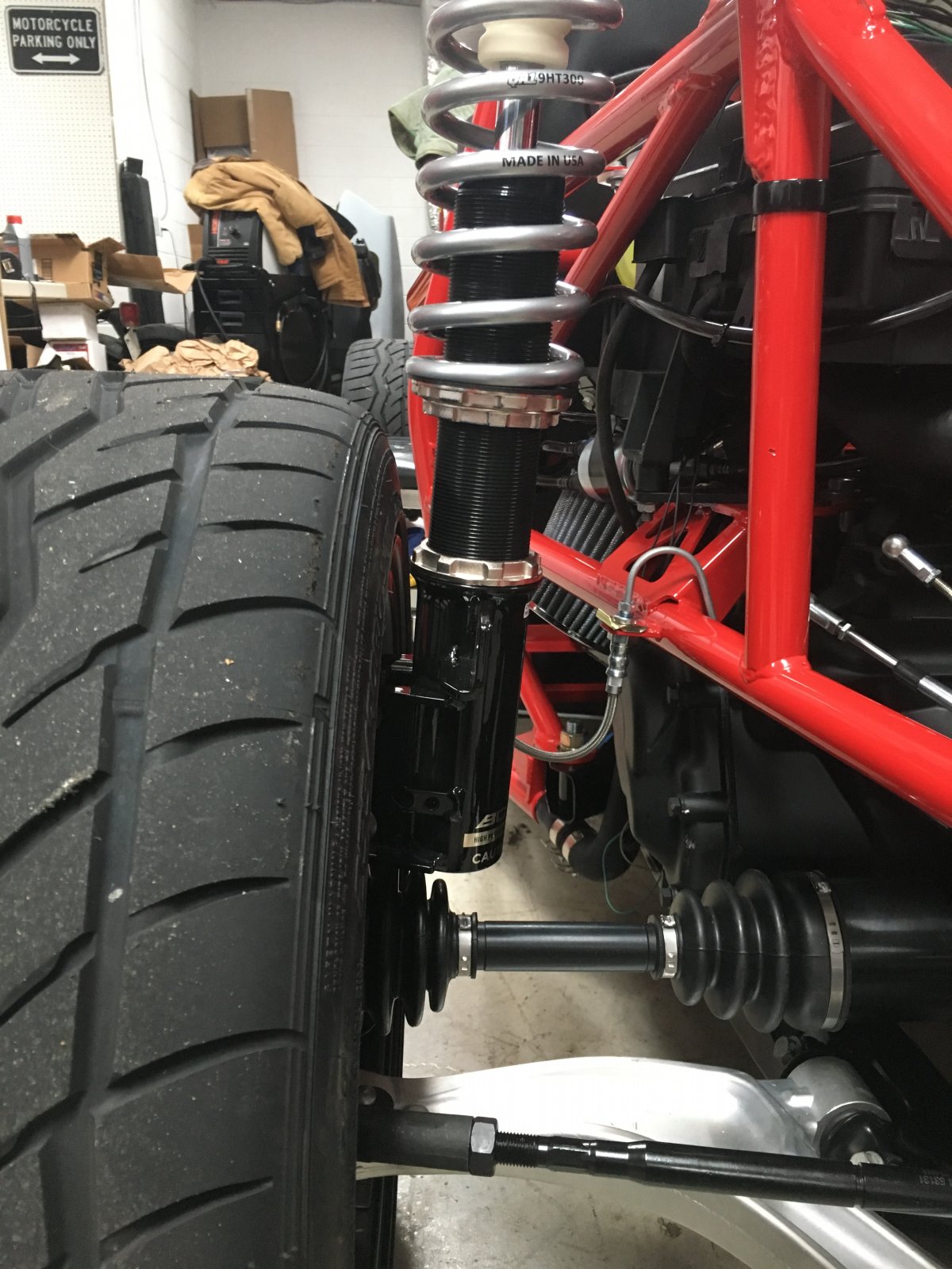

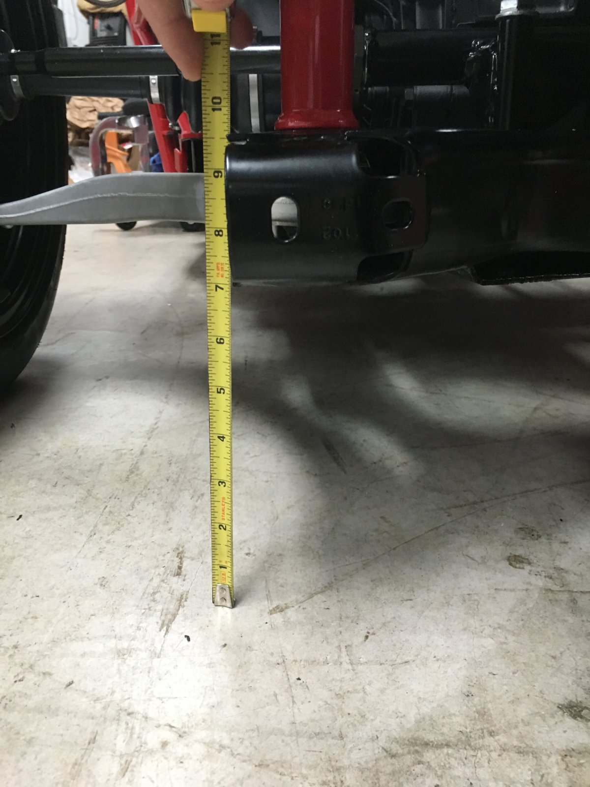

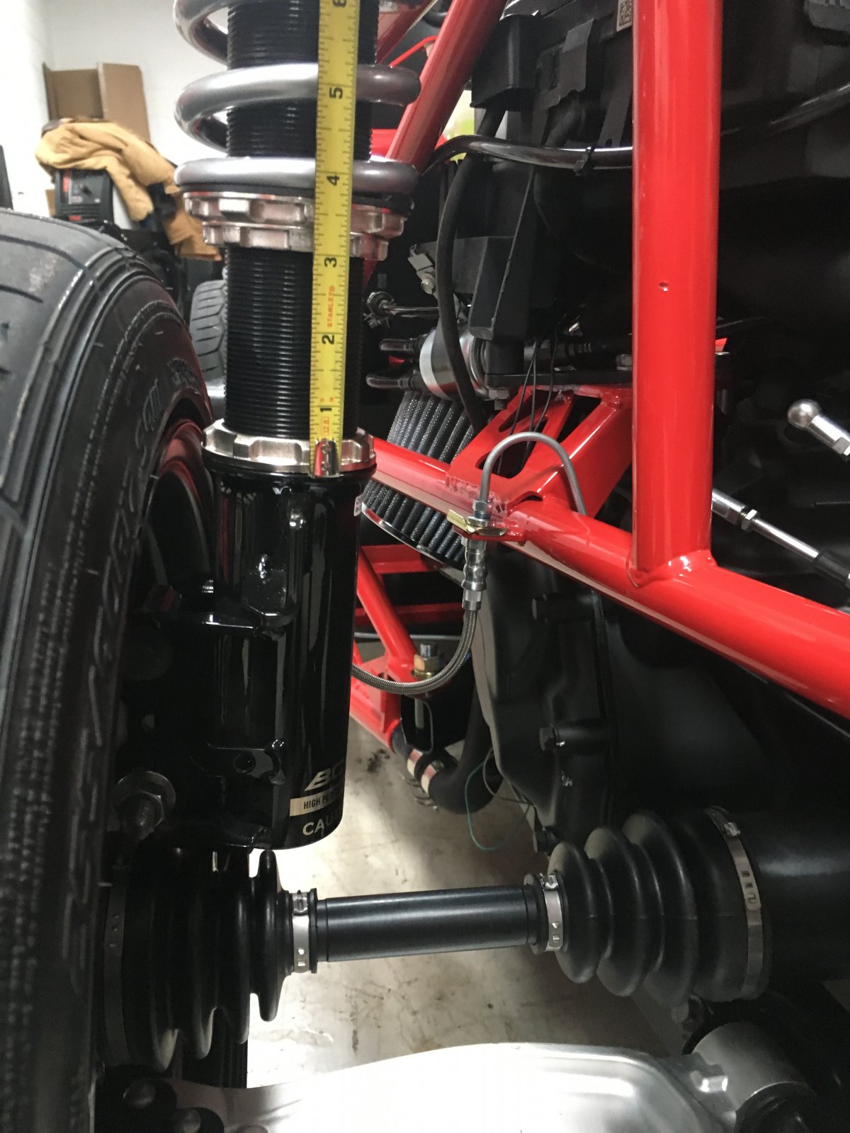

can I see a closeup picture of your rear shock setup? I am curious how high up you have your springs.
I'll take some pictures for you this evening. I ended up right where Adam suggested for ride height - 3.5 inches from bottom of threading (top of strut bottom piece) to lower locking ring. This yielded a rear ride height of about 7.5".

I also went 3.5 inches but I had to adjust the spring up a good bit.
SliderR1

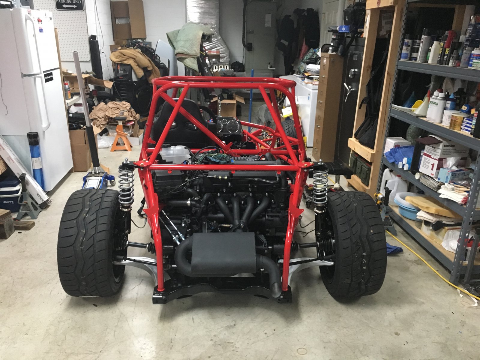

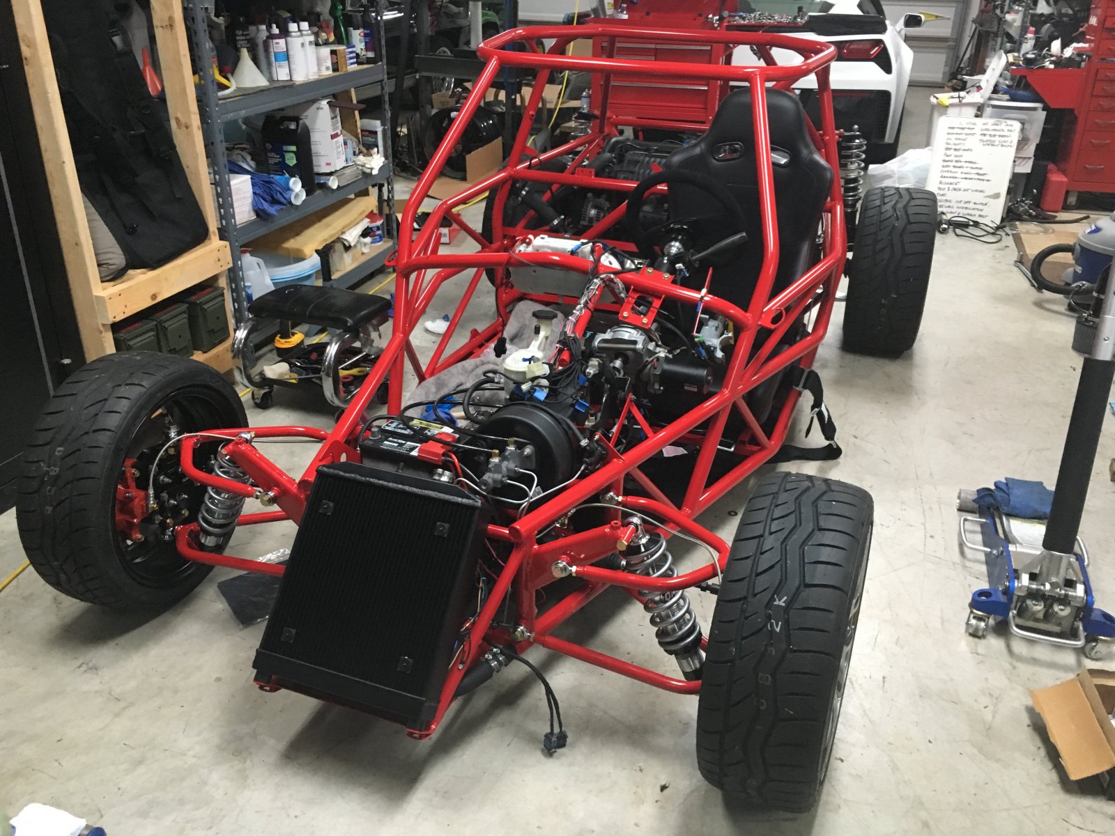

Here are some pictures:
She settled down a little after the first drive. The measurement on the strut isn't exact - it was kinda difficult to hold the phone and tape at the same time, but you get the idea.
