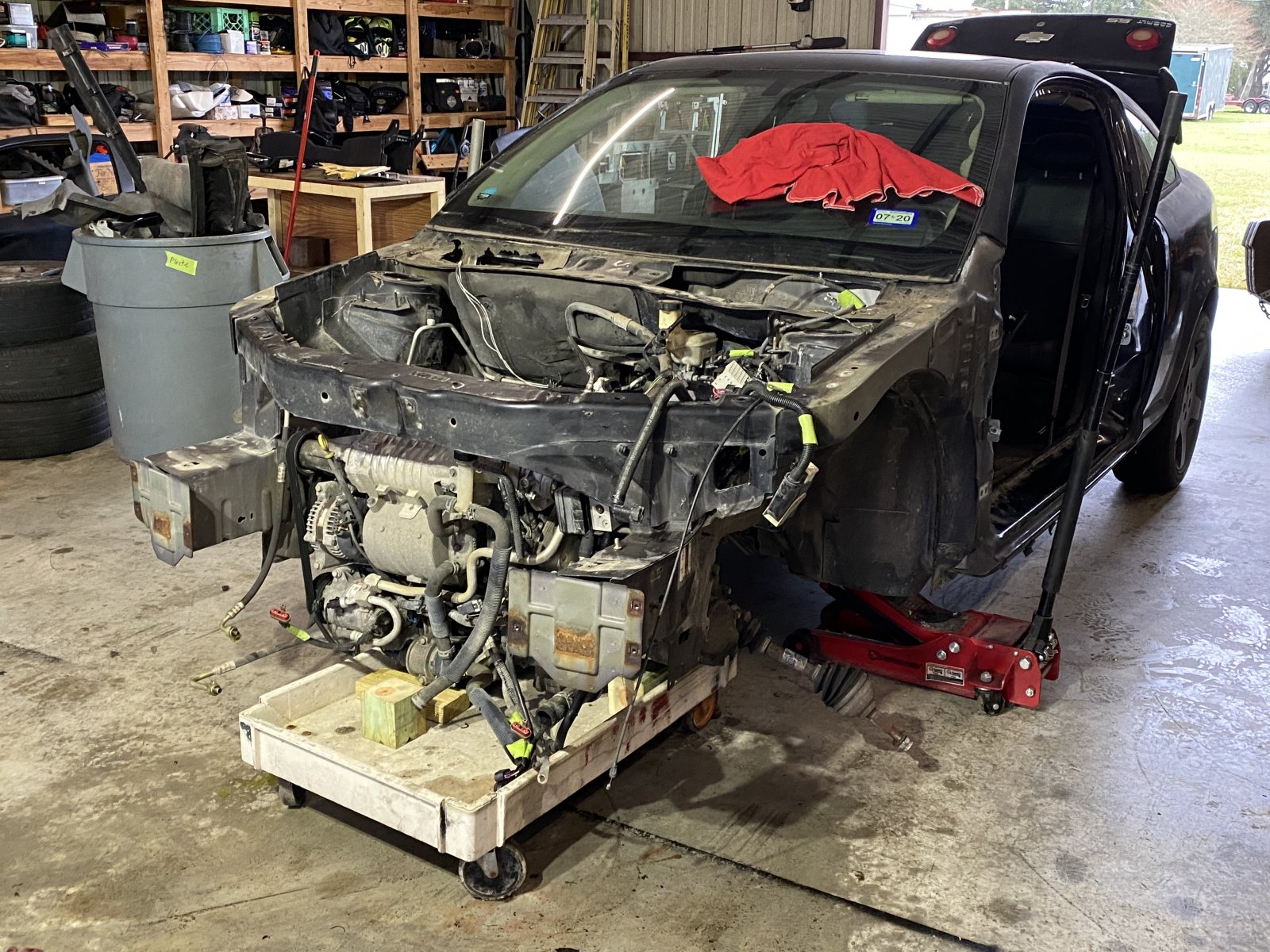

Yep. Lifting the body off the engine is actually the easiest, I feel. Hell cut the core support off the front and you won’t have to lift the car very high.

Well end of day on Sunday. Dash is out, body harness is almost out. I still have to remove the rear bumper to get the brake light harness out. Stupid sedan. If I didn’t have to work on Saturday I probably could have striped the dash. I bet my garbage men are going to hate me tomorrow. Oh and already sold the seats and front bumper do $580 back in my pocket

So my kit should be here by next weekend fingers crossed. I started my tear down Friday. So far the engine is out. The body harness is removed and the dash is put. Just need to pull the rear hub and fuel tank. Other than the parking brake cables and tubes am I missing anything else. I want to get the shell gone ASAP.
R
Sounds and looks like you got everything. Some people recommend the rear axle assembly as it is a way to give rear disc brakes to (malibus?) other chevy sedans.
Rubber brake lines (if you don't get the SS lines) and clips, clutch line and all clips. Does your registration require emissions, if so the evaporator canister and hoses/fittings.

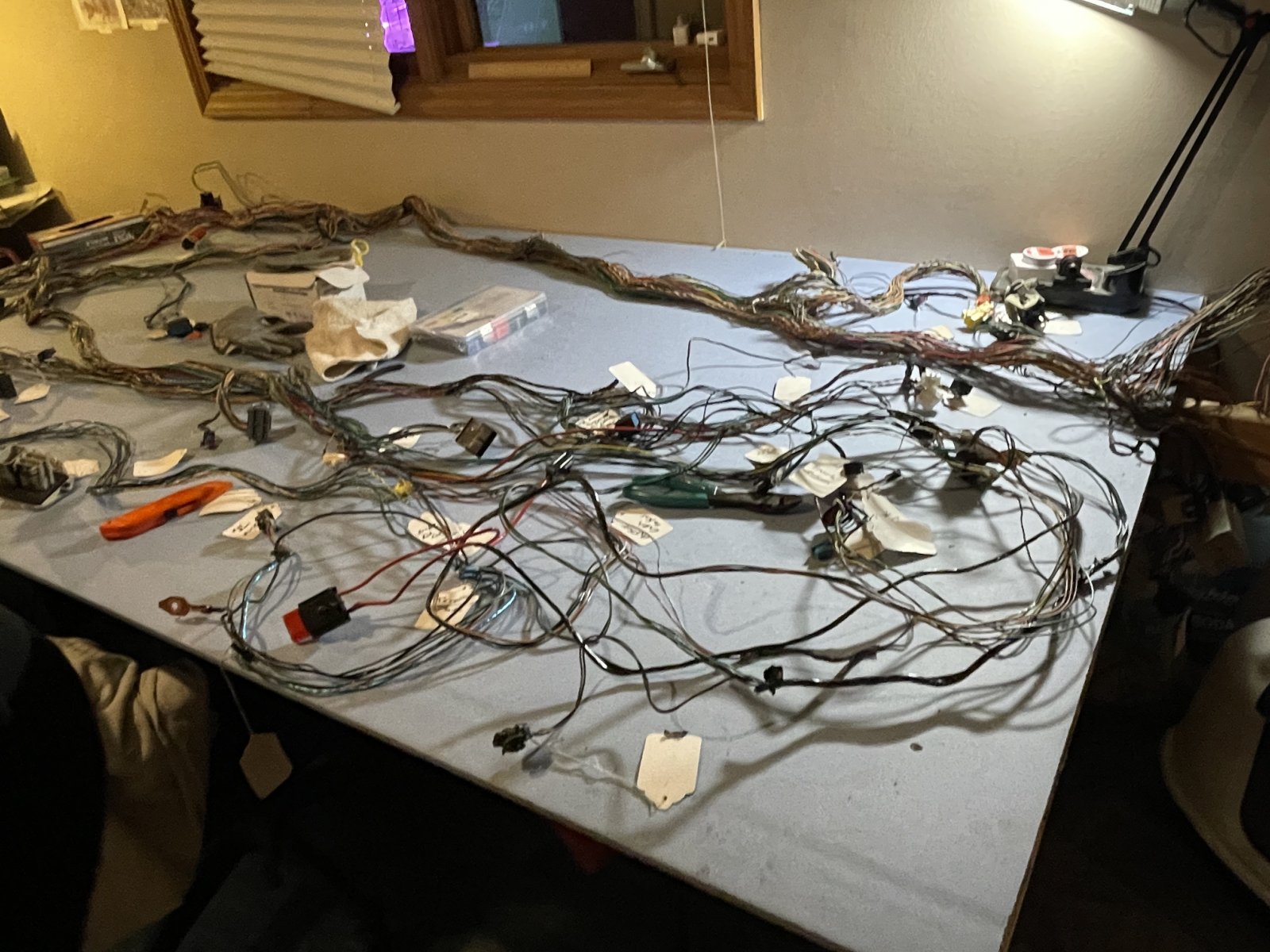

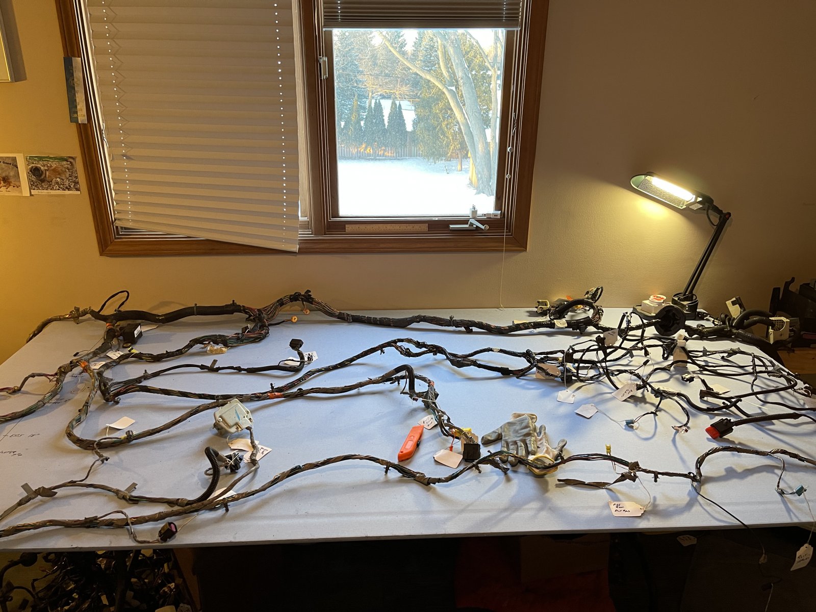

The best part is you get to deal with the stickiness left from the tape the WHOOOOLLLEEEE time you work the harness >.< I went through half a box of gloves doing the harness. I found Clorox wipes cleans up the stickiness from your hands pretty nicely (from when dexterity is needed and gloves come off)
