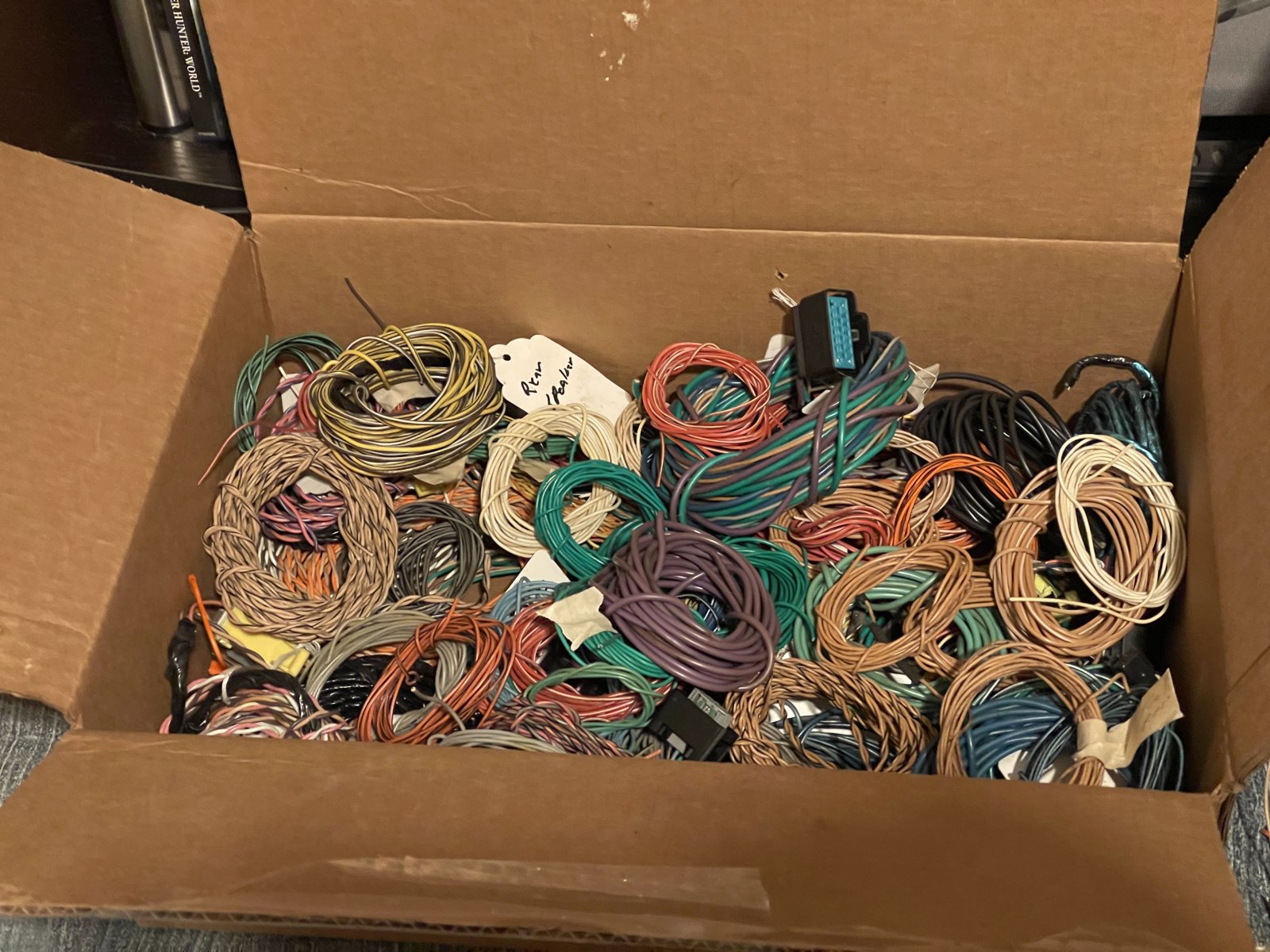

So I’m working on my wiring harness. I at the point where in organizing the main harness. I may have 2 problems. First the grey connector the is so posed to be pulled to the back by the BCM has some wires going between the wires from the main dash connector (female side). Second I may have cut the wrong tan fuel pump wire out. The one I kept goes the a 3 wire junction. Any help would be appreciated
SmsDetroit
Okay so I figured out how to get dash connector out of the way. Should have watched the video further. Looks like I did cut the wrong tan wire out for the fuel pump. Can anyone tell me where it runs to so I can soldier it back in please
SmsDetroit
Leave it to Lonny to know mi didn’t realize the tan wire for the fuel pump is also for the clutch. So apparently I never cut it out to begin with
