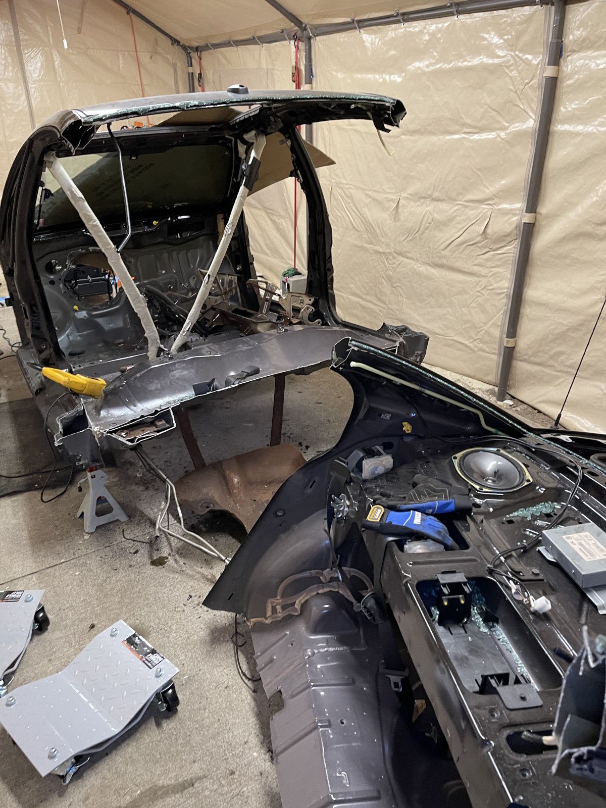

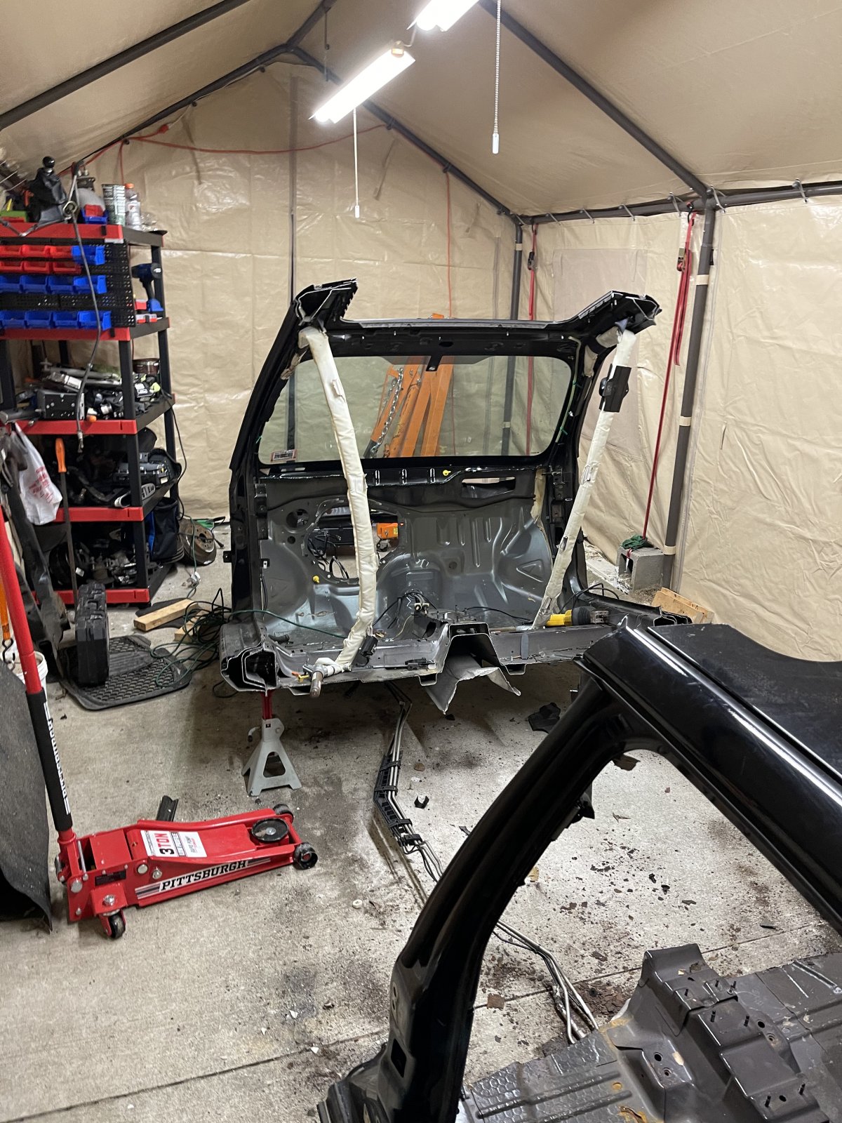

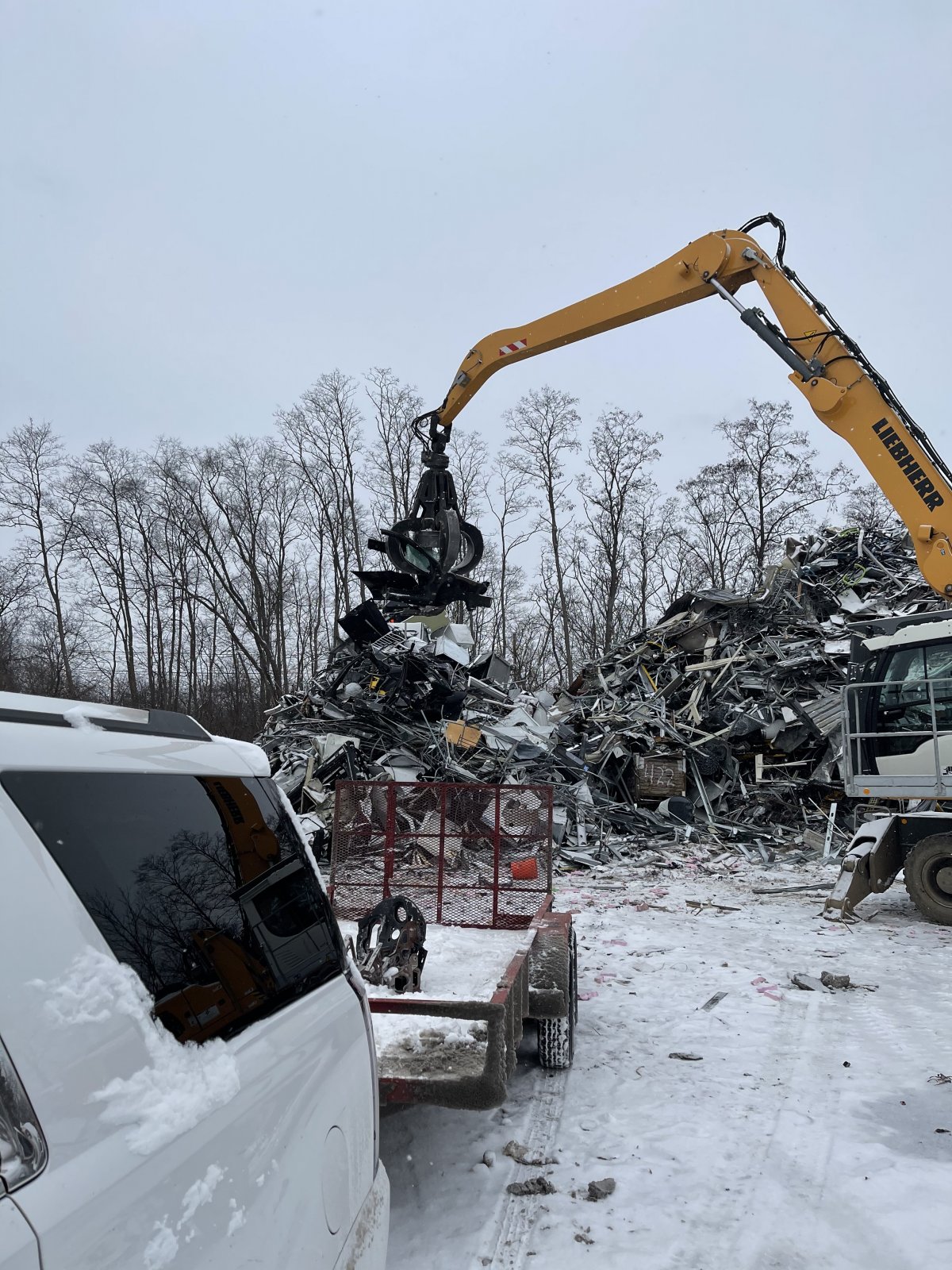

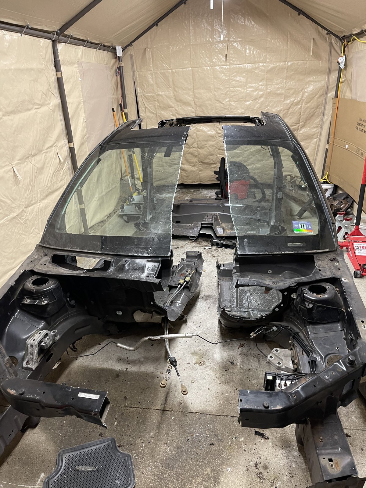

I’m thinking a few tac welds some bondo and I can put it back together. No one will notice.
