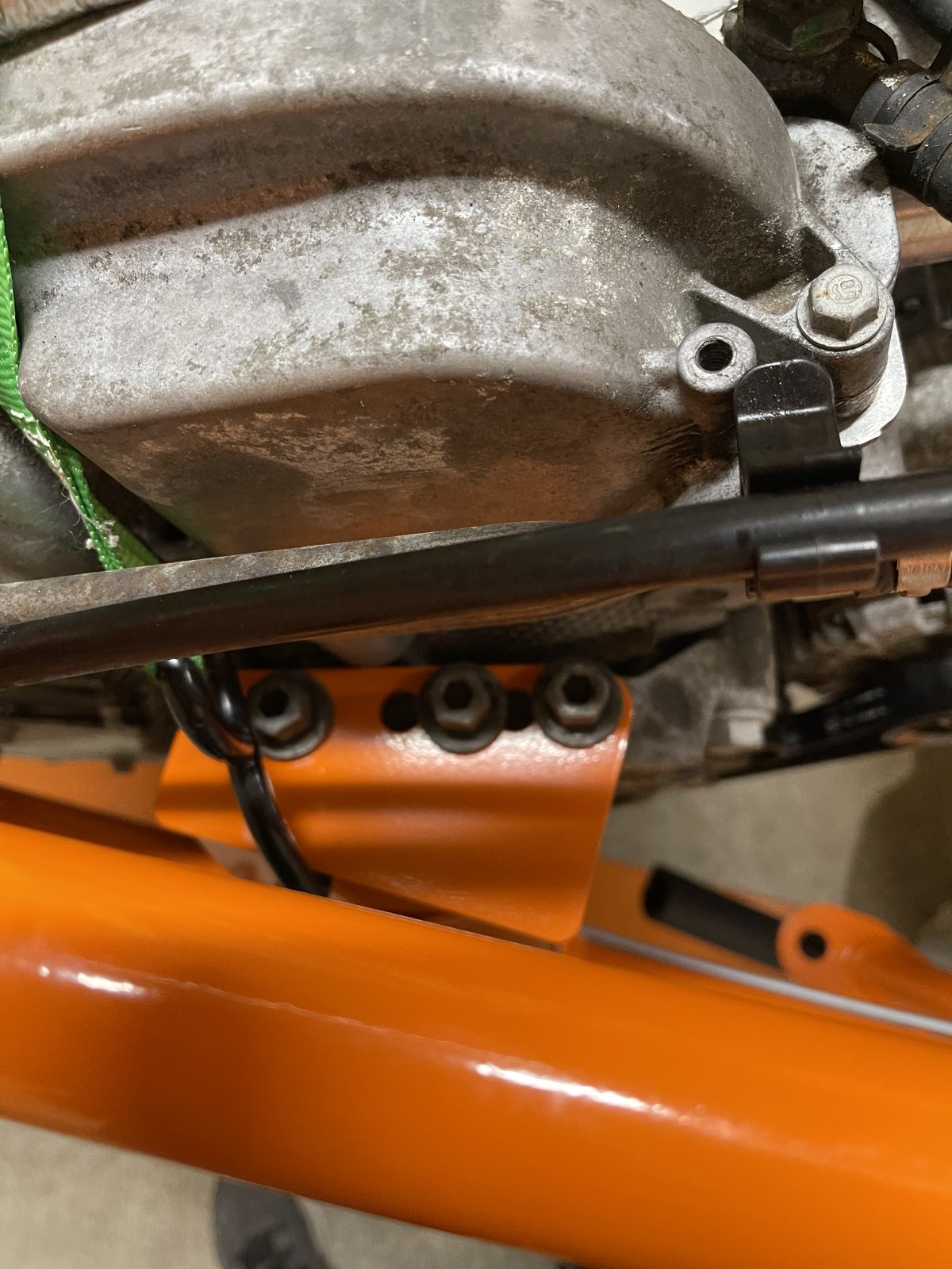

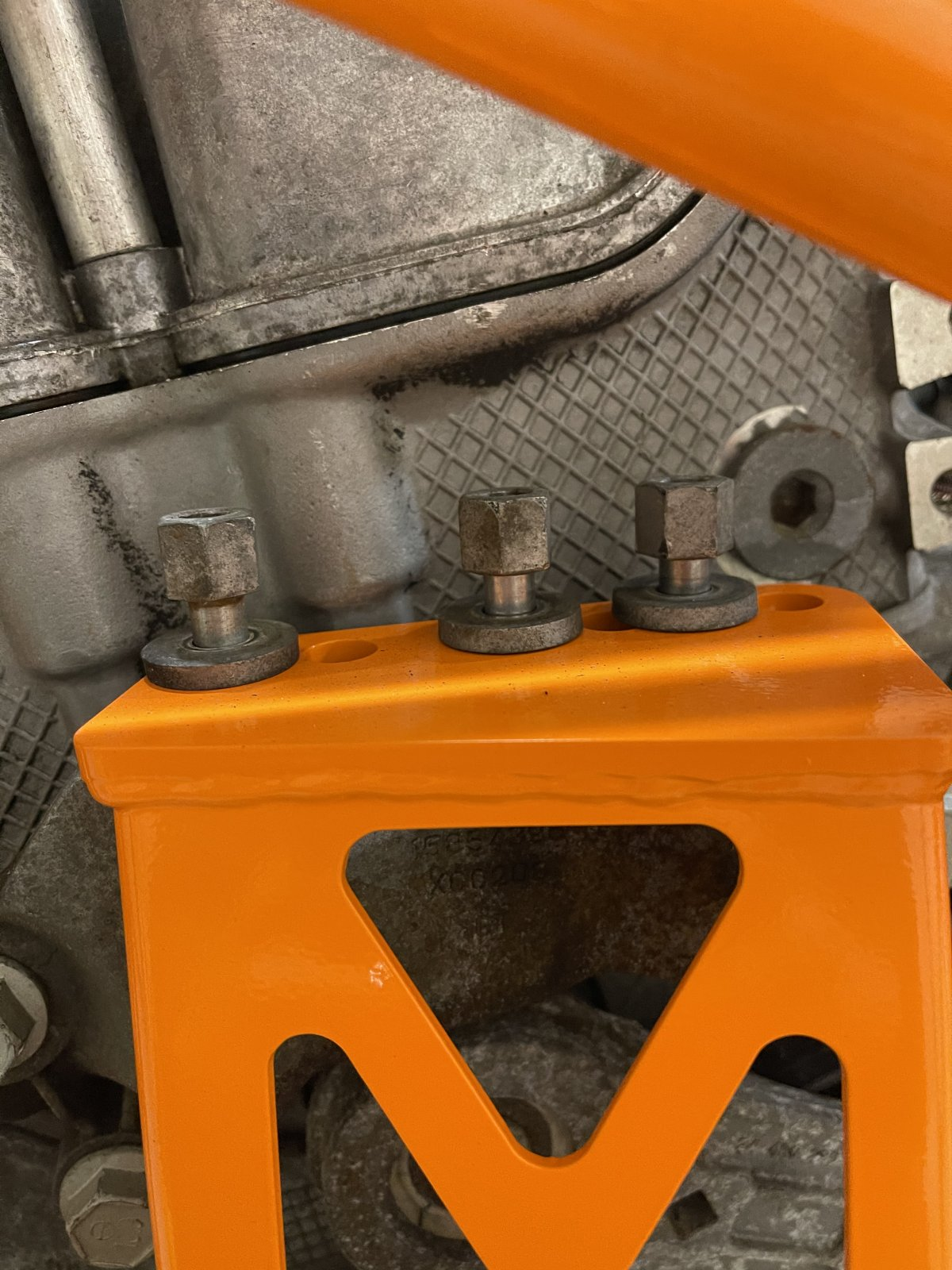

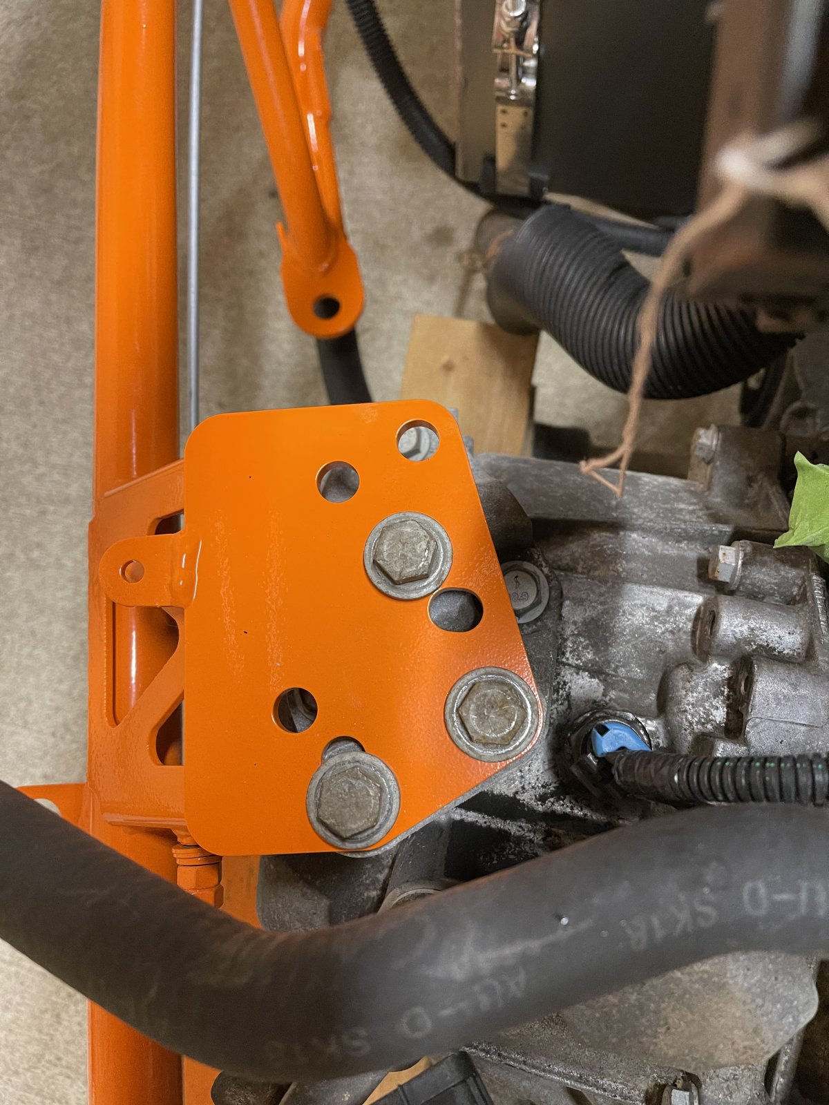

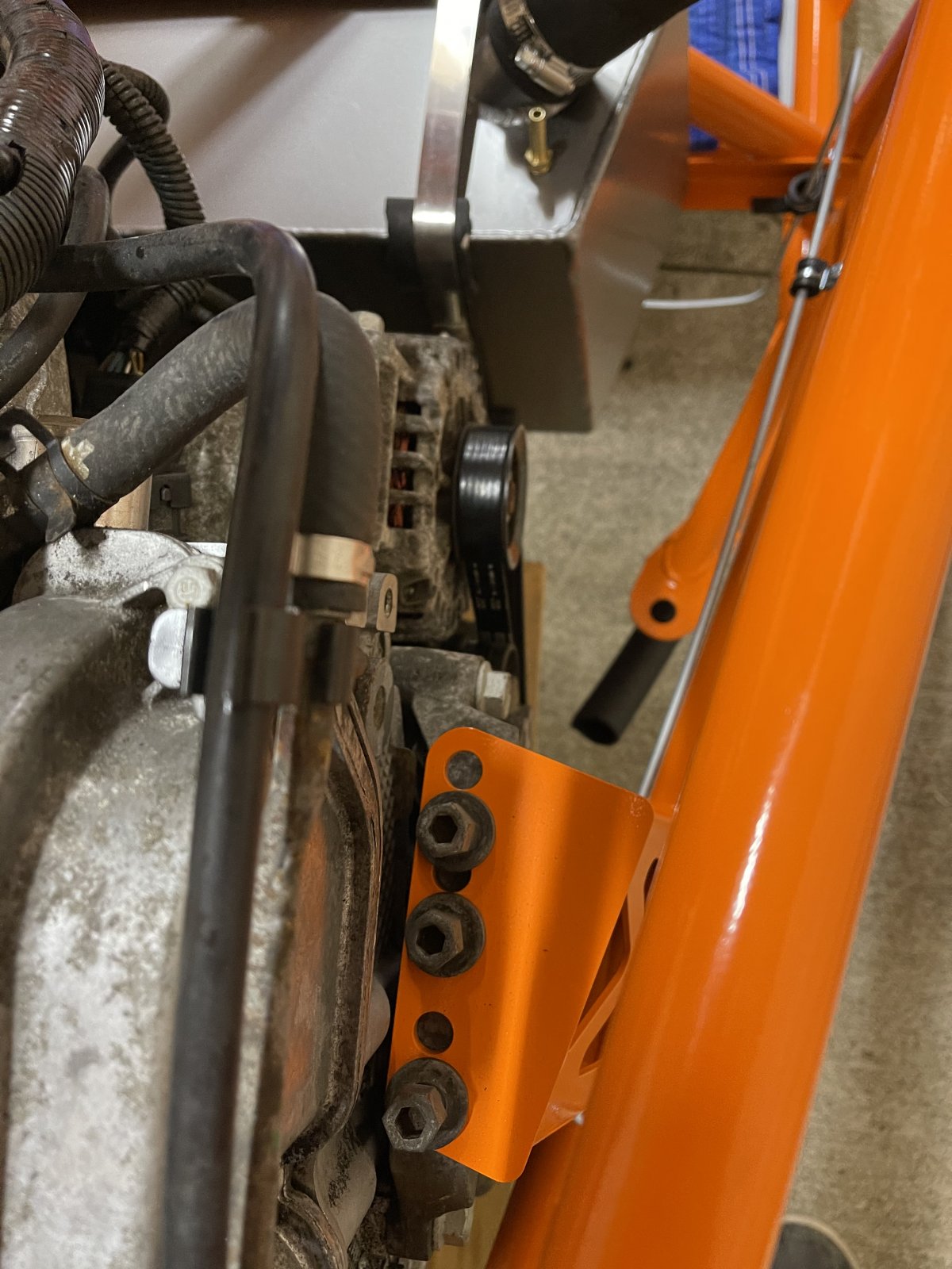

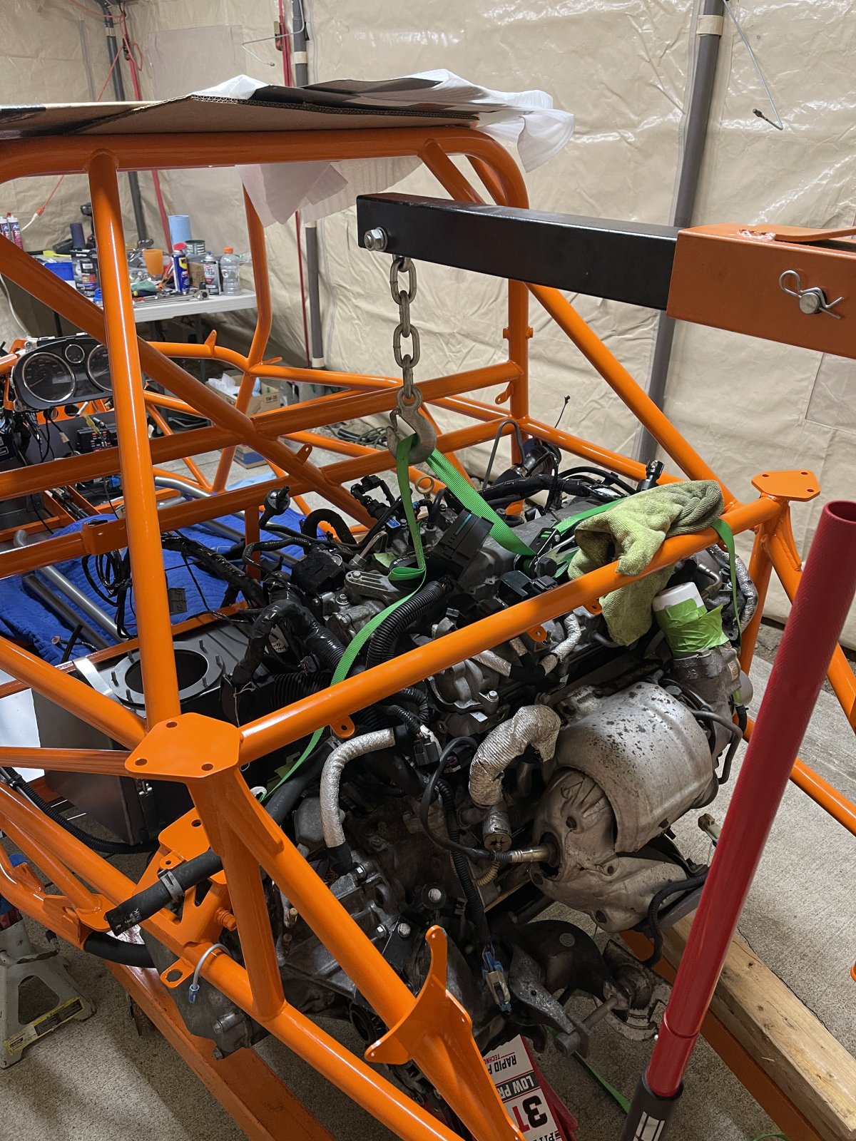

Well it is possible to install the engine solo. Although I do have 2 questions. First are there spacers for the passenger side engine mounts. The bolts won’t go all the way down and bottom out. Second which set of holes do I use. With the trans bolted up they line up with 2 different sets. I picked the furthest forward because he turbo lined up with the cross brake when bolted one hole back.

21721
These are the correct holes to use on the engine side.
The turbo outlet tube gets replaced with a short one.
The transmission spacers and turbo outlet tube should be in your kit.
I think the spacer kit is a K21E.
You will need to swap the o-ring from your old outlet tube to your new one.

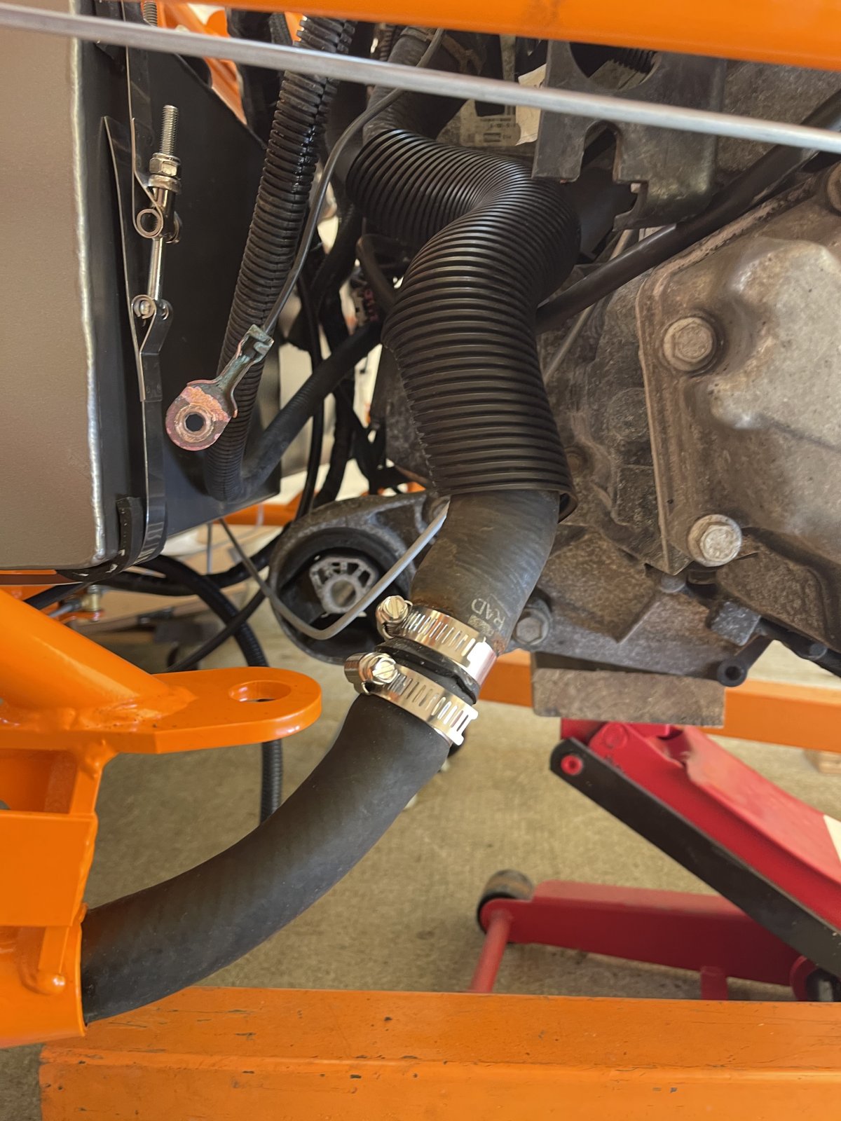

Does anyone see a reason a reason I can not connect the coolant hoses this way. I wanted to cut one connection out and use the stock hose. Also was I so posed to receive a 1” coolant hole for the coolant tank?
