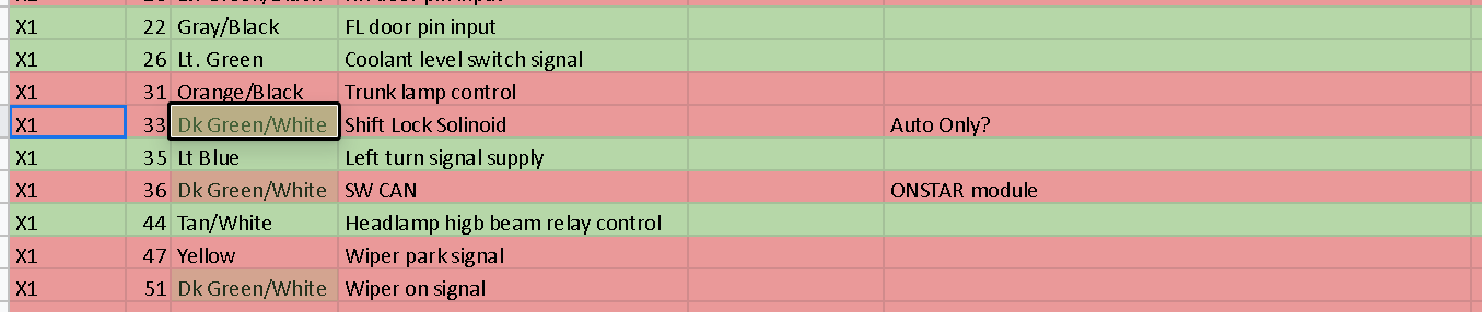

I'm sometimes such an idiot... caught it though finally...
12066
BIG THANK YOU to BradR and Ross... who provided tools to verify that the connector I am looking for would have gone to the BCM X1 connector
have to update the separate electrical query over on the other forum board
