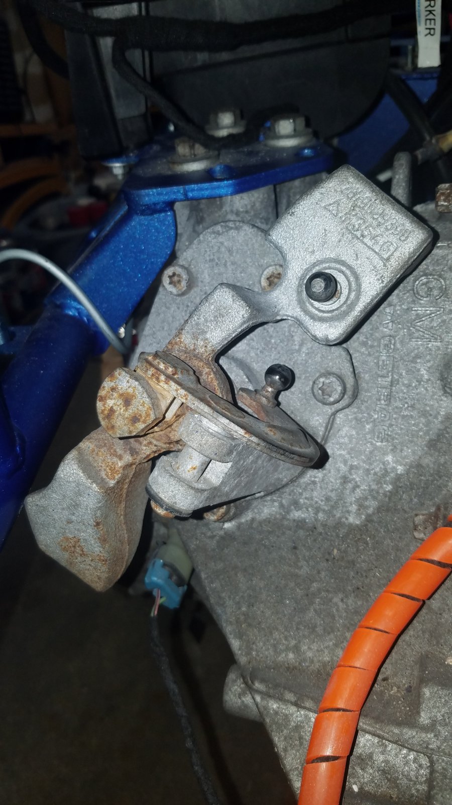

Found a new nuisance tonight... the shifter on the transmission bangs into the frame making a bang....
17279
This is either third or fourth gear, ???
Point being i have to see now if this part can be either swapped or trimmed and i believe my desperate butt will probably do the later.

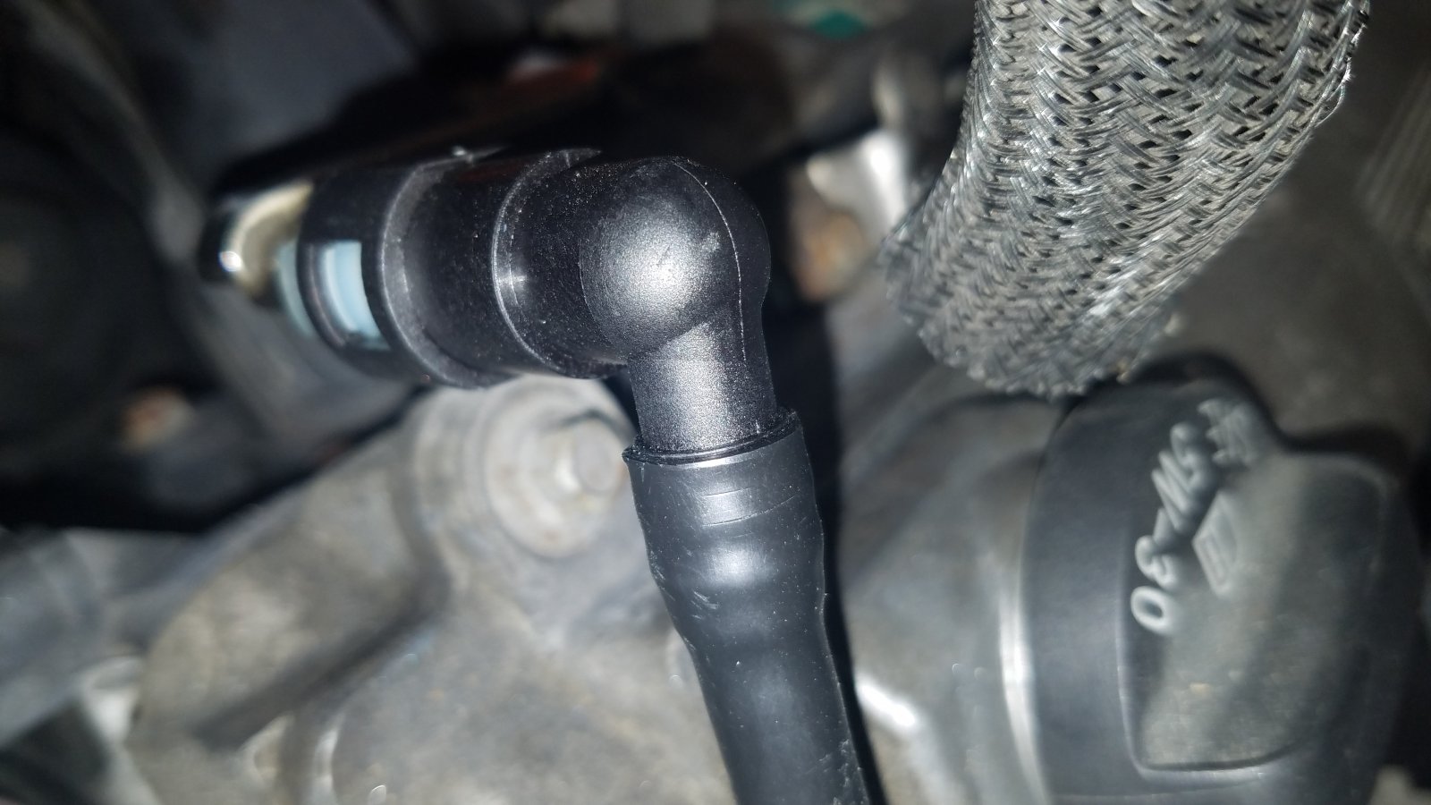

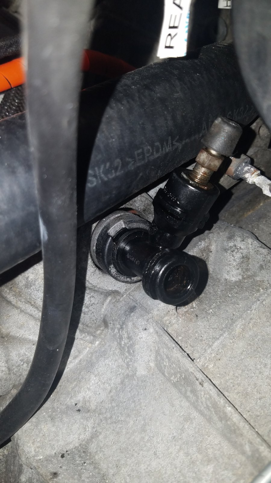

Was able to get the slave cylinder fittings undone from donor config
17280

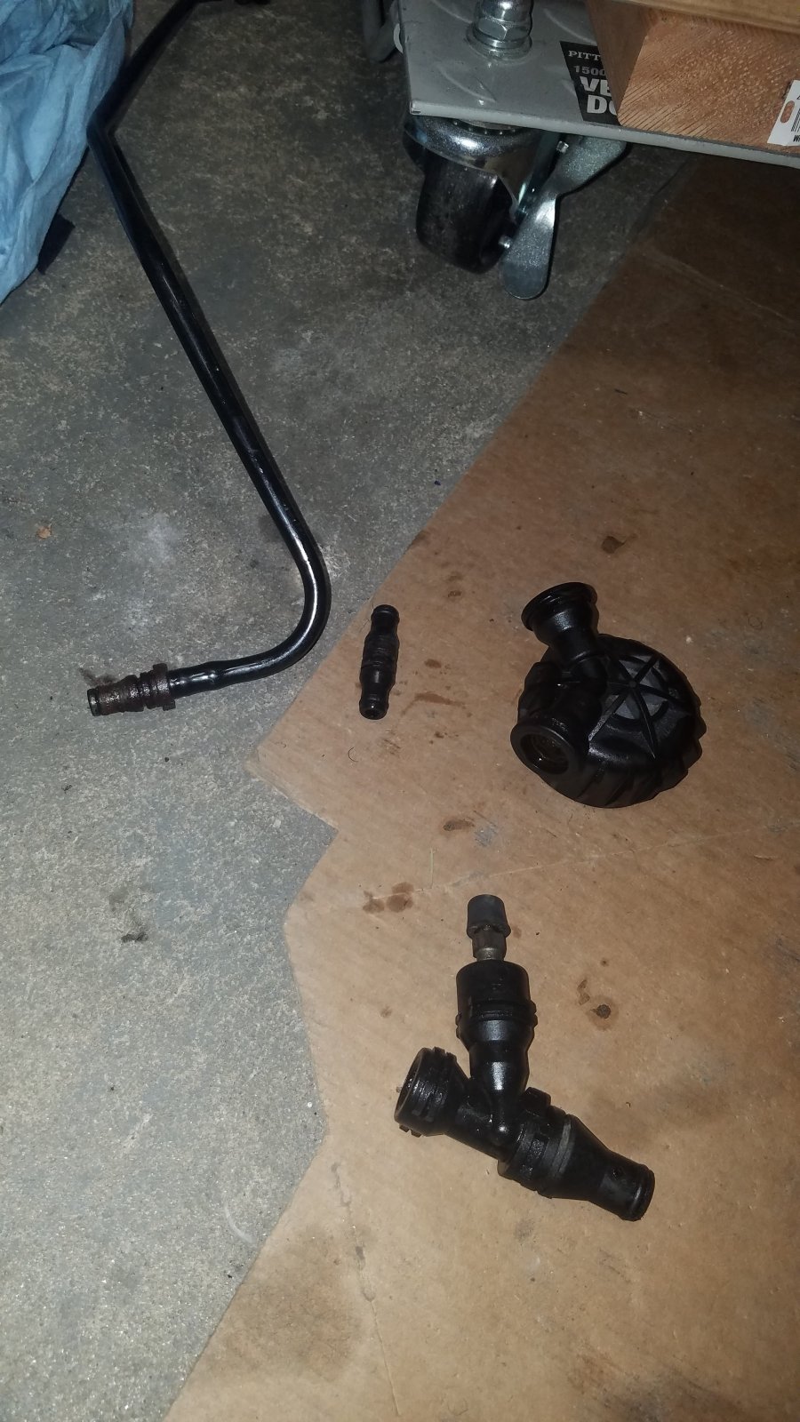

I'll place the fitting (bottom one) into the tranny... is there any use for the other part or is that just fodder? Will have to find out.
17281

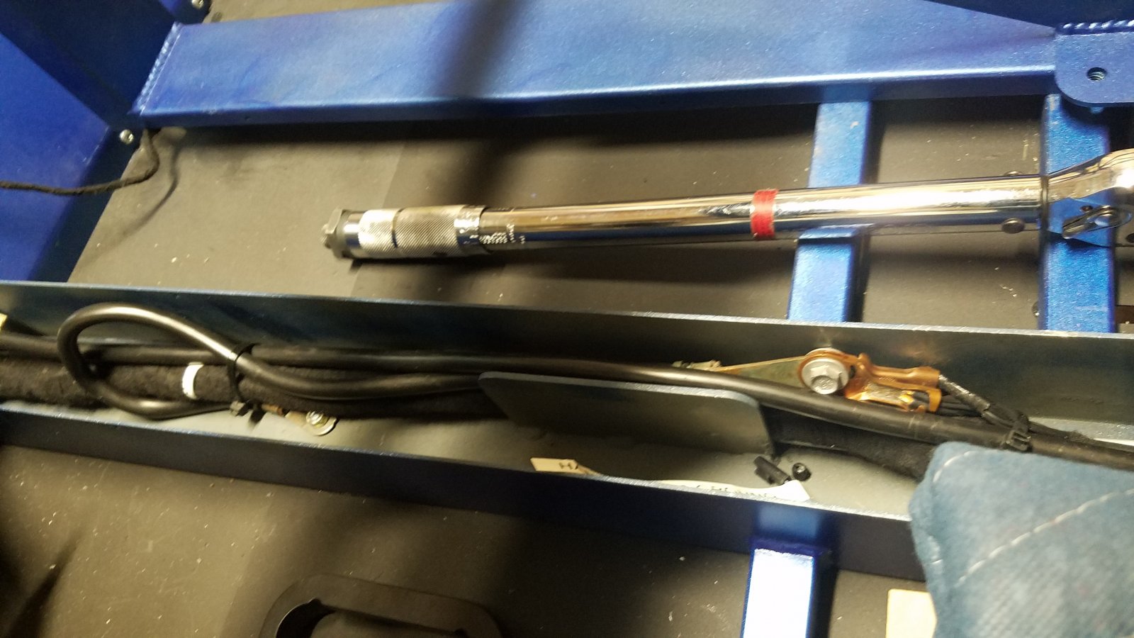

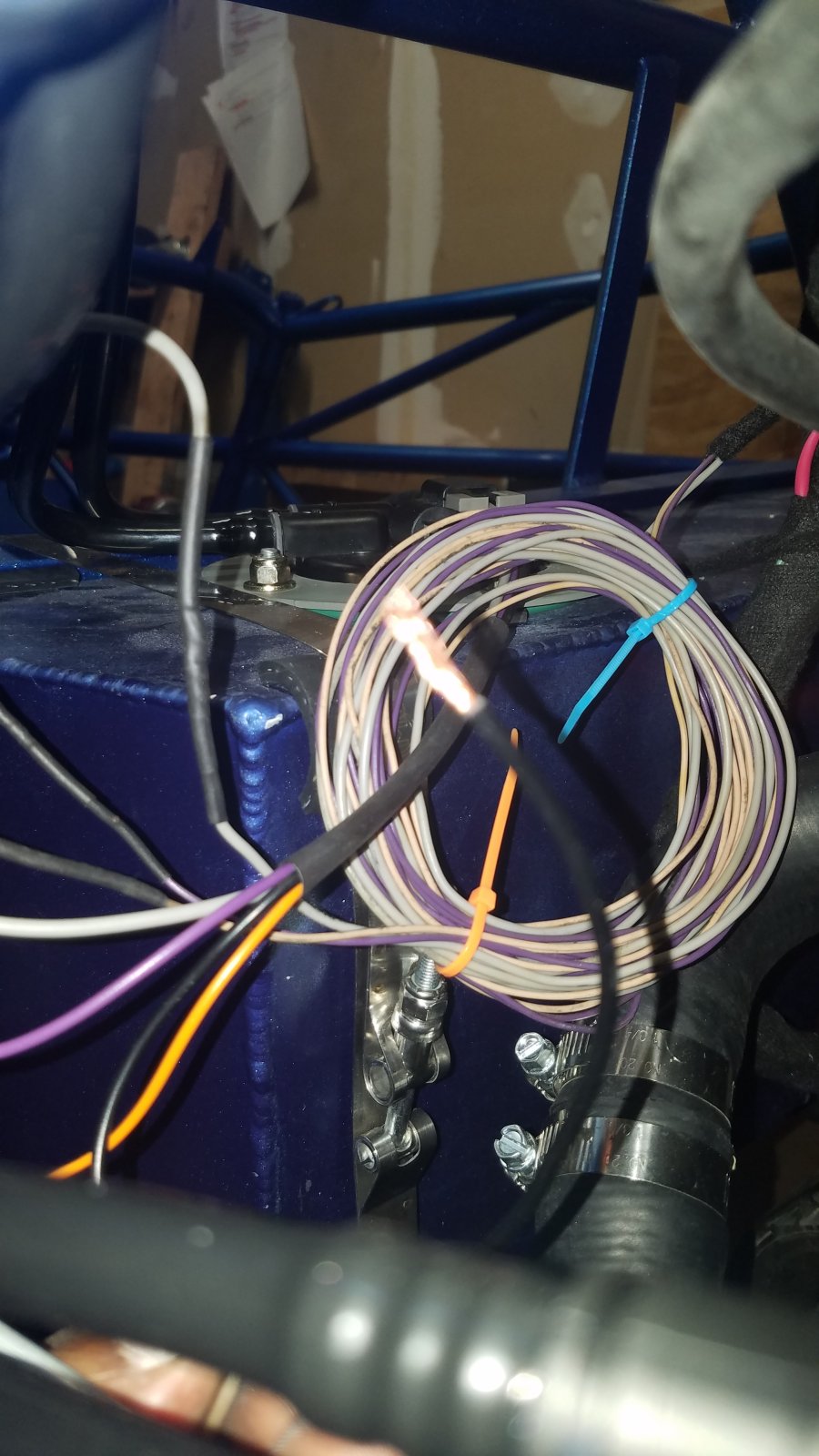

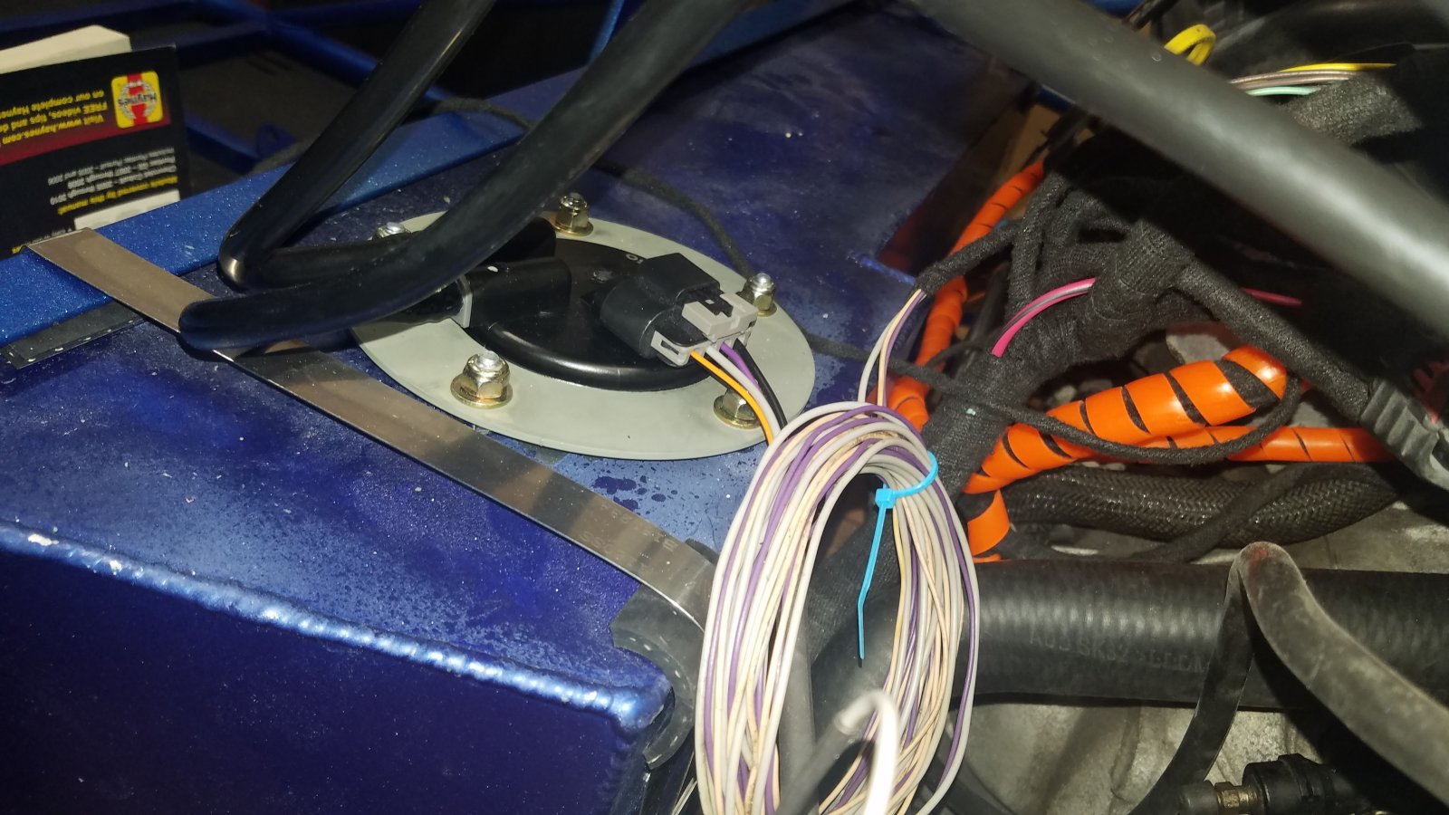

Also i need to back track to the fuel pump wiring and add a ground to the harness there... i left myself a black wire coming from the plug but never ran the ground wire.

found a very informative youtube vid re the gear selector...
side note... found a vid on WELDING THE F23 DIFF!!! omg, seems like too much trouble, like why even do that, ha ha ha.
EDIT: will take the time to pull the gear selector and trim the counterweight on the selector arm...

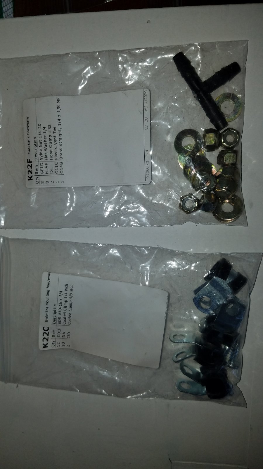

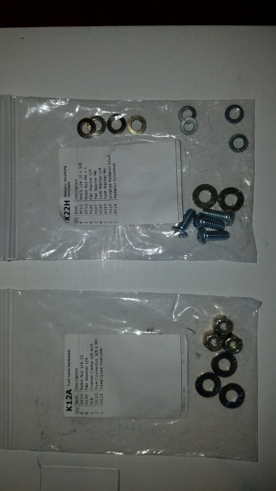

Thought I'd post what spare bits I didn't use so far... if i missed something critical then I can at least point here to say i missed it.
17373
K12A fuel tank hardware
& K22H radiator mount hardware
K22E fuse box hardware
Simply decided a donor bolt would do didn't like the look of an elevated fuse box
17375
K22C brake line coated clamps
K22F fuel tank hardware
I am sure that k22f will see more action as i have yet to pit in the breather to the fuel cell

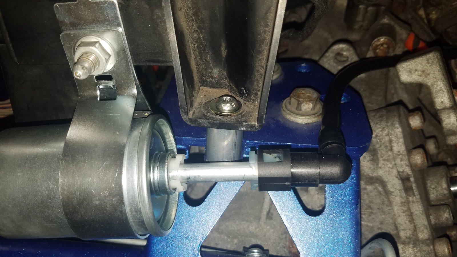

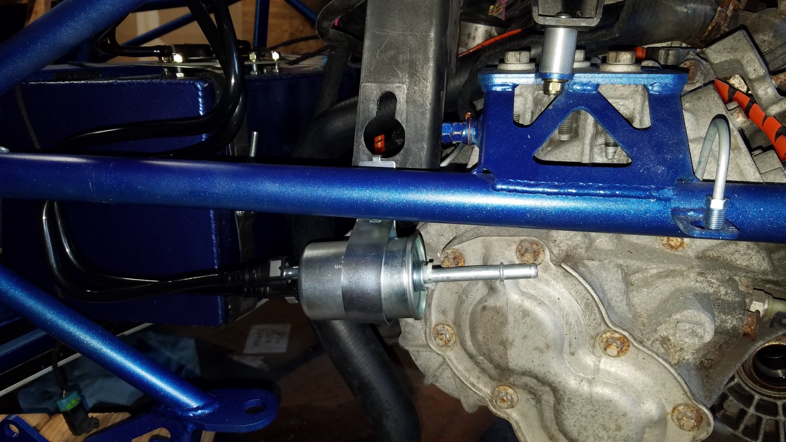

I'm tryimg to find a place the for the fuel filter different than what's prescribed
17376

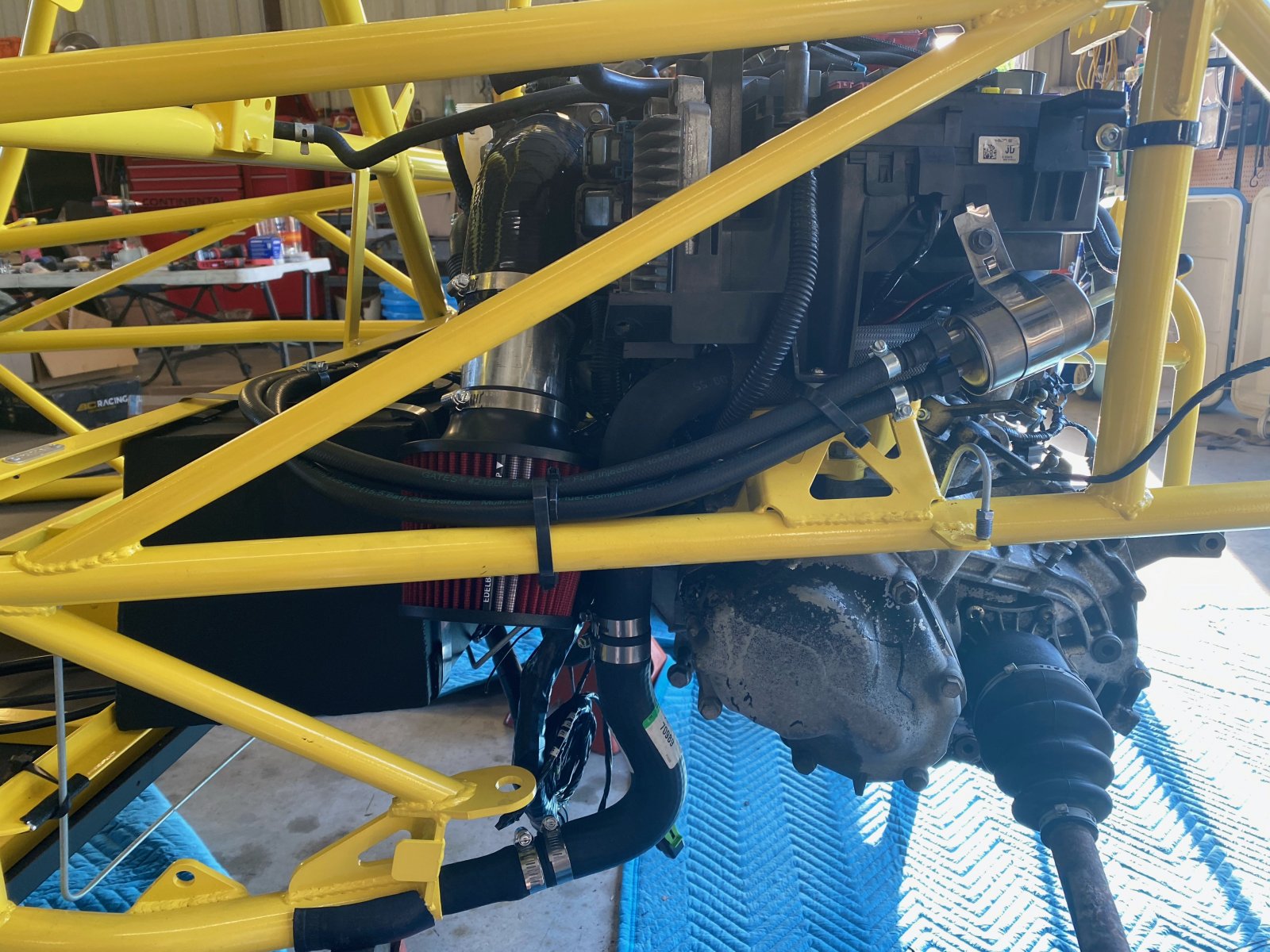

There's some interference with the edge of the manual transmission case. More research needed.
Ditch the factory hoses and go with rubber hose. Be sure to get the proper hoses.

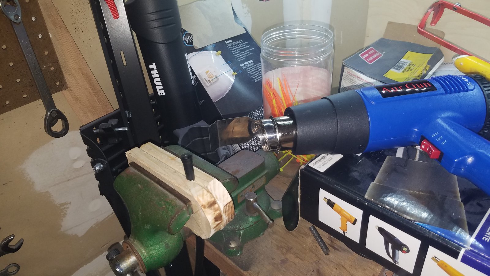

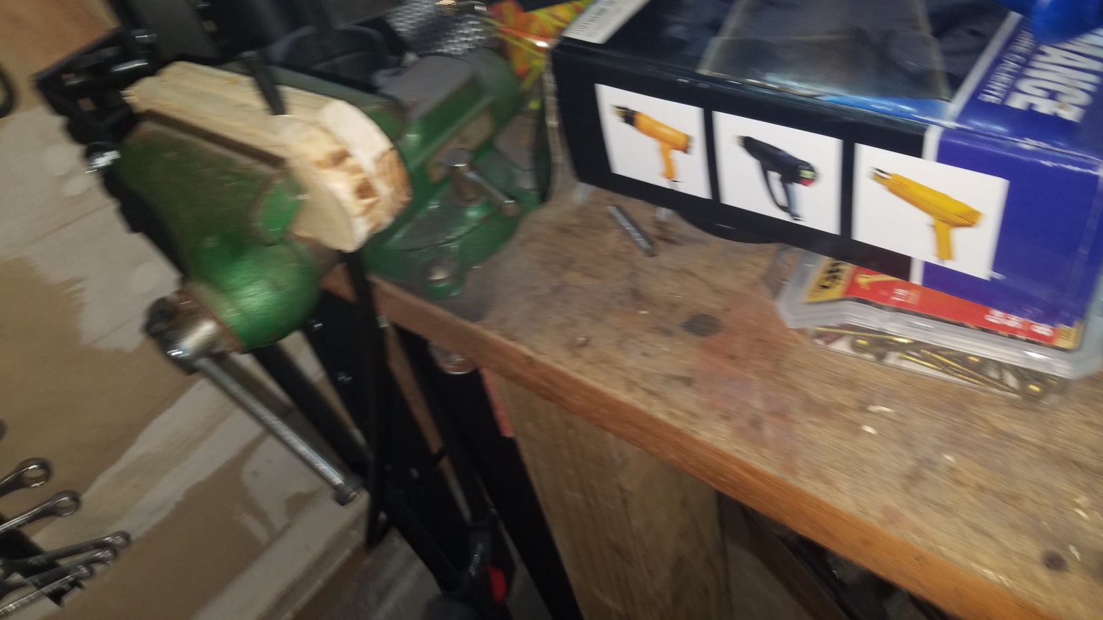

Although Rttoys advice rings true to me, i wanted to give it a shot setting up the default nylon lines like in the videos... will definitely swap them to rubber after getting first start though.
I ended up jerry-rigging a wood holder using a couple clamps and drilled through using a drill bit so that the hose was sandwiched and used fine grit sanding paper to get some bite.
Used the heat gun to soften the nylon hose so i could press the quick connect into the it. Will have to check to see how to test this before actually running pressured fuel through it.
Other than that i still need to ground the fuel pump and am thinking of simply tapping that bolt under the fuse box for now.
The only other thing left to source is a hose that will reach from the engine to the overflow tank
From my sausage of a finger to the overflow tank.... I've heard legend of a perfect fitting hose but have yet to find the right one in my travels in the forum. LoL.
Just about ready for first start and placing the order for stage 2.

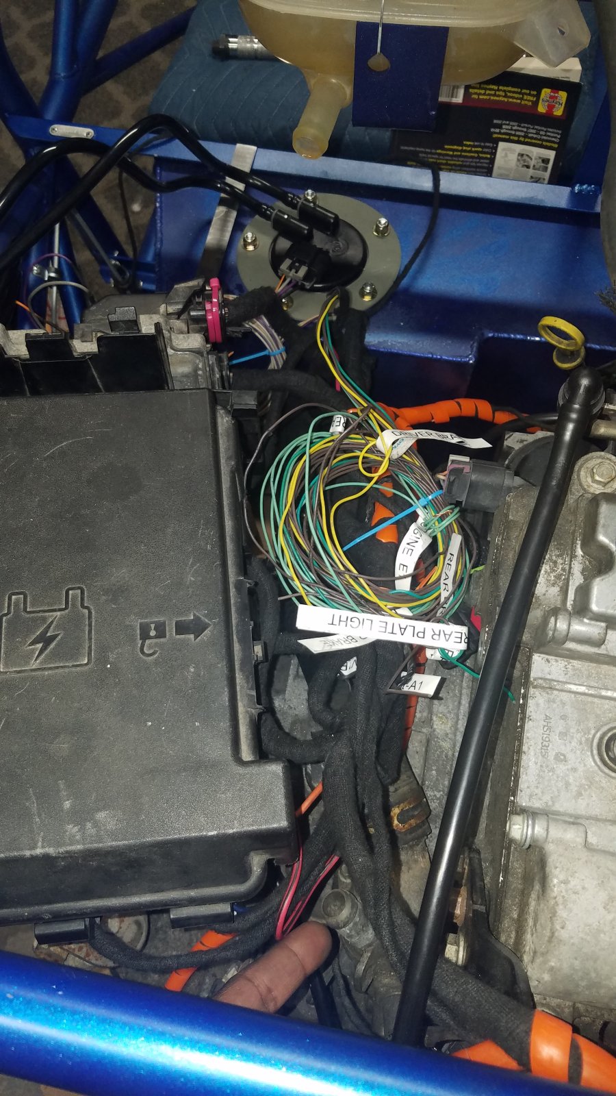

Attemtp at a first start has failed... i ran onto the same problems as a few other folks and found that the fuse box needed attention.
Initially found that I couldnt jump the fuel pump to source the gas, actually caused a spark with the jump wire i used... idk if that has ruined anything... was using the same spots they did in the video and got no response from the pump. Hope i didn't screw up the wiring.
Afterward i noticed that the cluster had a car/lock icon lit up and thought that the antitheft somehow may have hampered this start attempt. Seeing a couple other people fixed this with securing the fuse box i figured i would double check it.

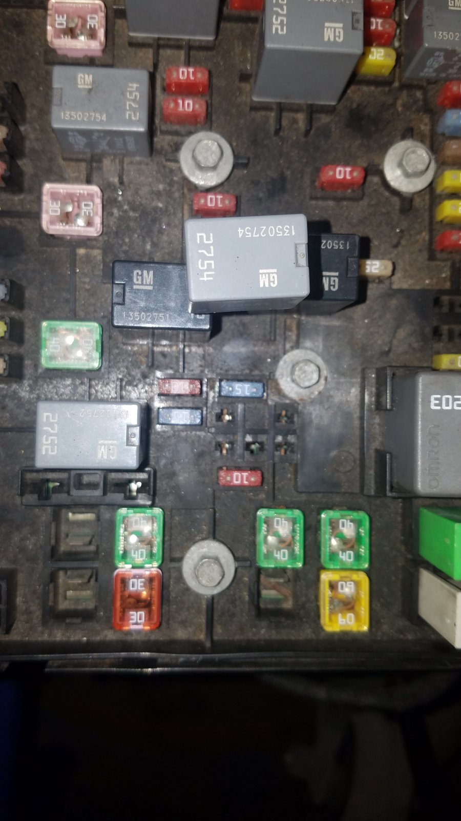

The fuse box seemed to be loose on some plugs and what felt like tuning the bolts on the top was a solution. Later on i tugged a bit to check the slack and was able to have a stable gauge cluster.

Crazy enough i jiggled all the cords and heard a few relays clicking about... narowed it down to the same one that the fuel pump is tied to... will have to check out the fuse box thoroughly at some point if the connections are just not making it...
First start still did not go smoothly. What seemed like a single cylinder firing then dying... maybe the other plugs are not sitting properly either...
SwerveMonkey

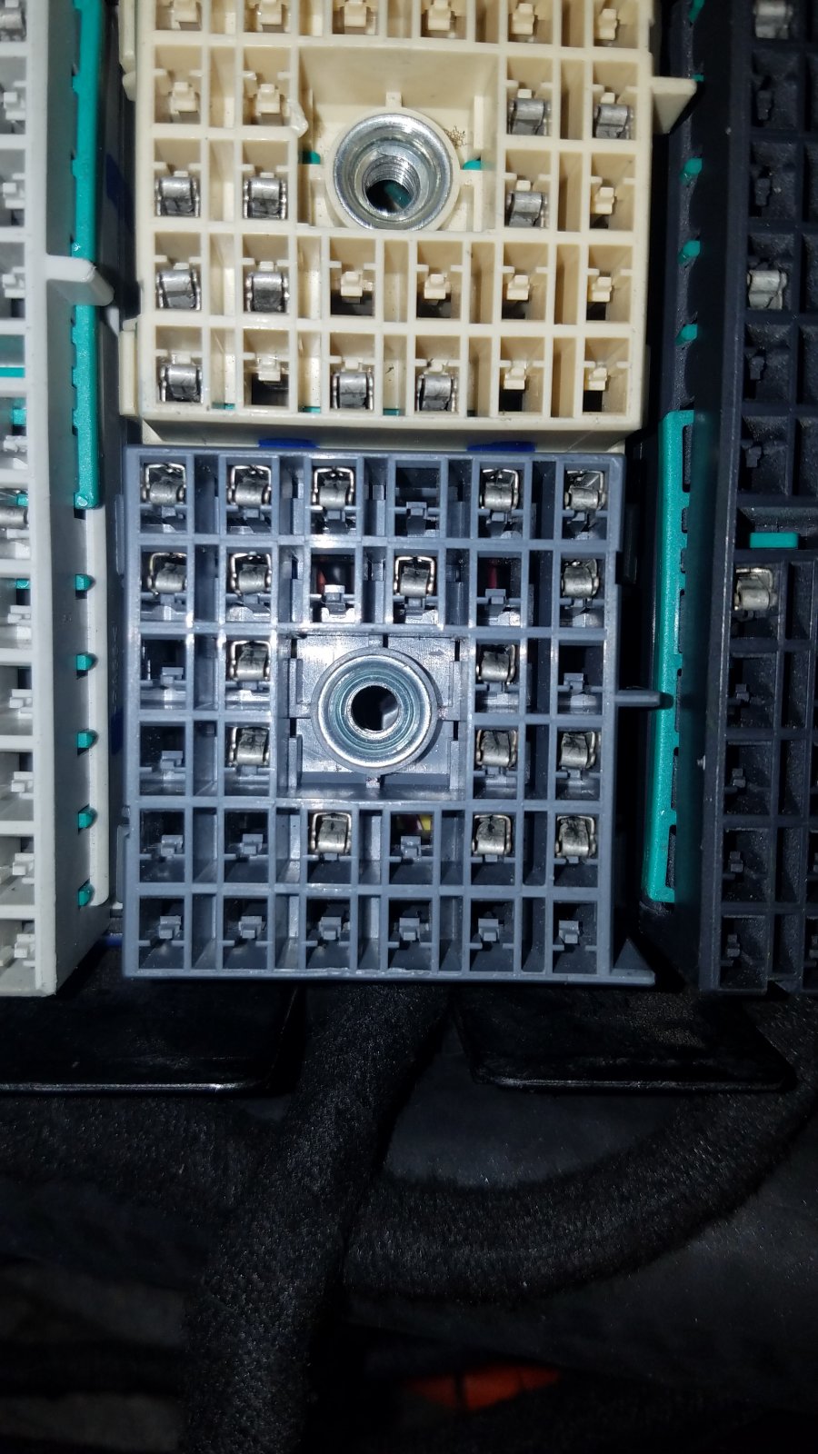

Make sure the screws in the fuse box are COMPLETELY tight. As in, you cannot turn them by hand any more. Don't use an impact for this.
Right-O! This did help but found other gremlins in the process... now the butterfly doesn't respond?!?
upon further fiddling i found that even though the fuse box bolts are tight now, the cables being jostled will activate relays...? More specifically the gray square plug's cable bundle.
I have a feeling that i'll need to have a close inspection of the plug & fuse box and check that it is not corroded or anything under the plastic. I'm inclined to draft a diagram of where the ground are on my build for sheer sake of sanity later on when the accessories come into play.

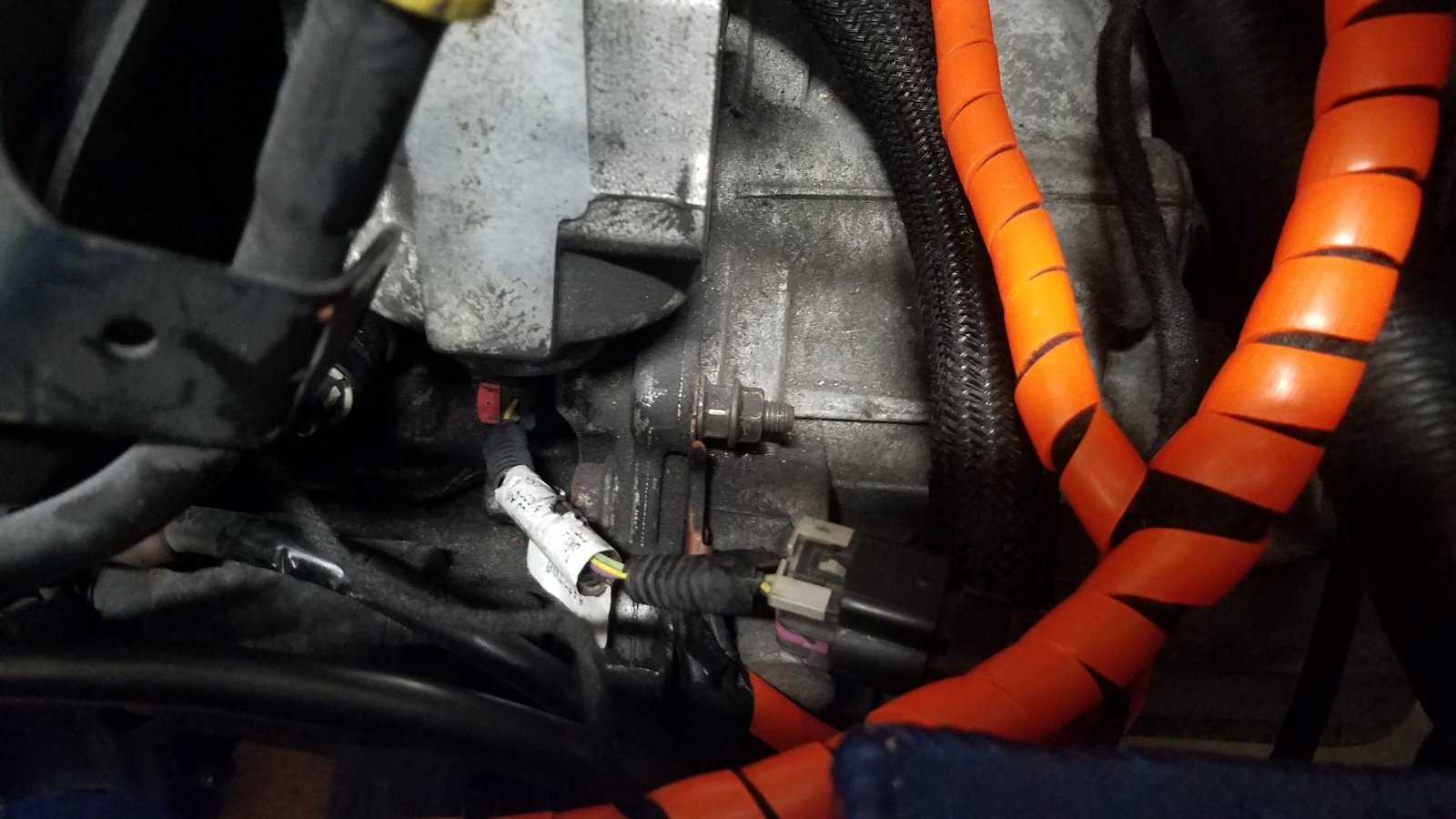

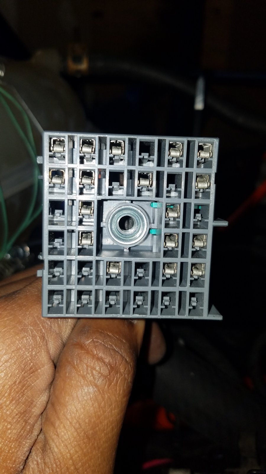

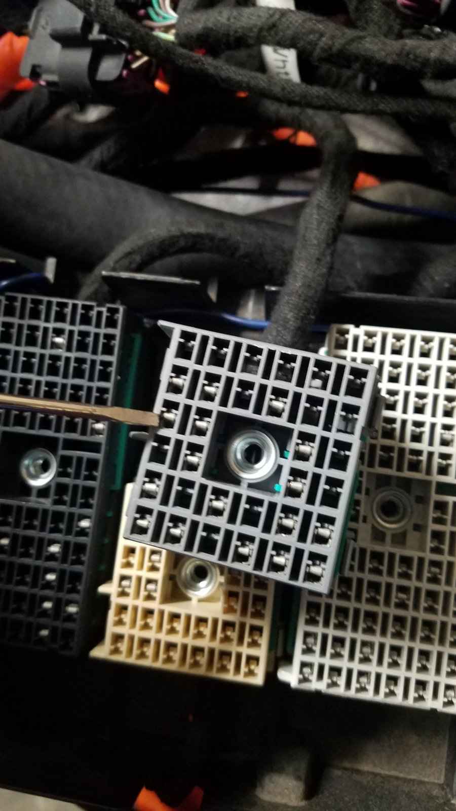

After fiddling a bunch with wire bundle positioning, I isolated at least one problem. The grey square plug in the fuse box had weak connections due to un-sprung contacts. Explaining why relays were clicking when the harness bundle moved or the fuse box position jostled.
I pulled each contact out of the plug, one by one, and pushed the contacts to make them conducive to a good connection.
Afterward I checked the ground contacts as Lonny mentioned.

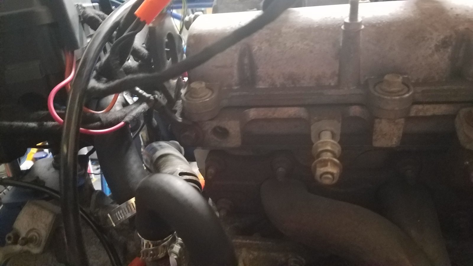

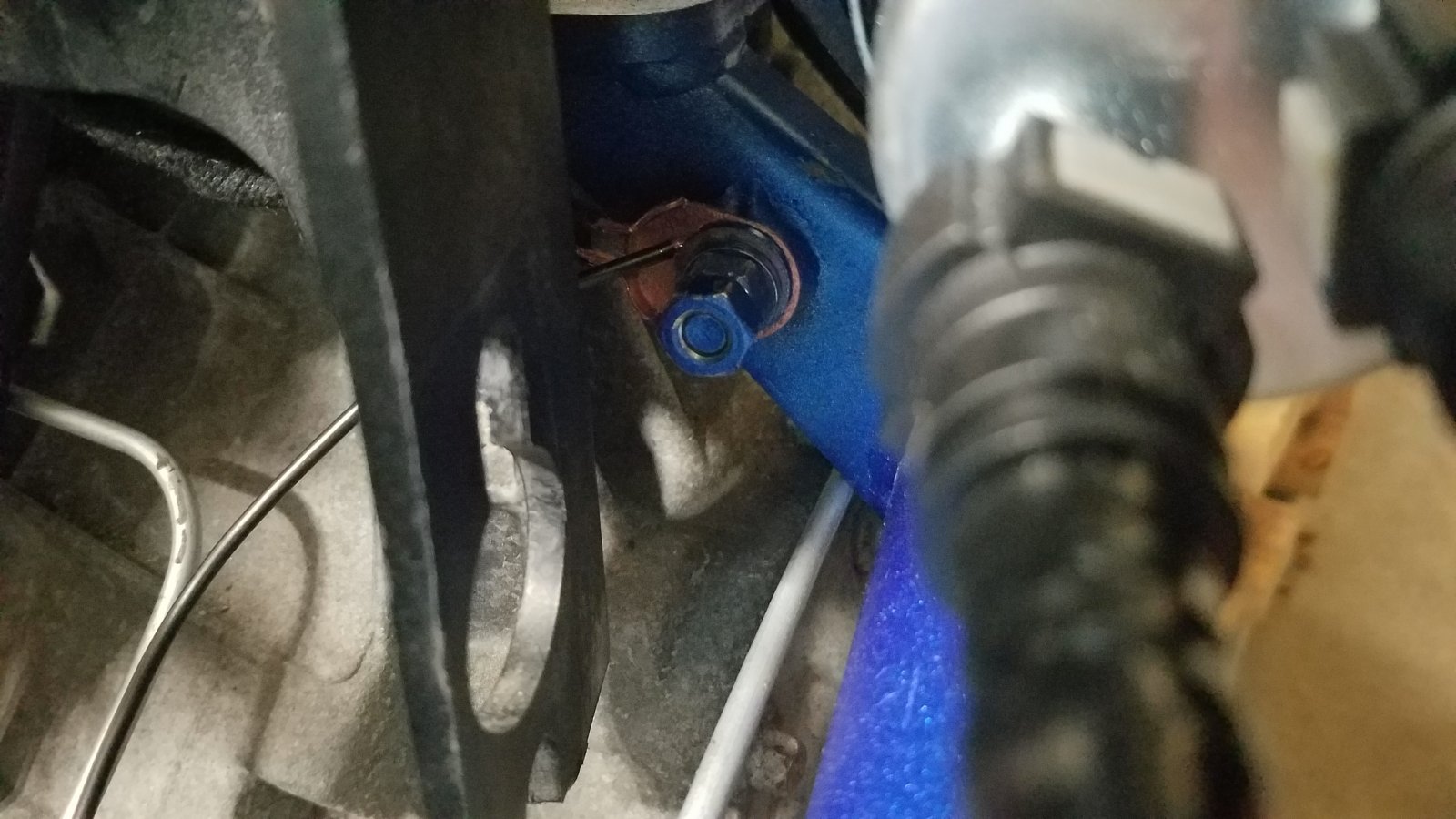

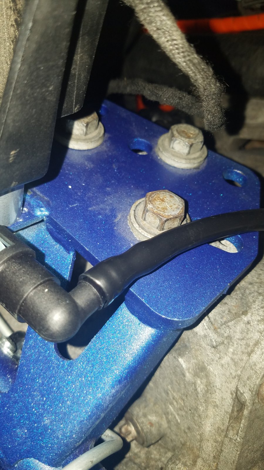

Grounding point in the tunnel where i had to extend it
Grounding contact in the engine harness adjacent to coil packs
Ground on the engine (front) near the starter
Grounding point under the fuse box, has the fuse box ground + the fuel pump ground wire
I cannot think of any other ground locations i might have missed...

My goblin (#121) has a 3 grounding spots: on the gas & brake pedal box, the side of the battery tray, as well as the same one under the fuse box.
DF eliminated the tunnel ground shortly after my frame, so I skipped using that one in my build. I also don't have the engine grounding spot that you mentioned, but technically my engine & transmission solid mounts do conduct ground for the engine.
SwerveMonkey
I forgot about the pedal box ground!! Thank You!
I'll check that next along with the spark plugs.

I double checked the pins in the fuse box related to the P0230 code for the fuel relay and even reseated connectors on both the fuse box & the bcm under the kick plate.
The cranking sounded a bit more promising until i got yet another intake "backfire" with a puff of smoke shoting out the butterfly valve.
Will continue to research symtpoms and hopefully have more info soon on why it is not starting.
