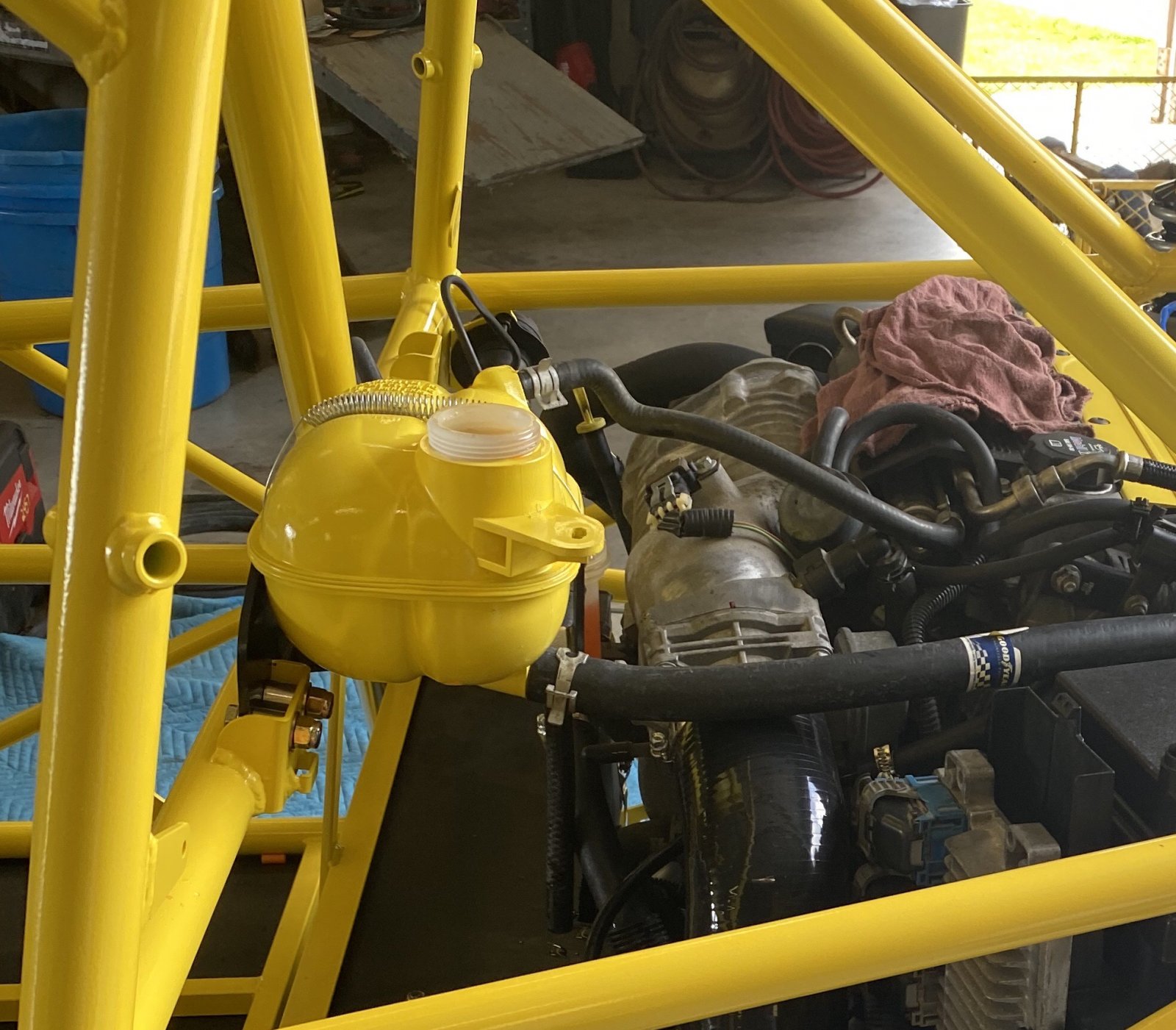

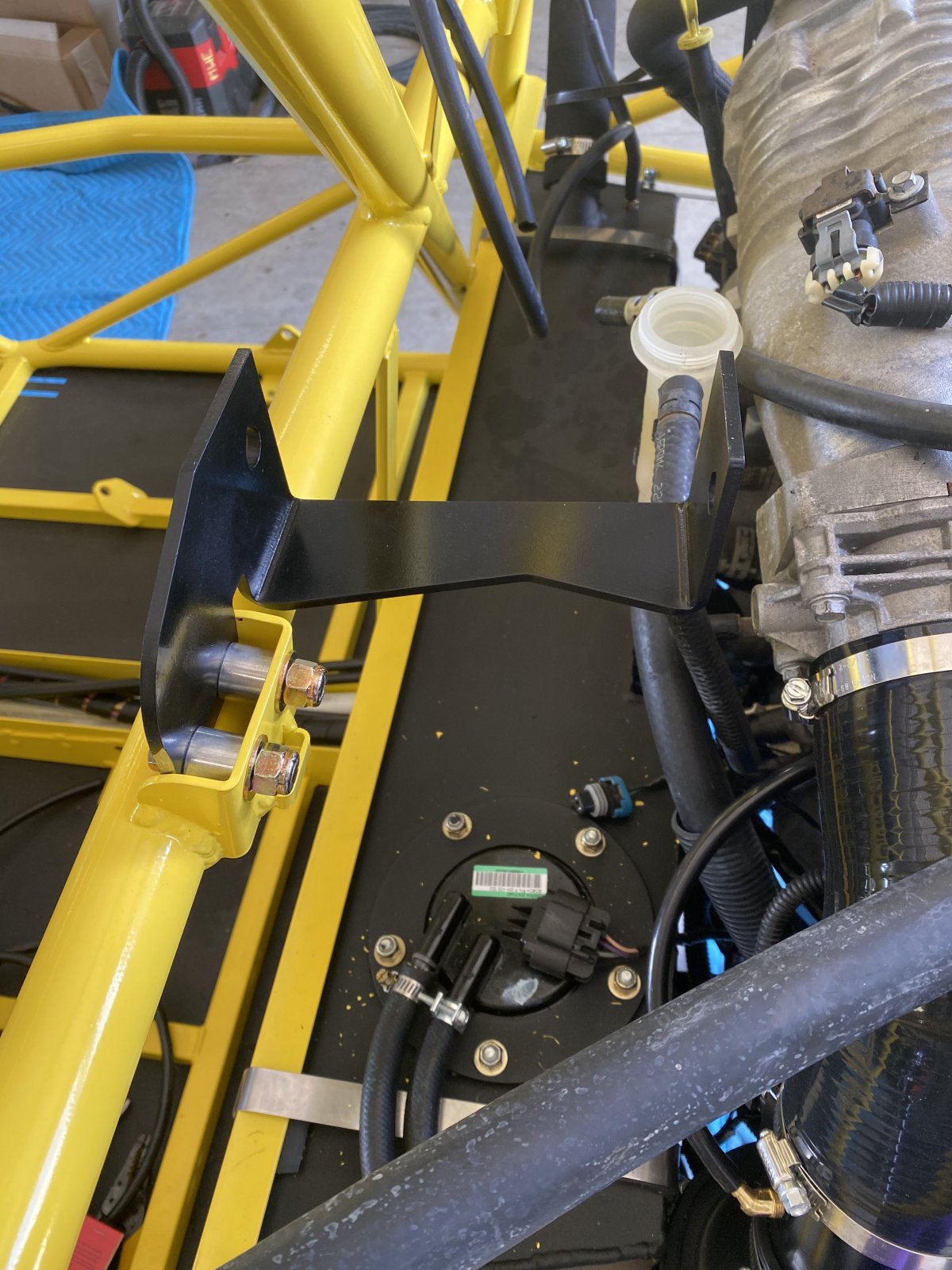

New design. You should have parts to mount the reservoir to the back of the seat area. I ended up using a different hose to go to the engine from the reservoir.
yes
i may have done the same with the hoses, but made them work.
good progress
Rttoys to the rescue!!
with all the shuffling about I ignored that bracket sitting on the bench, Doy!!
<sigh> thank you, this project is very humbling but also so invigorating when a solution comes up.
also still need to grab a 4" rubber o-ring for the fuel filter, and a coffee can ( i think it's the right size) to cover up the shell of an AC compressor that i have now, ha ha
I'll be very curious to learn if the new mounting system for the coolant reservoir allows it to clear the engine cover. It sure looks like it doesn't, that's why I stuck with the old method.
We designed the coolant tank mount to go on the other side from what Rttoys did. The spacers are suppose to move it far enough back to clear the front of the engine cover.
I think Rttoys did it that way to help clear the supercharger. We have not had an opportunity to test it with a supercharged Goblin.
Correct. I had it all the way back with the spacers and the hose/nipple would hit the air intake. Everything was in a bind there.
I moved the bracket to the seat mount (inside or outside of the mount) and it would ”work” but the air intake would push on the hose. I could see this being an issue over time.
Moving the bracket all the way forward with the spacers (like pictured), gave everything enough room to be happy.
