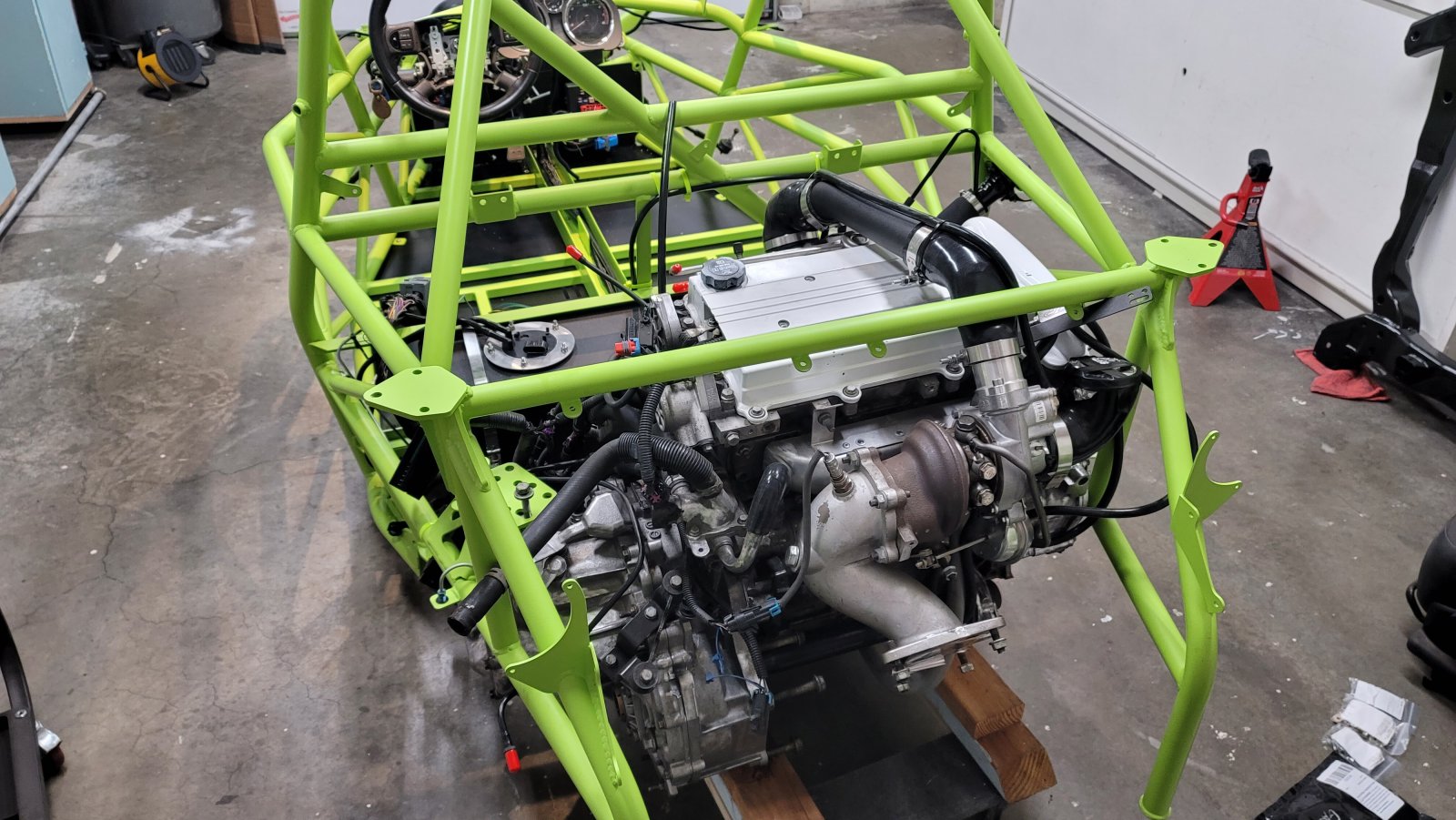

Engine is in! Ran into a problem though...

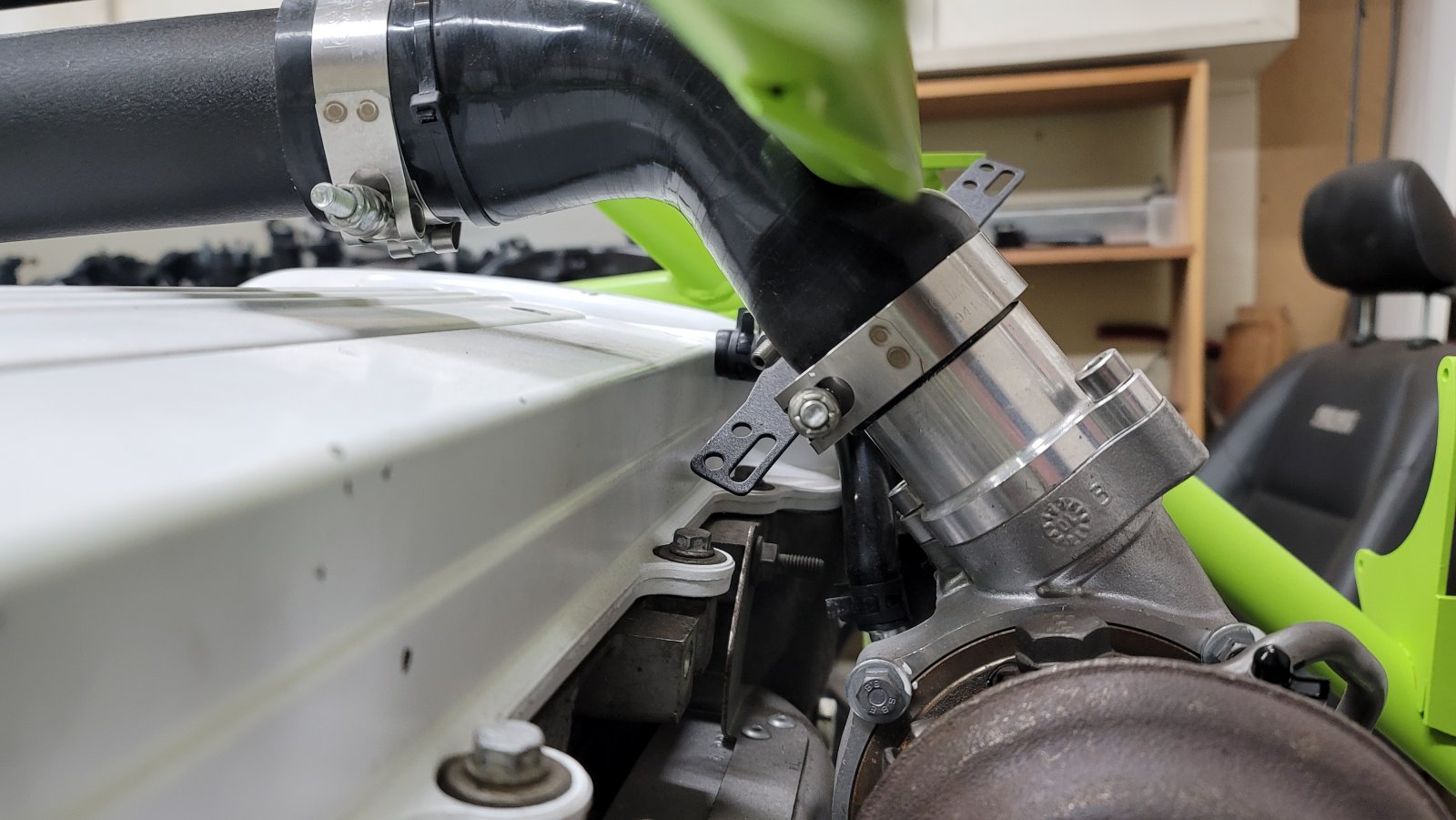

Turbo piping is being blocked by the cross member. I know this is a pretty specific issue to ZZP turbos
but any ideas would be helpful. I'm thinking of trying to shove the rubber tube onto the turbo fitting farther?

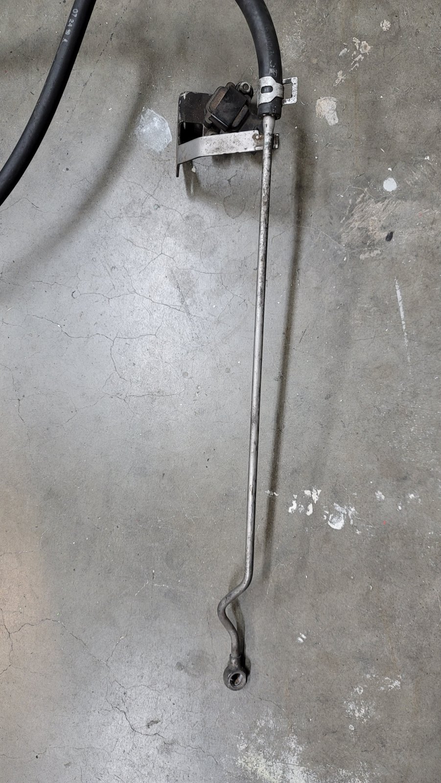

Still not sure if this coolant fitting is supposed to go back on. I remember the videos saying to remove it, but I can't understand why.

Bonus pic of LSJ in the car

Which driver's and passenger's sidemount holes are you using? The front-most holes in the mount plates must be used with the TC setup. If using the rearward holes there is reduced clearance for the charge pipes.
And the silicon pipe closest to the turbo has to be trimmed a bit to get the angles correct. This will help some too.
ToothMagician
I'm using the F35 driver's side and rearmost mounts for the passenger side IAC with the videos.
You should be able to clock the turbo housing to gain clearance.

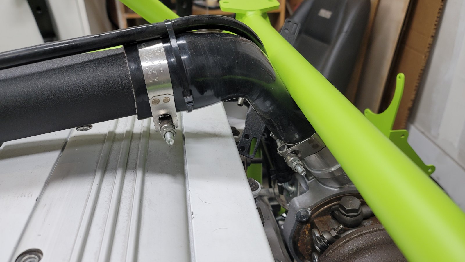

I ended up clocking the turbo, rotating the clamps and adjusting the tubing to clear the cross member. It rests gently on it now and one of the clamps rests on the ignition coil cover, but I think it'll work. I'll take a pic soon and post so y'all can see what I mean.
