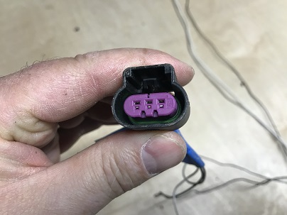

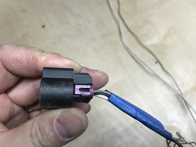

Wiring Harness Video 3 Question
I've completed video 3 where we remove all the connectors and wires on that long branch of the wiring harness, but once the video was over and all the wires on that branch were removed in the video I had one connector left that isn't covered in the video. When I was unconnecting everything during the stripping of the donor, I tagged this connector as the "ground sensor". There are a couple pictures of it below. It has a grey, white, and black wire connected to it. The question is, can I remove this connector and it's wires completely or should I leave it alone for future use?
Thanks in advance for the help.

Joebob
One thing to note as you get to video 10 or so and extending lines, is that the Automatic shifter plug needs to be extended 20" or so toward the ECU. I left it as it was stock and for good measure I went and watched the original wiring videos which is for a 2.2L automatic and saw that they extended the connector. I will have to extend mine once I start fitting into the frame. It is a good idea to watch all the original videos to make sure you don't miss any base model things as the new videos are Turbo/manual centric.
