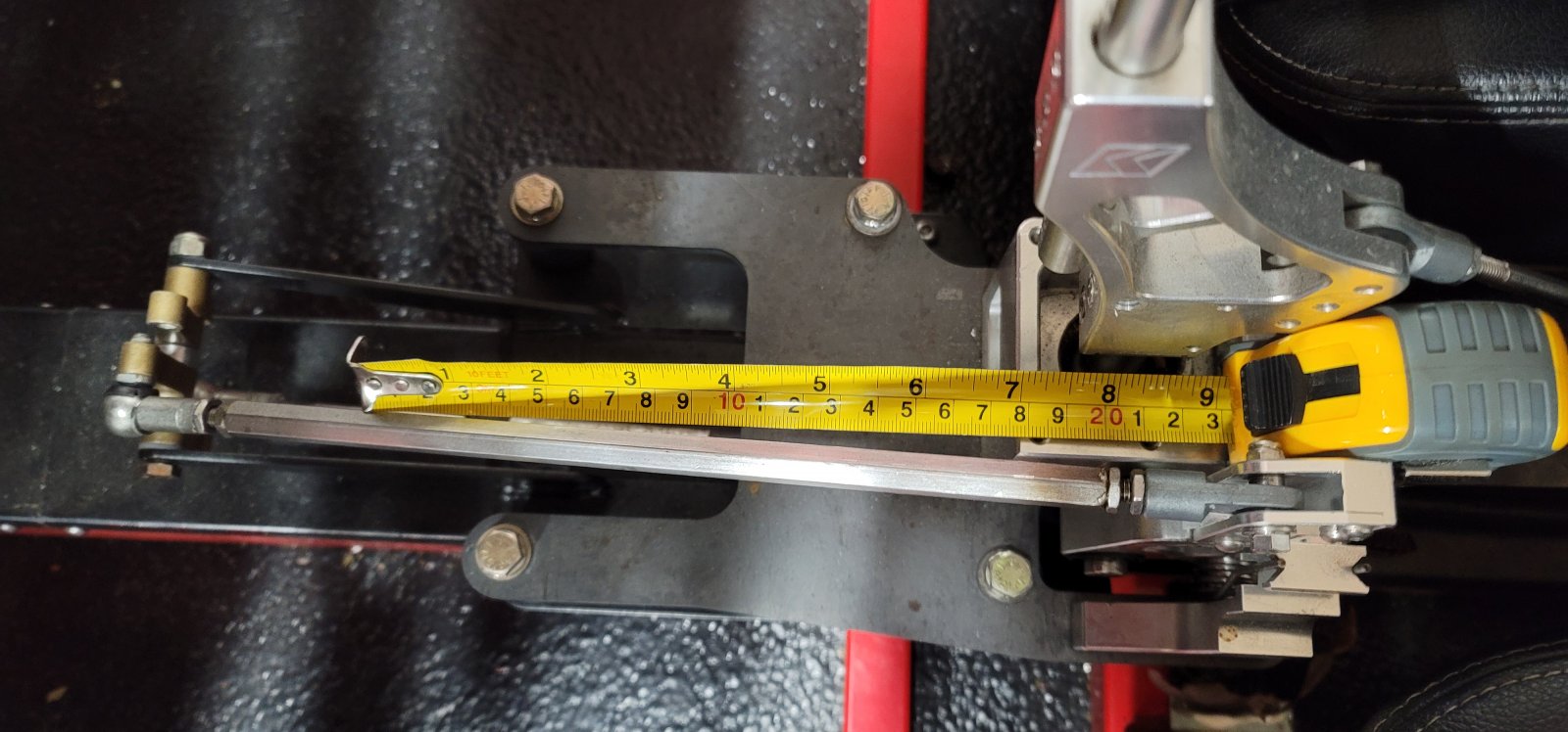

Figure about 7" or so, I think. I was just comparing by bending a pieces of 1/4" and 3/8" that we had laying around the shop. The 3/8" thick aluminum all-thread was not hand bendable in a 2 foot long section. :)
Actually, I also looked up the tensile strength and sheer limit of both and took a WAG that the deflection would be comparable. The 1/4" SS 18-8 all thread has a TS of 70,000 psi to give a TS of the 1/4" rod of 2,520 and sheer of 1,580 using 60% (as a guess). The 3/4" 6061 all thread has a TS of 40,000 but the extra thickness gives a TS for this rod of 3,100 and a sheer of 1,860 using the same 60%. The 3/8" aluminum rod is about 23% stronger based on this math.
I am definitely not an engineer so I just looked up formulas and tensile strength area of threaded rods online (engineeringtoolbox.com and there were a couple of bolt mfgs that had the same formulas) and this seemed pretty accurate based on trying to hand bend the threads that I had at the shop. Let me know if these are wrong or if I'm going down the wrong hole.
You really have to use the Modulus of Elasticity for Metals (amesweb.info) which is a measurement of how stiff a material is. This if factored with the shape. A hollow rod will be stiffer that a solid rod for the same material cross section area. Here is an online calculator for bending; Deflection calculation (converteraccessory.com) for a rod.
But it looks like my first guess was wrong and the deflection of a 3/8" AL is about 1/2 of 1/4" SS for the same load. The moment of inertia for the larger diameter over rides the higher Mod of Elast.
This is not really a comment on whether the deflection of the 1/4" SS would be a problem, but if the 3/8 AL is at all questionable, the 1/4 SS would be a lot worse.

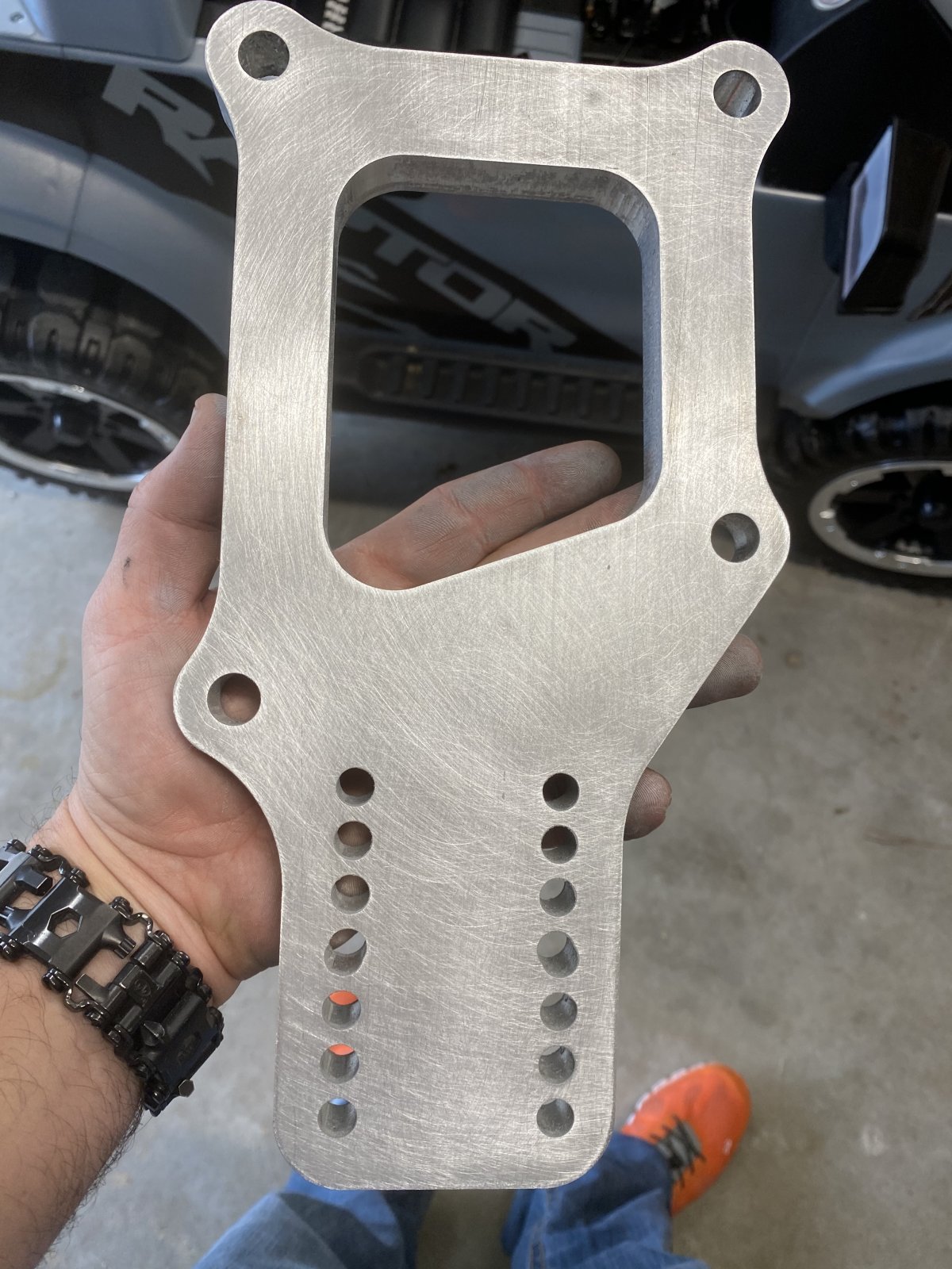

I drove the car for about 100miles of mostly city style driving this weekend, tuning for the TVS, and the shifter performed flawlessly. There was some pretty aggressive driving involved :). The wood base started flexing a little and that made me glad we went with the metal we did.
TheNuker got me the first metal base to install and I took about 10 minutes with 220 grit sandpaper to put a quick random brush on it. It looks nice but does need some edge work. That'll be with sand paper as well. I'll be installing it today or tomorrow to confirm fitment one more time and we'll be good to go.

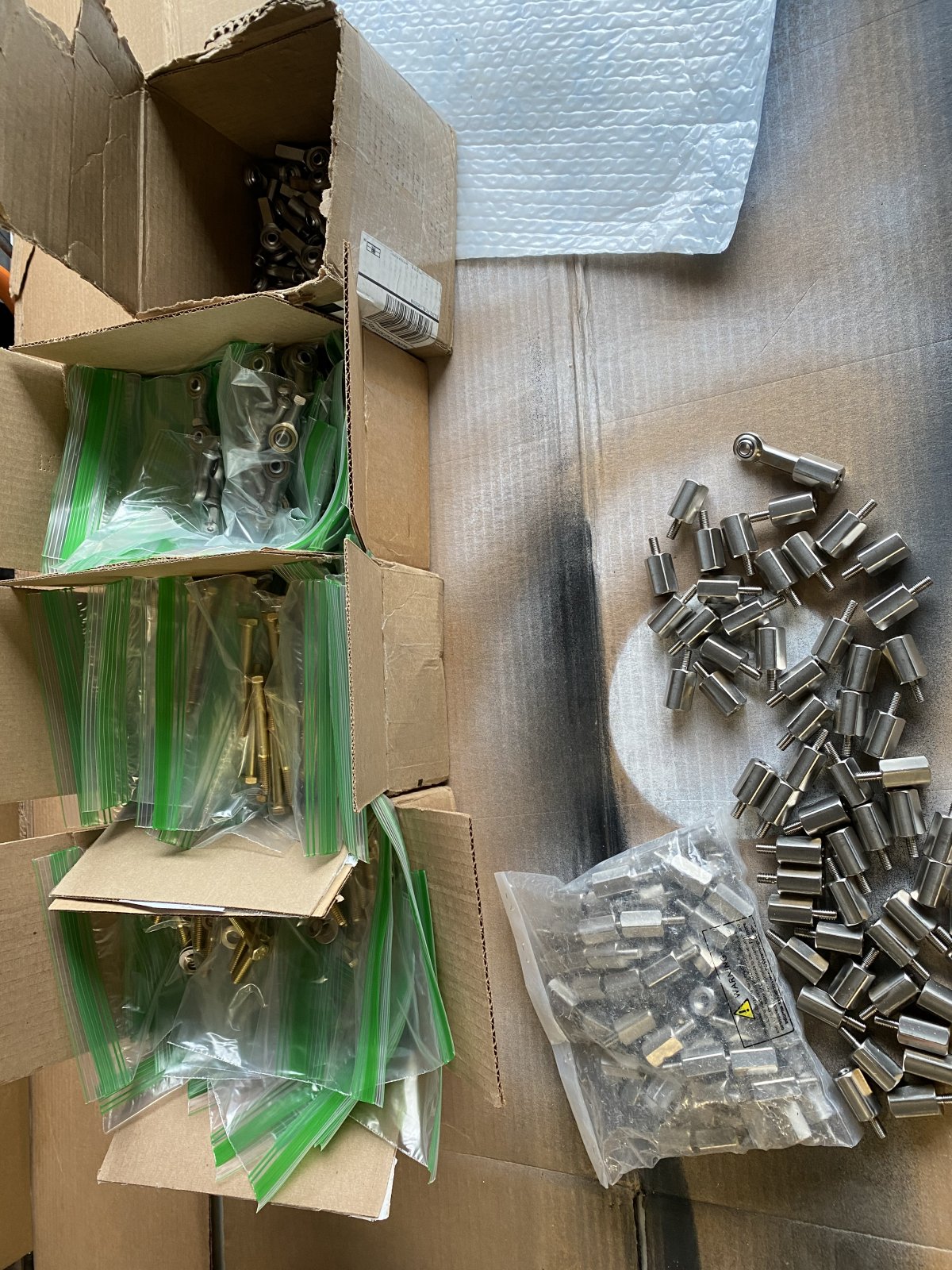

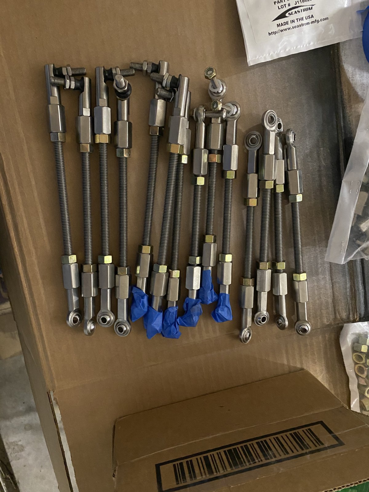

Sorting day and a real surprise!
We ended Up getting the back ordered parts early. Ladies and gentlemen we have enough to fill everyone’s orders on the first go around. I had no idea it came in because I ended up getting so many boxes of hardware I lost track of it all!
The first set of hardware went to @TheNuker today so he can do a mock up install blindly and confirm that everything works the way it supposed to on his car as well before we start shipping these things out to everybody.
The first delivery of shifters from China was being delivered today. The rest will probably be delivered on Monday.
The rest of the day will be cutting all thread and putting stuff together.
We are getting very very close.
Please make sure to pass this on and let everyone know if you like it once you get it. In order to make pricing work I had to order 50 sets of hardware. Basically, most things come in sets of 25 or 50 and the way the price breaks worked out it was better to go ahead and order enough for 50 full sets. I have a large amount of money in parts sitting on this table. I would appreciate y’all’s help getting it moved :)

The shifters arrived from China yesterday and we are getting started on modifying them this week.
We're still putting together hardware sets. Alan likes working on them. They're like big tinker toys. The sets will be shipped with the all-thread cut to fit the furthest rear adjustment holes (as they fit in my car and hopefully TheNuker's car). If you move it forward, you'll cut ~1/2" for each set of holes you move it to the front of the car. It's aluminum all-thread so it cuts in about 3 min with a hacksaw. The short one is the left-right connection and the longer one is the front-back connection. They can only go one way but I thought it'd be good to put it here.

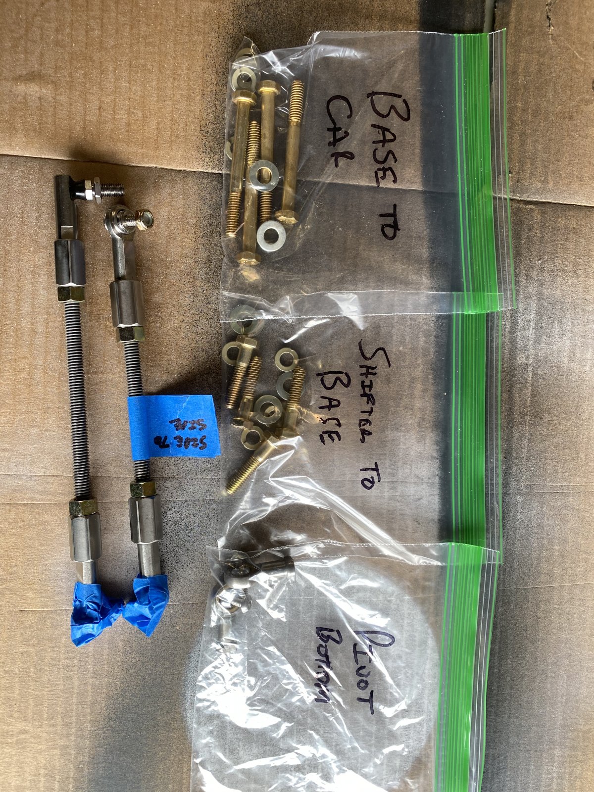

One more question, everyone should kind of know how to do these but I wanted to see if anyone needs instructions.... They're going to be shipped with the linkages assembled, the screws in separate baggies, and the lower pivot SRE in separate bags. Let me know if you need some instructions. I don't want to leave anyone hanging and not able to install.
SACTX
I believe the installation will be pretty obvious. A few key close-up shots of your shifter should be all that's needed, methinks.
That's what I was thinking but I wanted to make sure no one was left hanging. They essentially install just like the stock ones do with just a few changes.
