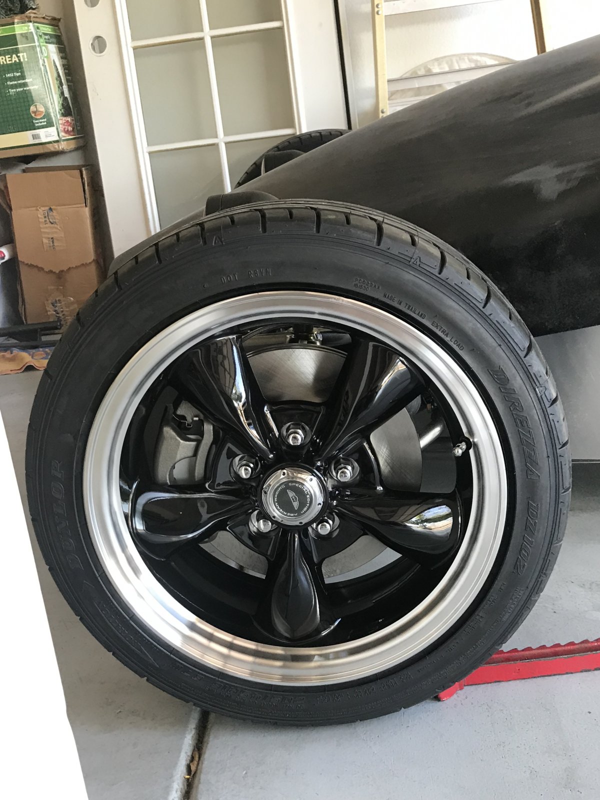

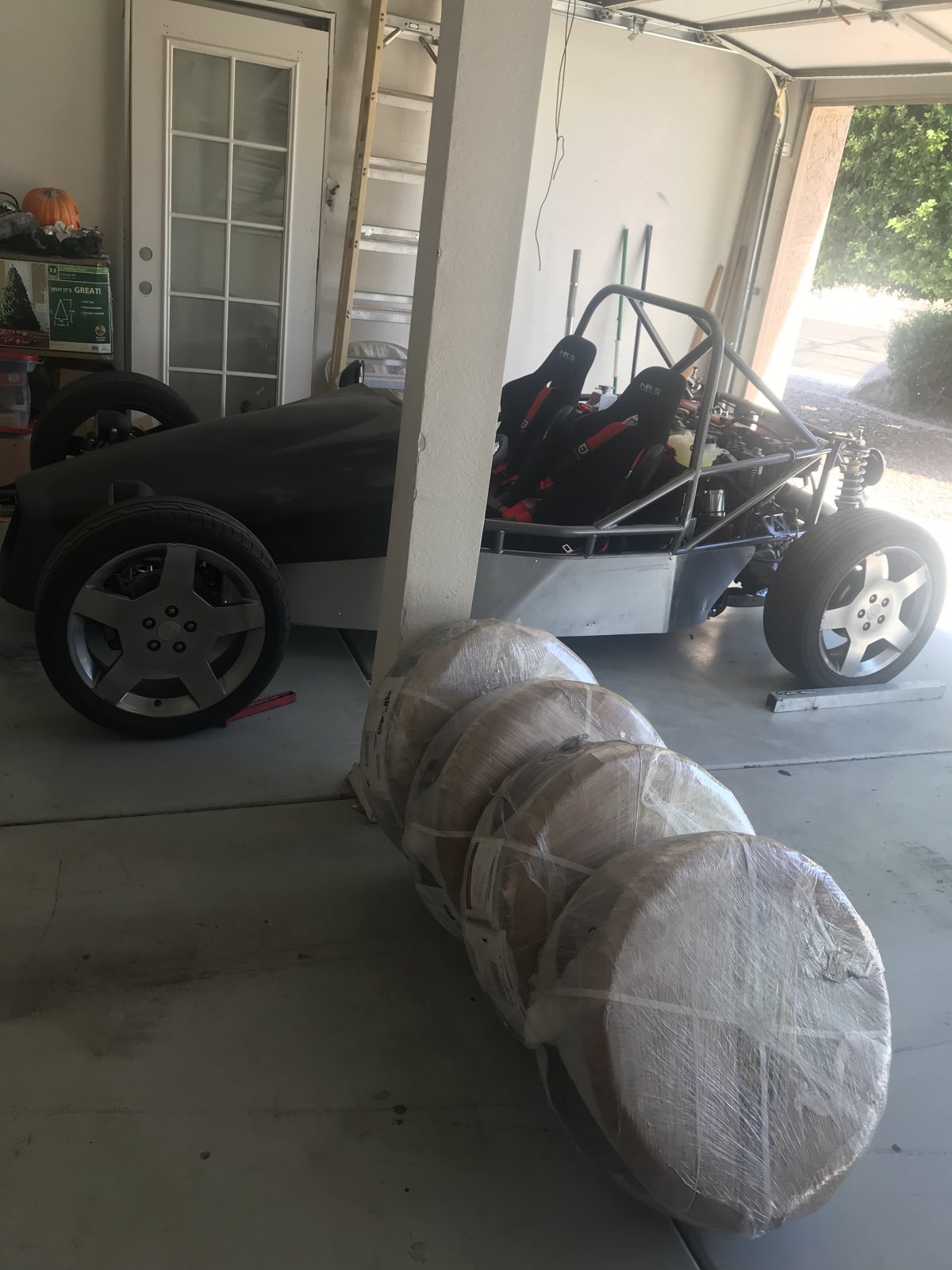

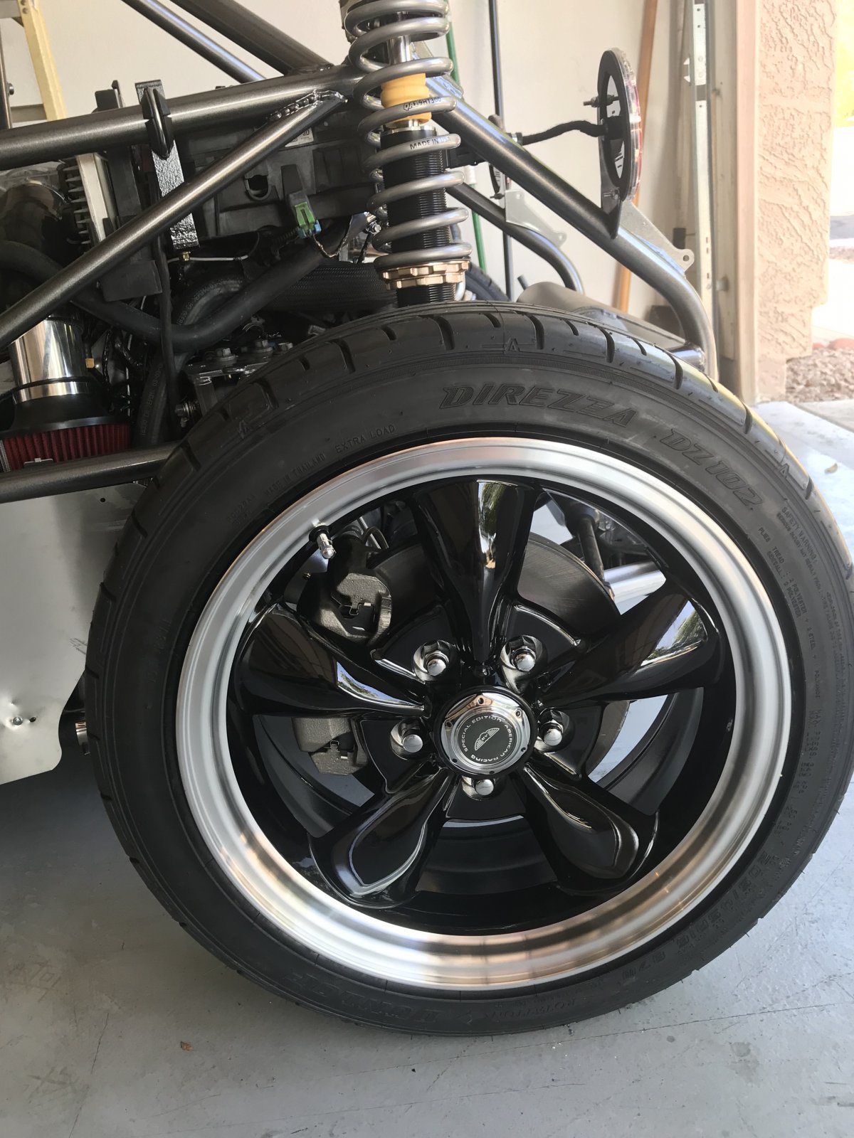

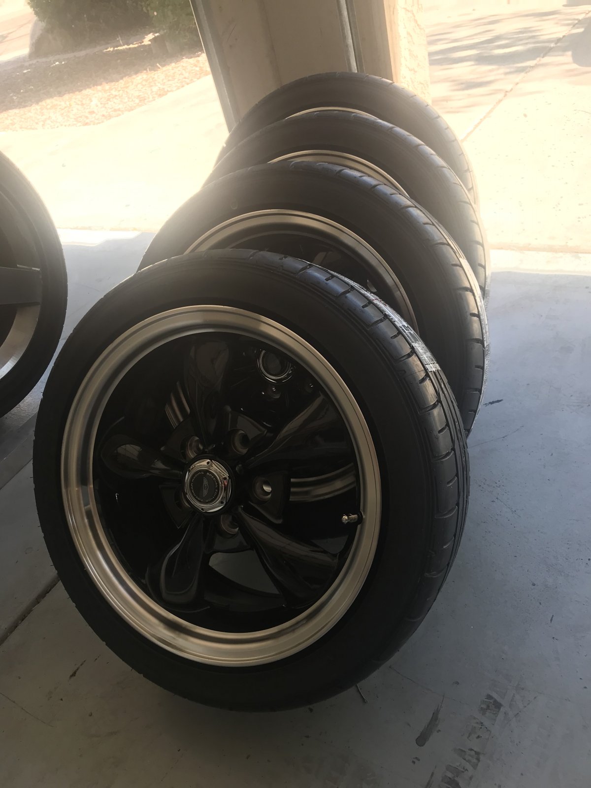

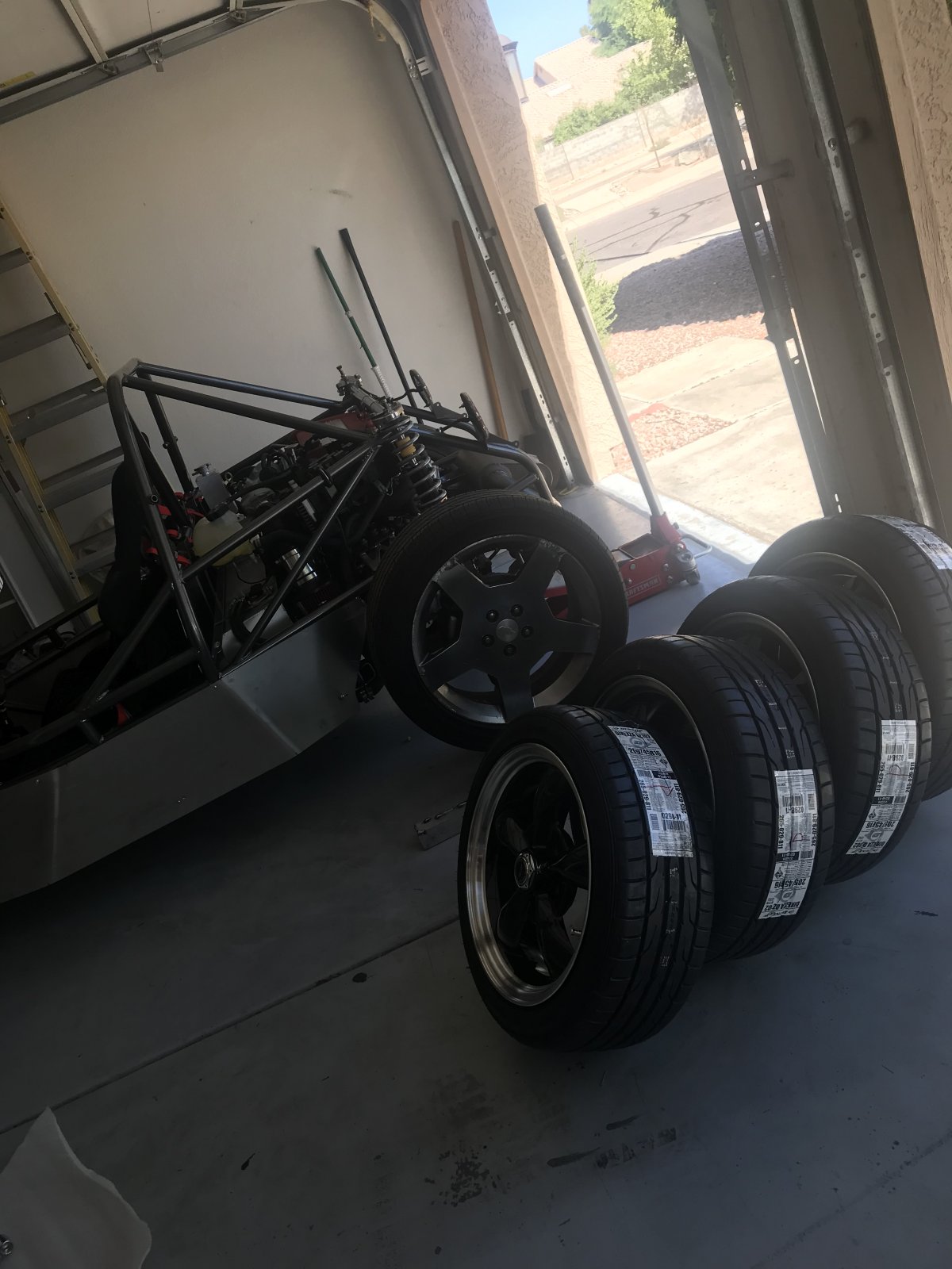

The updates are slower these days, but they are still coming!! Received he wheels and tires today, and live them. They fit great, and look amazing. Nothing like a nice brand new set of wheels and tires. American Racing, Torq Thrust, 16” x 7”, 205-45-16’s.

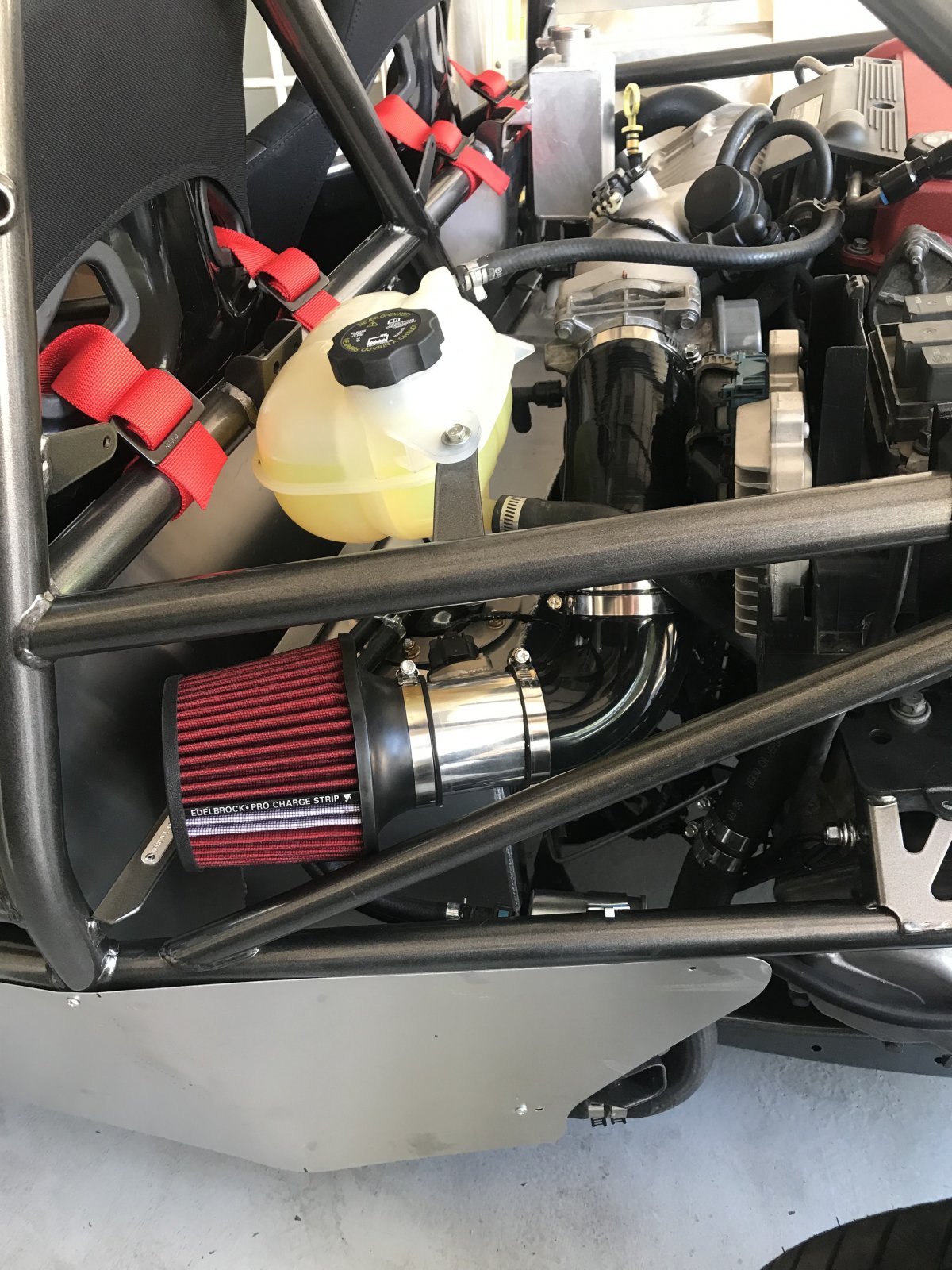

Today I also fashioned a new air intake. Something a little different. Very easy to put together. I like it, and think it gets the filter in a much more open area than I had it. I may even make a shield and maybe a scoop for it off the side.

That by far is the best looking intake on a SS/SC I've seen done. I was planning on doing something similar and making a scoop too.
Off the shelf parts?

Thanks. Yep. Off the shelf pieces from Vibrant. I used the 45 elbow provided. Trimmed it slightly on one end. Then a 3” aluminum coupling. Followed by a 3” 90 elbow trimmed on both ends. MAF. Filter. I just had to buy the coupling and the 90.

Should be fine as long as you stick with a fairly conservative tune, but MAF sensors usually prefer to have a bit of straight tube before/after to get an accurate reading. You may not notice a difference, but if you're going to try to push for more power, I might try to figure out a different setup. Looks good though, and awesome to have it on the road!

I'm not too worried about that. The stock intake has even more bends to it. My tuner said that with the IAC being controlled solely by the throttle blade on these cars, the short, straight run between the throttle blade and MAF may actually cause resonance back to the MAF, screwing with the readings. So we will see if this helps with a slightly smoother idle. Maybe, maybe not. I just like the positioning of the filter more.

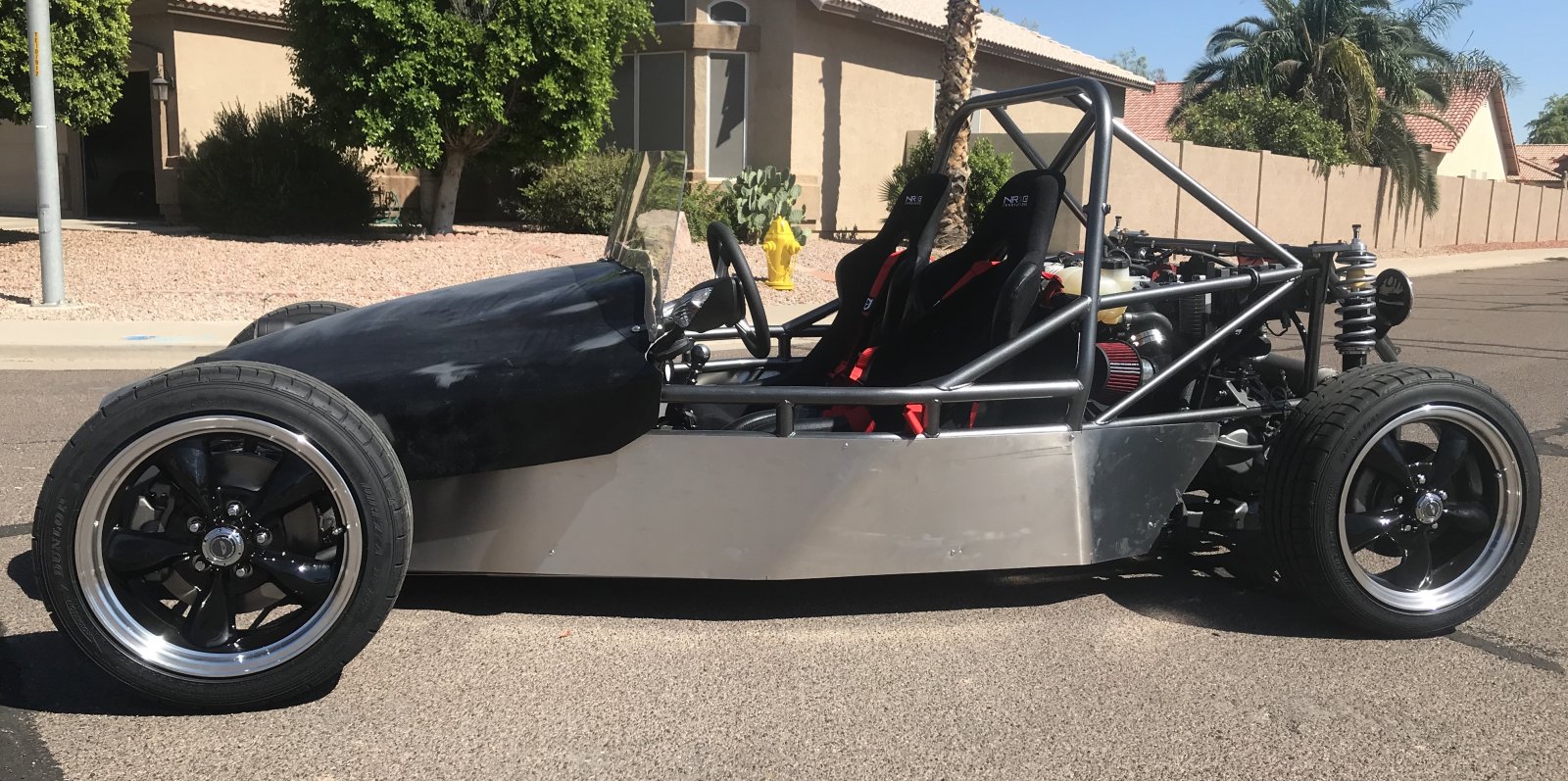

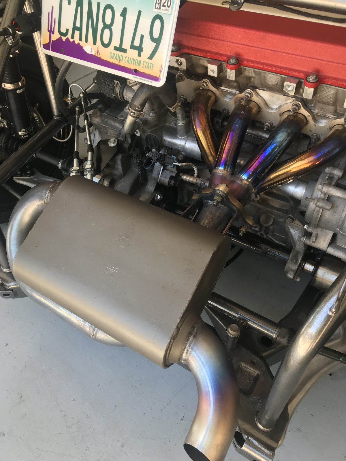

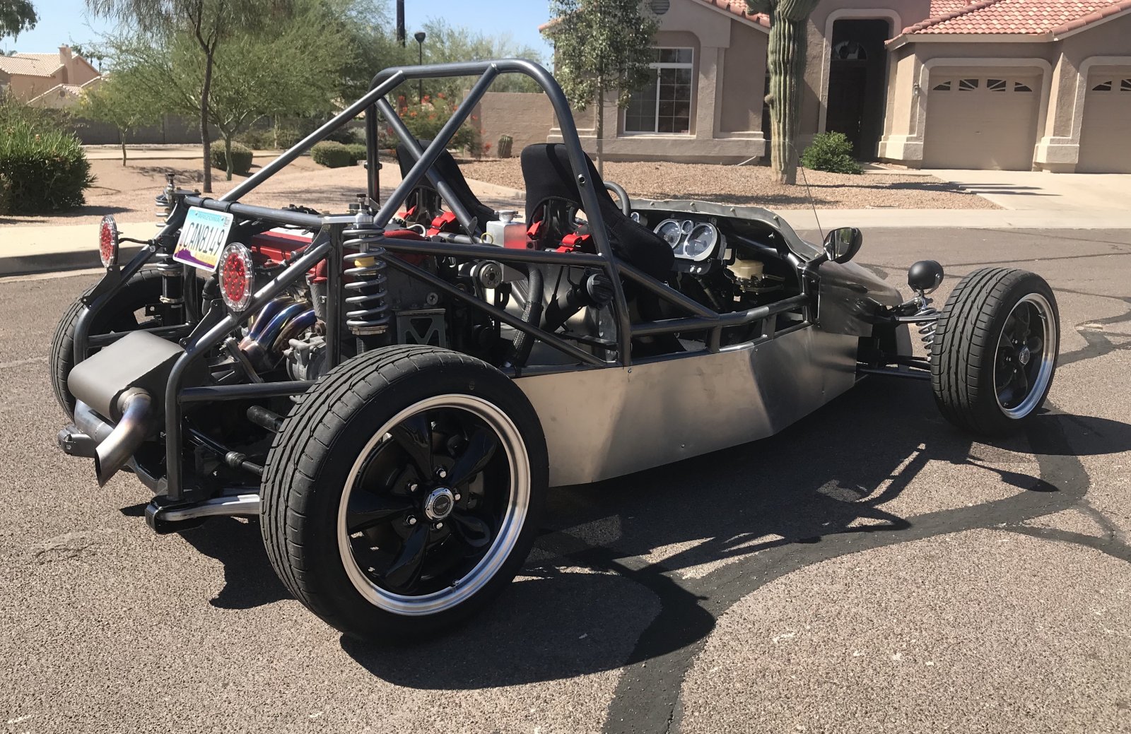

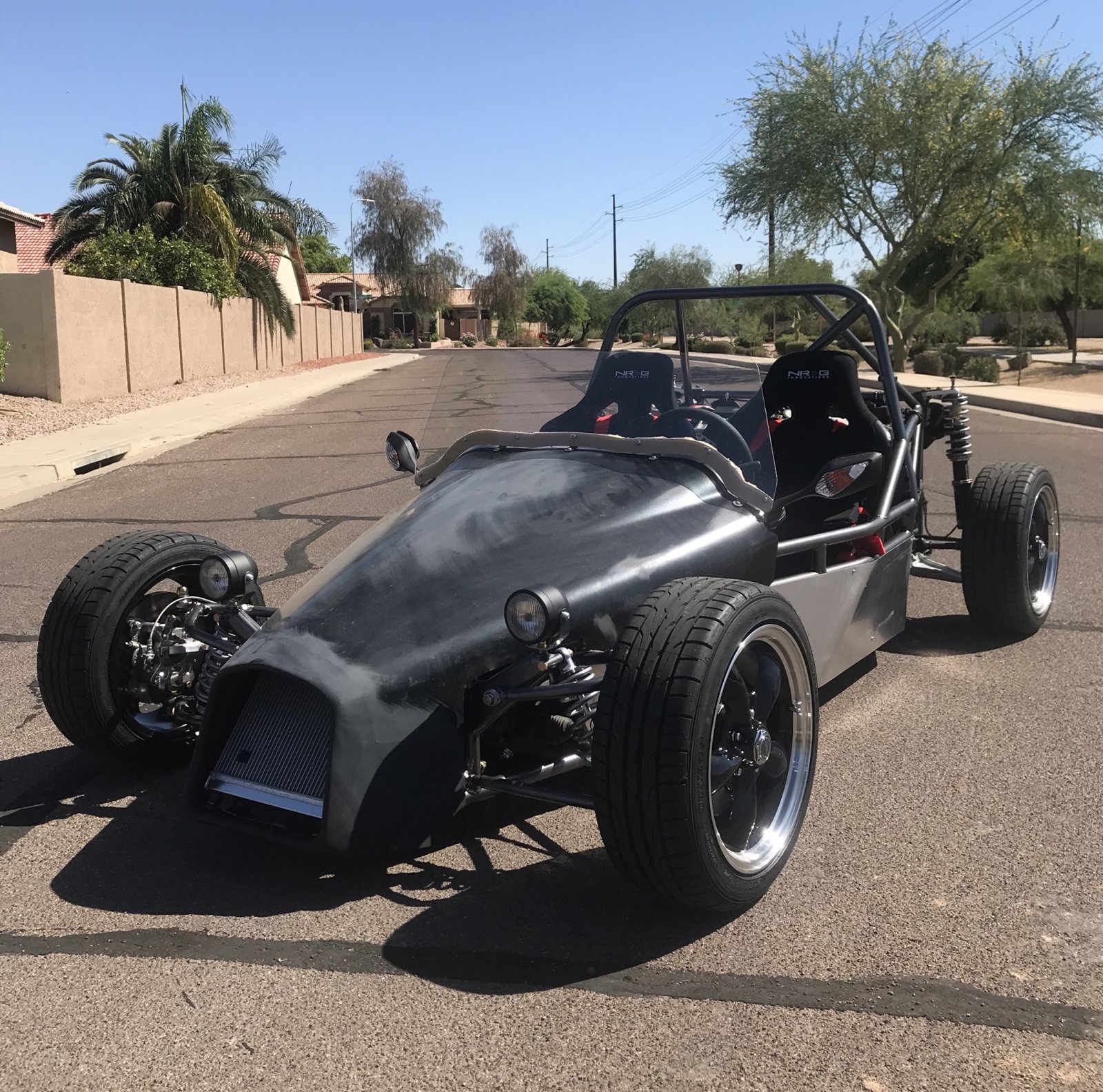

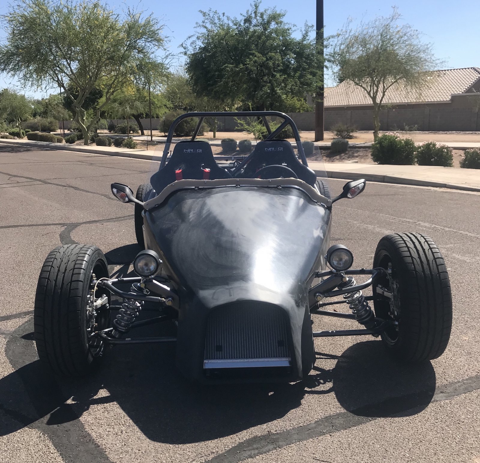

A few pics from the weekend...
