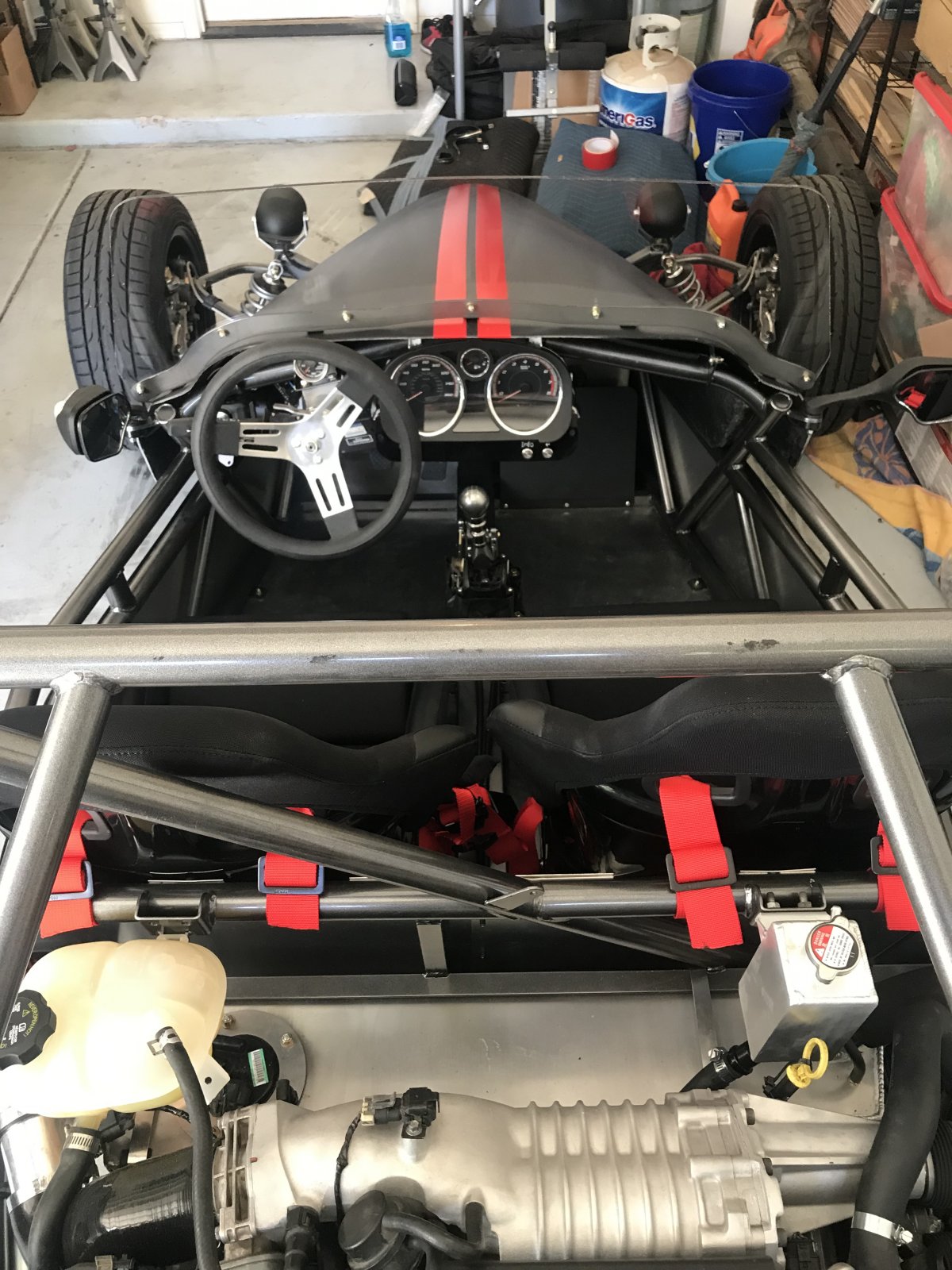

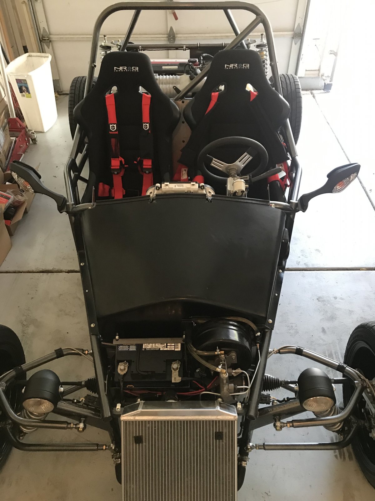

I installed my footwell cover today. Lots of cutting and fitting. Used some foam seal where it touches the frame. It serves its purpose.

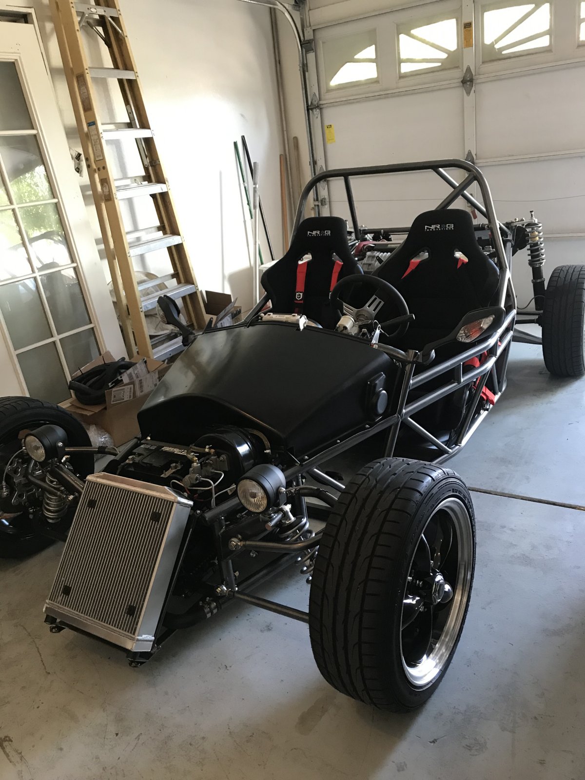

askiles

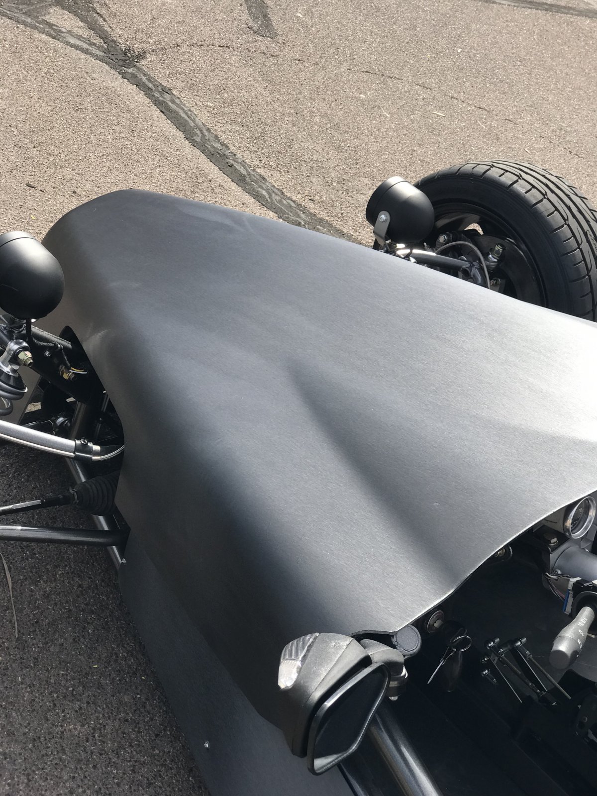

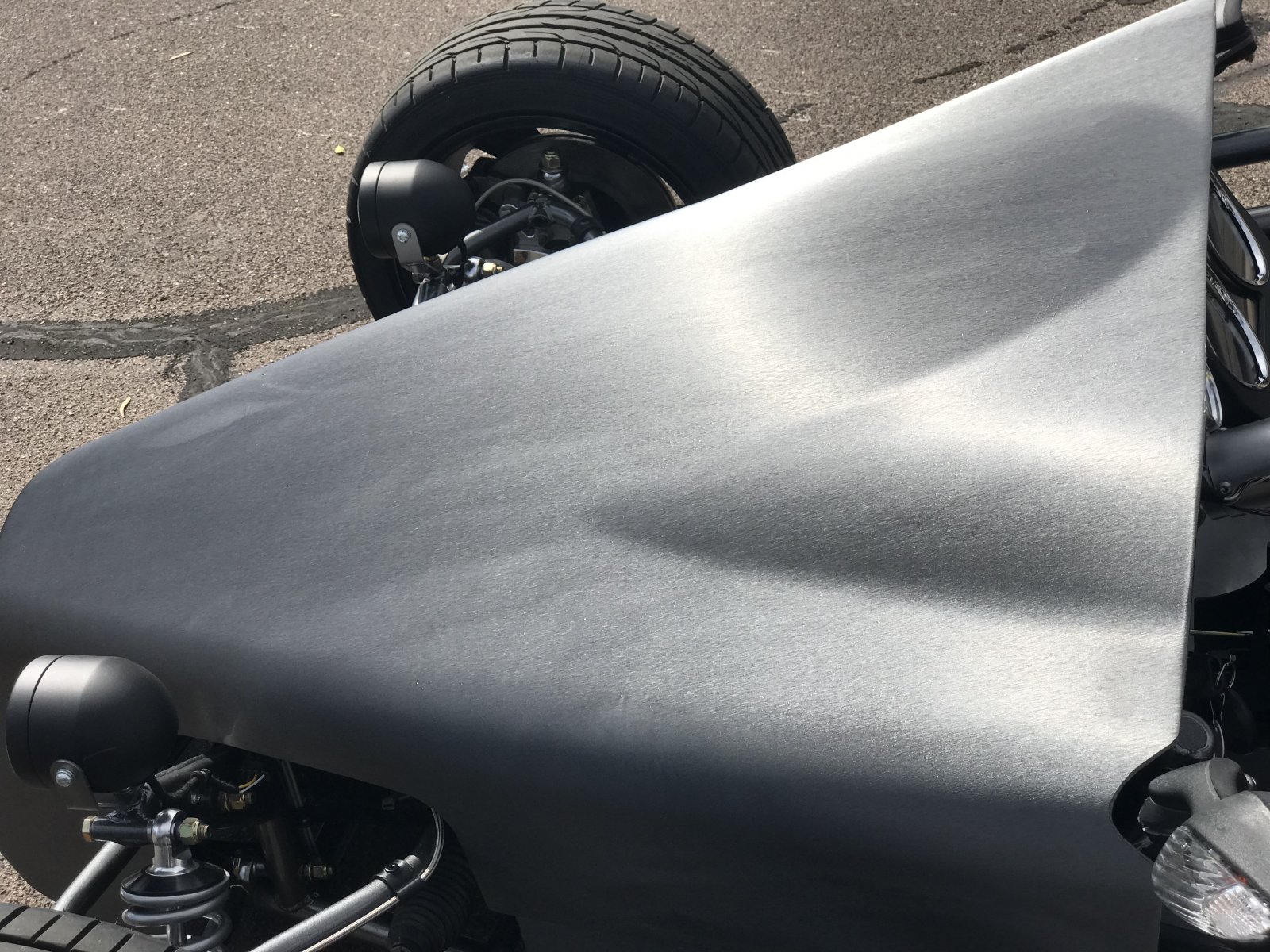

Brushed gunmetal wrap installed. Really love it!!

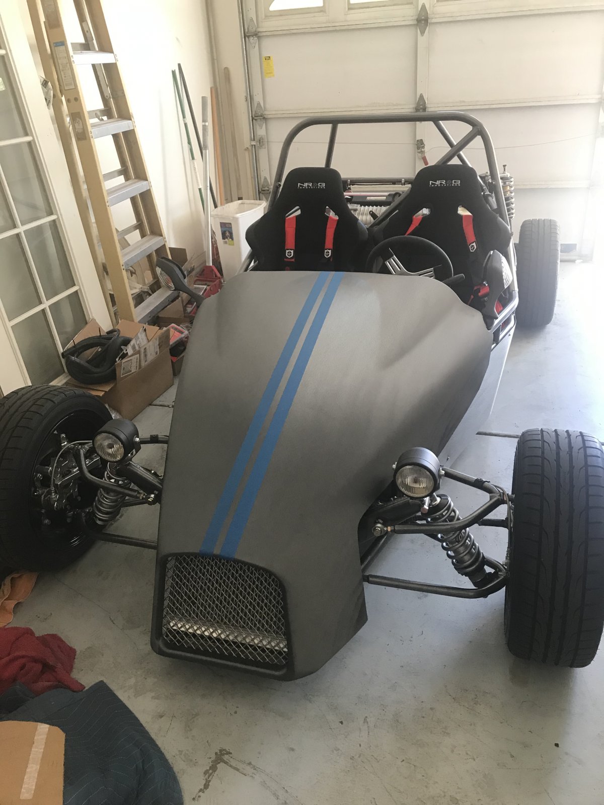

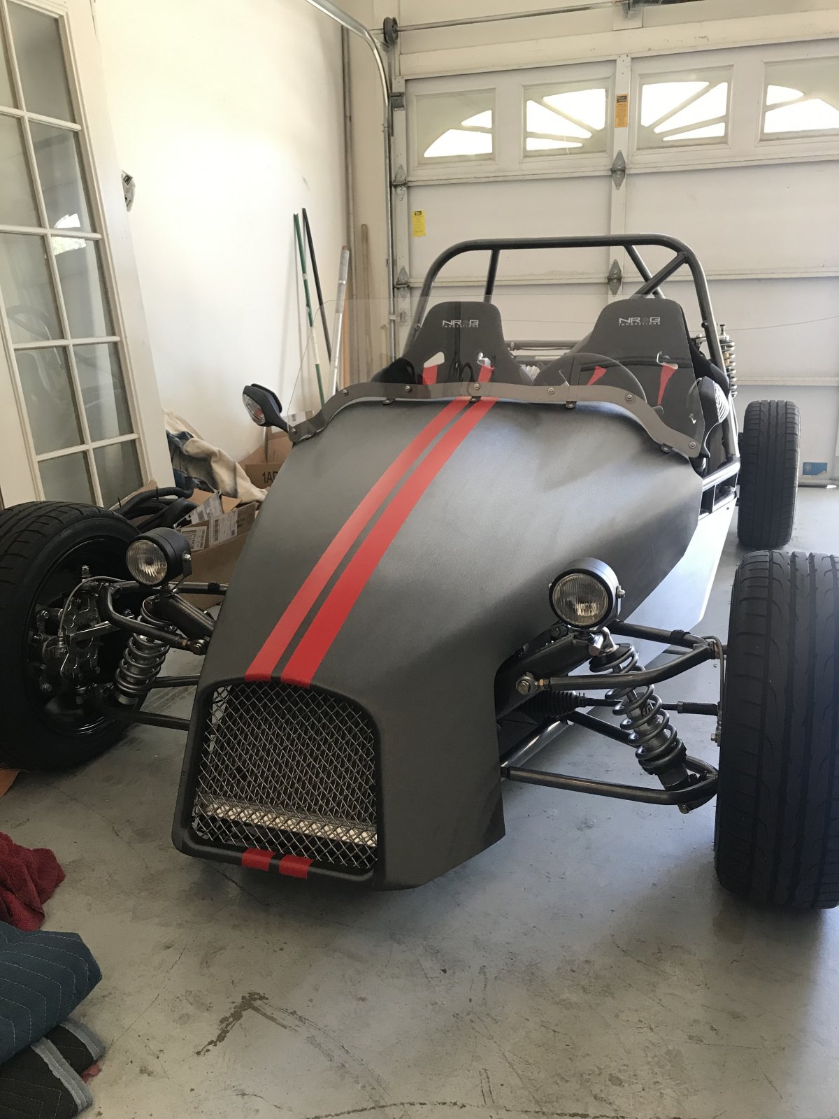

askiles

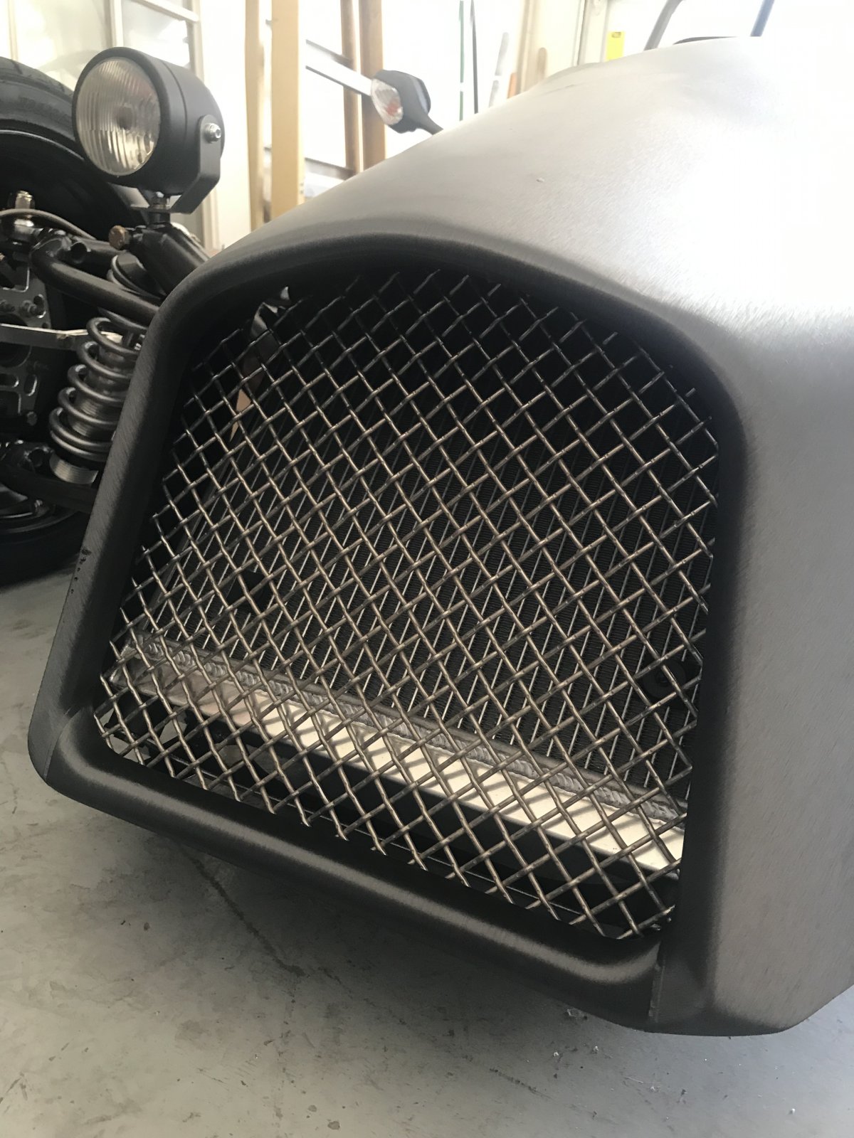

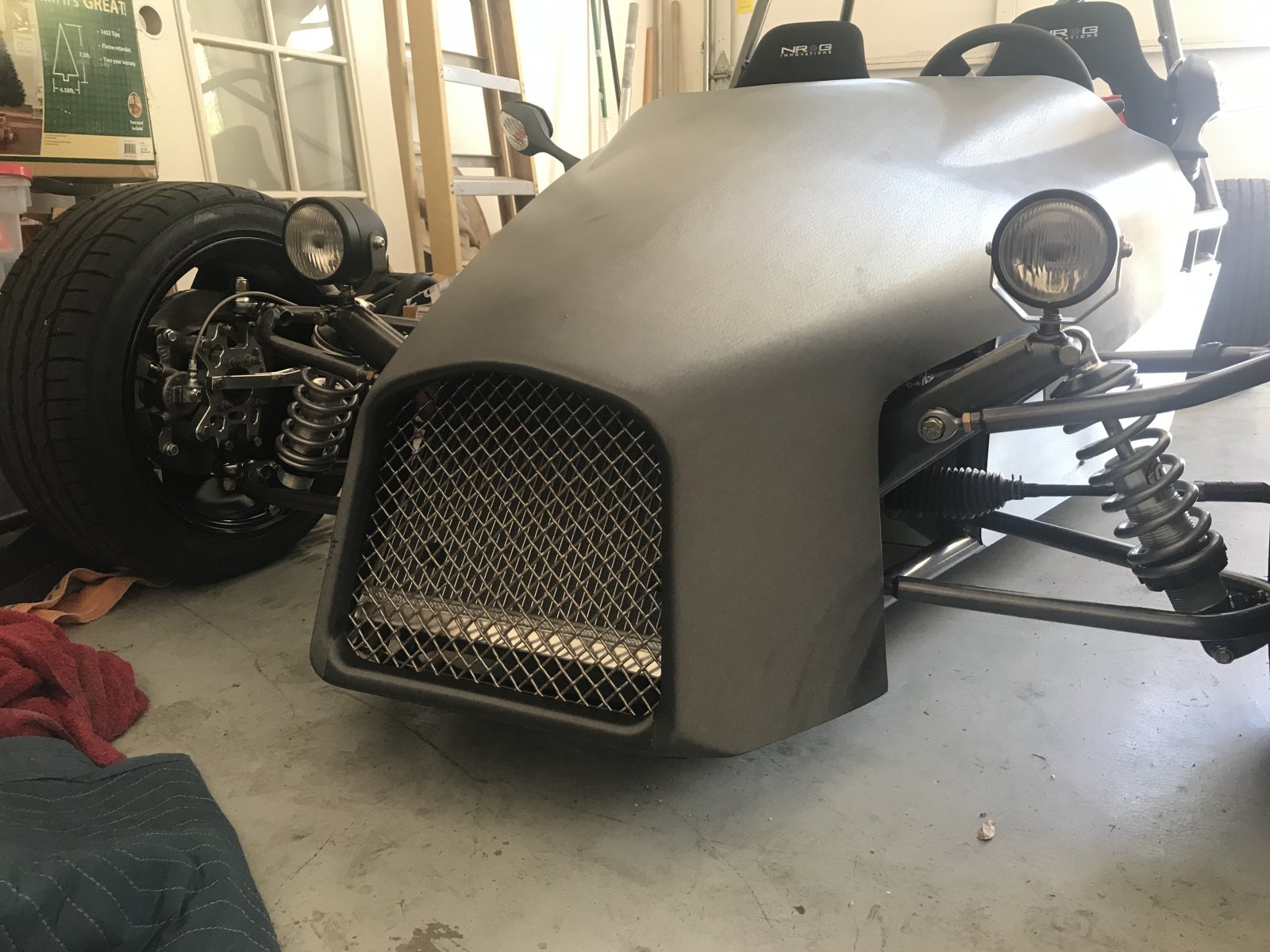

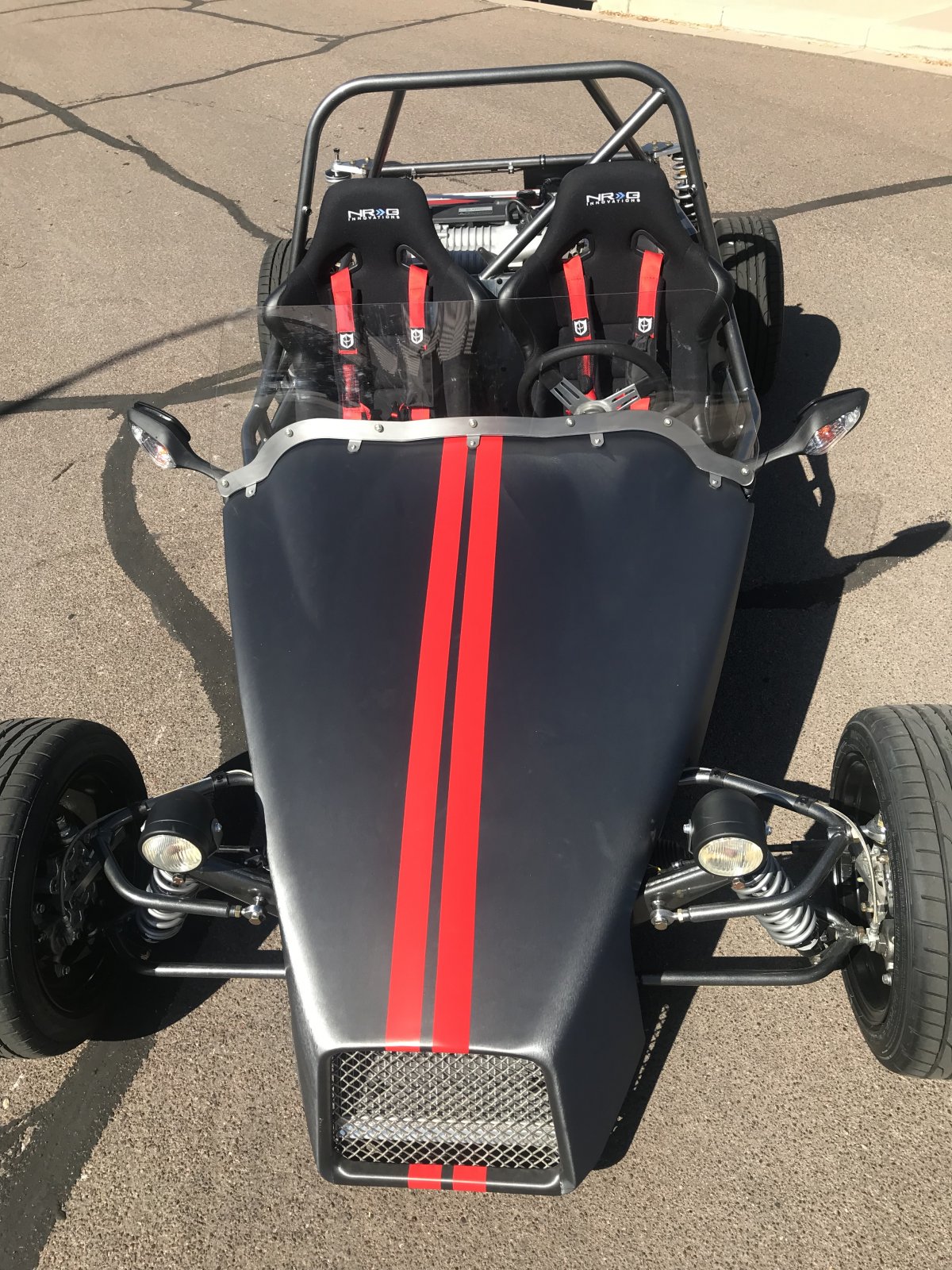

Pretty sure I am going to do (2) 2” wide matte red stripes right down the center with about a 3/4” gap between them. The blue painters tape is only 1 1/2” so the actual stripes will be a bit larger.
I also had my shop cut me some SS wire mesh that we had sitting around. I think it looks great. I will drill some holes in the edge of the turned in lip of the hood and either zip tie it or weld little tabs on to the mesh and bolt it. Haven’t decided yet.

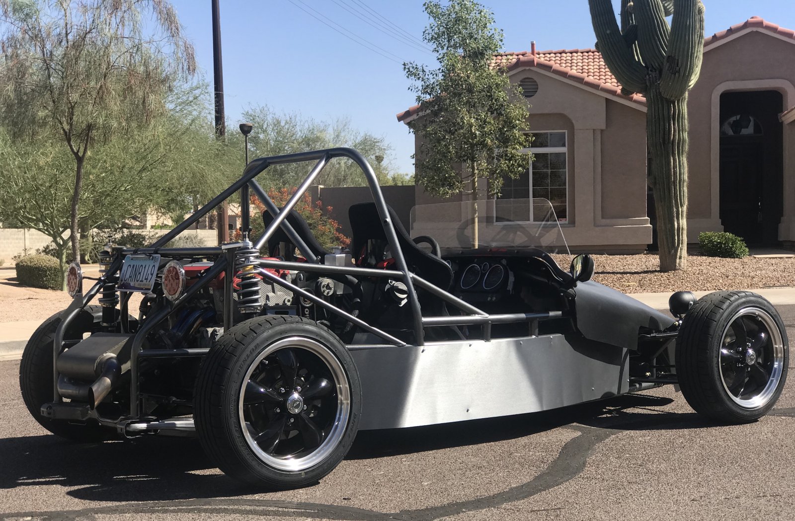

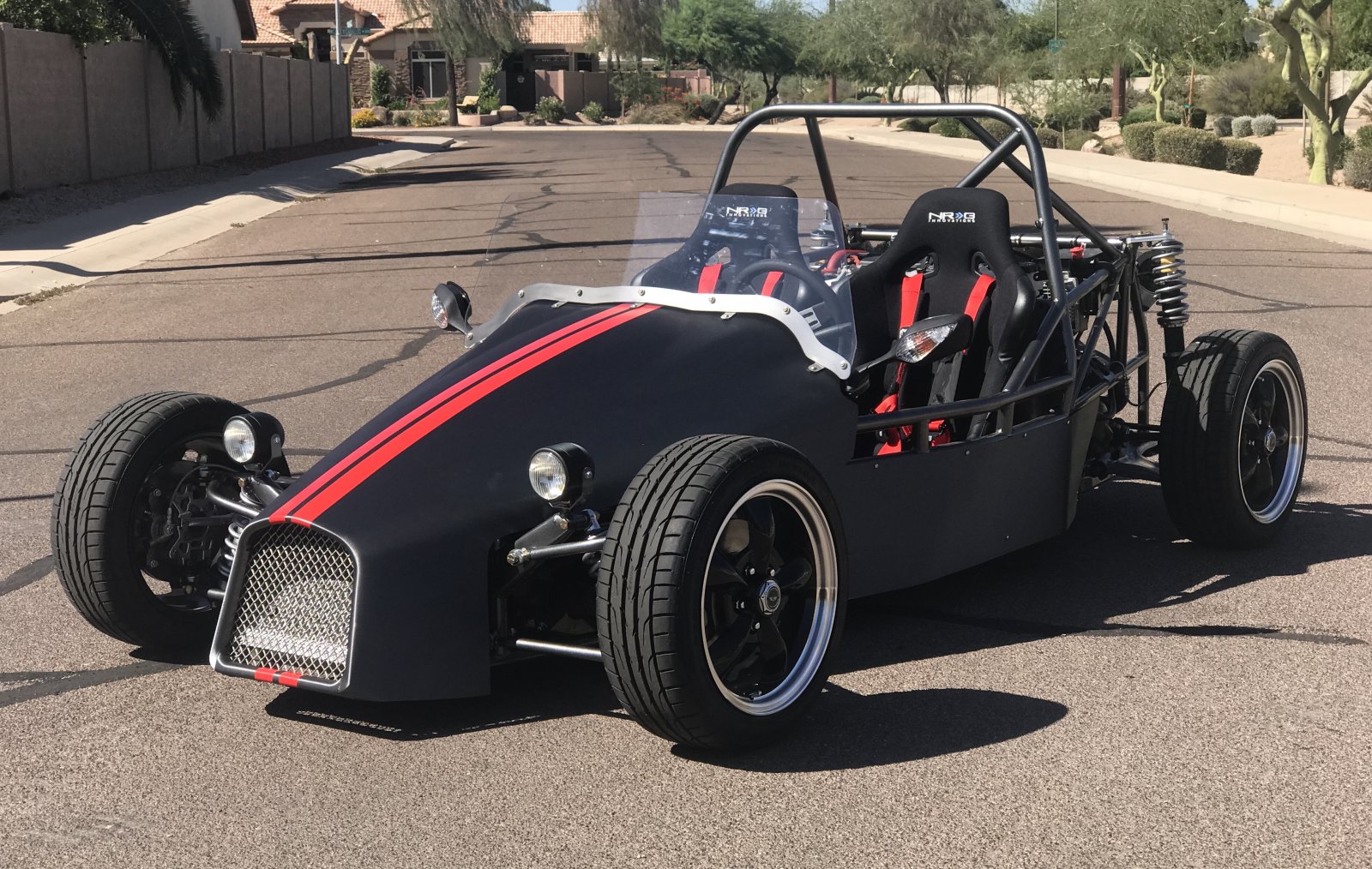

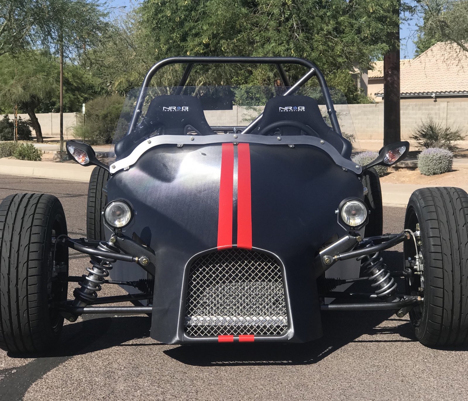

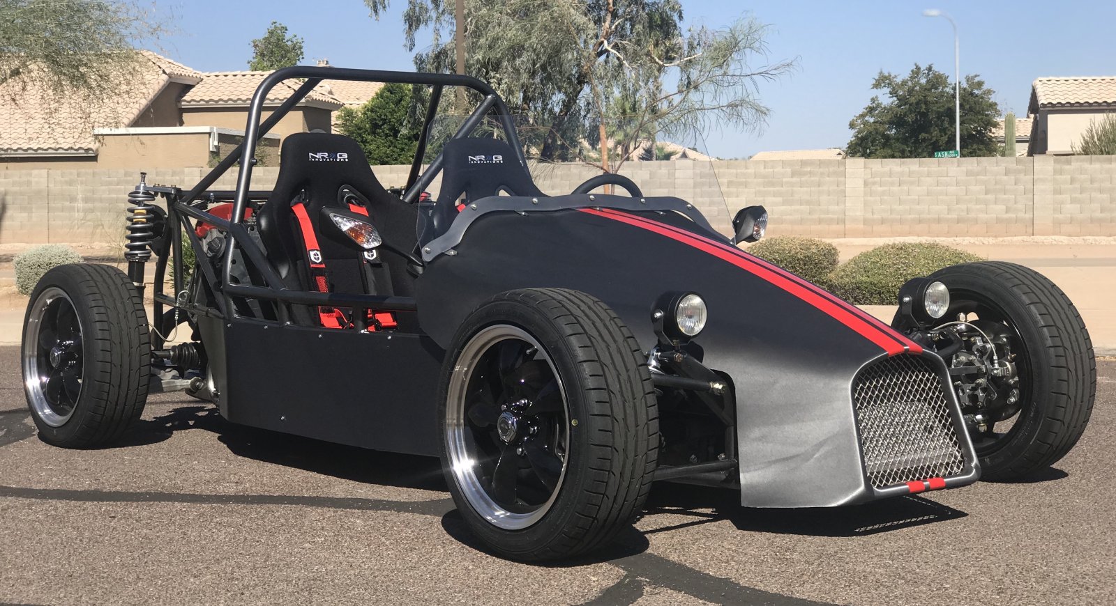

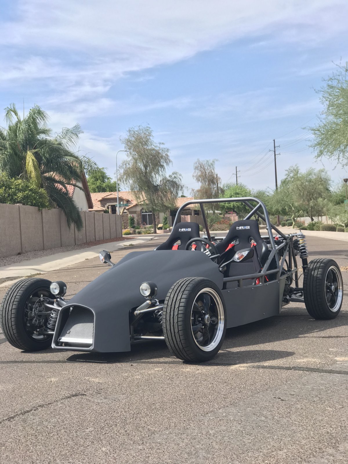

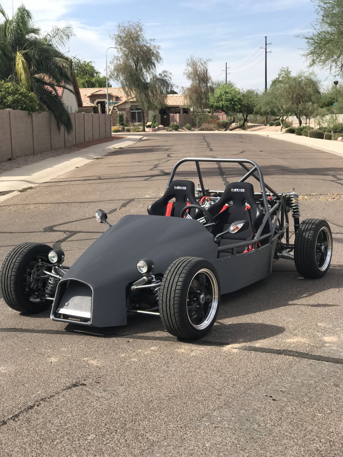

askiles

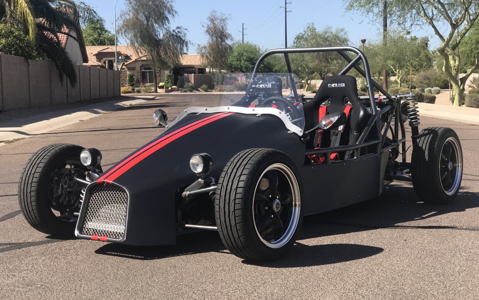

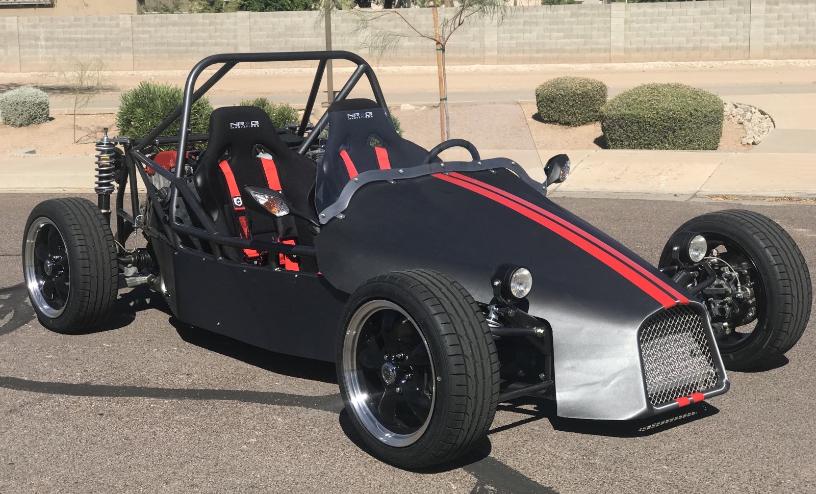

Some pictures of what I am calling the final product. The last thing I need is my custom plate for it, which is on its way from MVD.

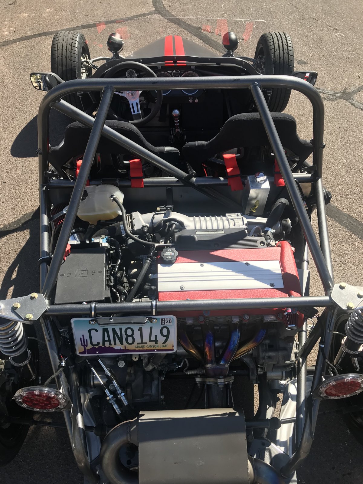

askiles

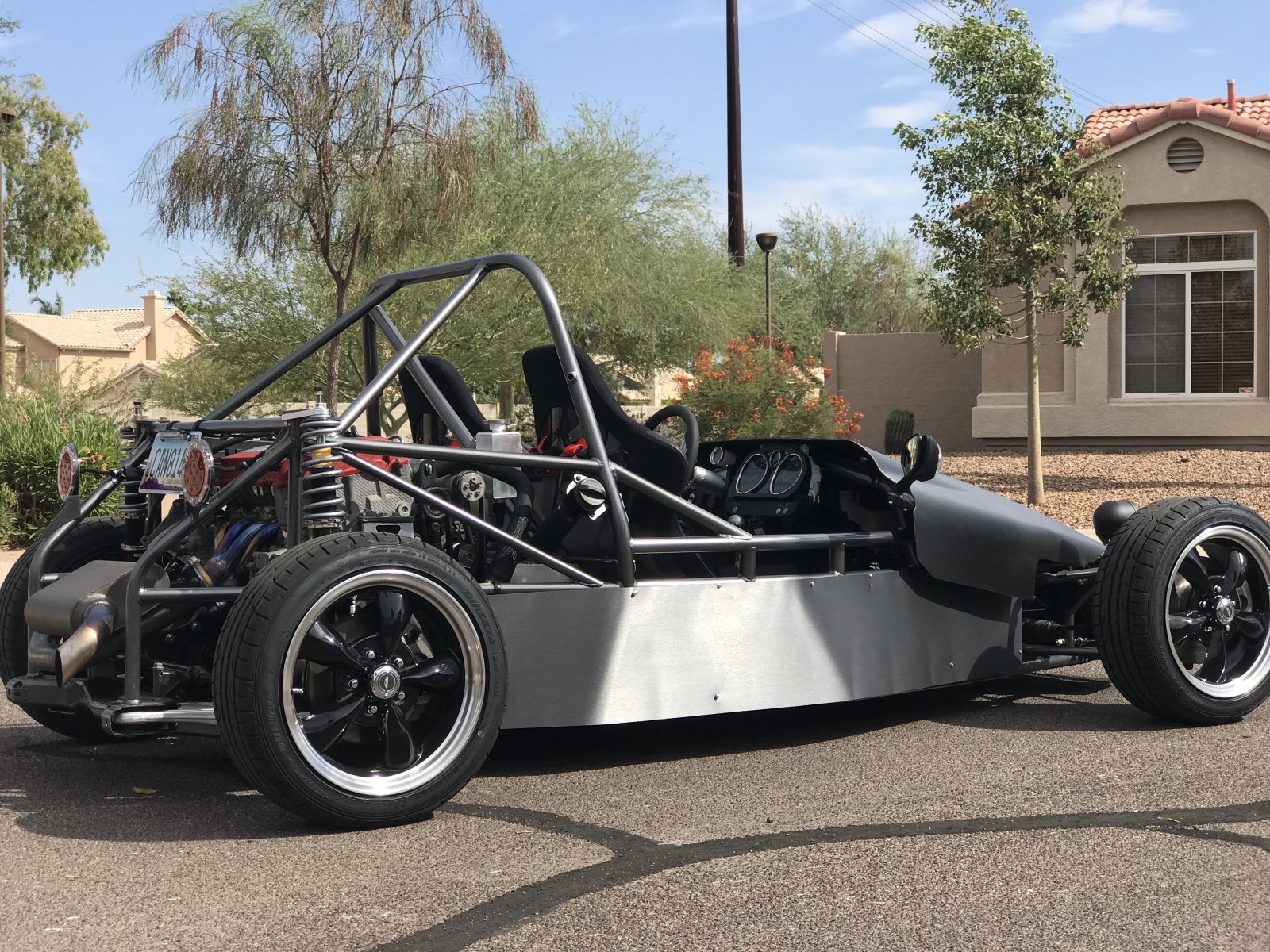

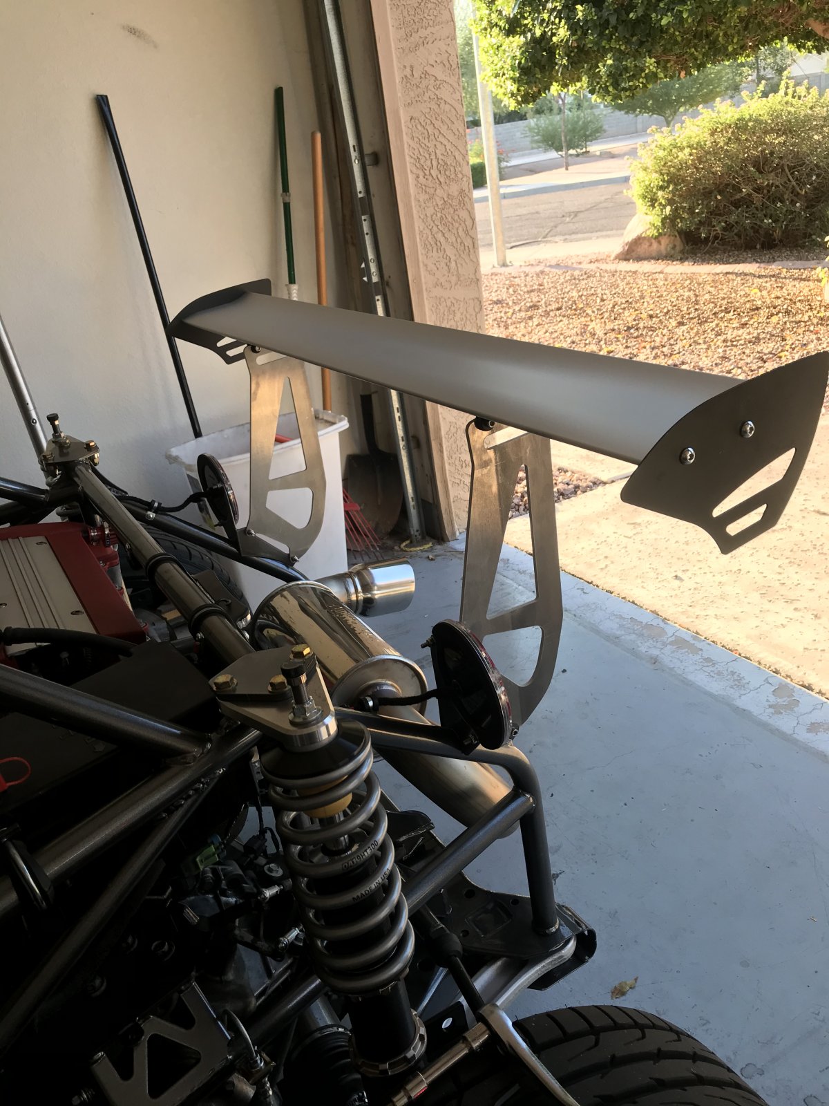

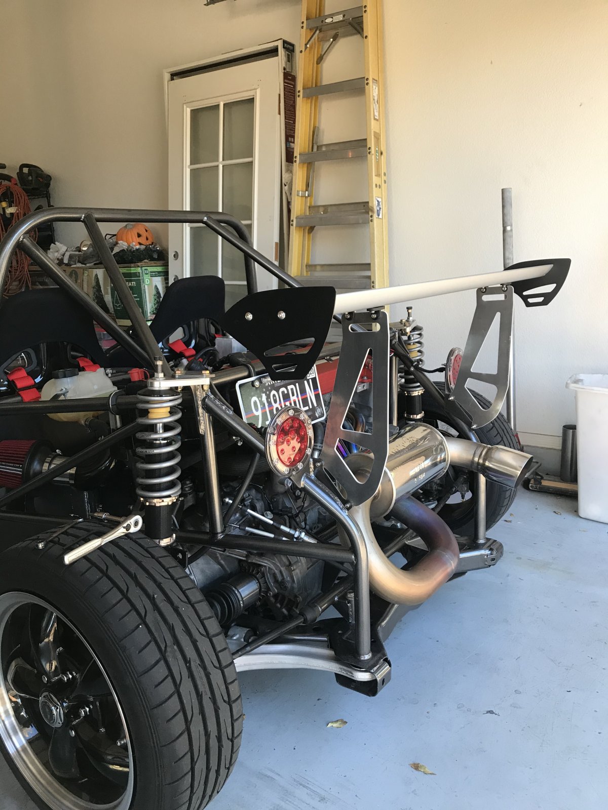

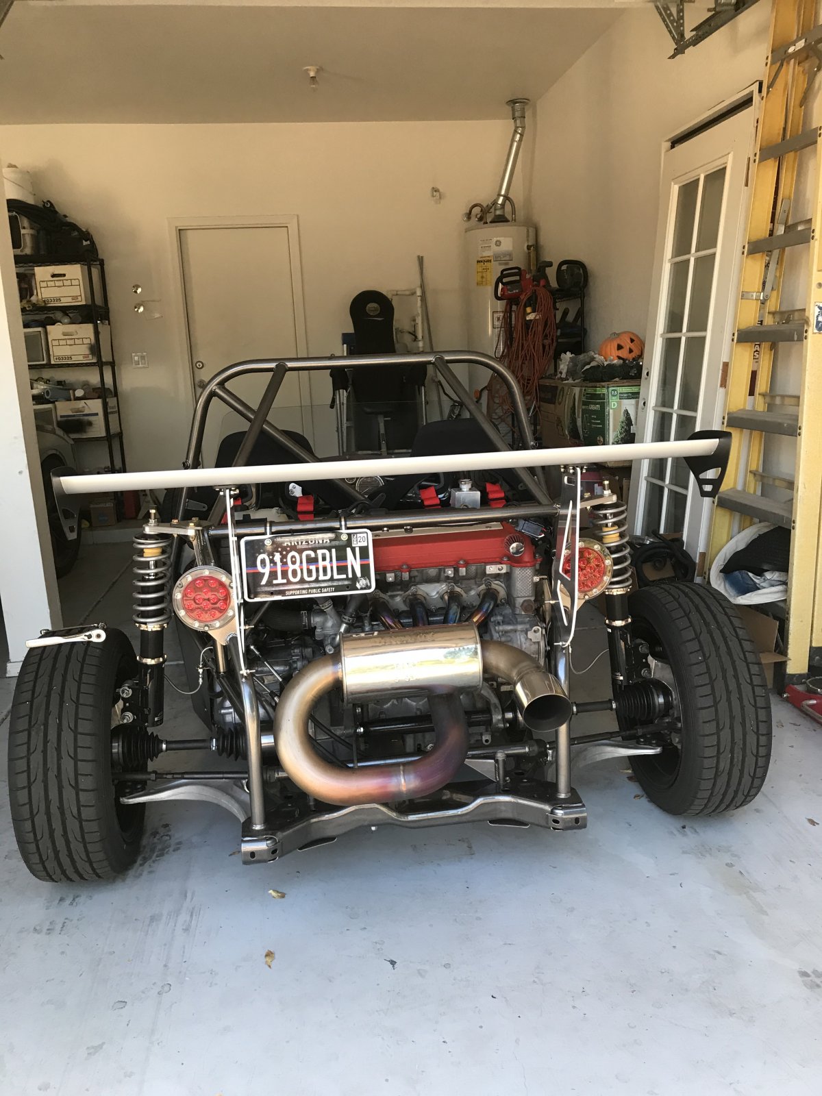

So I decided to go ahead and add a spoiler to my Goblin. I custom designed and had cut some shorter and less steep brackets out of some 3/16” aluminum. I like the look and height. The spoiler was a very inexpensive extruded aluminum wing that I found. It has some adjustable brackets so I could set the width needed. Overall, I am really happy with it.

Is that the nine lives racing wing? Or another one thats aluminum? It looks great with your designed brackets!
It is not. The Nine Lives stuff was very expensive. This is an inexpensive extruded one that I found on eBay. I believe it was less than $50. The quality of it was great, too. I am glad I went with it. ...and thanks, I really like the look of it! I designed the brackets so they would be a few inches shorter than the DF ones, and at less of an angle.
