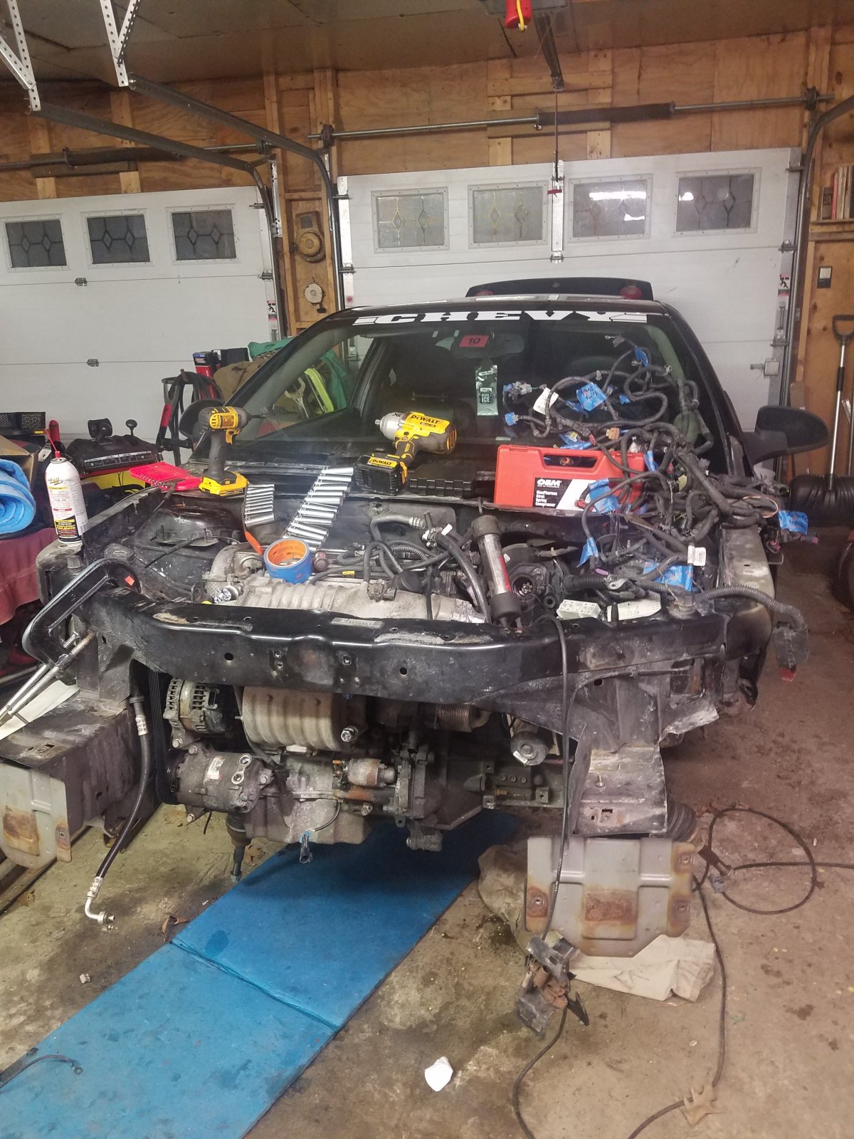

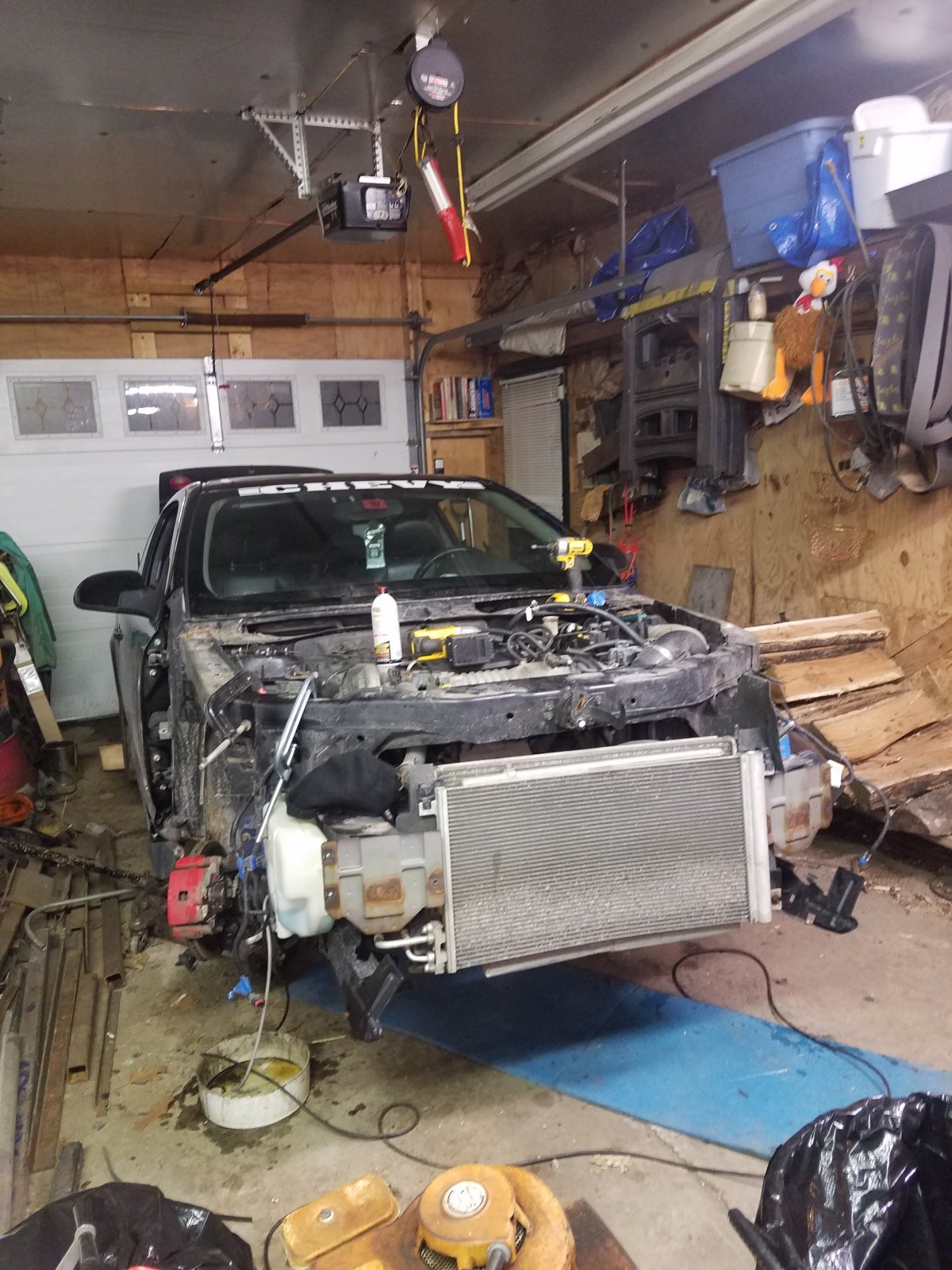

My name is Ben, i started this project because I wanted something fun to drive in the nice weather. Im 22 and pretty good with mechanical systems, although i have not worked on vehicles very much. This should be a fun project.
20180226_071920 (1).jpg 20180301_233633.jpg 20180228_210901.jpg 20180302_154650.jpg

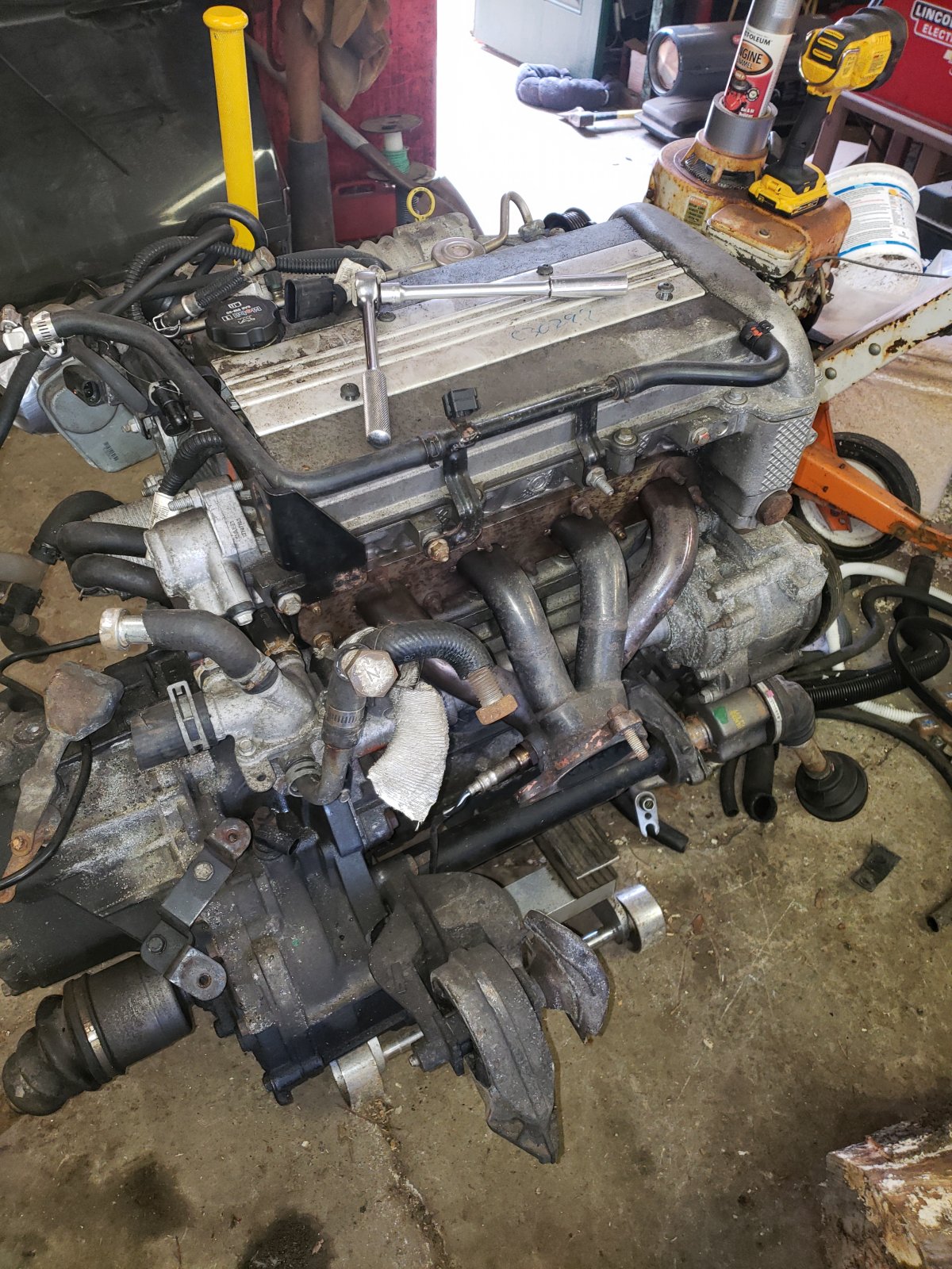

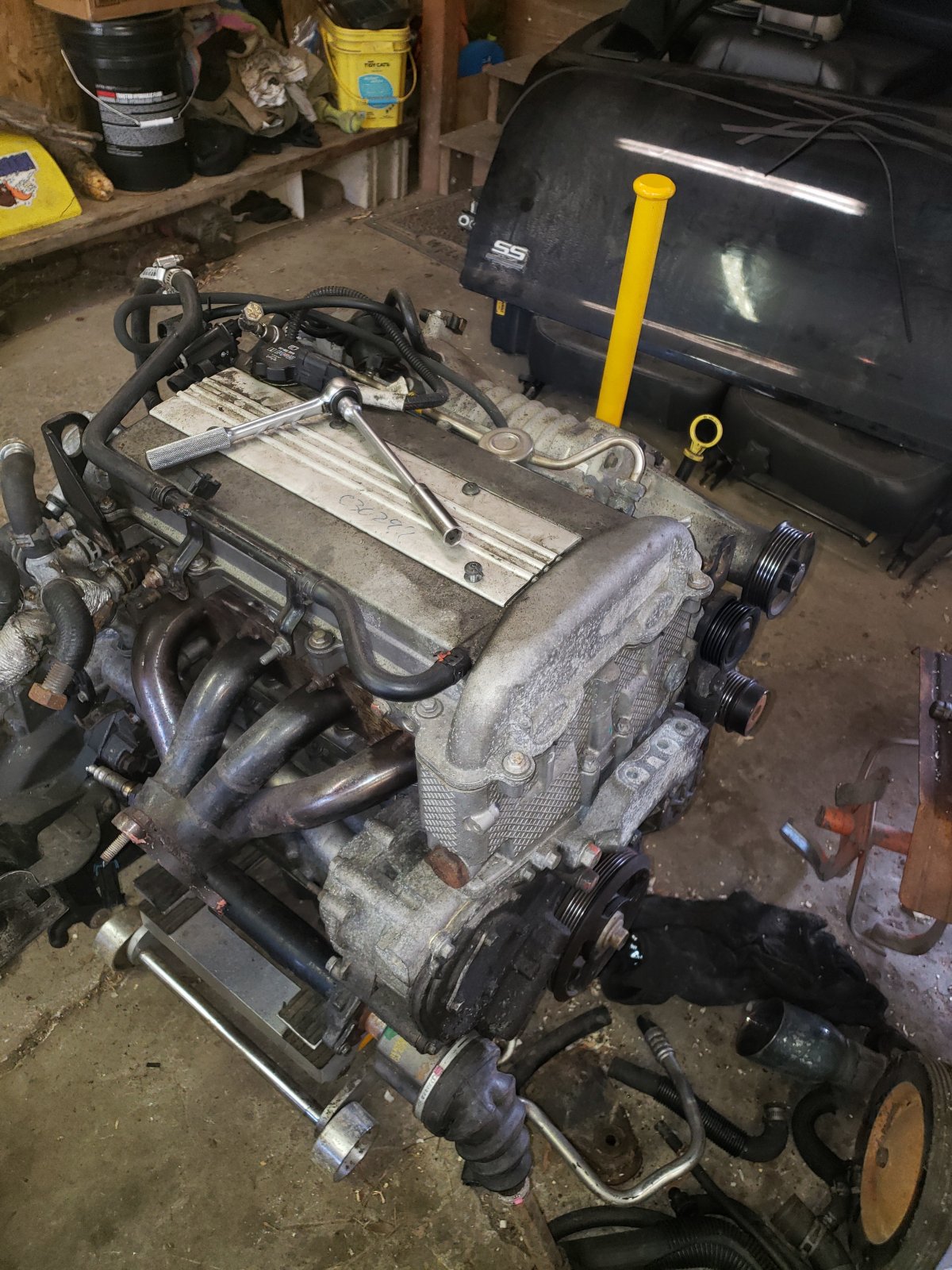

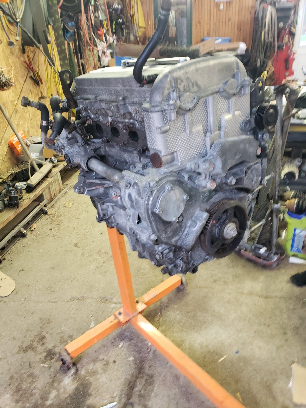

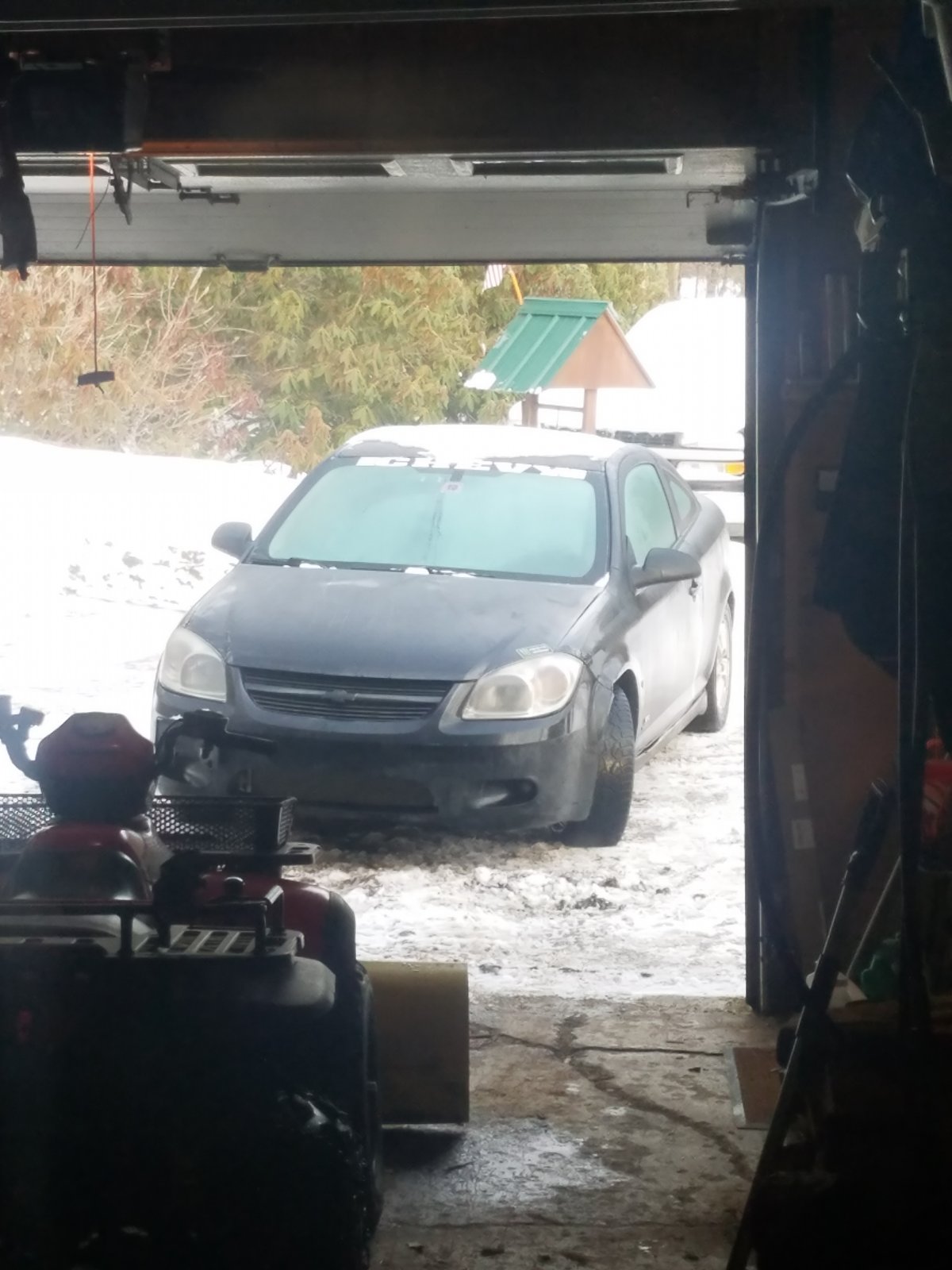

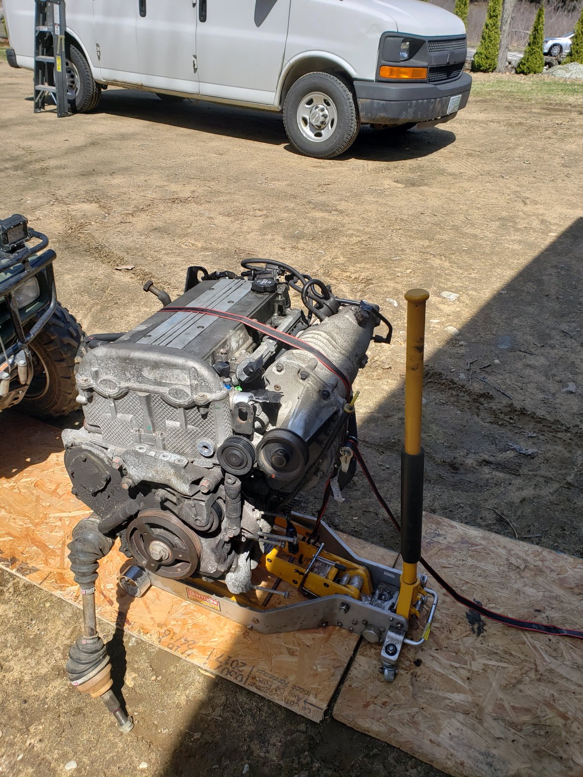

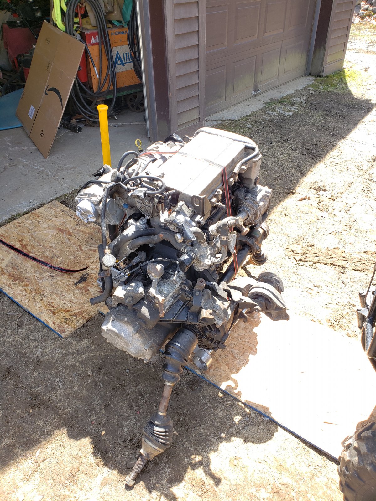

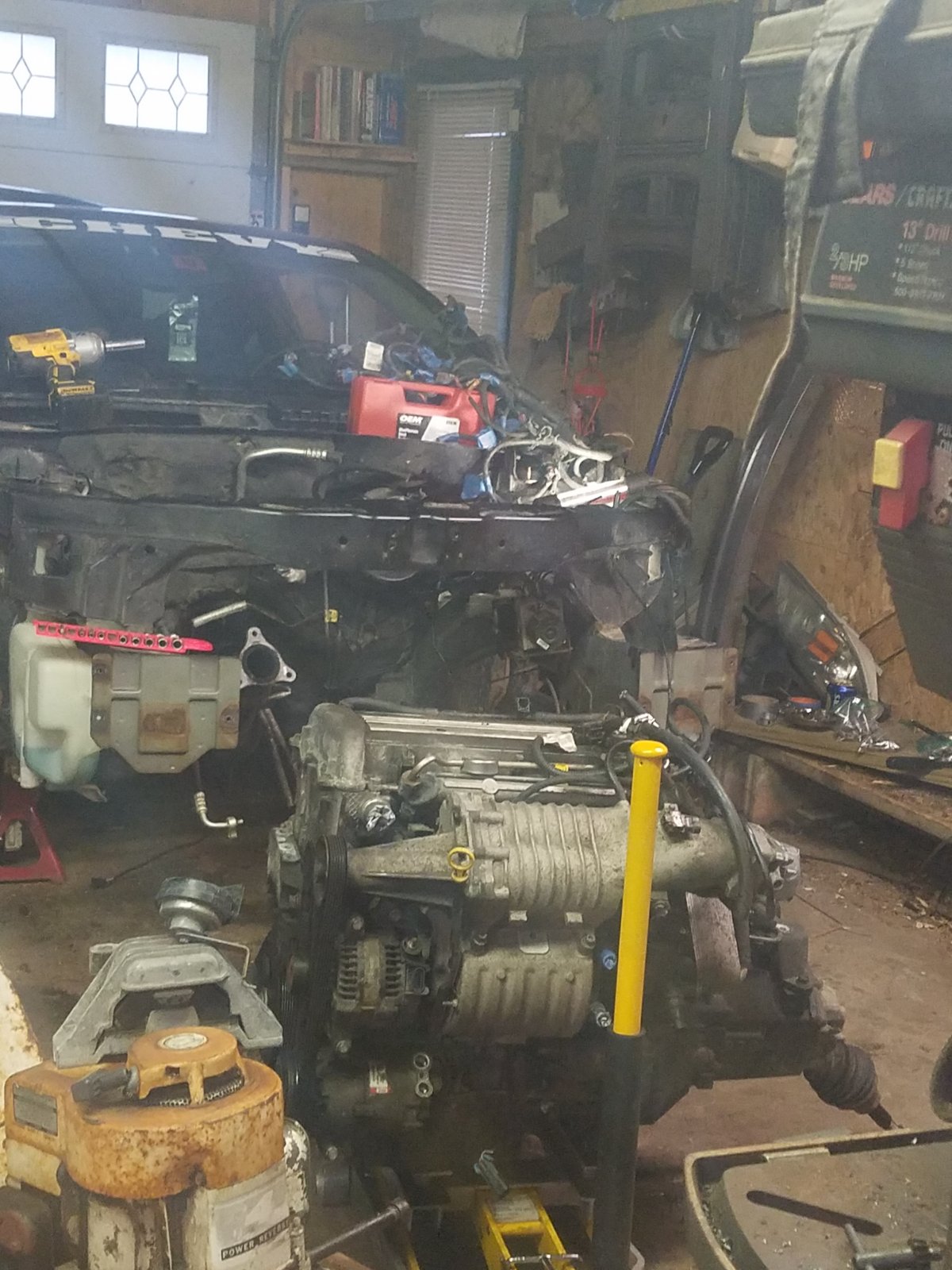

I stripped my donor in a couple days. I have since scrapped the remaining chassis, and put up the parts Im not using for sale. I paid $900 for the car and drove it home. 100k miles on the drive train and 160k on everything else.

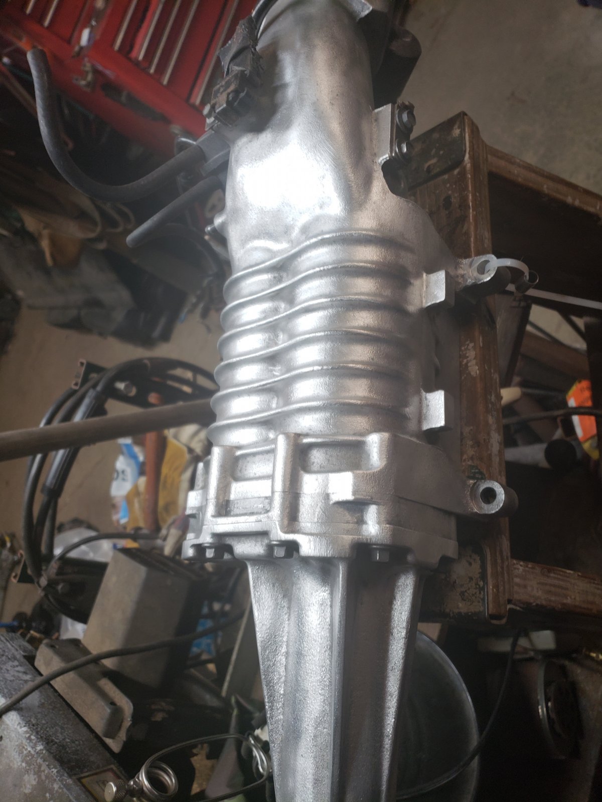

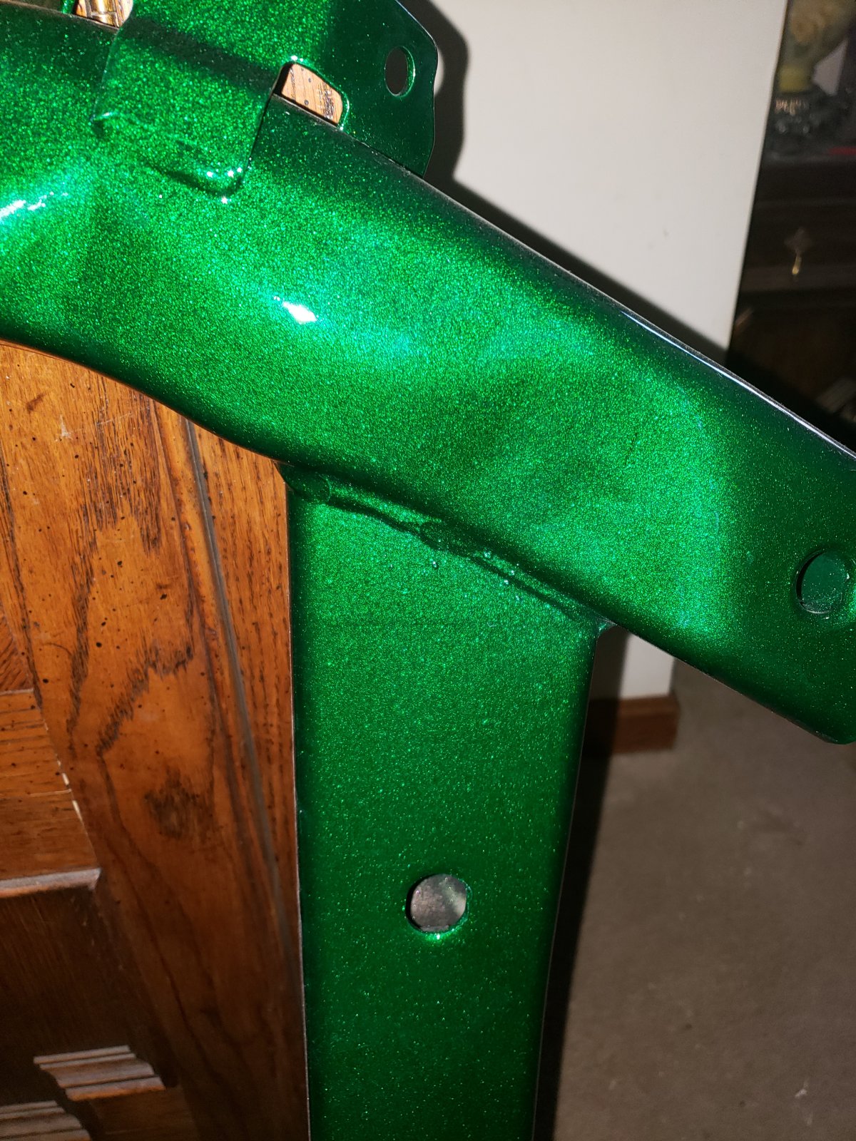

The cleaning was one of the things I semi rushed and was not really looking forward to. Take your time. A lot of people have used soda blasting and had good success. I just didn't want to buy another tool to use once.
Also had the Subframe Powder coated.Im going to have my frame and parts done in Gambler Illusion

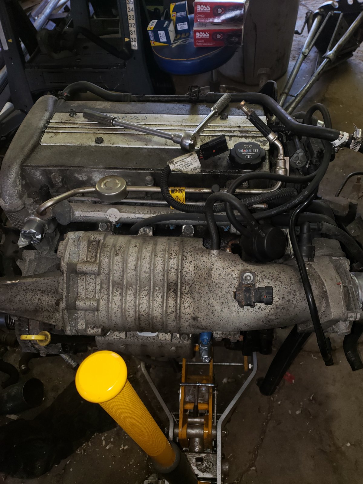

They nearly ruined the header adapting it too the custom exhaust they had my fathers going to cut the 3 bolt end plate off and re-weld the stainless correctly.They attempted to weld the inside and outside with the wrong welding setup. its pretty terrible.
