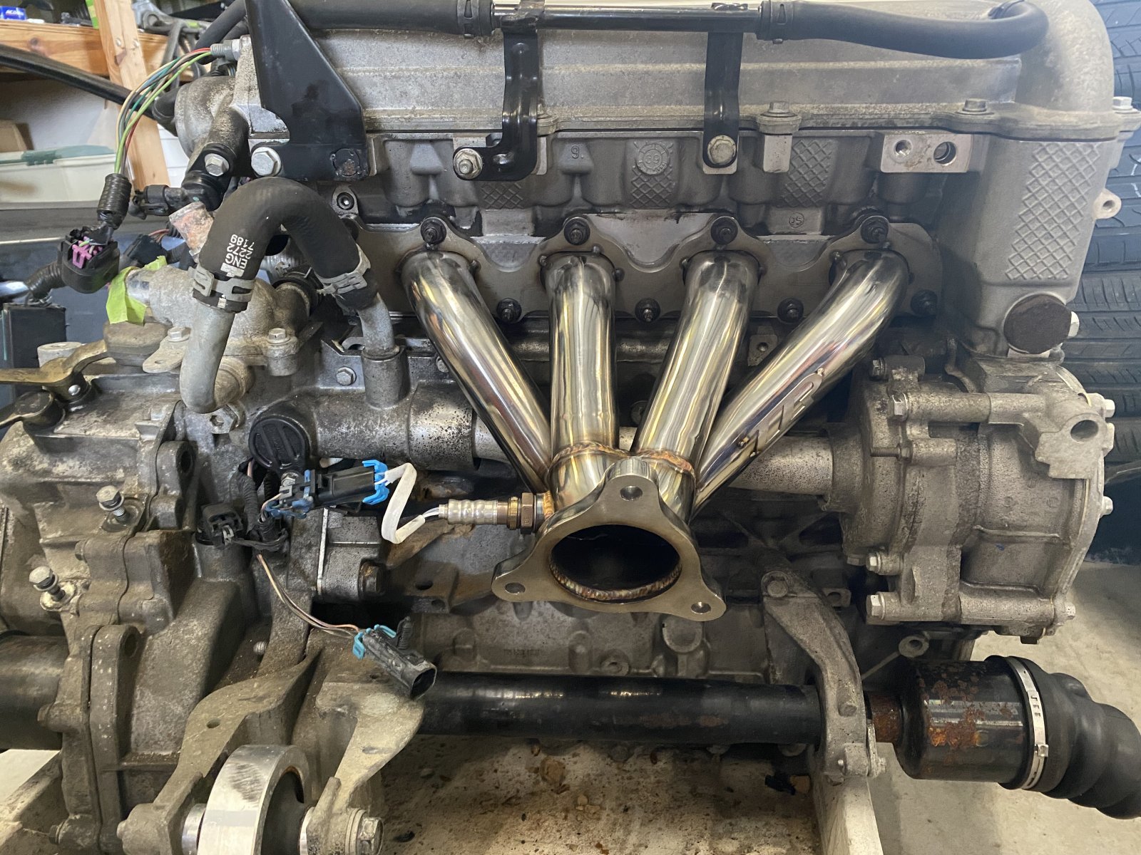

One thing that cleaned up my engine nicely was putting a ZZP header on it. :cool:

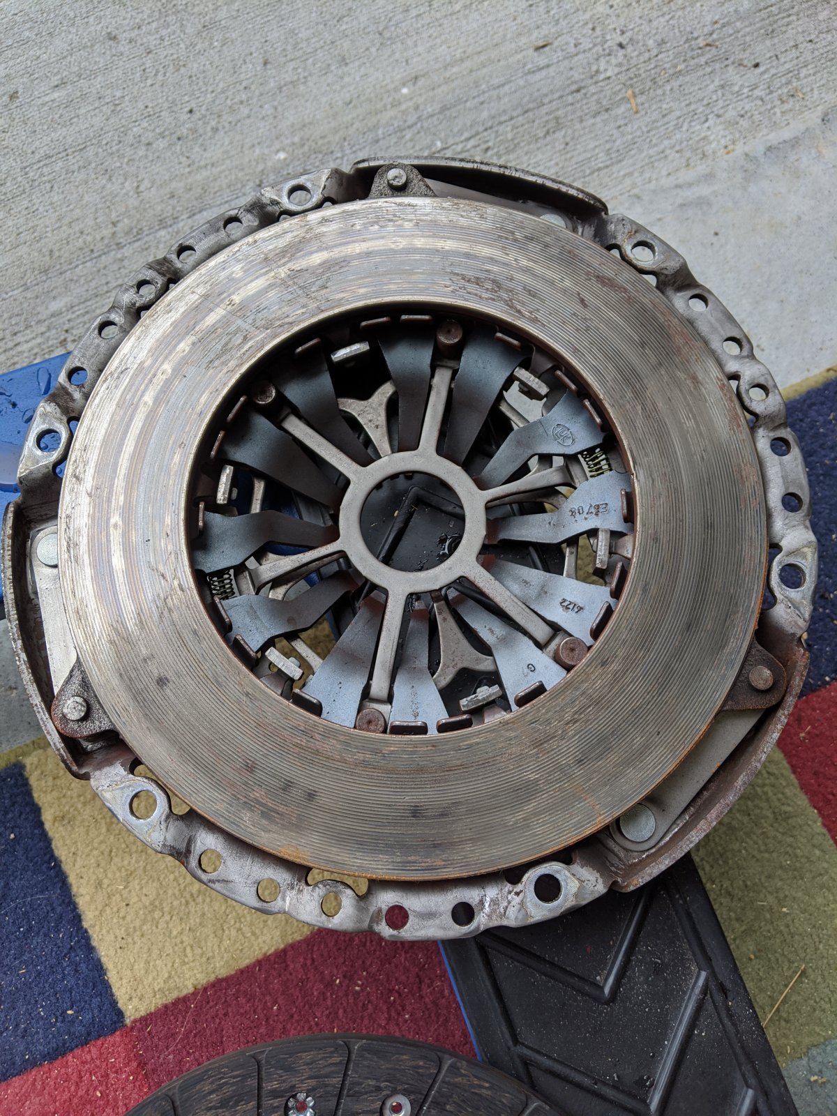

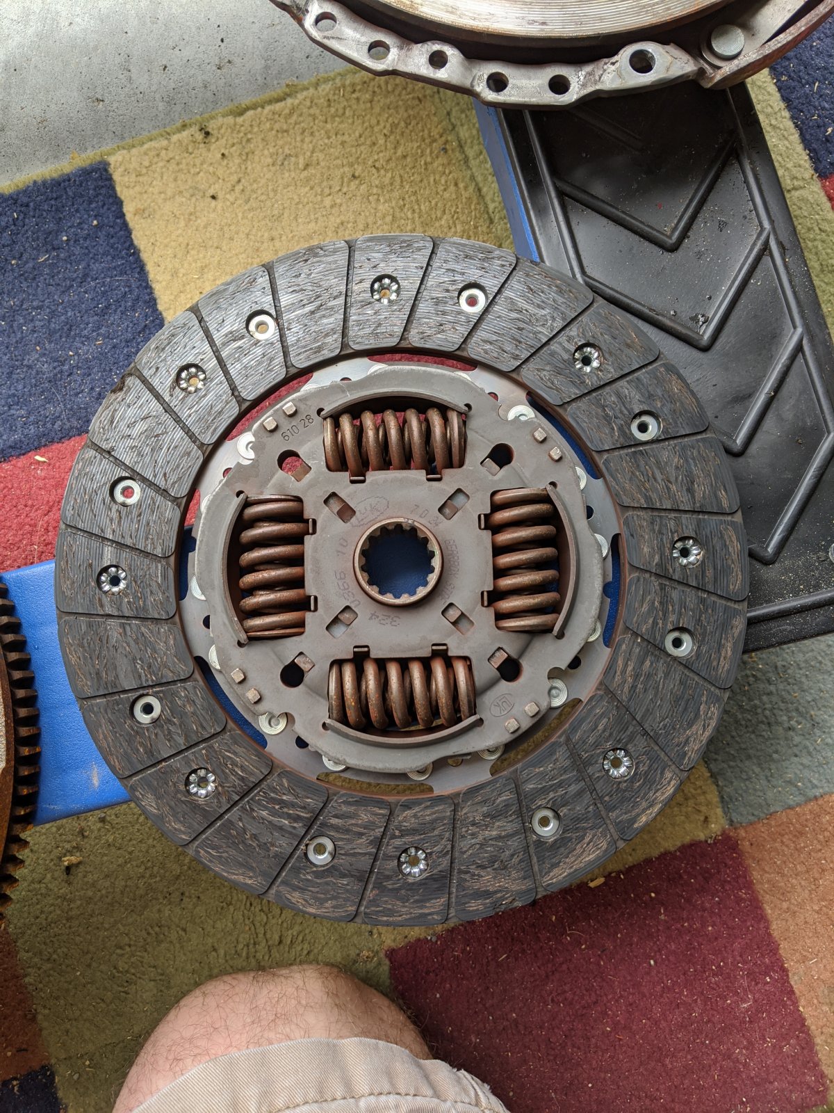

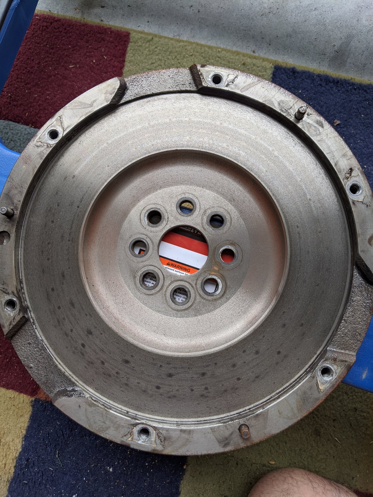

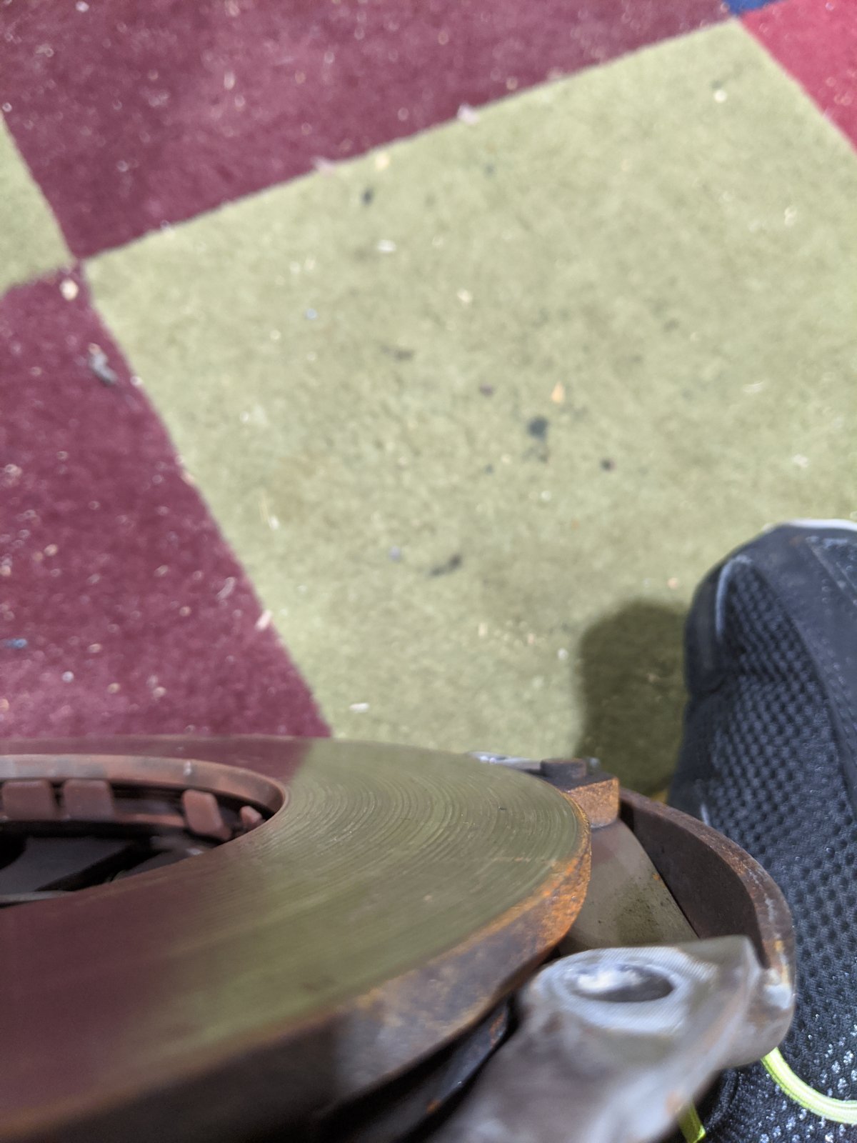

So, I took off the clutch and flywheel and they look . . . . really good. Here are pics to give you guys a look. The only thing I question is that the surface on the pressure plate is grooved/ribbed . . . almost like it was machined that way. Is that correct?
In the end, I'll probably end up keeping the flywheel but maybe replace the clutch plate and pressure plate . .

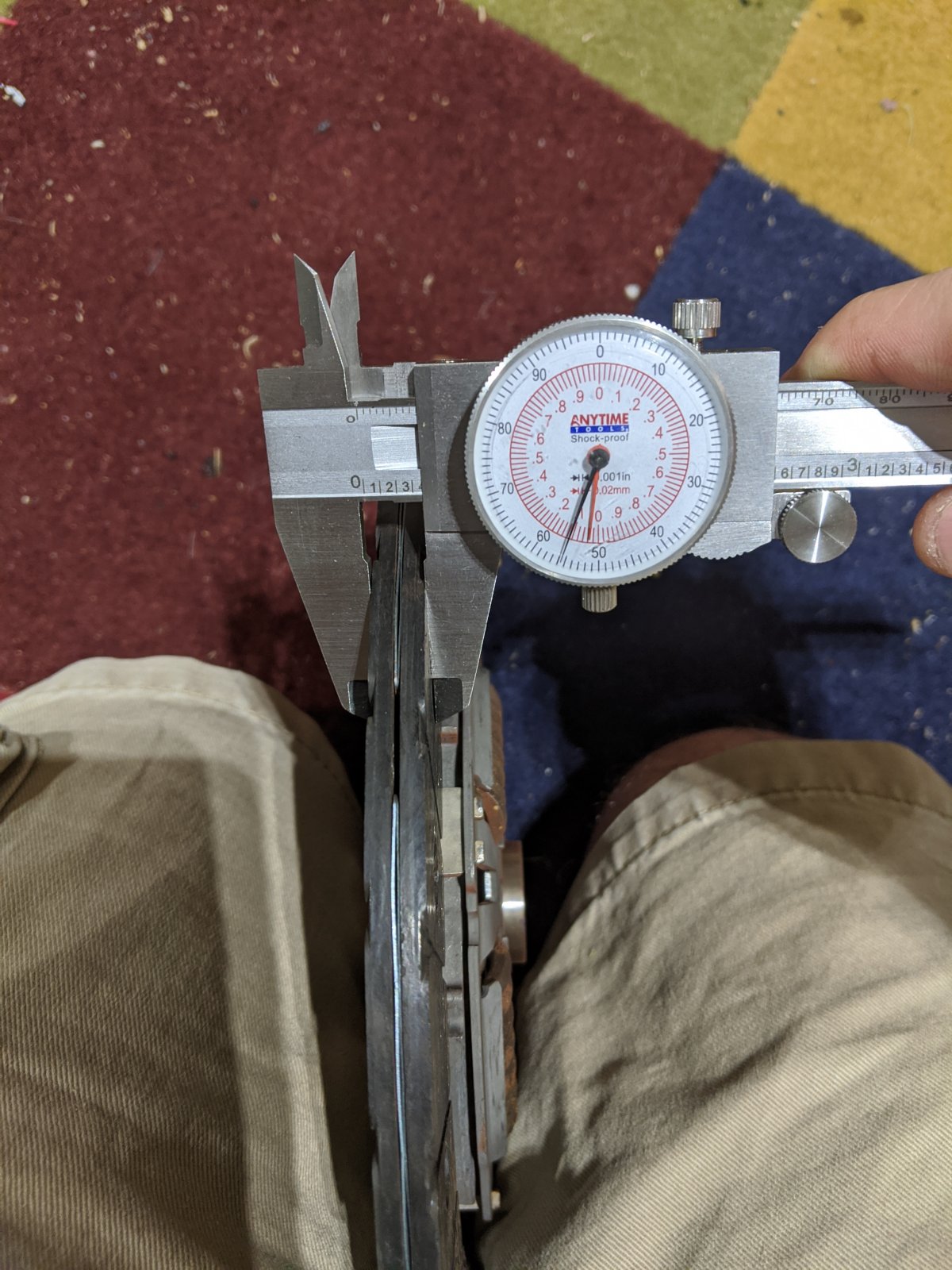

Looks pretty good. How thick is your clutch plate? 5mm = worn, 8mm= new.

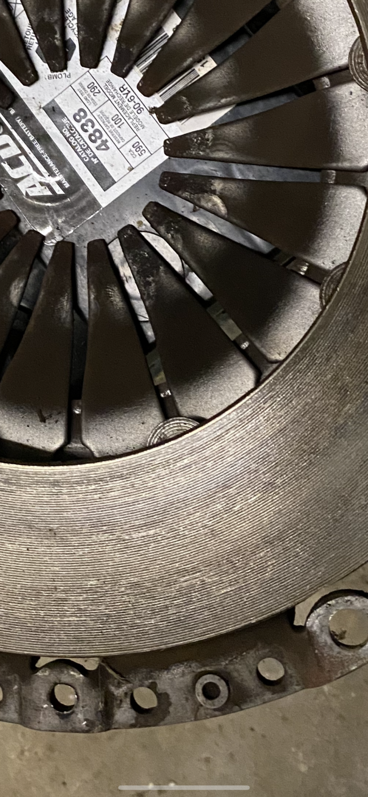

I have never seen grooved pressure plate? I googled it and did not find any references. The surfaces that engage the clutch plate should be smooth and clean.
WorkinMan55
My pressure plate looks just like yours. My flywheel also has grooves in it. Just don’t have a good pic. Mine are the factory original parts
ToxicBill
My clutch plate measures a touch over 9mm . . . so, yeah . . . look like this guy just had a clutch job. Nice, but I wonder what happened to the throw out bearing.
The thing with the grooves on the pressure plate is weird . . . but, as long as its "normal".

Oh, and my pressure plate has those grooves too.

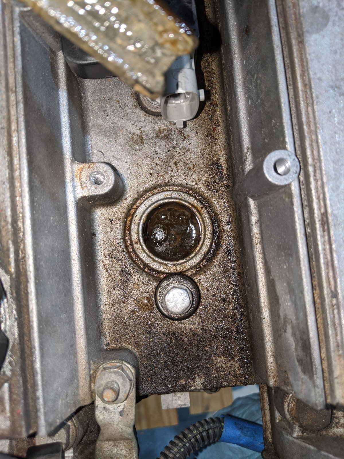

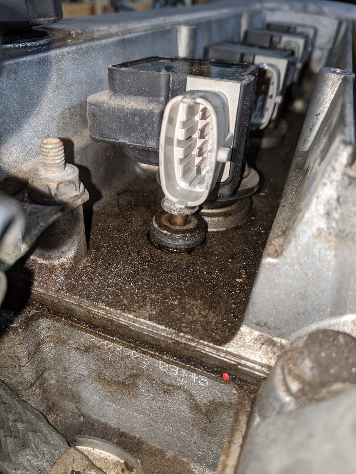

OK . . . new problem. I was removing the wiring that goes to the spark plugs and I noticed that a bolt was . . . loose.
13177
To get to that bolt, I removed the ignition coil and found what appear to be water/coolant with some amount of oil
13178
Any thoughts on where this coolant may have come from? Perhaps a bad gasket?
EDIT: I did degrease/pressure wash the engine prior to removing it from the car. Perhaps that is the source of the water since that bolt did have the ignition coil slightly unseated.
Vwsaabvt
The oil is from the valve cover leaking because that bolt was loose. If all of that was in there before you would have probably noticed a misfire. Put a new valve cover gasket in.
Pretty much this. ^^
what did the spark plug boot look like? If it looks like the others, then it’s probably from your pressure washing. Like said above, you would have noticed a misfire with that much water in there. Not to mention (unless someone knows better) there’s no coolant up there, just oil.
also a note: in a highly humid climate like we have down here, it’s not uncommon to have moisture built up in places like that and over time, it can easily fill up the hole with water. Anyone with an LS powered truck or car with the knock sensors under the intake, has probably experienced knock sensor codes because those holes have fill with water and rusted up the sensor and wiring.
ToxicBill
Yeah, the engine ran fine with no codes . . . so I'm hoping it was just water from the washing. In any case, I was planning on a new valve cover gasket anyway. After I wiped off the spark plug boot . . it looked like all the others.
Yeah . . that was a panic moment just before bed. LOL
