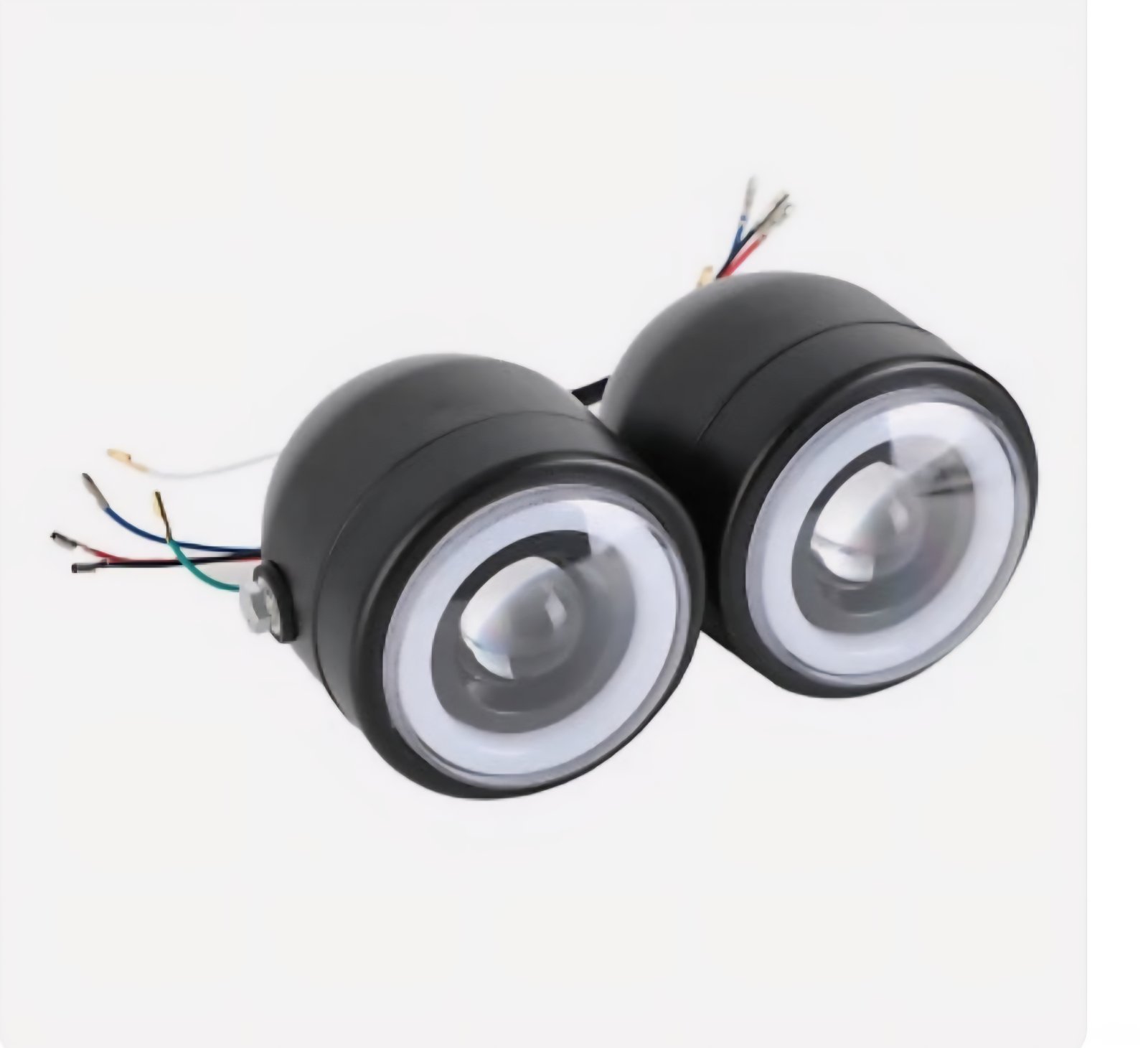

Just buy some cheap headlights, and make your own mounting? That is what I did.
Similar to those, are these that I'm considering changing over to. A modern look to the lamp.
