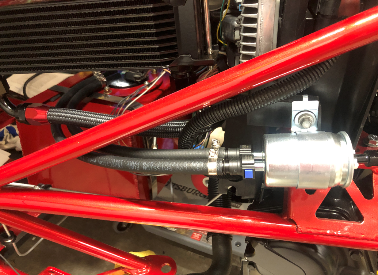

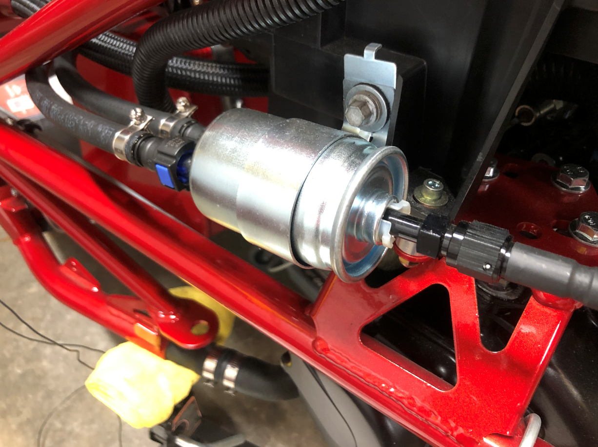

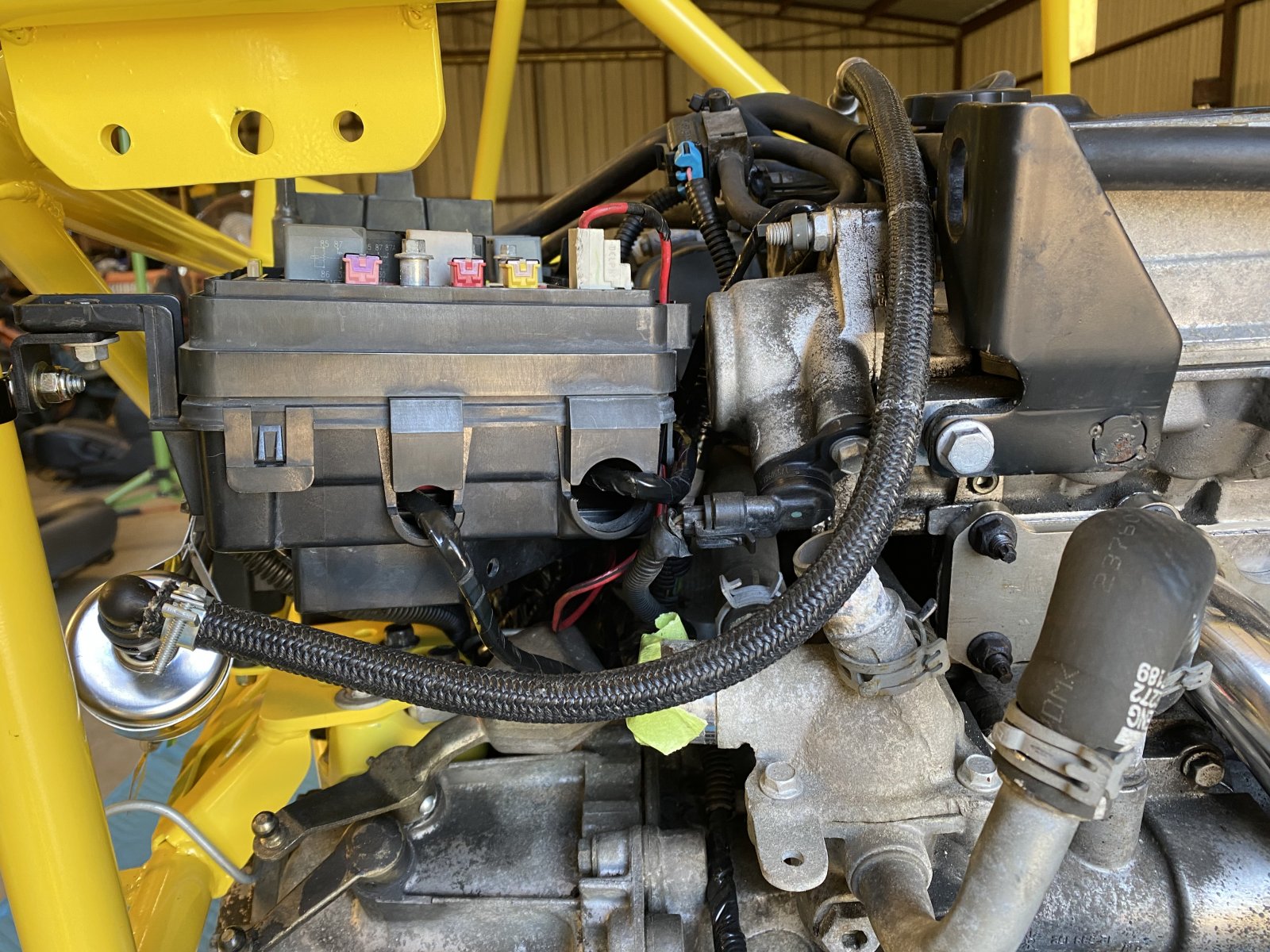

Use high pressure (60psi or higher) rubber fuel hose to clean up the the fuel hose routings. Cut the ends off the stock hoses and attach them to the rubber hoses. I also cut the plastic line off the car from the quick disconnect on the engine to the metal line going back to the fuel tank. I spliced that in for a clean look from the filter to top of the engine.
