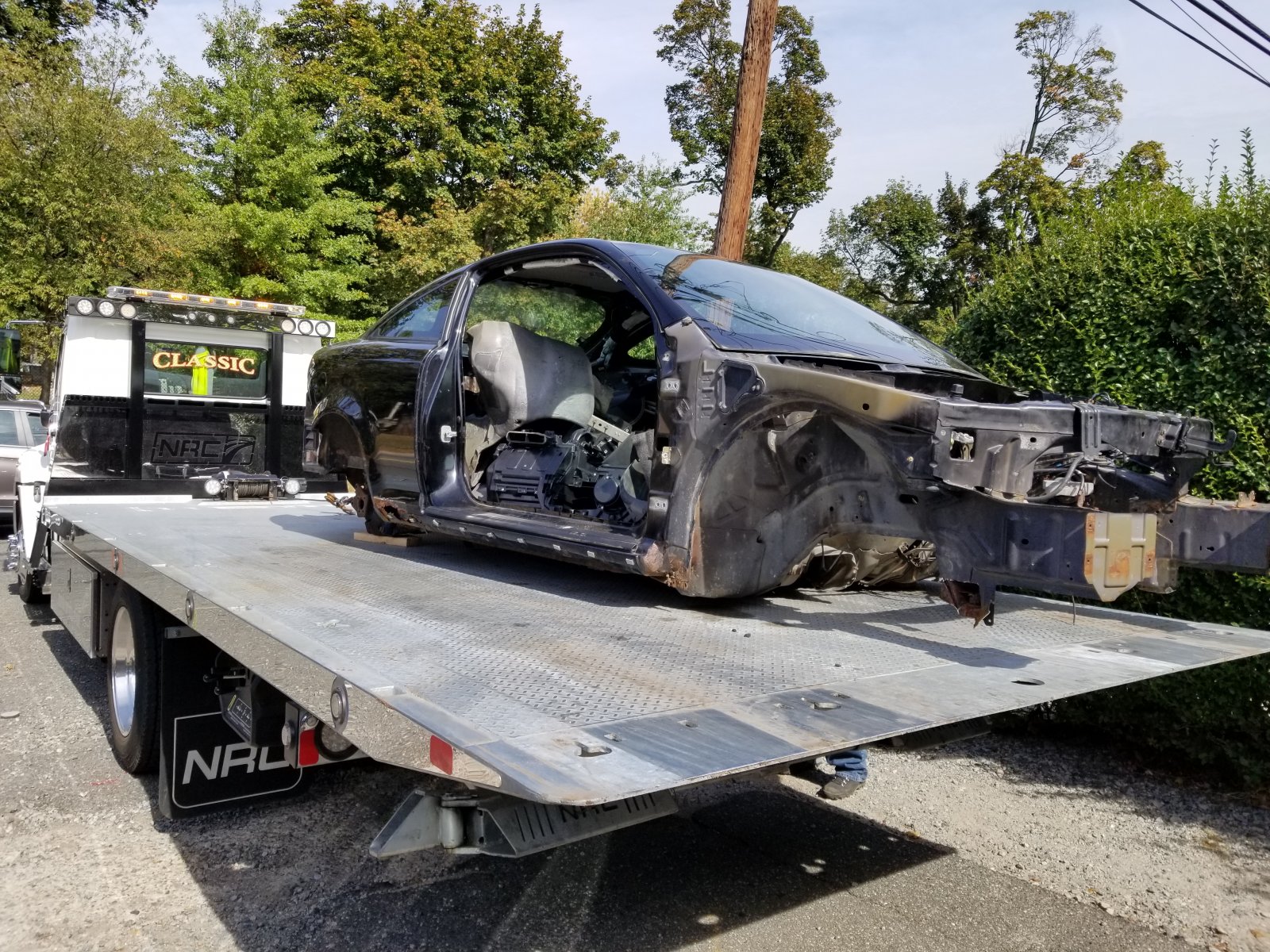

V1 David's Track ,street goblin - in NJ
David
Tell me about it I must of Called about 10 places
And I have my attic full of parts I'm selling just need the shell gone
P

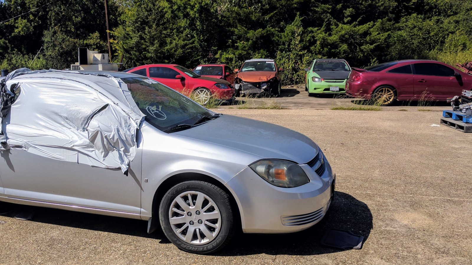

I checked the local metal recycling yard and was told they didn't deal with car shells but told me a local salvage yard would probably take it. I loaded my shell onto my trailer and basically gave the shell to a salvage yard along with all the junk parts loaded inside it. :D The seats were the only parts I was able to sell since there isn't a big market for Cobalt parts in the Dodge City area. :confused: I was able to use a bunch of the trim out of the donor to finish up a 2008 Cobalt LS I originally got as a donor but since it was so nice, I decided to sell it.
Had I still lived in the Wichita, KS area, I would have had several options to get rid of the shell AND be paid for it! I just didn't want to drag the shell ~ 2 hours + on two lane roads just to make a couple of $$ (which would have been eaten up by the gas used!)

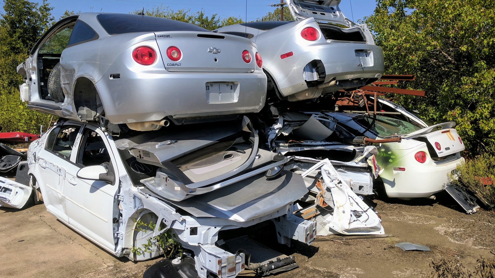

Wait, you guys don't just stack them up behind your buildings like we do?
These are the 6 shells left over from the following builds:
  • P1
  • P2
  • Dyno Man
  • DanPerryy
  • All terrain Goblin
  • the Goblin from the instructional videos
We're hoping that if we collect enough of them we can get a mobile crusher out here to pick up all of them at once.
Also behind the buildings are other future donors (the red Cobalt in the background that is considerably shorter than the others is actually the shell from my dad's LSJ donor):
I was able to trailer it to a salvage yard. They gave me $75 for it. I heard a different one would have given me more, but it's done now.

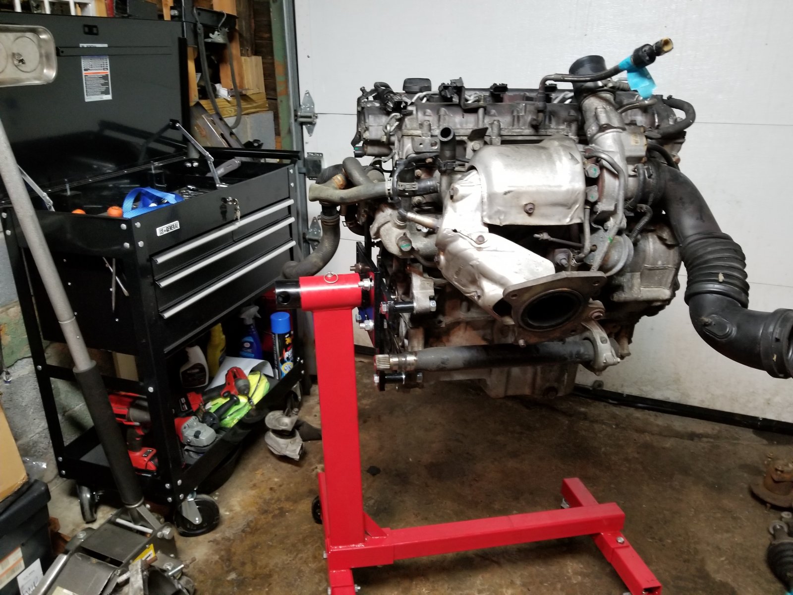

So Finally I got the engine on the stand ready to strip her down and clean her up real nice and looks like going to spend lots of elbow grease on her not easy working in a 1 car garage that's already packed with this things

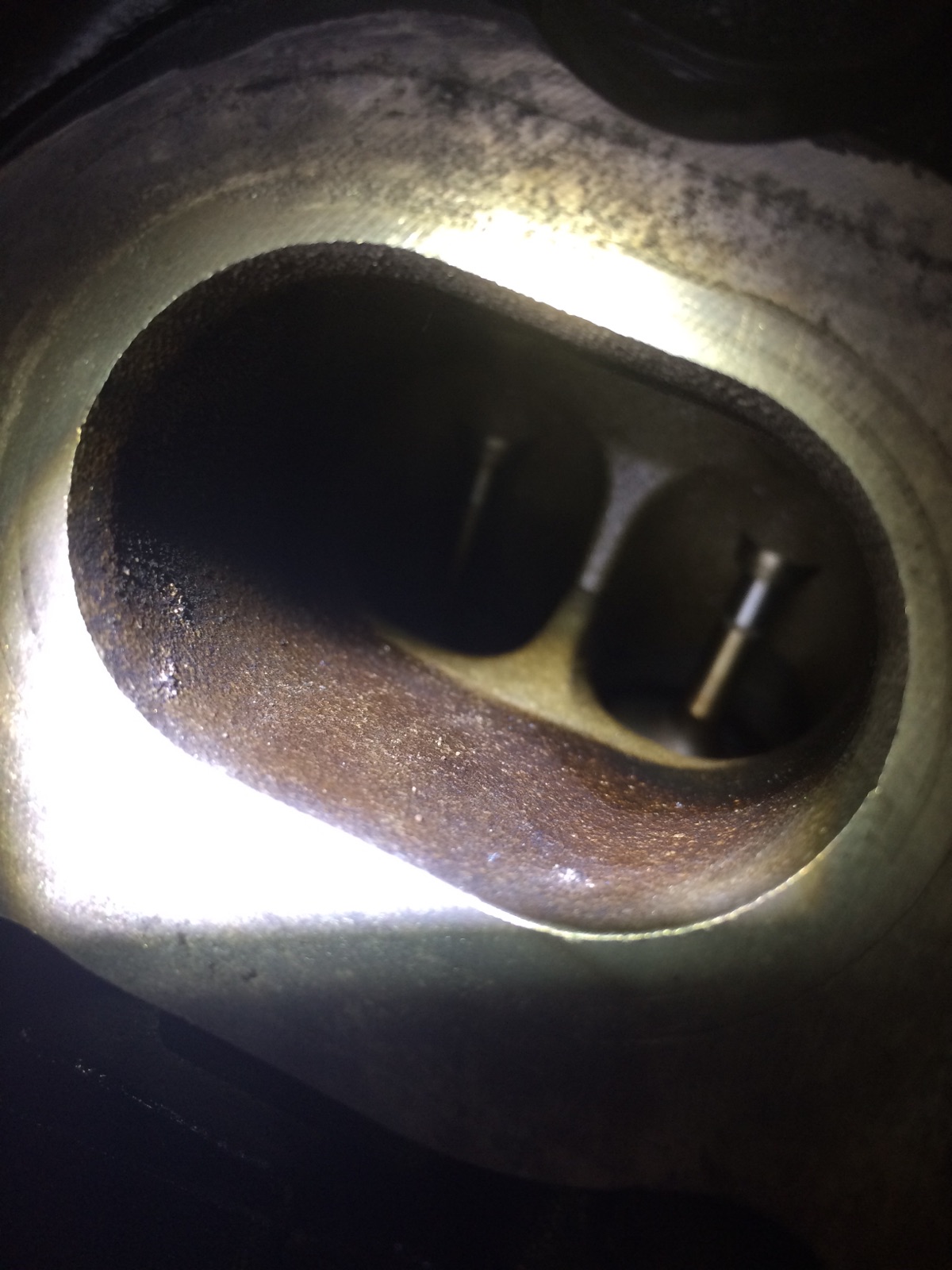

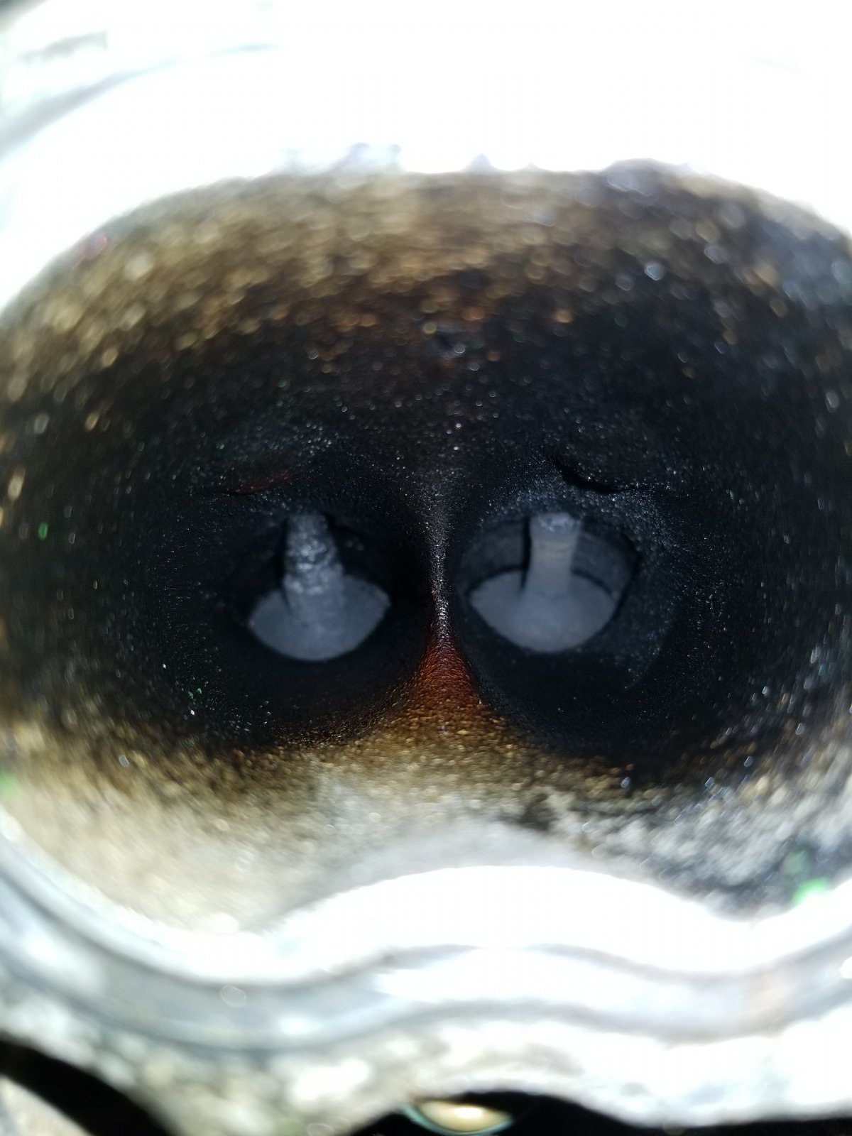

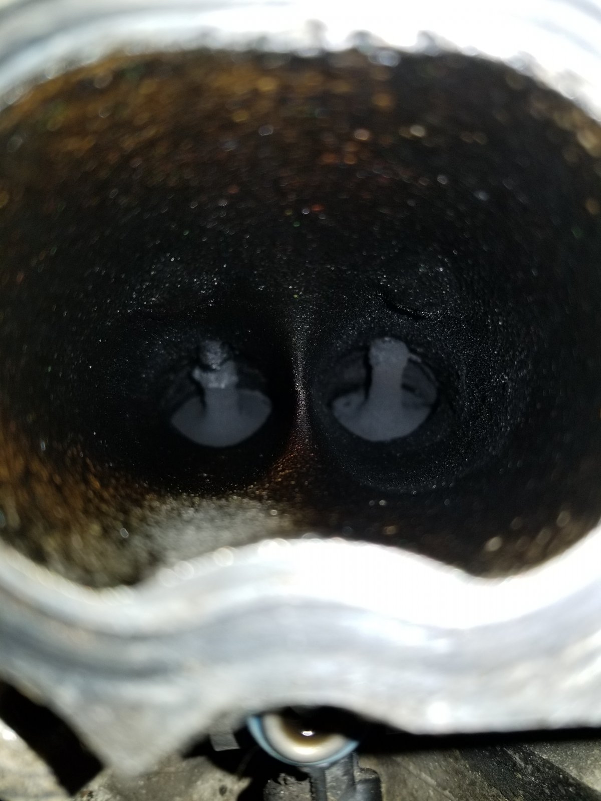

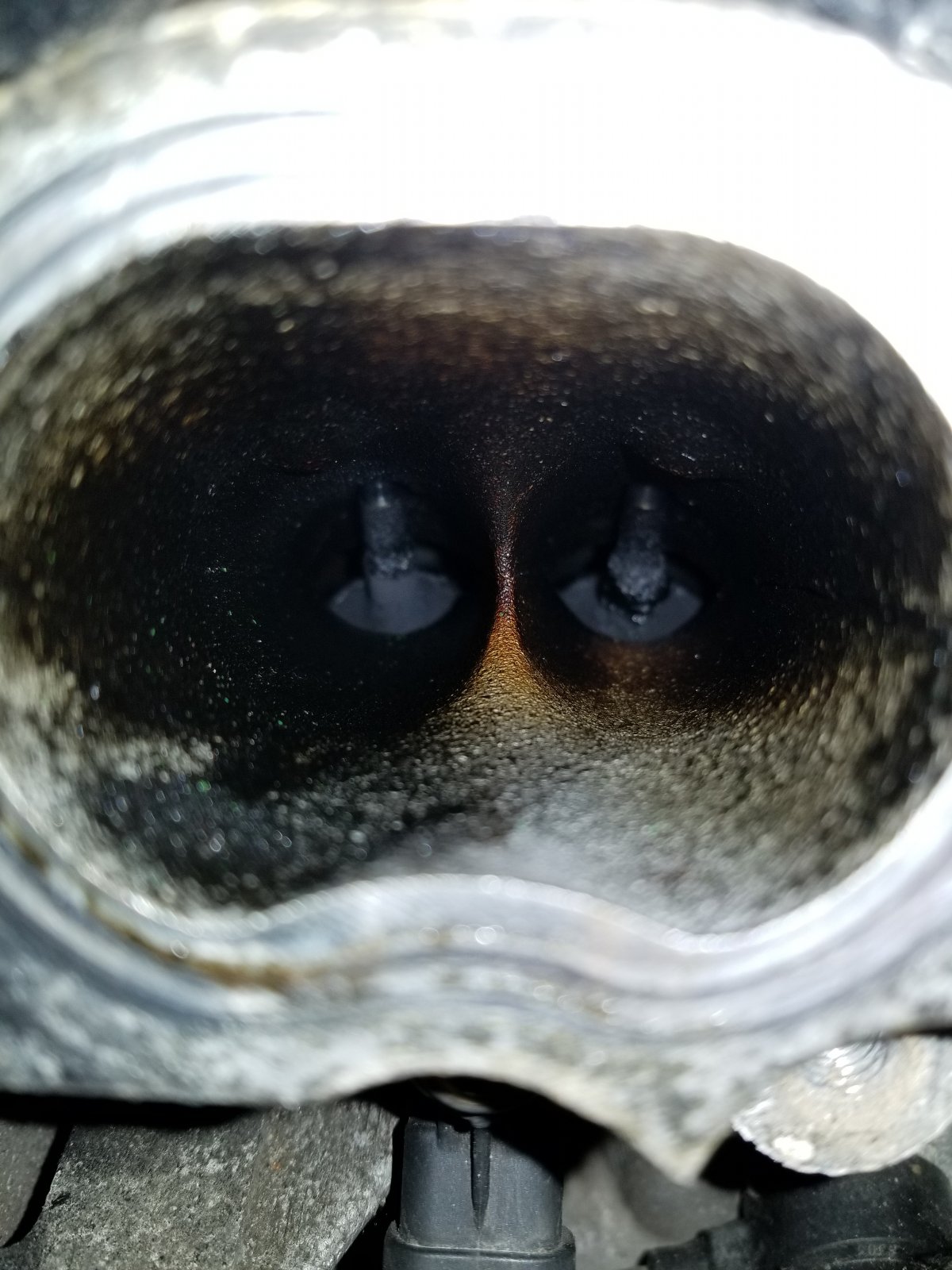

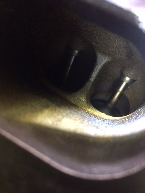

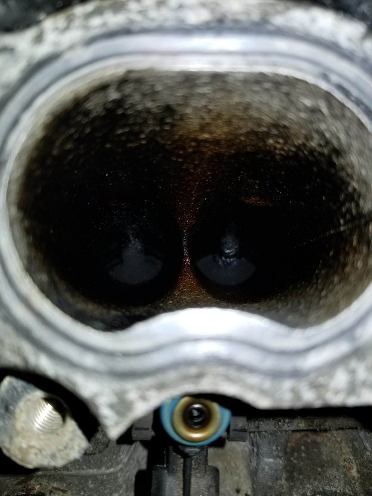

So I did a little more tear down today and here are some pictures of the valves with 110,000 miles looks like I have some serious cleaning too so :mad:
David
I just cleaned mine a few days ago. Do yourself a favor and spend $60 or so for a media blaster and some walnut shells. Lesson learned.
Yea I was looking into that I also read some where to soak them in acdelco top engine cleaner then go with a tooth brush.
How did you go about cleaning them?
Chemtool B-12 and a toothbrush. Took most of the day for soaking and scrubbing.
The chemtool works good, but a blaster would have done a much better and faster job.

So just a little update I finally found a solution to get rid of the donor I called a scrap yard and they sent a tow company and they give me 20 bucks at least it's better then nothing
