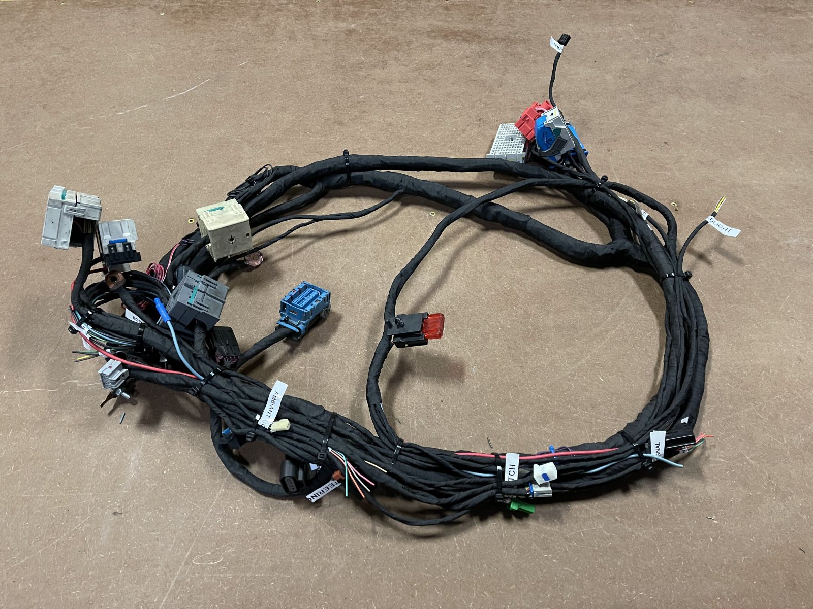

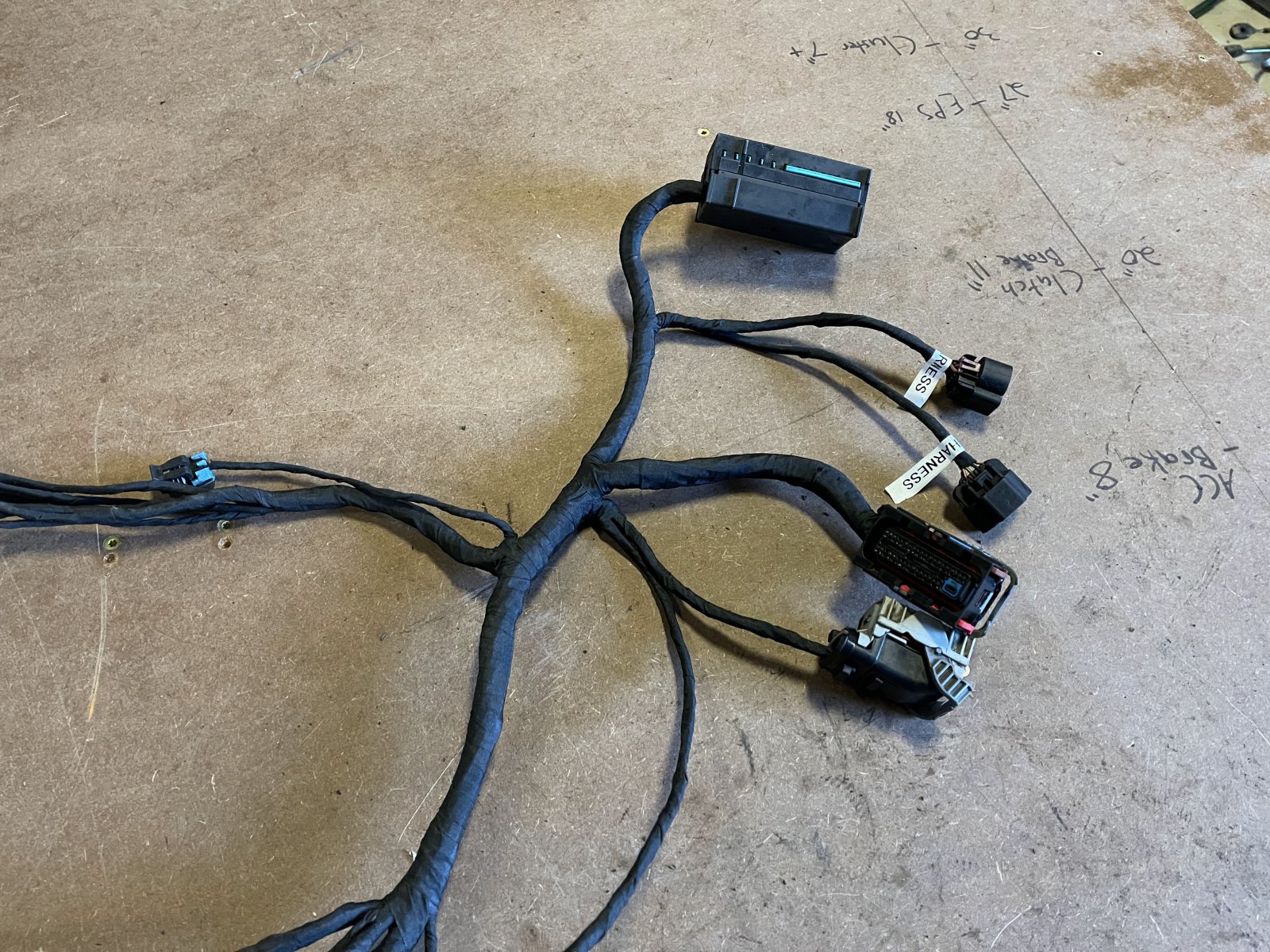

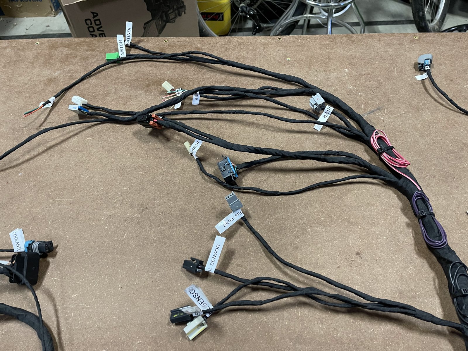

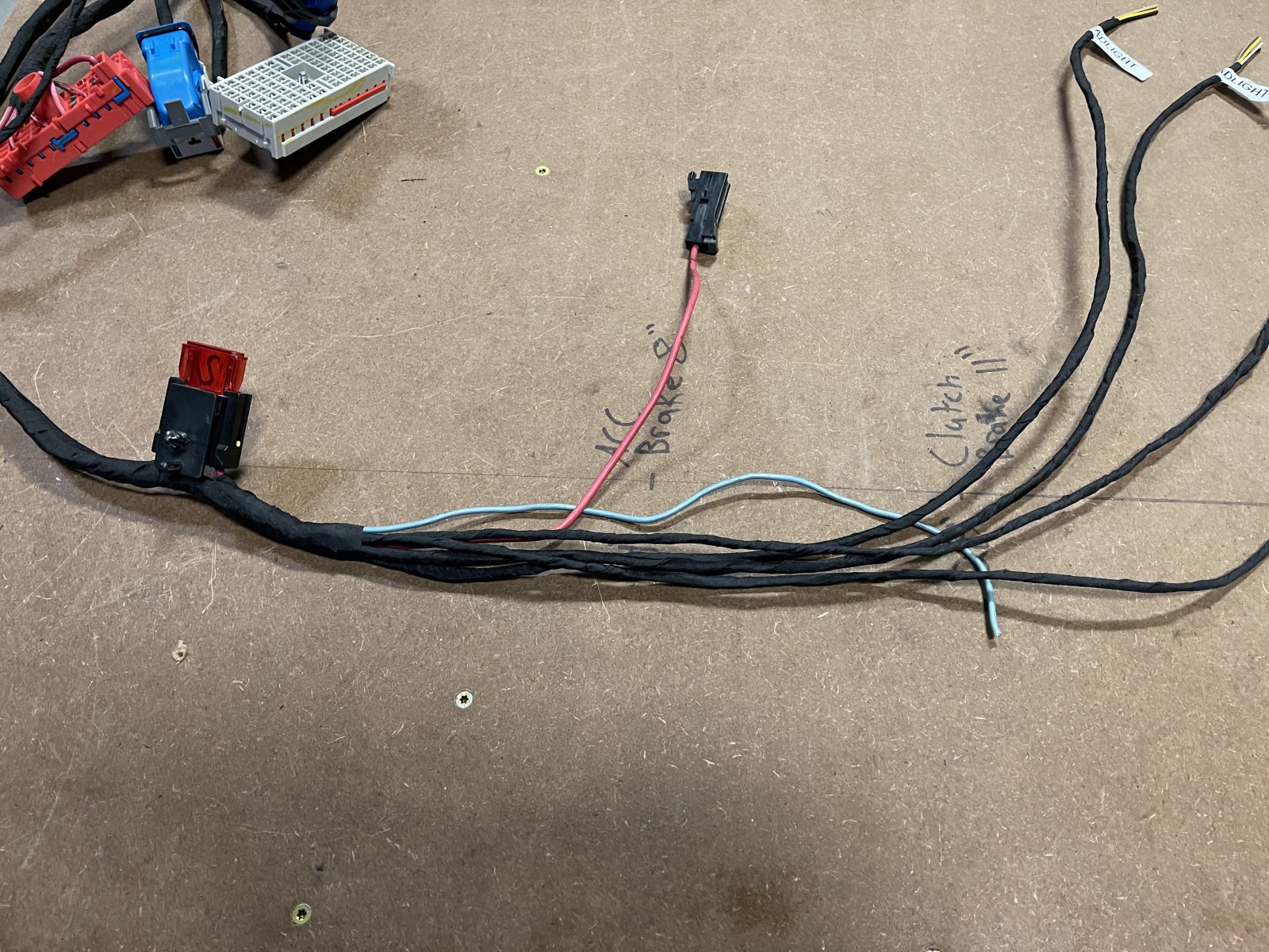

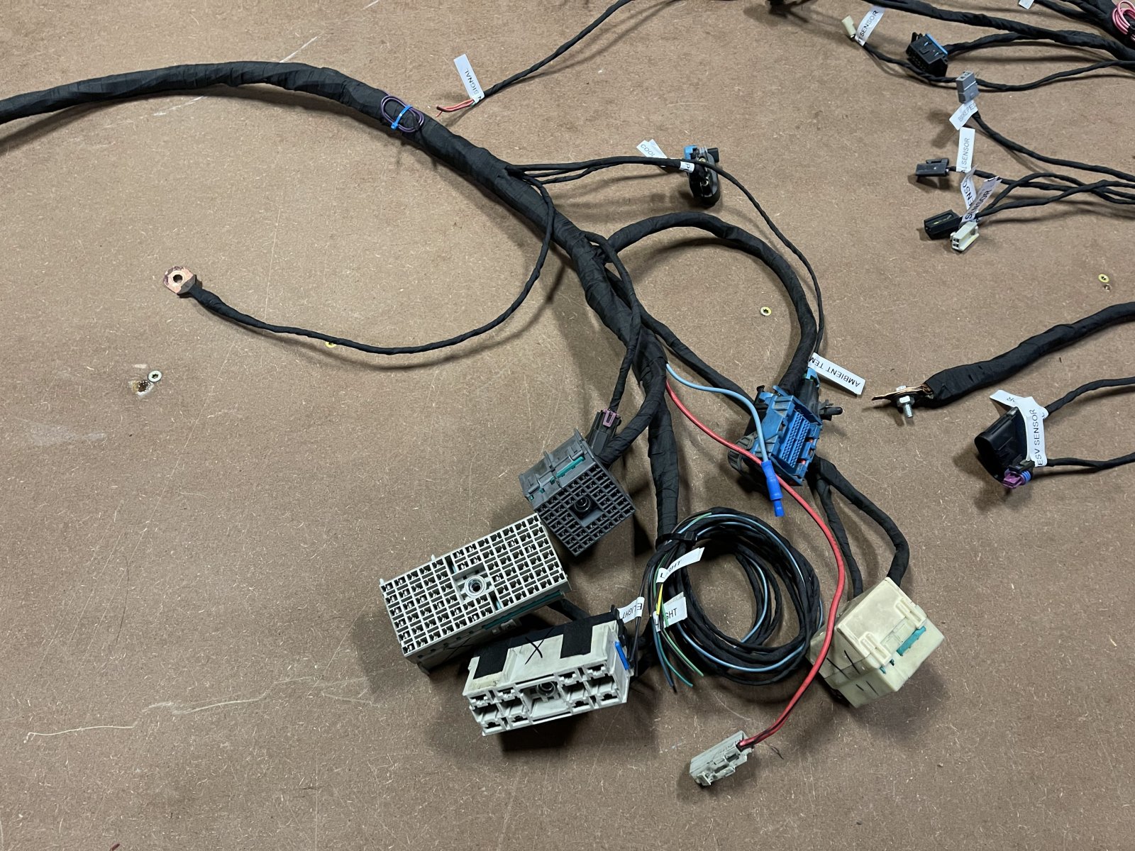

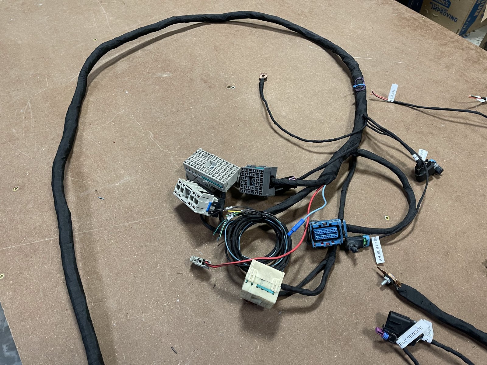

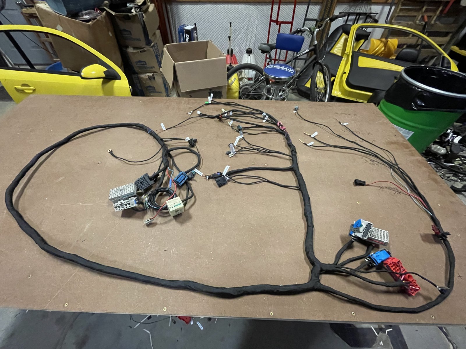

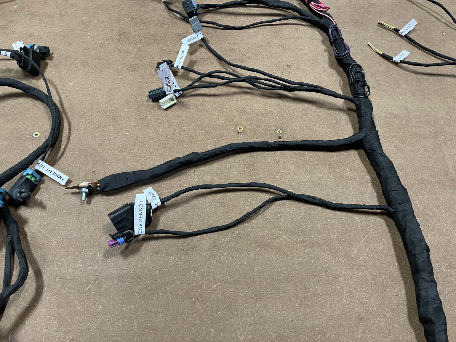

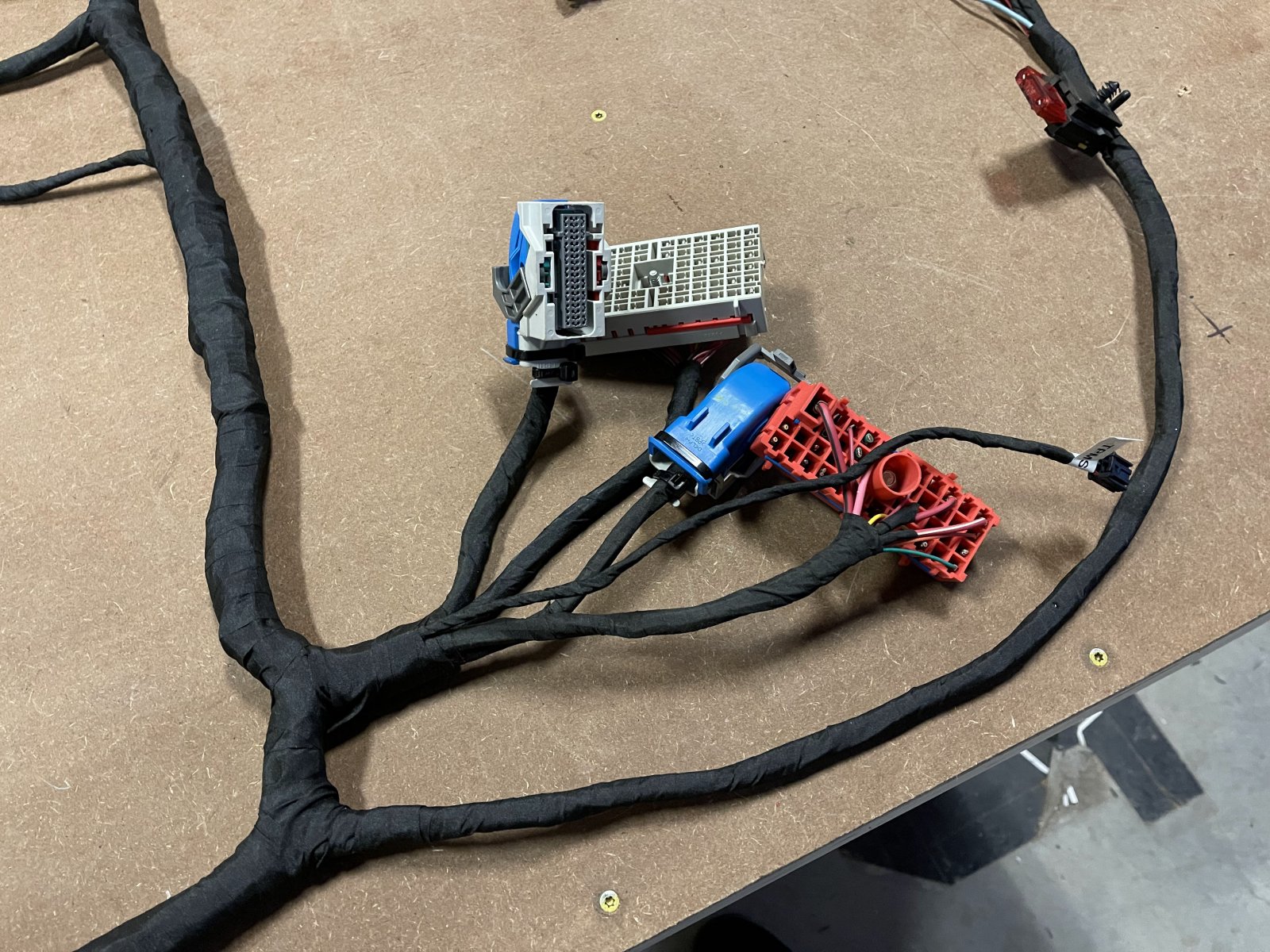

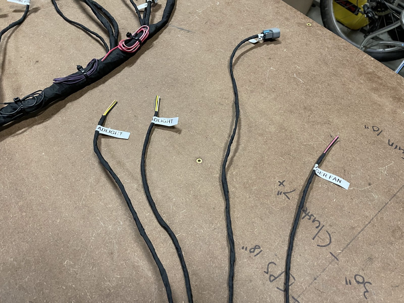

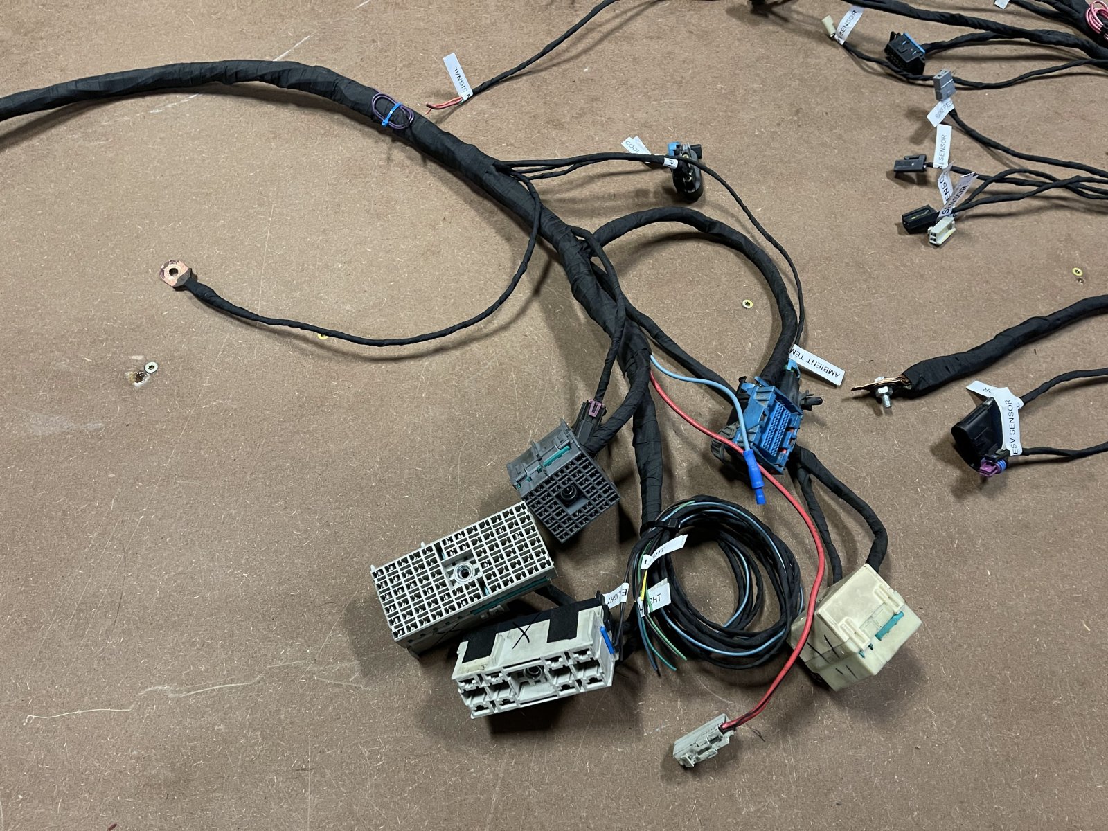

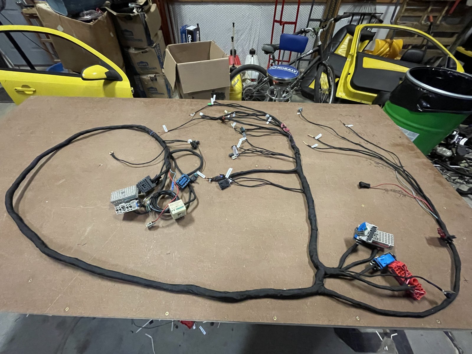

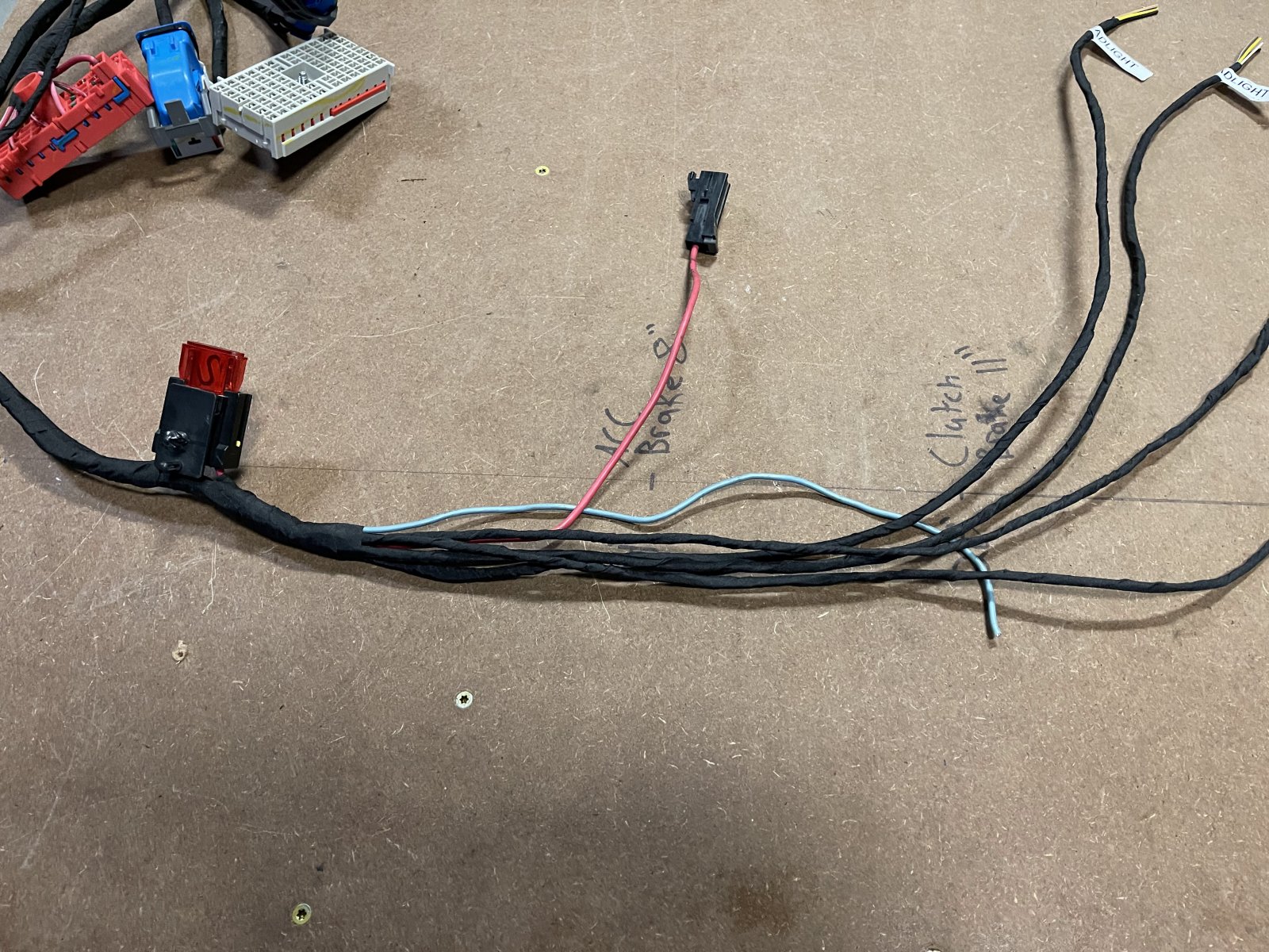

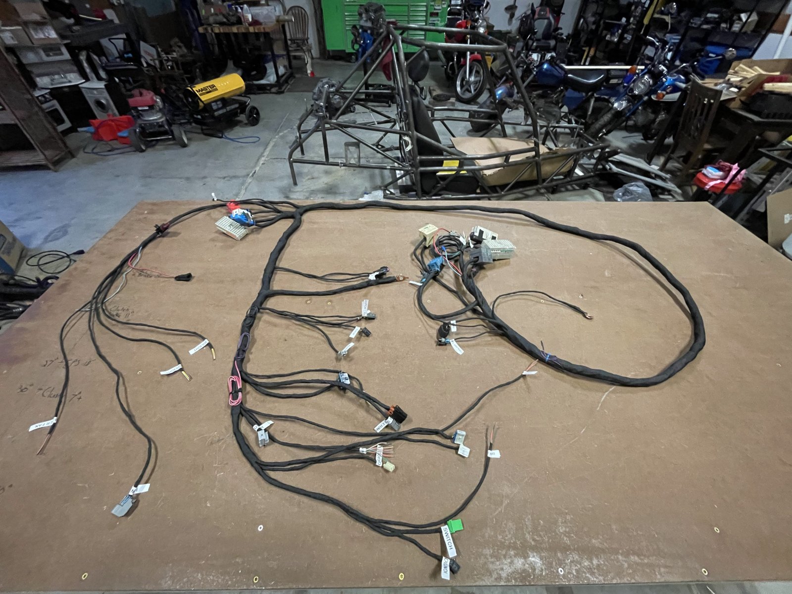

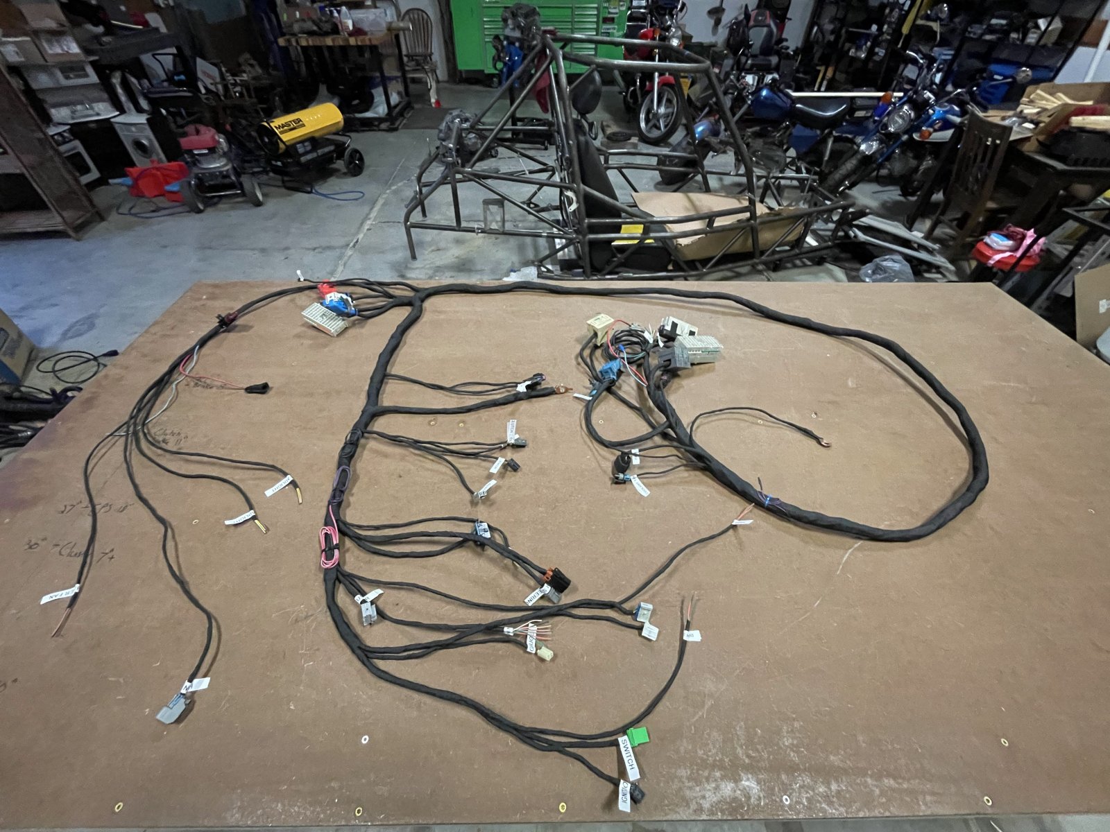

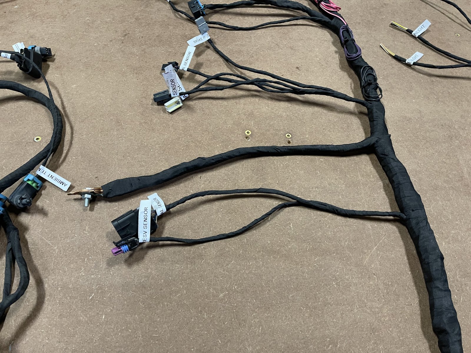

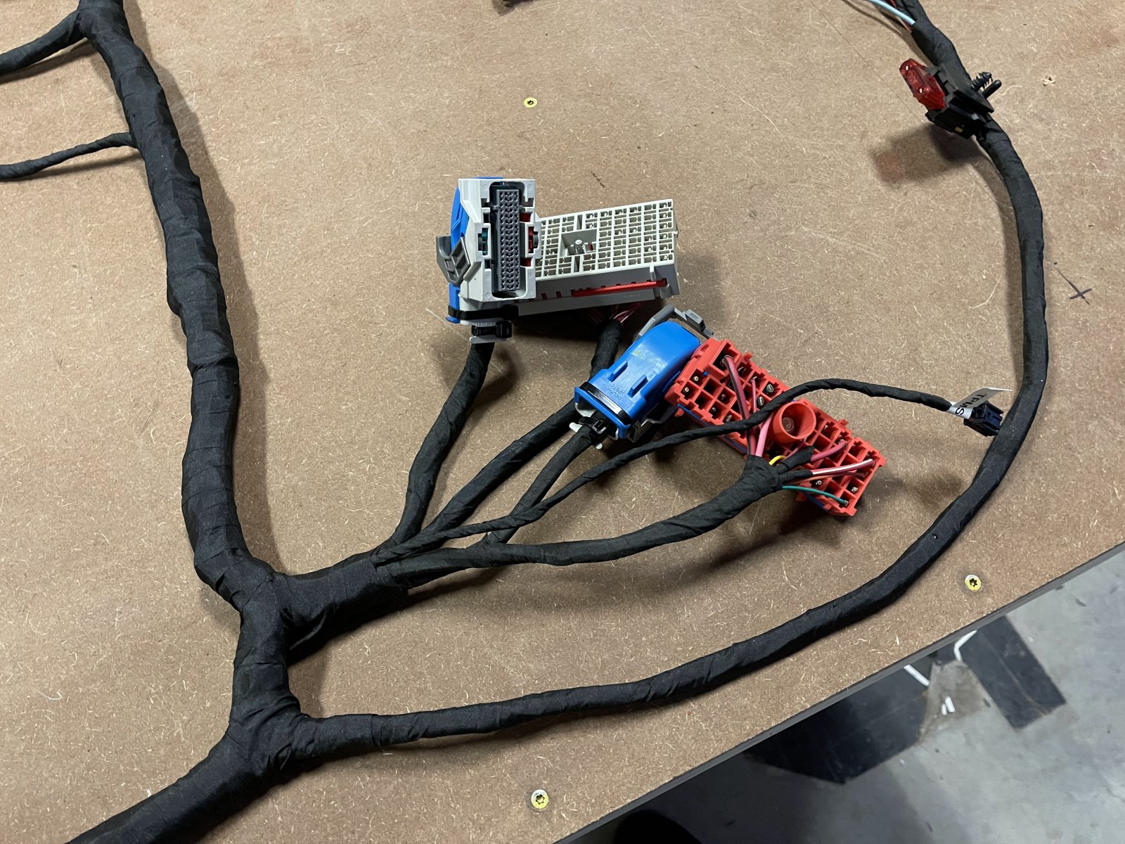

Wire harness is officially finished. Sharing photos for later reference, or for others.
Next up, cleaning up the engine harness.
PaulPerger
**** that looks NICE! The look of the cloth tape over normal electric tape is most definitely worth the couple of dollars difference in cost!
devianteng
Thanks! Tesa harness tape is about $6/roll, and I think I used 3 rolls on this harness, and may use 1 more on the engine harness. Cost is so negligible that it's a no brainer to me. Also considering using a split wire loom, at least in the tunnel and a few other areas.
PaulPerger
Ditto. I am also thinking about using a wire "wrap" on wiring that will visible in the engine area.

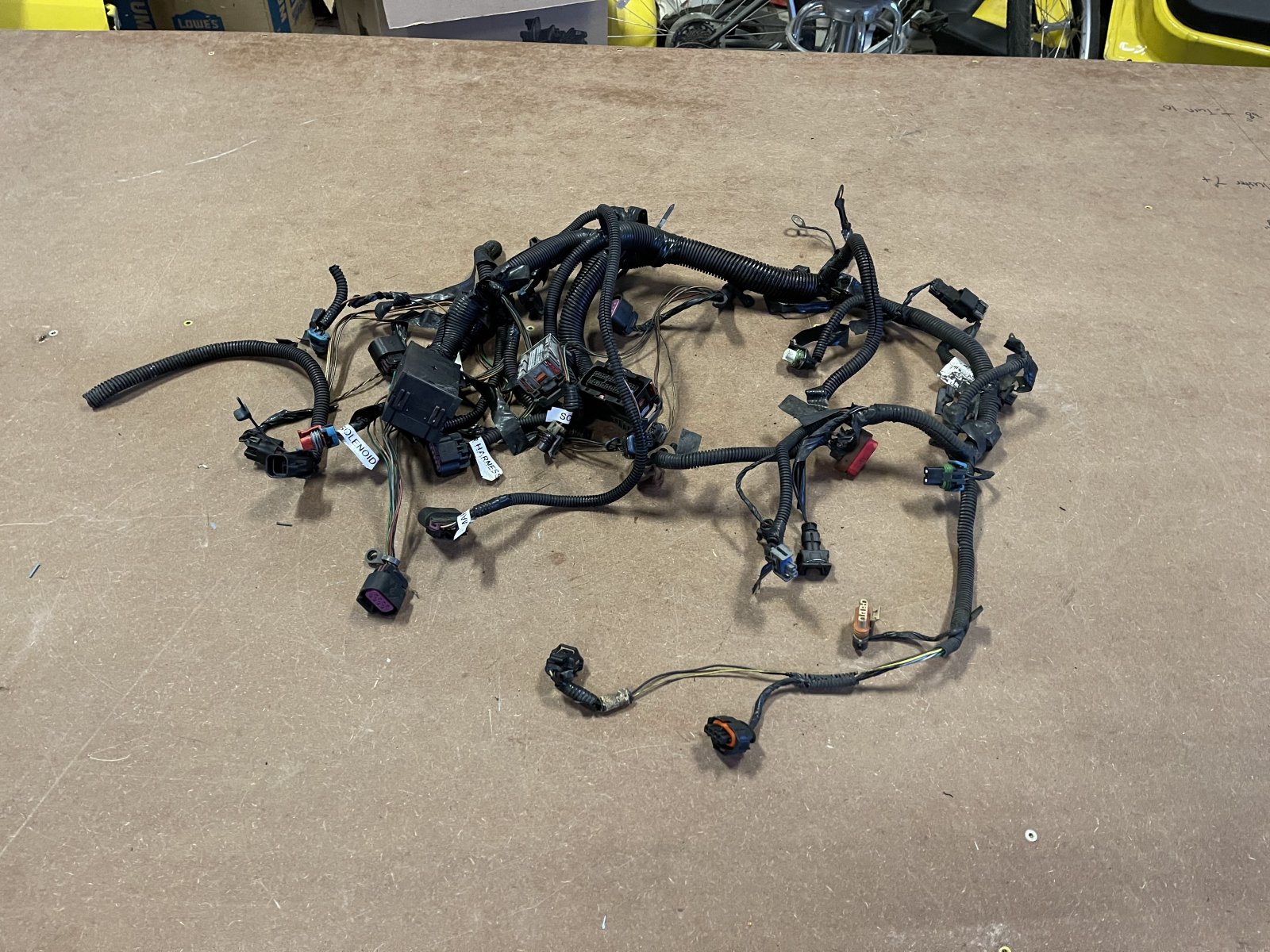

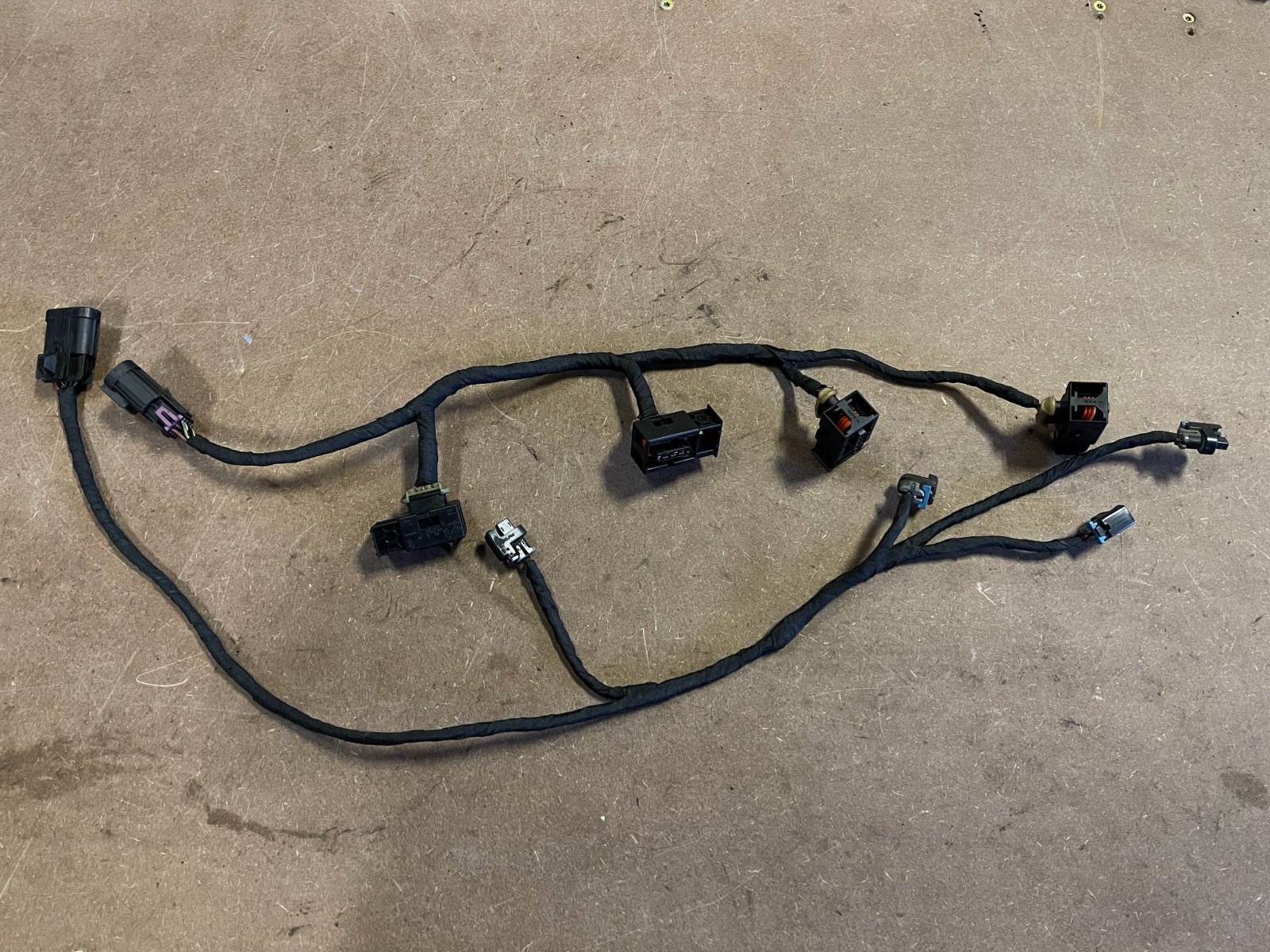

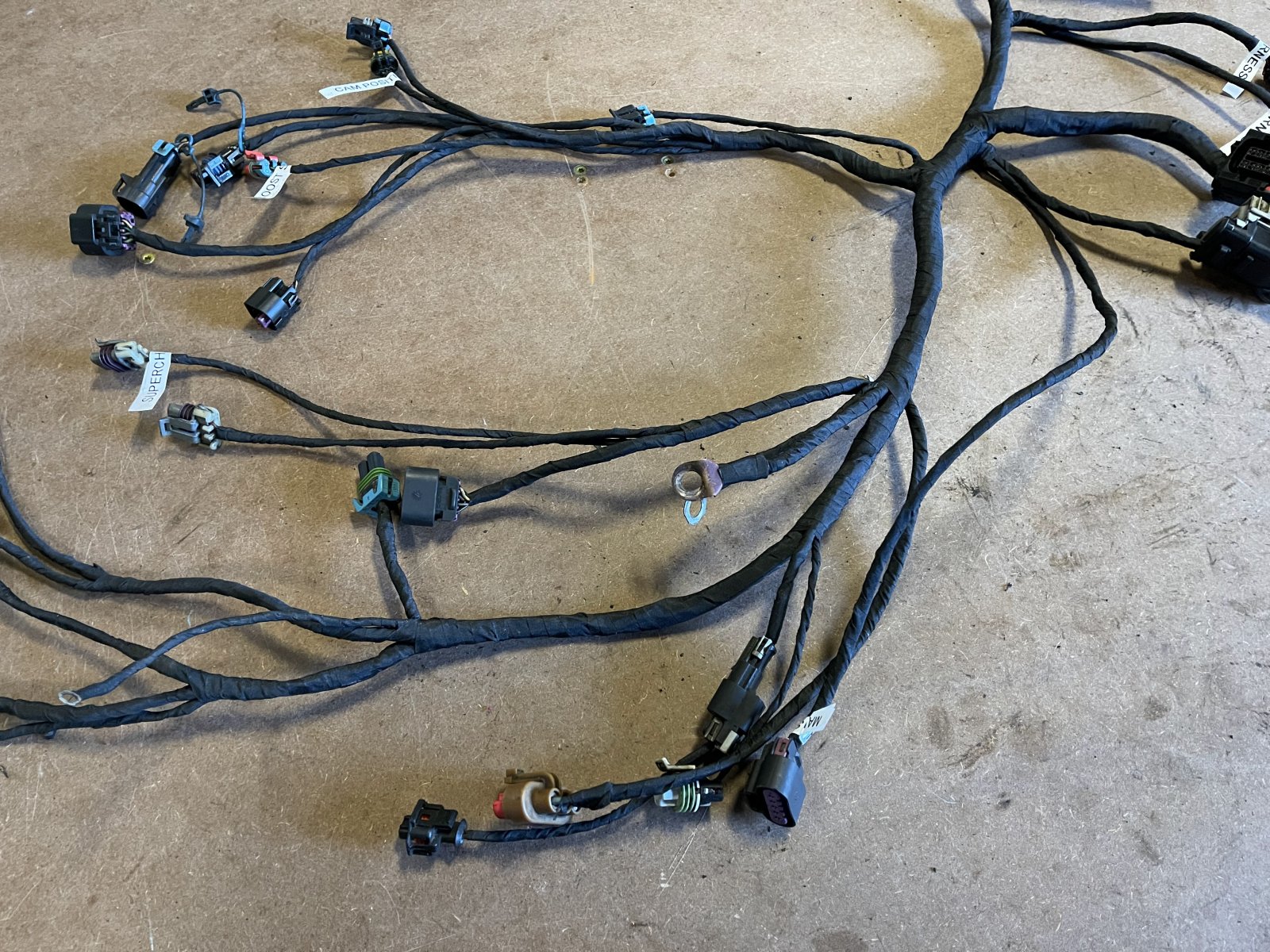

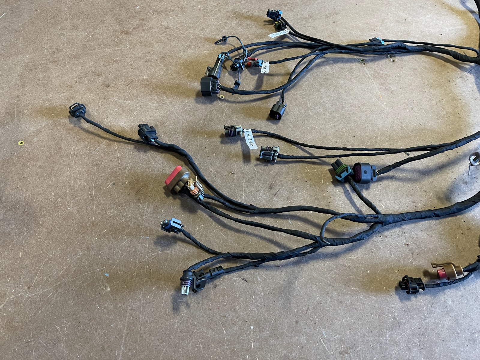

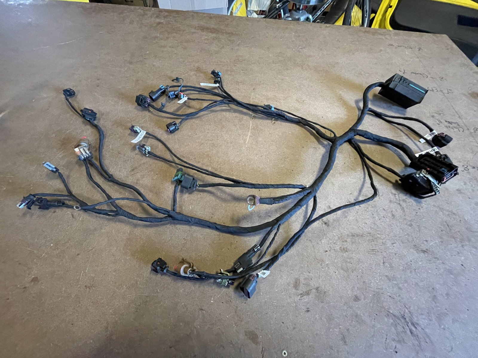

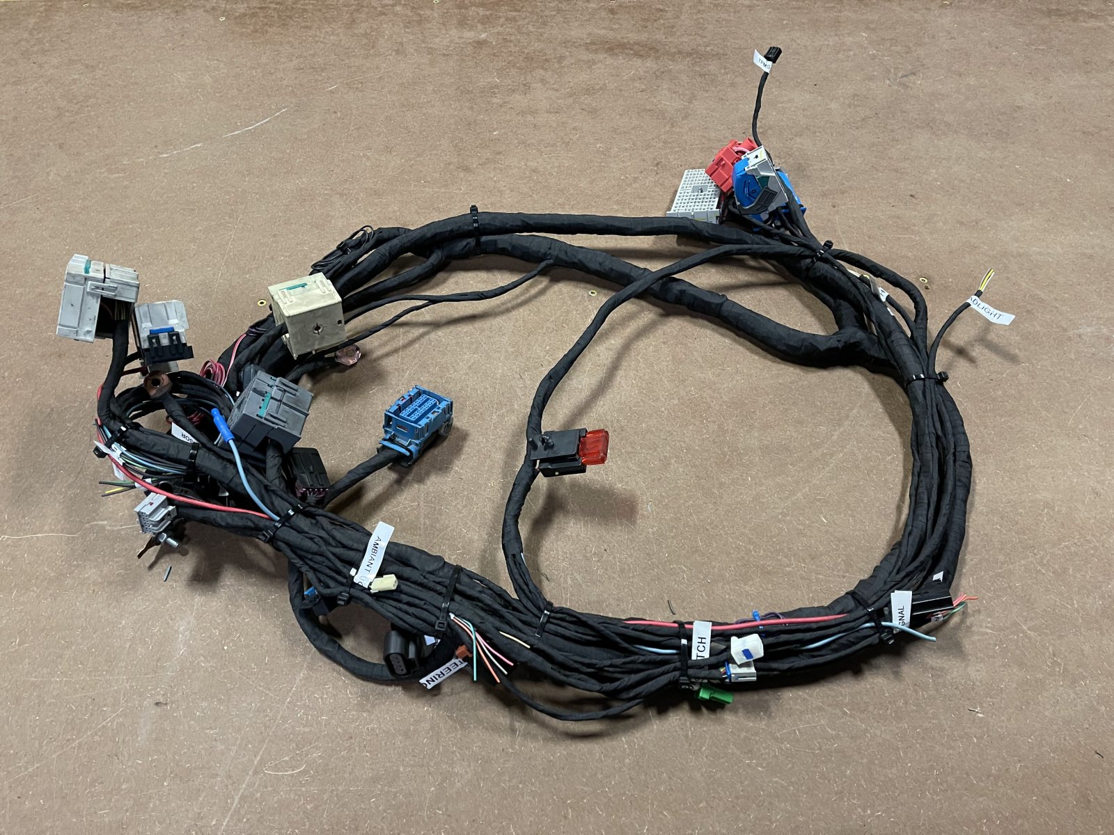

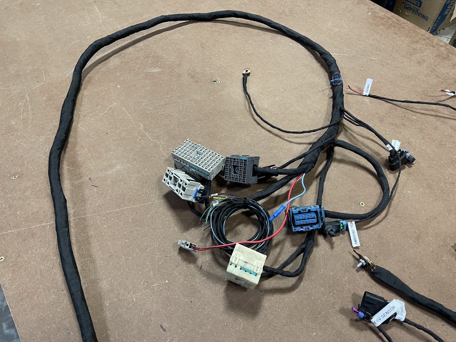

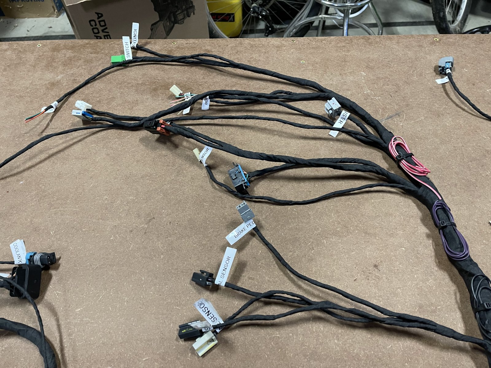

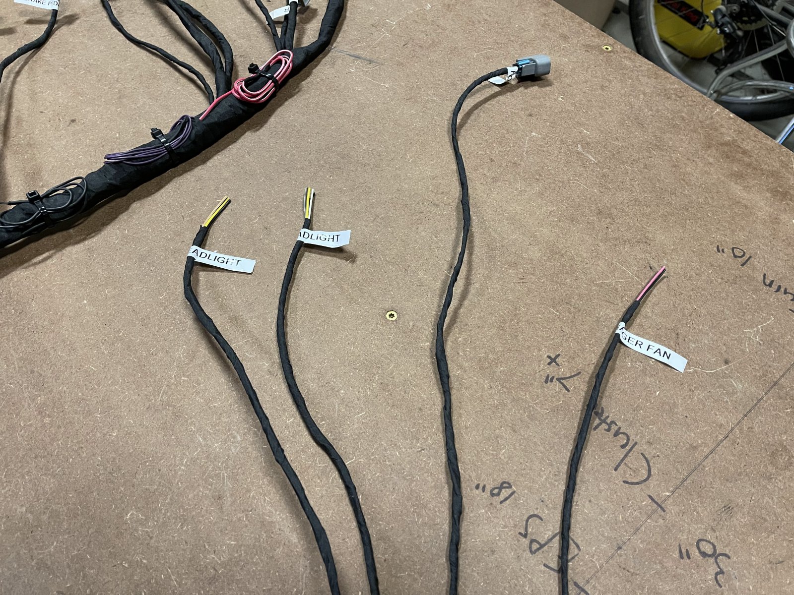

Engine harness, including injector and coil harnesses, have been cleaned up.
Time to turn my focus to my frame and get roof bars and trick tabs welded in, then prep all parts for powder coating. Has anyone made a list of all the small parts I should get coated/painted? Would be quicker than figuring out my own list. :D
Before:
After:
Injector/Coil harnesses:
Sluggonaut
It looks like you kept some connectors you don't need, like the radiator fan connectors. You'll want the light blue wire from one of the radiator fan connectors to connect to the extended light blue wire for the new radiator fan up front.
I cleaned up my harness after I installed the drivetrain as I wasn't sure if the MAF or other connectors needed to be moved from their stock location. I also thinned out the radiator fan, downstream O2, and EVAP wires/connectors.
Yeah, unfortunately a lot of those connectors were disconnected my someone who was trying to "help me", which means I didn't get to label them. As I was taping things up I got to wondering about some of those things like Evap, MAF, etc and if those would need to be lengthened or shortened, and decided that I'll revisit that harness if/when the time comes. Not like it took that long to tape up or anything.

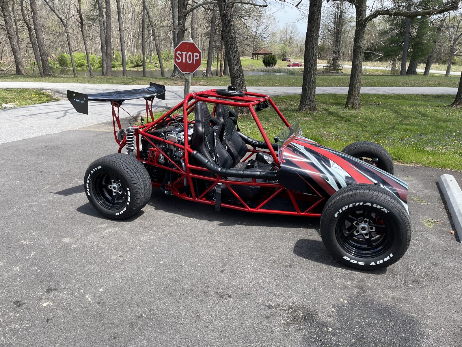

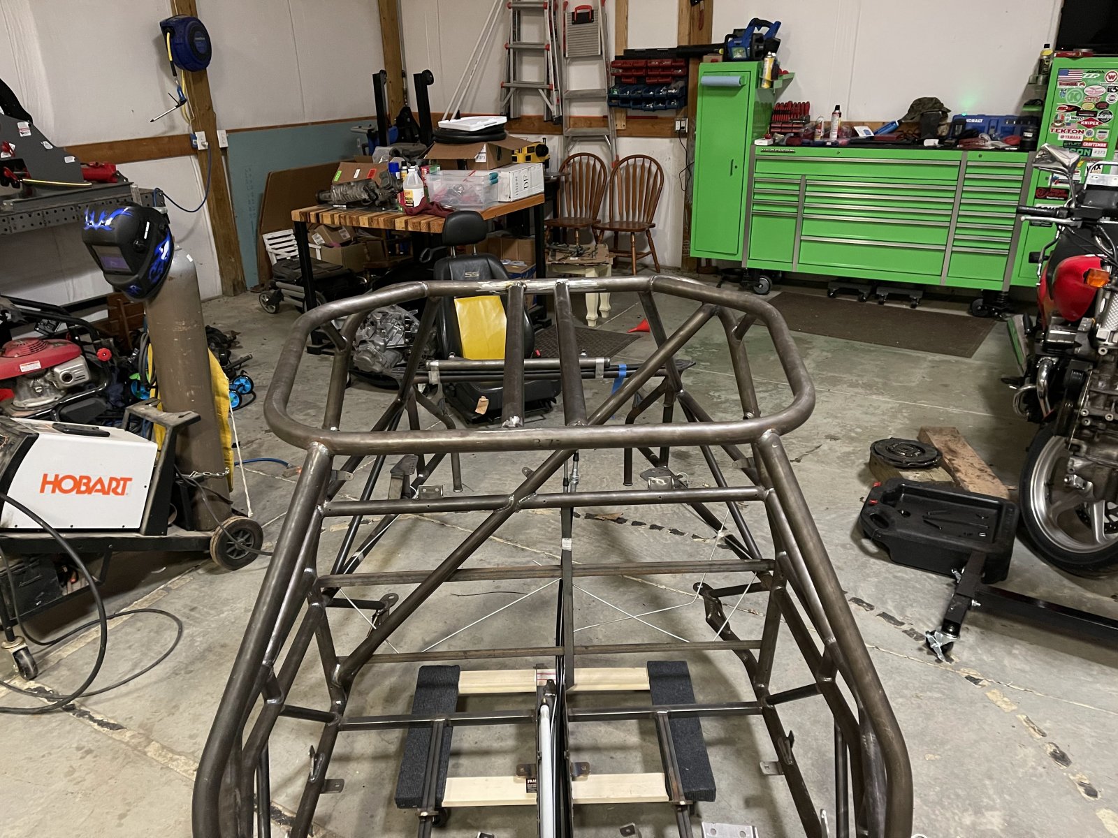

Unfortunately not much progress lately, other than welding in some roof bars. Was hoping to get my trick tabs welded on by now but didn't get the chance. (photo is just bars tacked in -- I'm not sharing photos of my welds, haha)
On another note, I finally got the chance to meet up with @MR.812 and go for my first Goblin ride! Unfortunately I didn't fit great in his standard frame, and my knee broke a tab of his gauge cluster that he has mounted below the dash cluster. (again, sorry!)
My immediate feedback about the Goblin platform is that 200hp in a 3200lb car is way different than 200hp in a sub 2000lb car. I definitely plan to still turbo swap mine once it's on the road, but even with the stock LSJ it's got more than enough power to walk just about anything on the street. Riding in his also confirmed that I want to do a square tire setup, oh and that I really liked his seats which fit me pretty good (I'm 6'2" and 280lb, so a big boy).
I've got some out of town travel coming up this weekend and next week, but once I'm back my focus will be getting this frame coated. Also hoping to meetup with a few other Goblin owners this weekend (@jaredthenav and/or @r3drckt) if their schedules allow. I promise not to break anything else!
