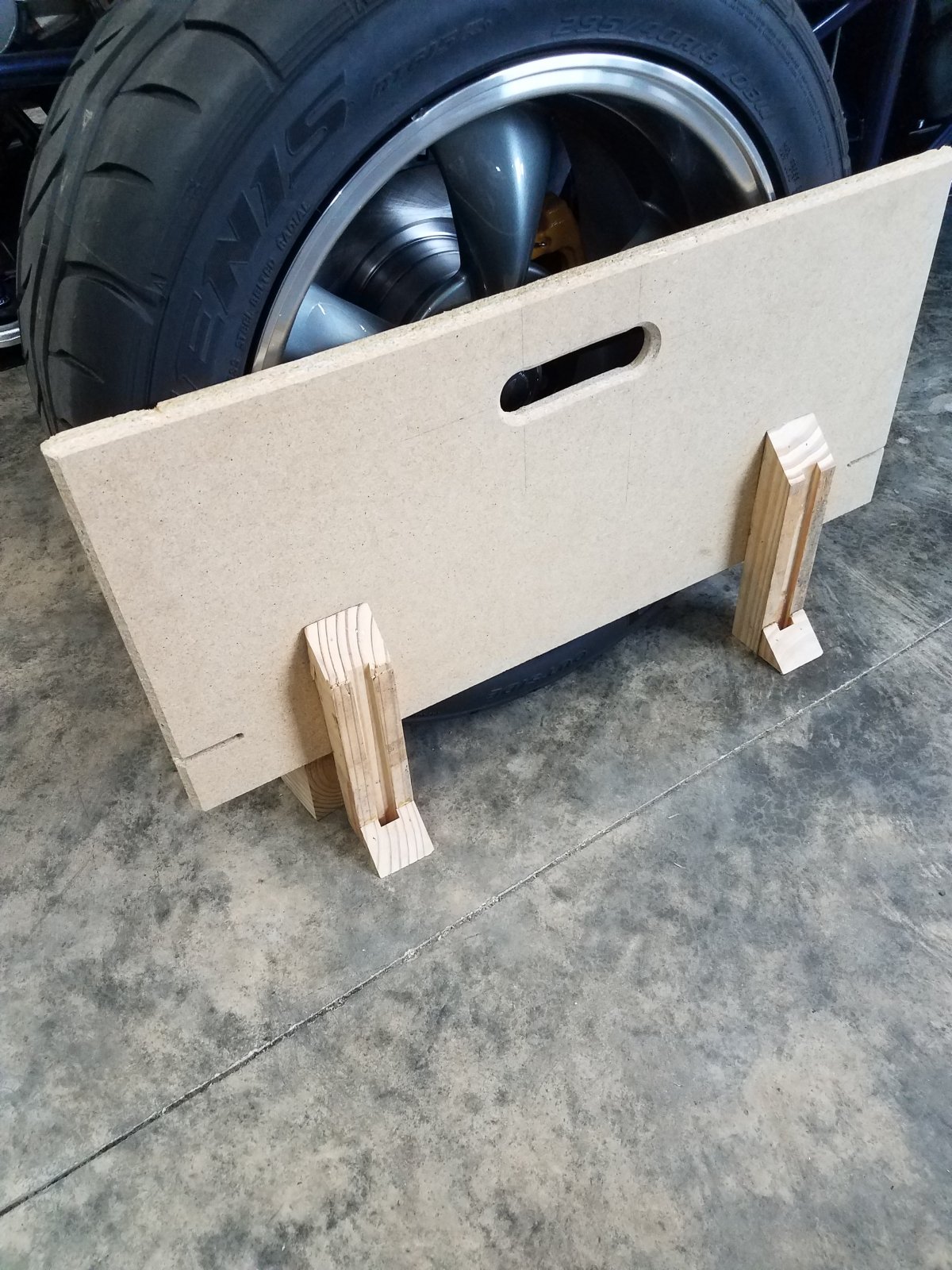

Who needs fancy name brand or knock off toe plates....
35770
Who needs fancy name brand or knock off toe plates.... View attachment 35770
Very nice. As good as an expensive setup. Key is having two identical tape measures.
Here was one example of the string method. I tried it too. The DF diy is hard to beat though.
