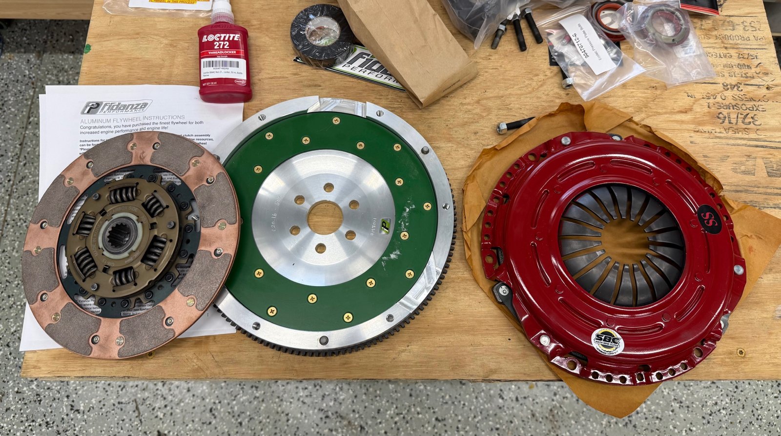

New clutch, pressure plate & Aluminum Flywheel arrived today. Well packaged & ZZP ships very fast. Going to replace the Crankshaft seal, the axle seals and put in a new throw-out bearing. Need to check the clutch "air gap" and see if I need a spacer.
PS: The "GREEN" on the flywheel gets removed with Acetone.

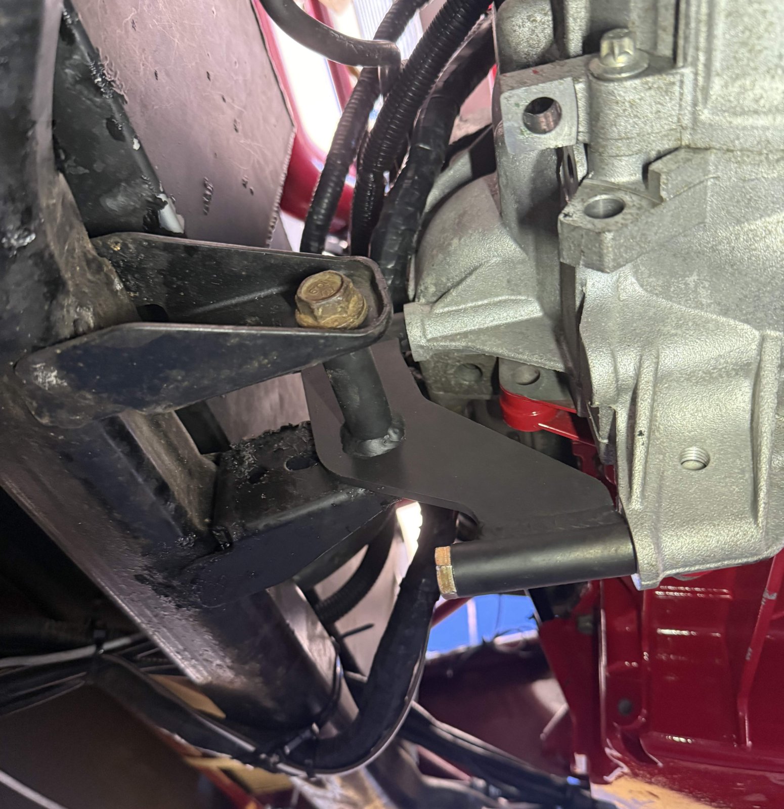

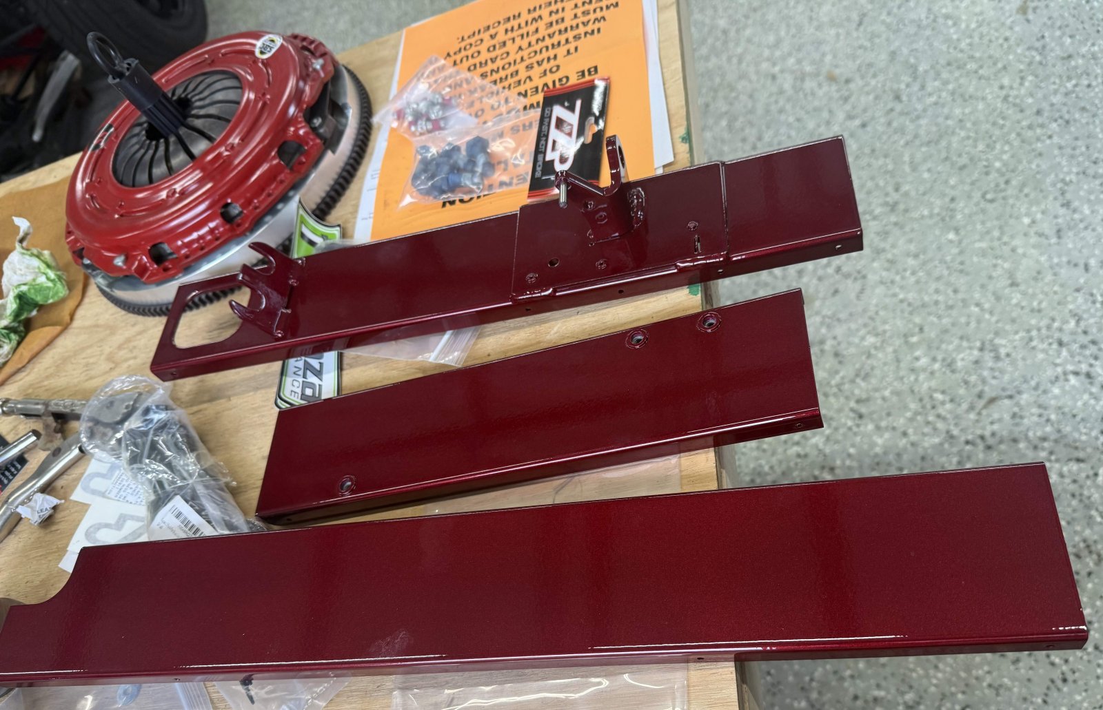

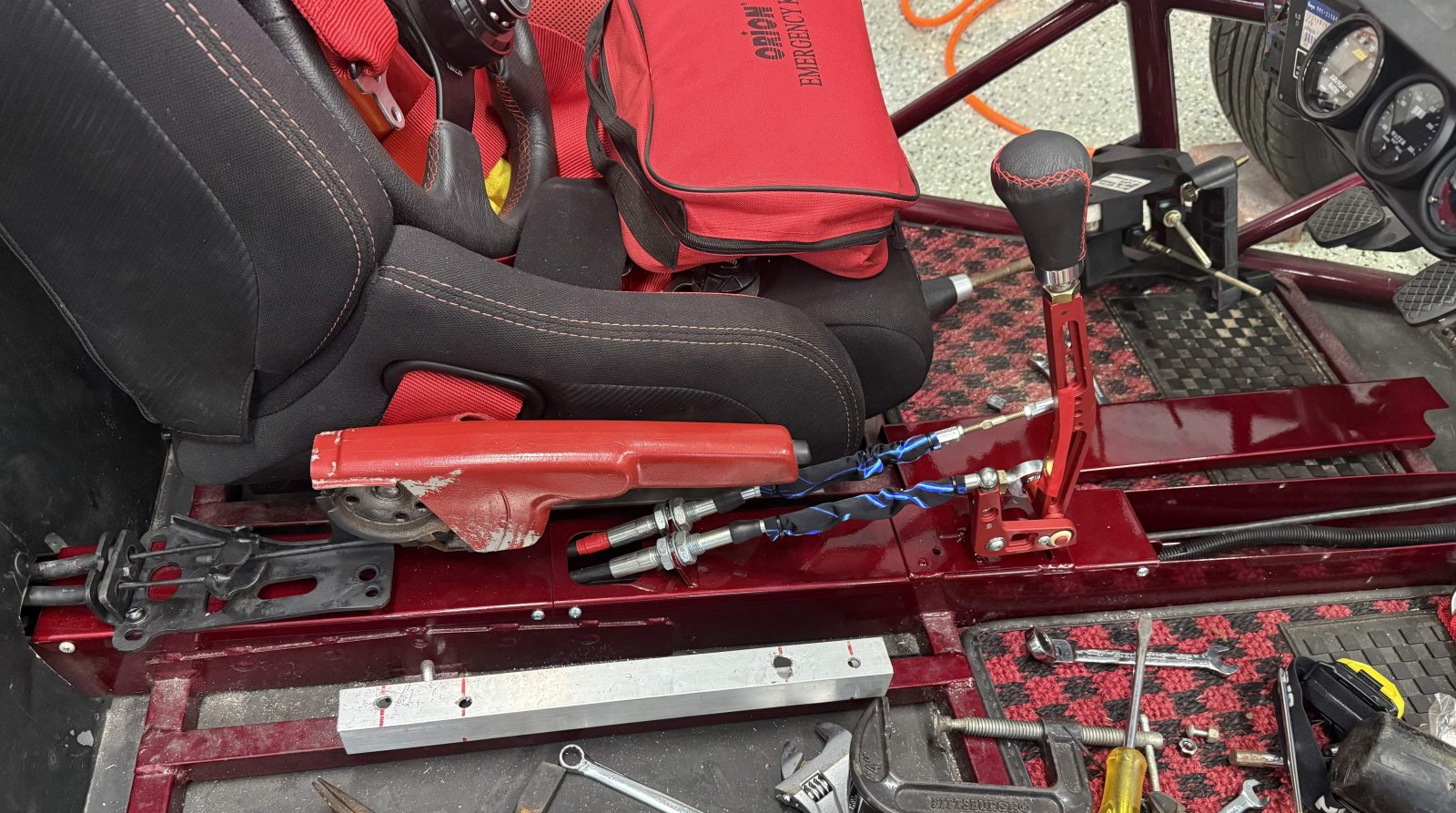

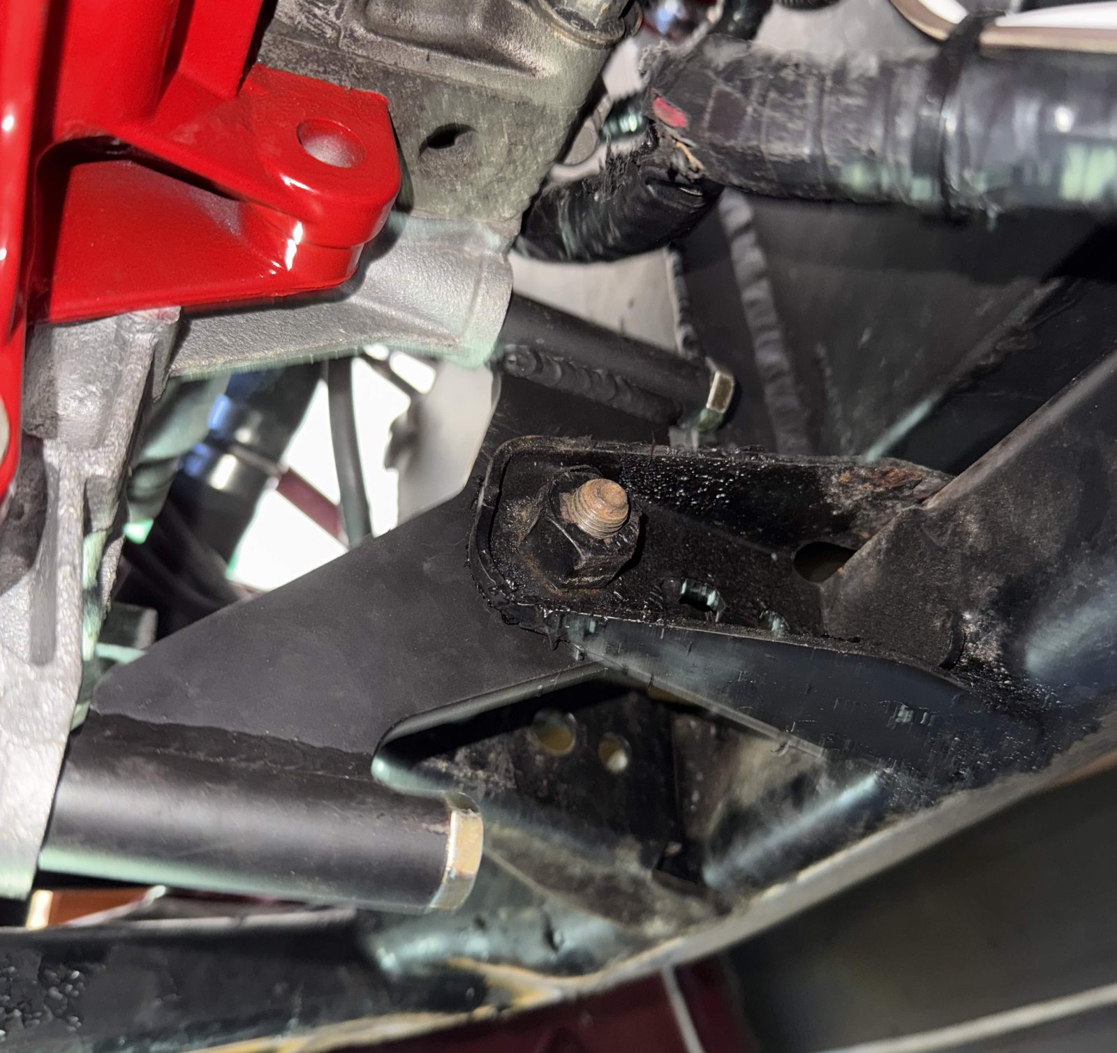

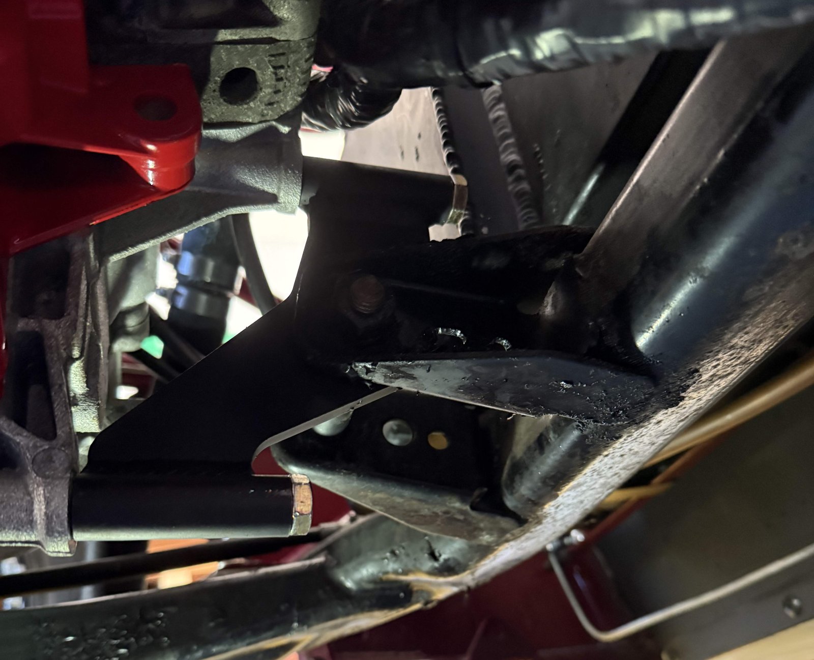

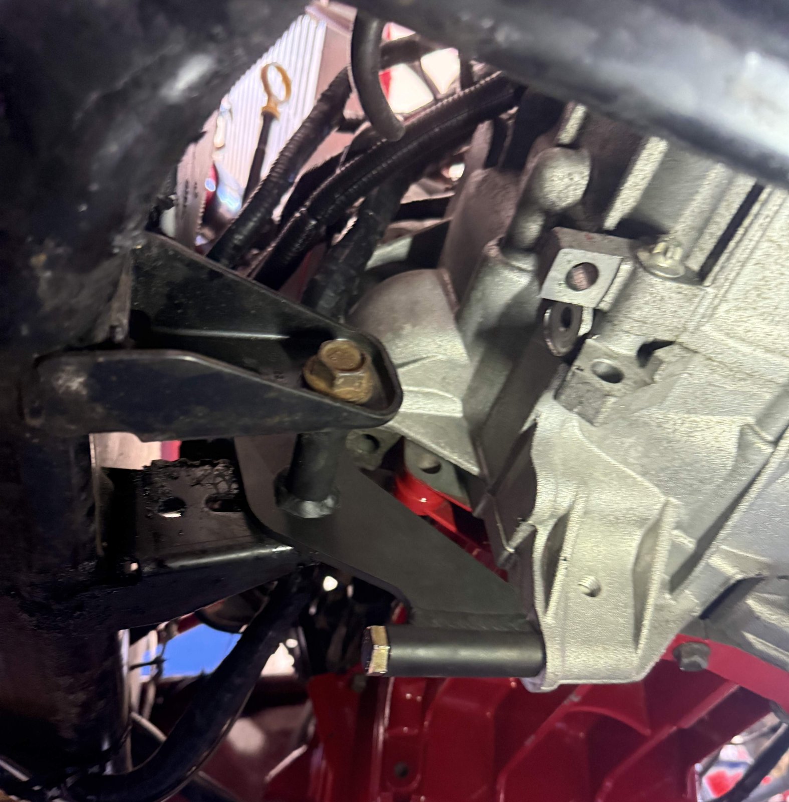

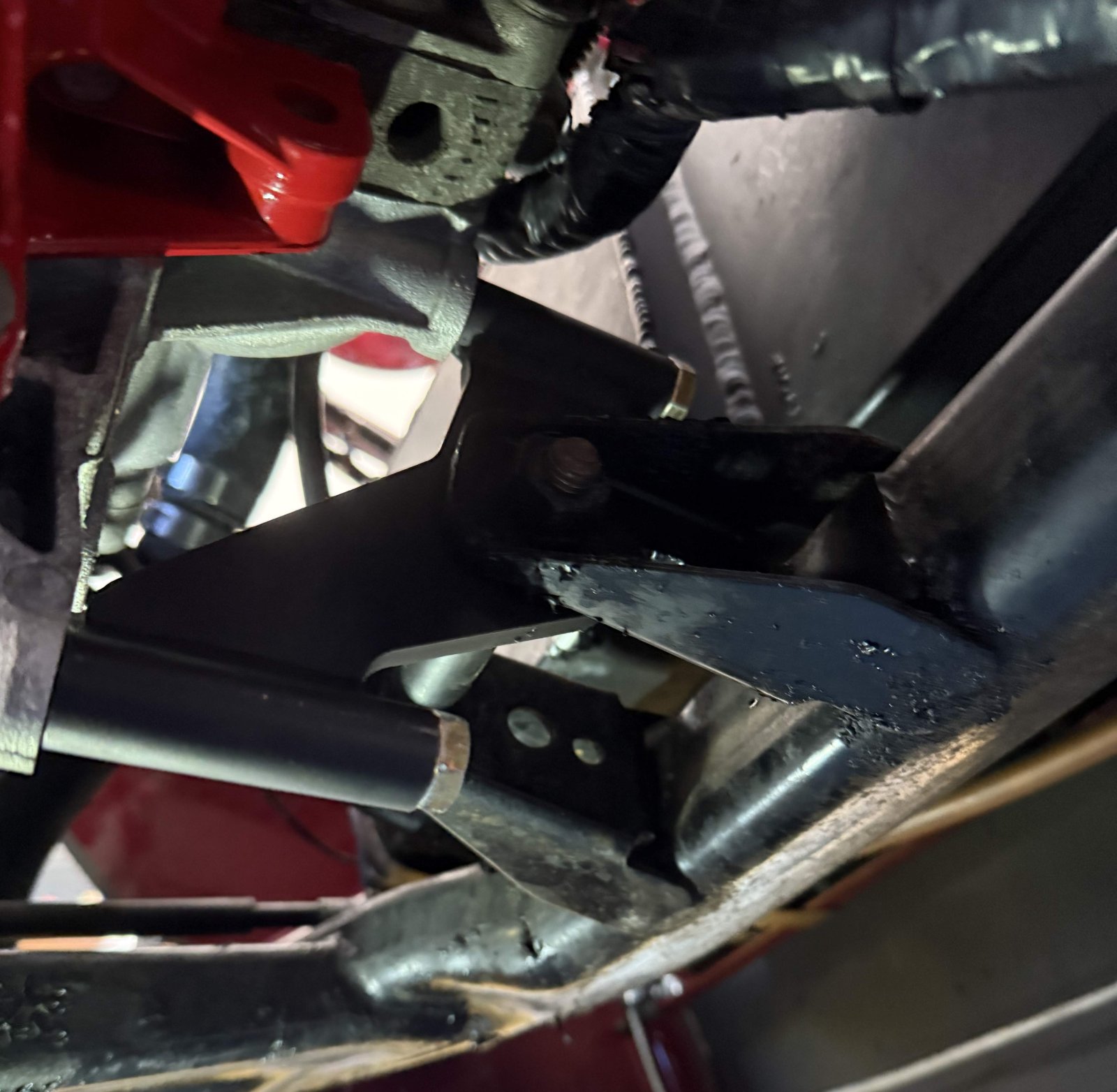

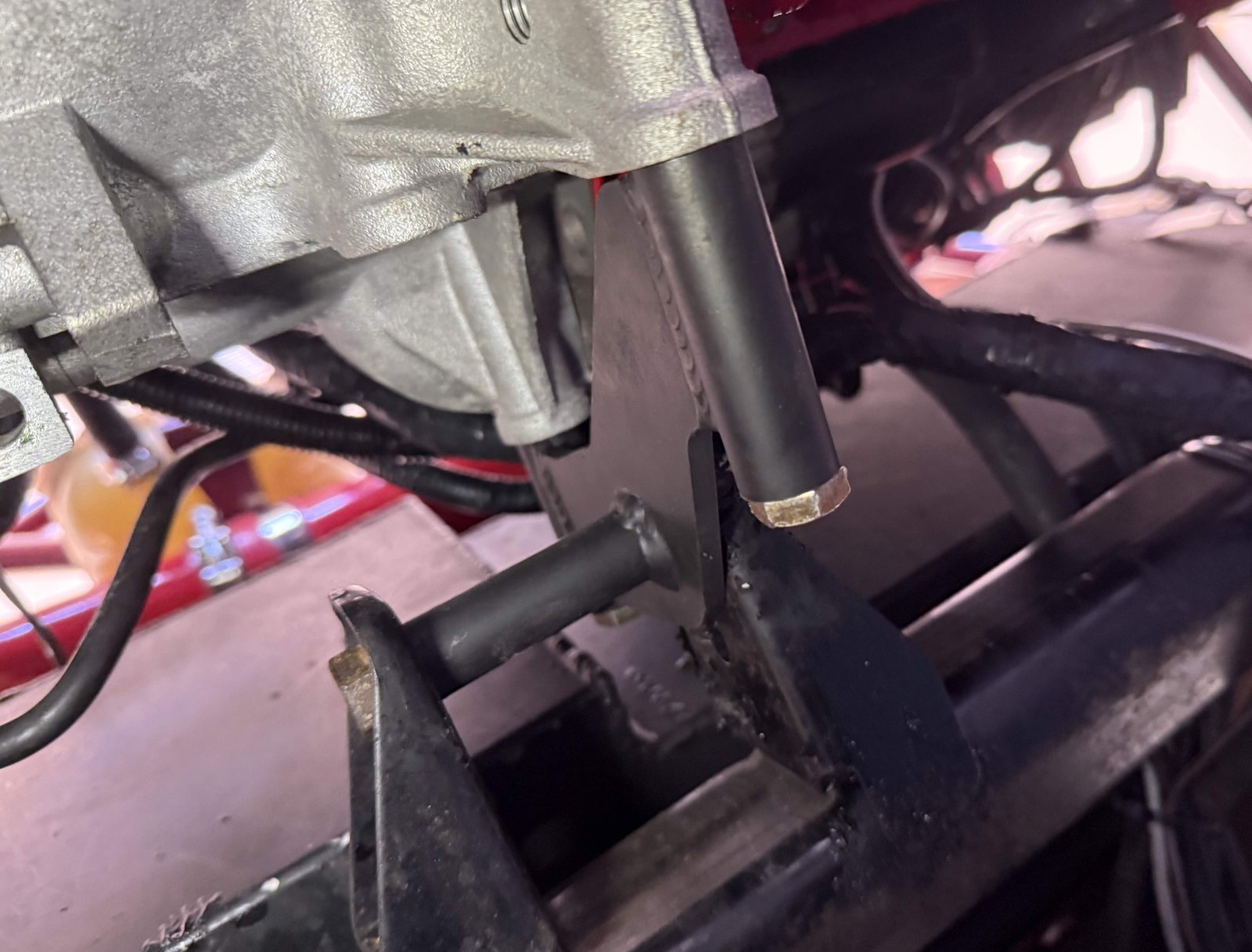

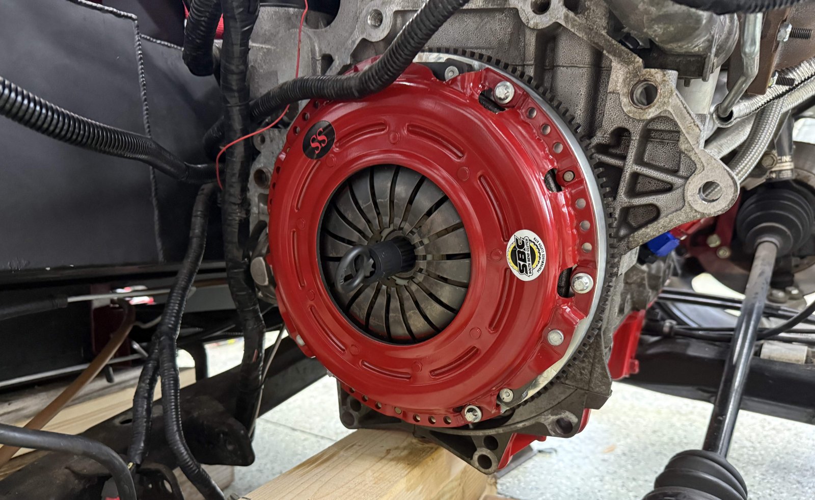

New ZZP Stage III clutch installed. Quite a project. While I had the car torn down I put in the new DF Billet Shifter I had for well over a year. Replaced rear crankshaft seal (was not bad) & both axle seals (also not bad). Installed the front rigid Transmission mount. I could not find any video for the installation but after 15 minutes of puzzle solving I figured it out (see pictures). Mount had interference on one bolt from the fuel tank which I had to shift 3/8" to the drivers side. New clutch is stiffer than I thought it would be but it's manageable. Short test drive today & I believe I have a vacuum leak.
