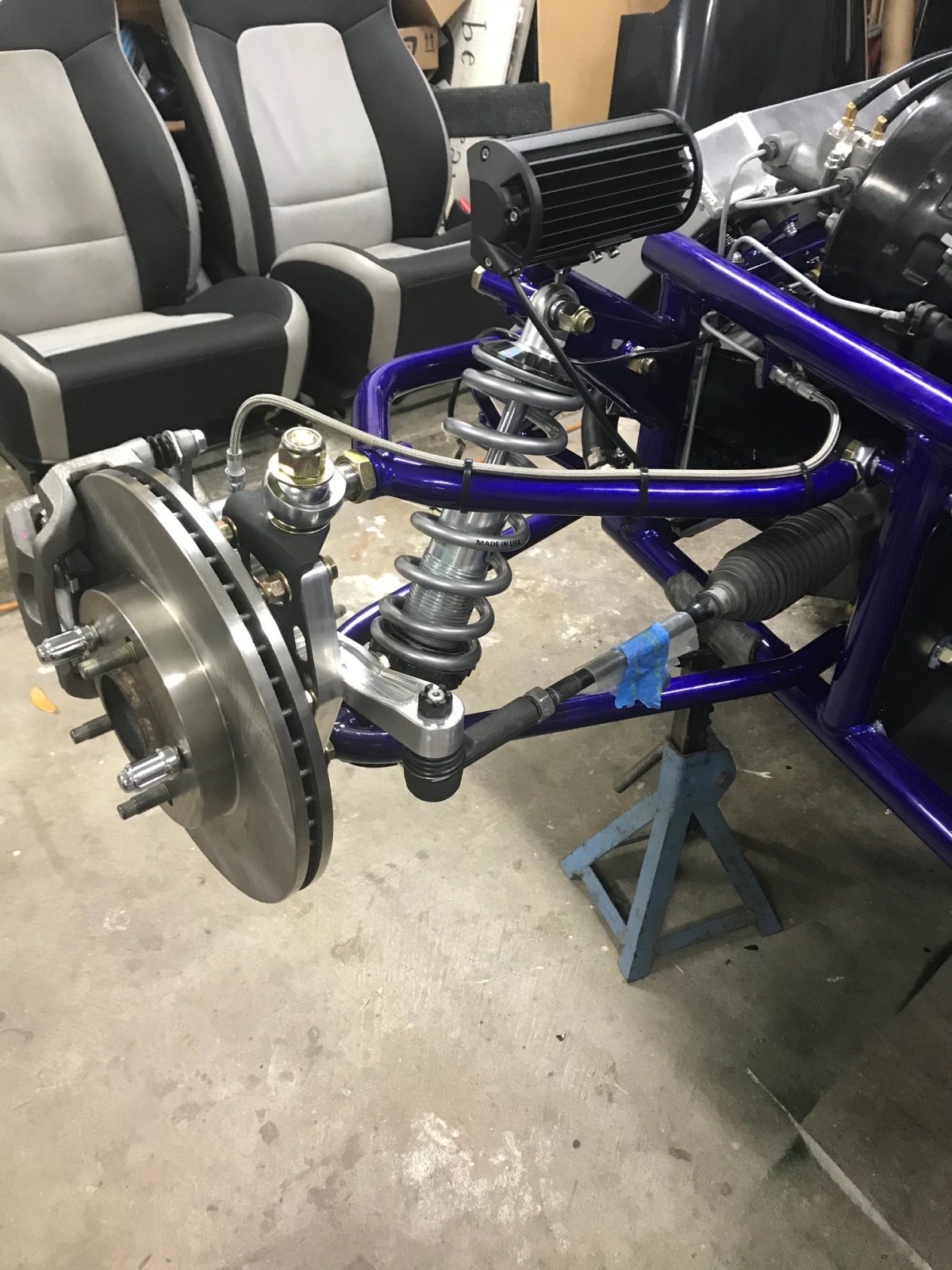

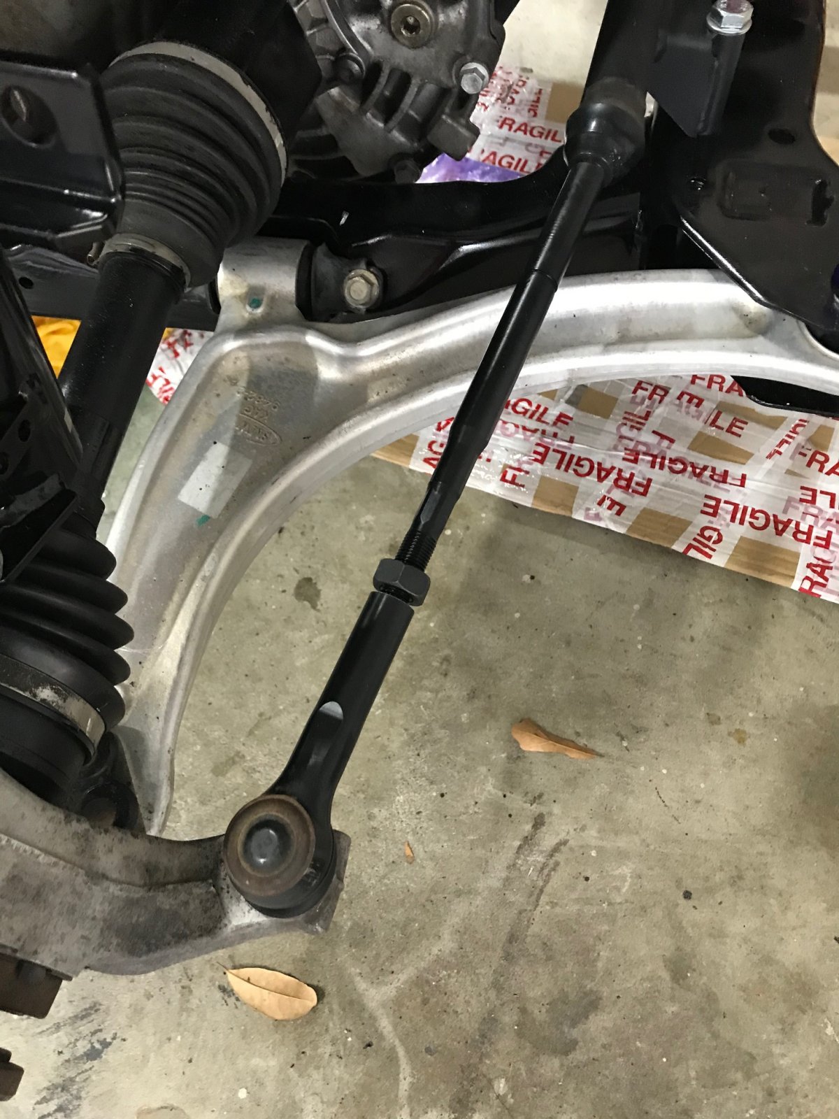

Started with swapping out the tire rod ends - new short ones in FRONT, old long ones in REAR. :)

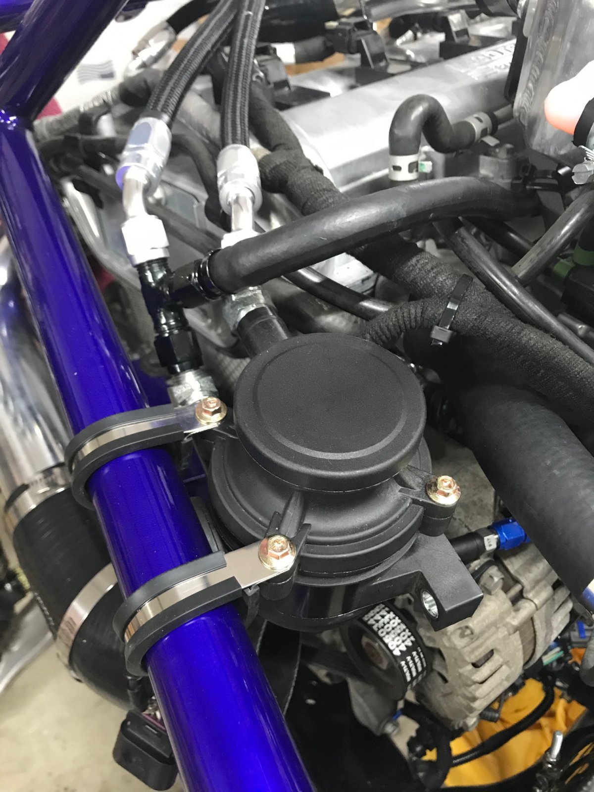

Situated and mounted the air/oil separator

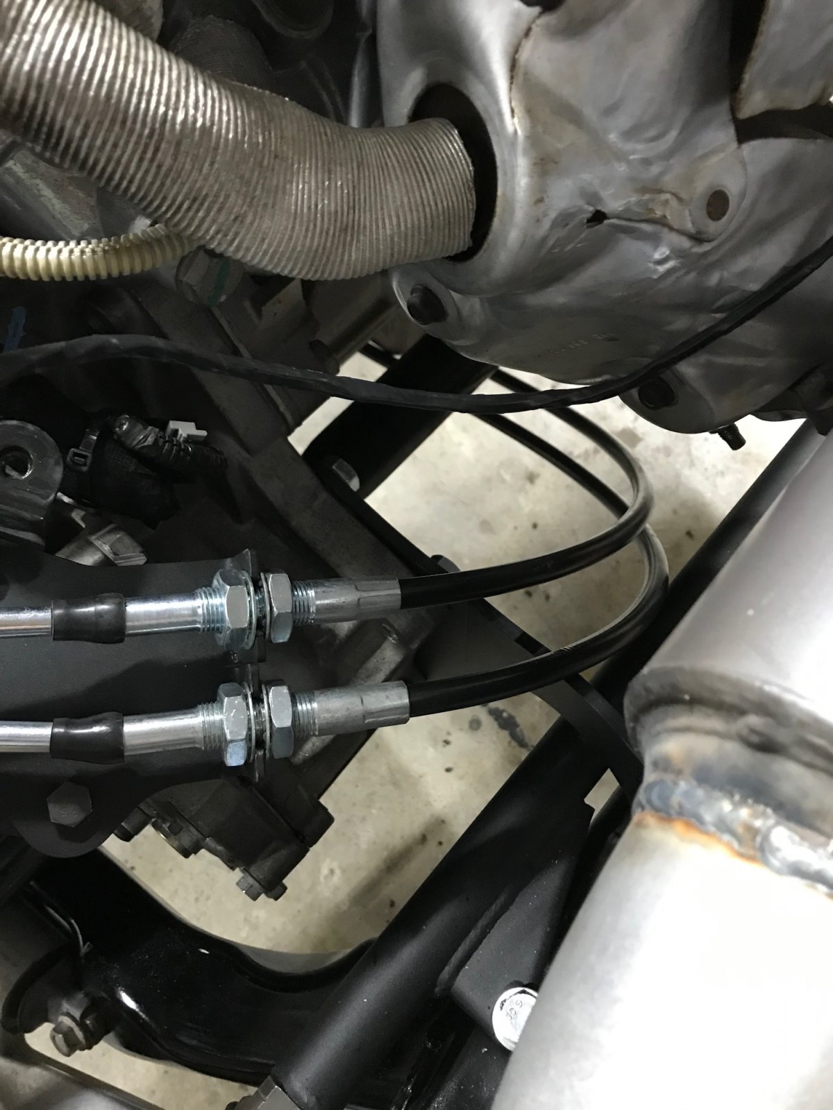

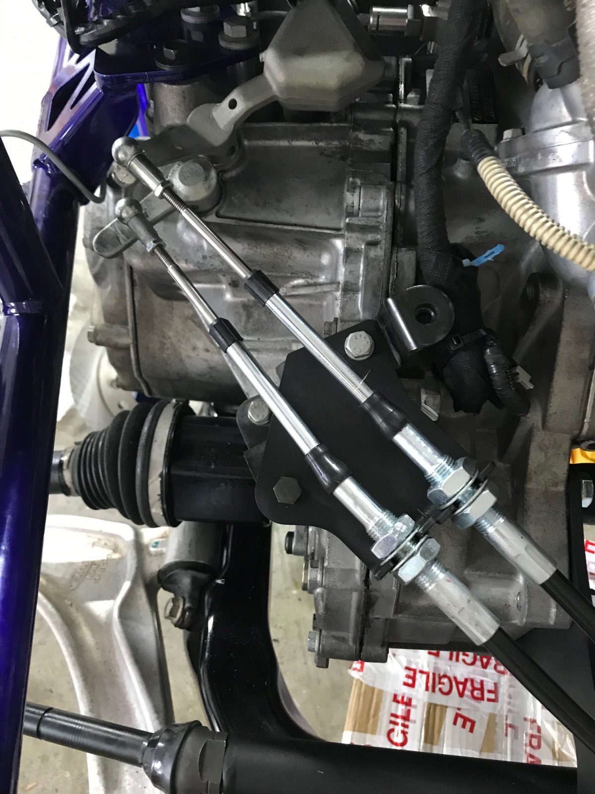

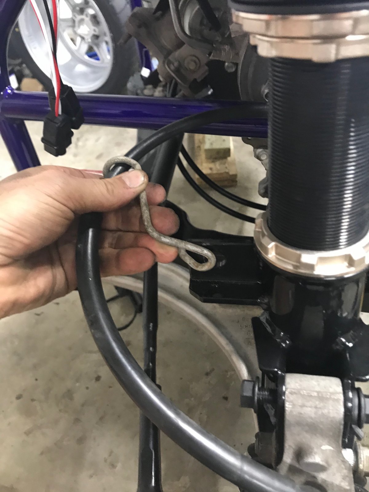

mounted the transmission end of the shifter cables. The heavy cables do not bend easily and the routing to the shifter does not leave a lot of options.

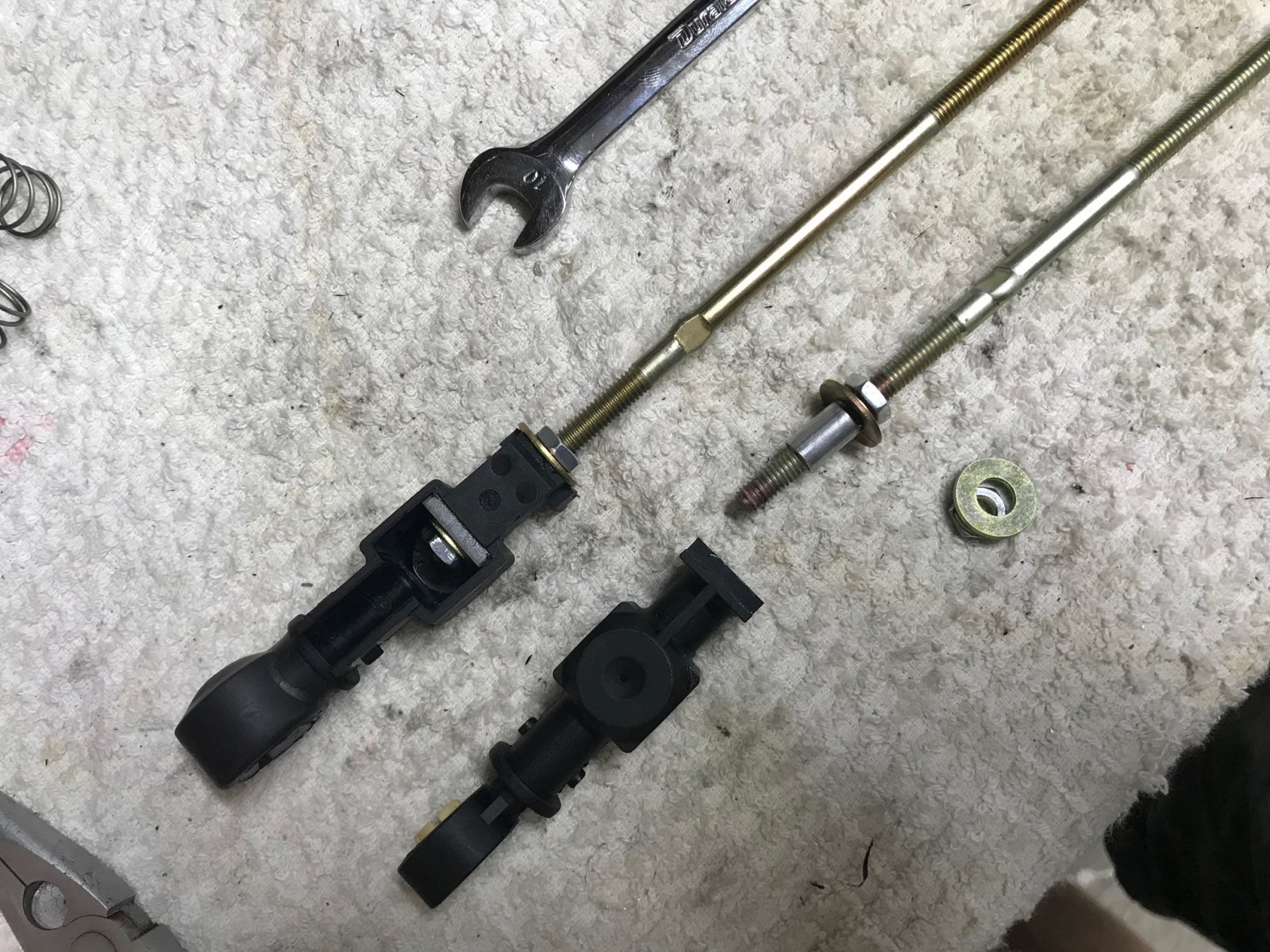

Started assembling the shift lever cable ends. Still waiting on a few missing parts there.

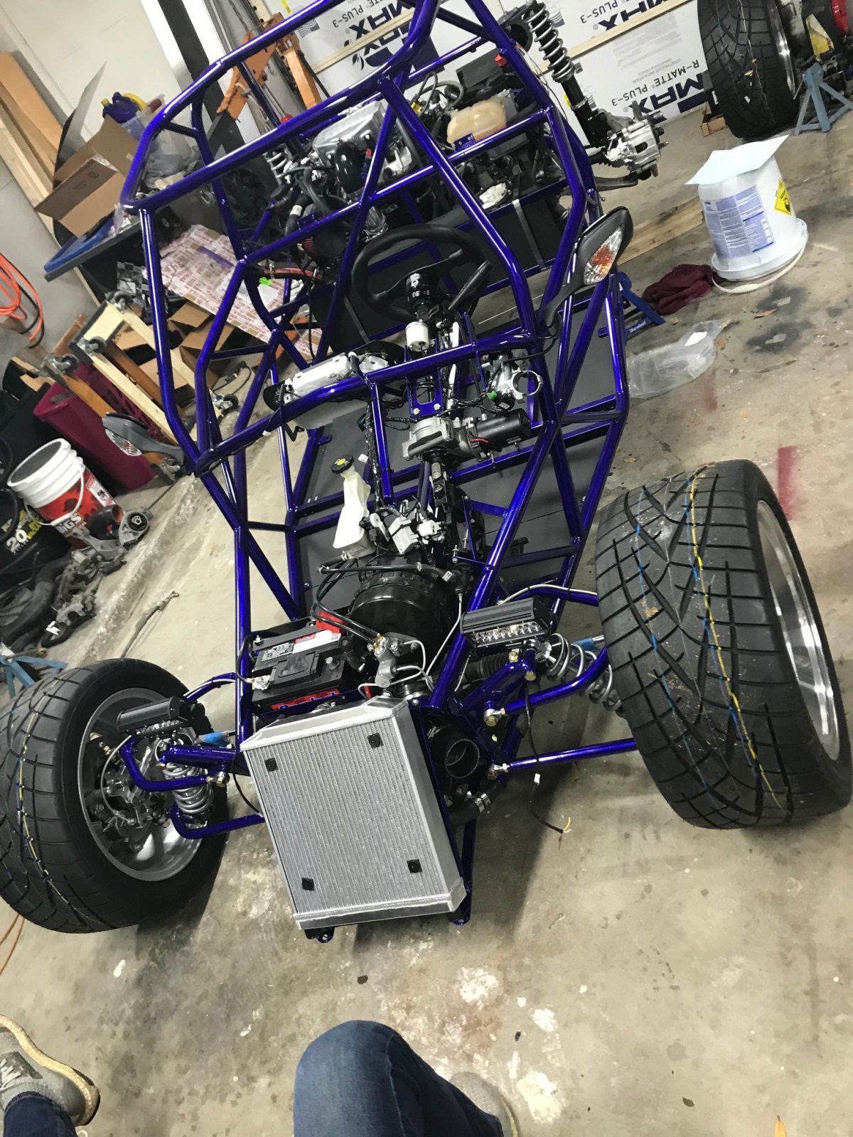

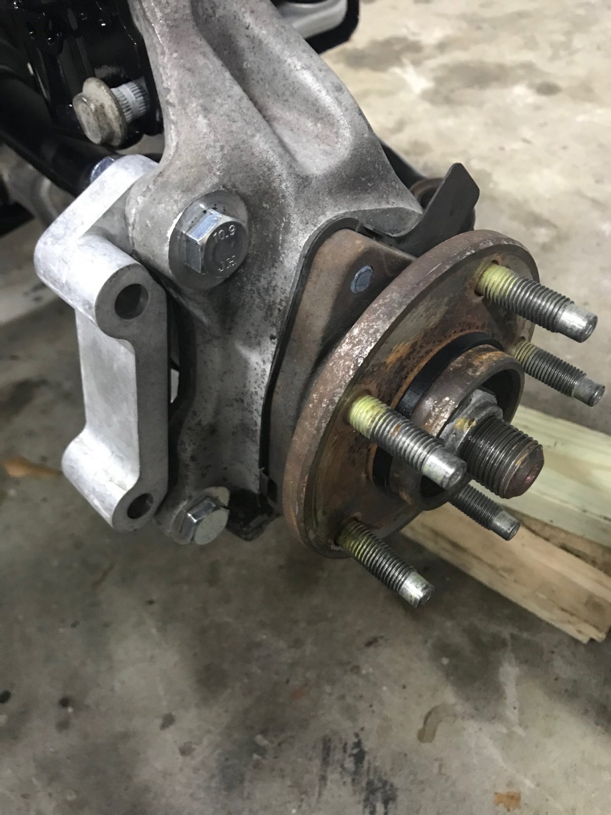

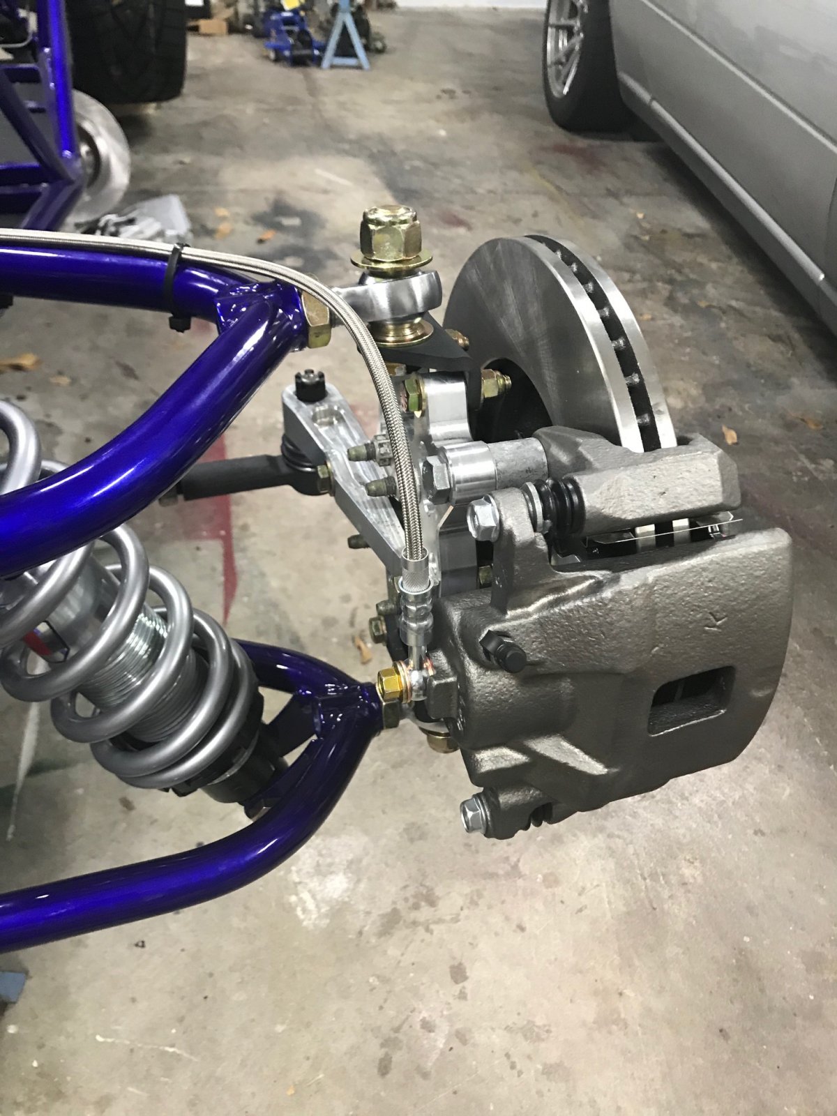

Brake kind of day today. Front hubs needed the ABS back plug cap removed and replaced with some from DF. Got those and installed the front hubs, and brakes.

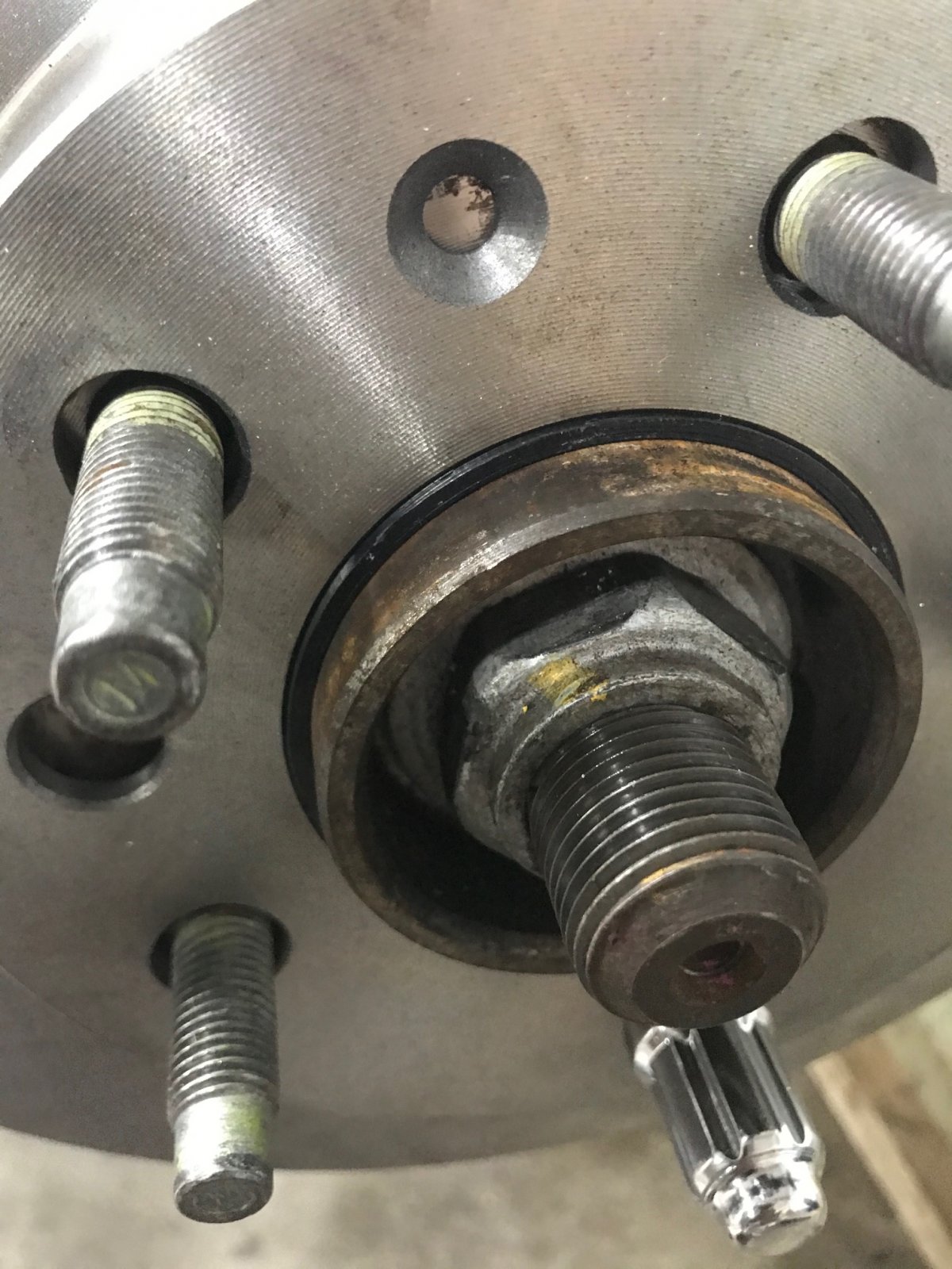

Rear rotor centering ring shown before and after rotor installed.

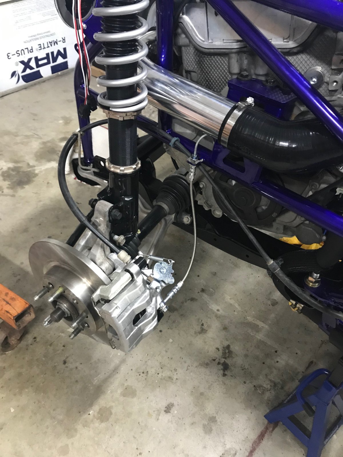

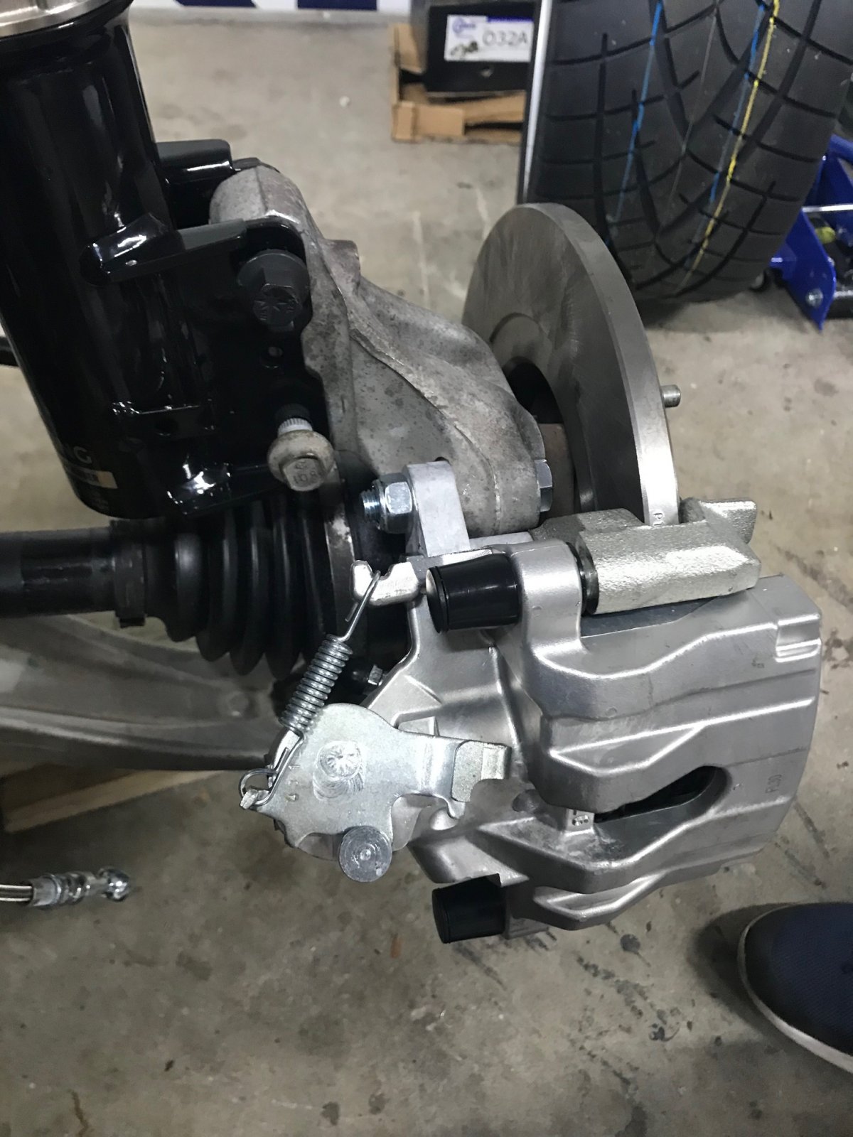

Rear brakes with parking brakes and special brackets installed.
Got the parking brake cable temporarily in place. Not a lot of options there.
Tightened up all the brake lines.

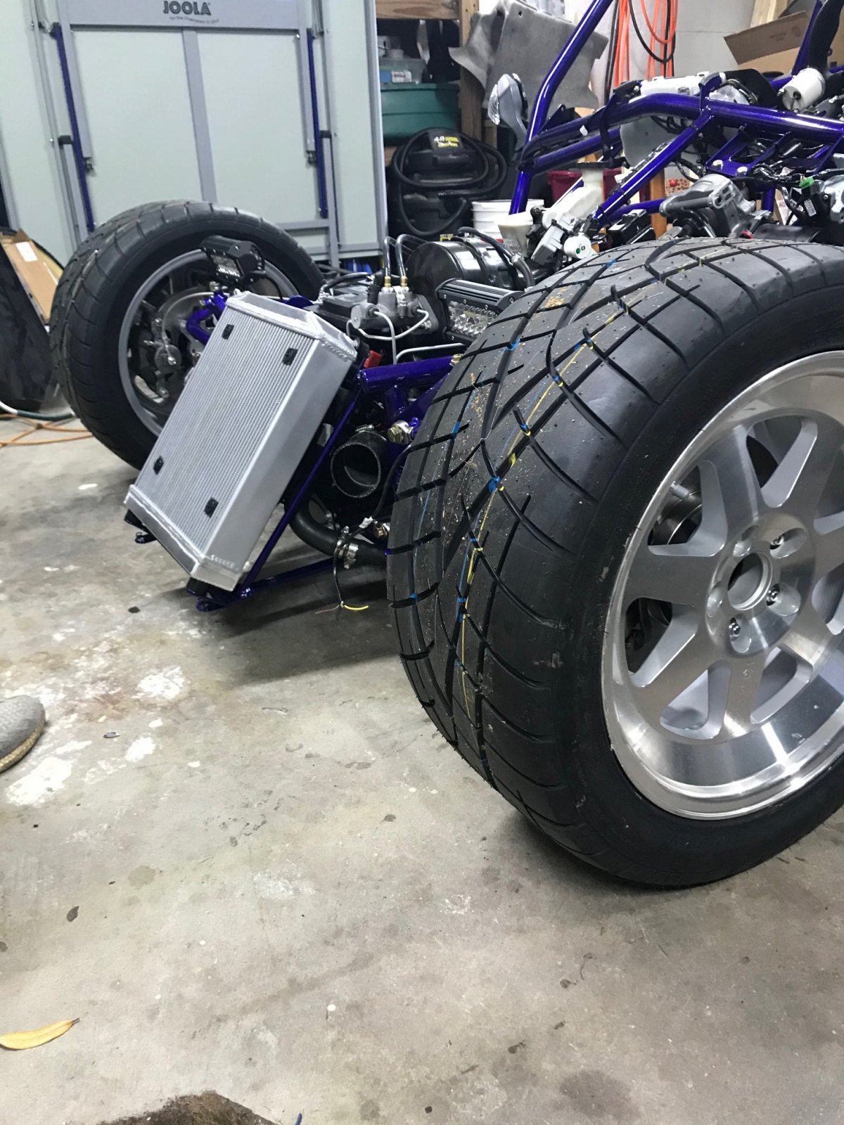

Finished the brakes earlier, so I figured why not get some shoes on the front. Low rider. As low as my son's Miata next to it. No. Lower......

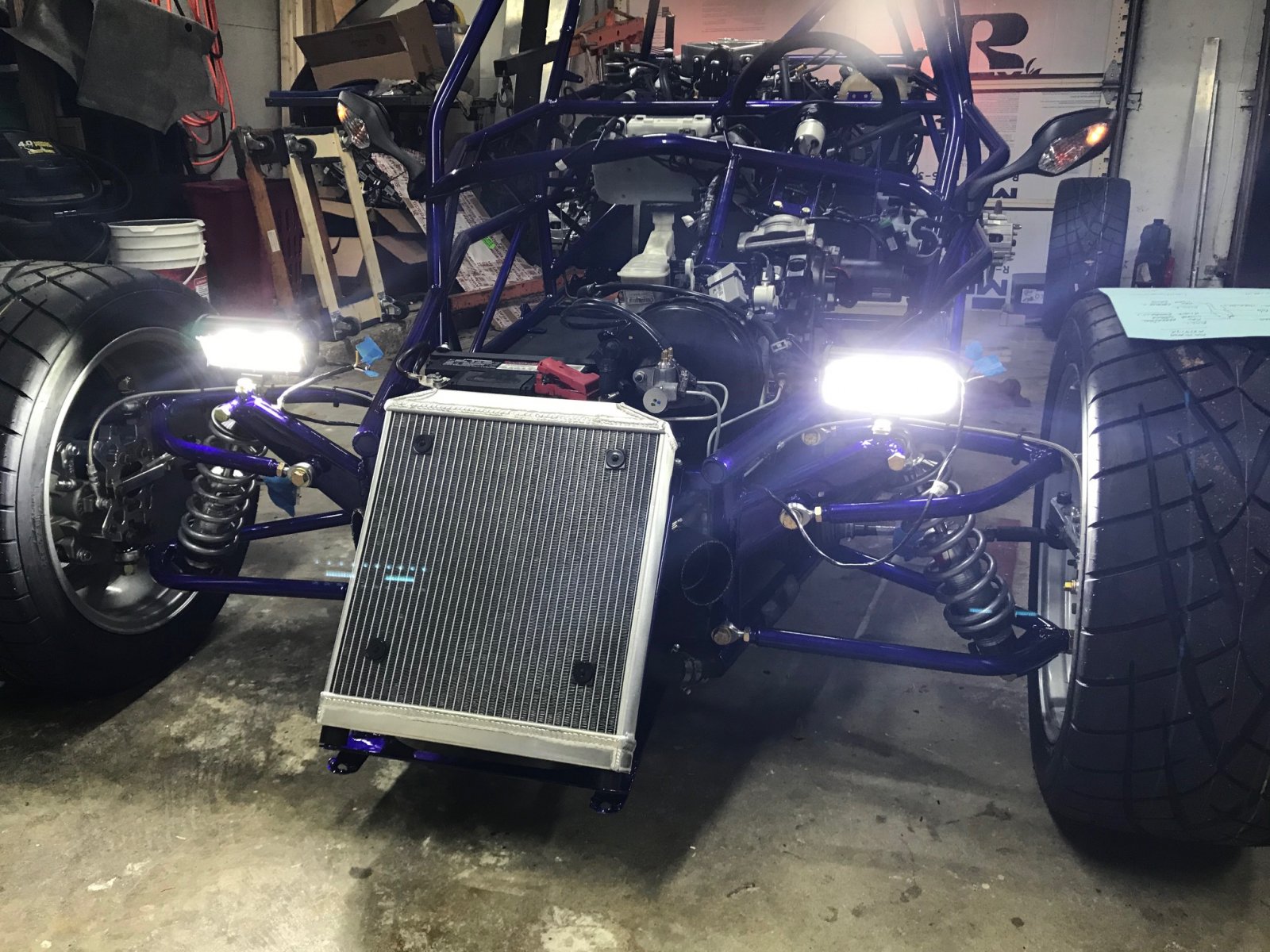

Temporarily hooked up the lights to see if I could make thinks blink a little. Success!!!!!

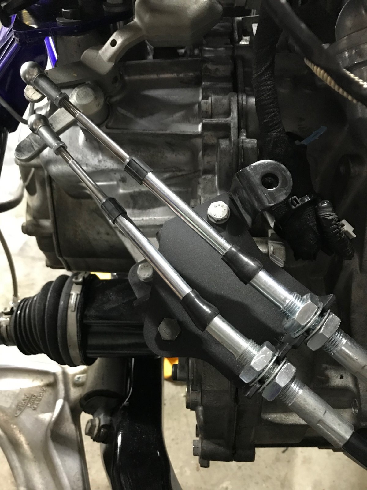

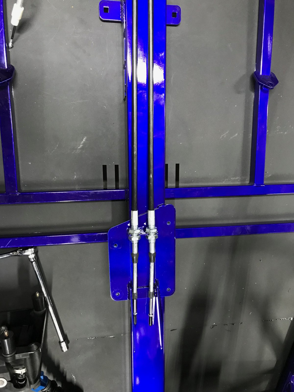

When talking to Lonny while picking up my kit, he spoke faster than I could absorb. He is a walking tool box of knowledge. :) But, one thing that did sink in was how easy it was to set up the shifter cables. Start at the transmission end, with the two levers in the middle position. Fix the cable ends in the middle of their thread length. Snake the cables under and over until they are on top of the tunnel cover. Left trans lever goes on the left side of the shifter. Install the bellcranks so they are about vertical. Then connect the hardware top and bottom to the bellcranks adjusting each rod. I will post the remaining pics when done.

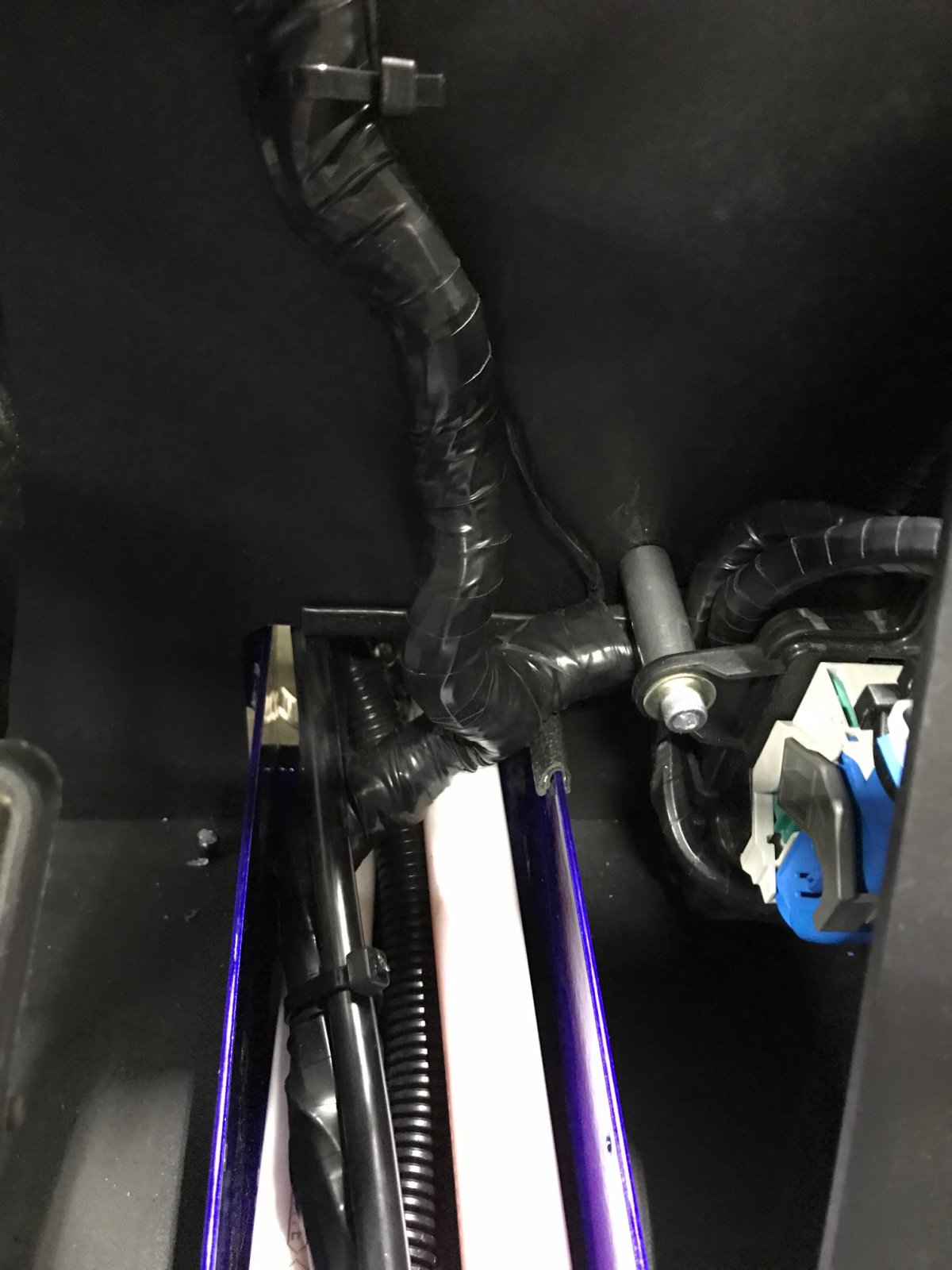

And one other small detail. The wire harness needs to go UNDER the BCM mounting bolt or the tunnel cap will not slide all the way forward to the front firewall.

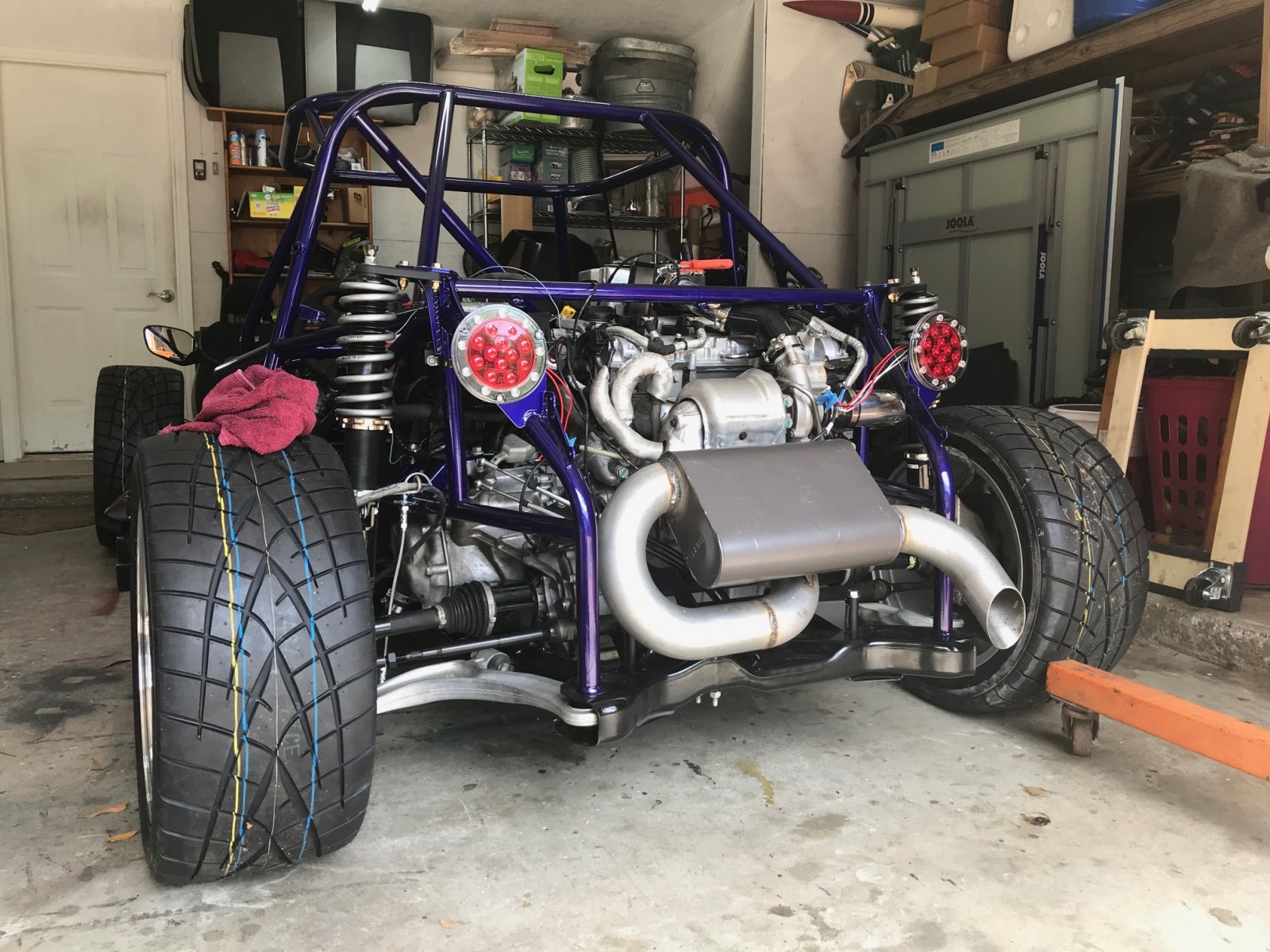

I have heard others talk about the first time the car is off the jack stands and fully on the ground - and how LOW it is. Well, even knowing that, I still was stunned at how low slung this baby is now!

Go to the transmission and check if it's out of gear, it's pretty straightforward once you look over it for a minute. Left/right control is spring loaded so you don't have to worry about it. That leaves 3 positions on the other lever.

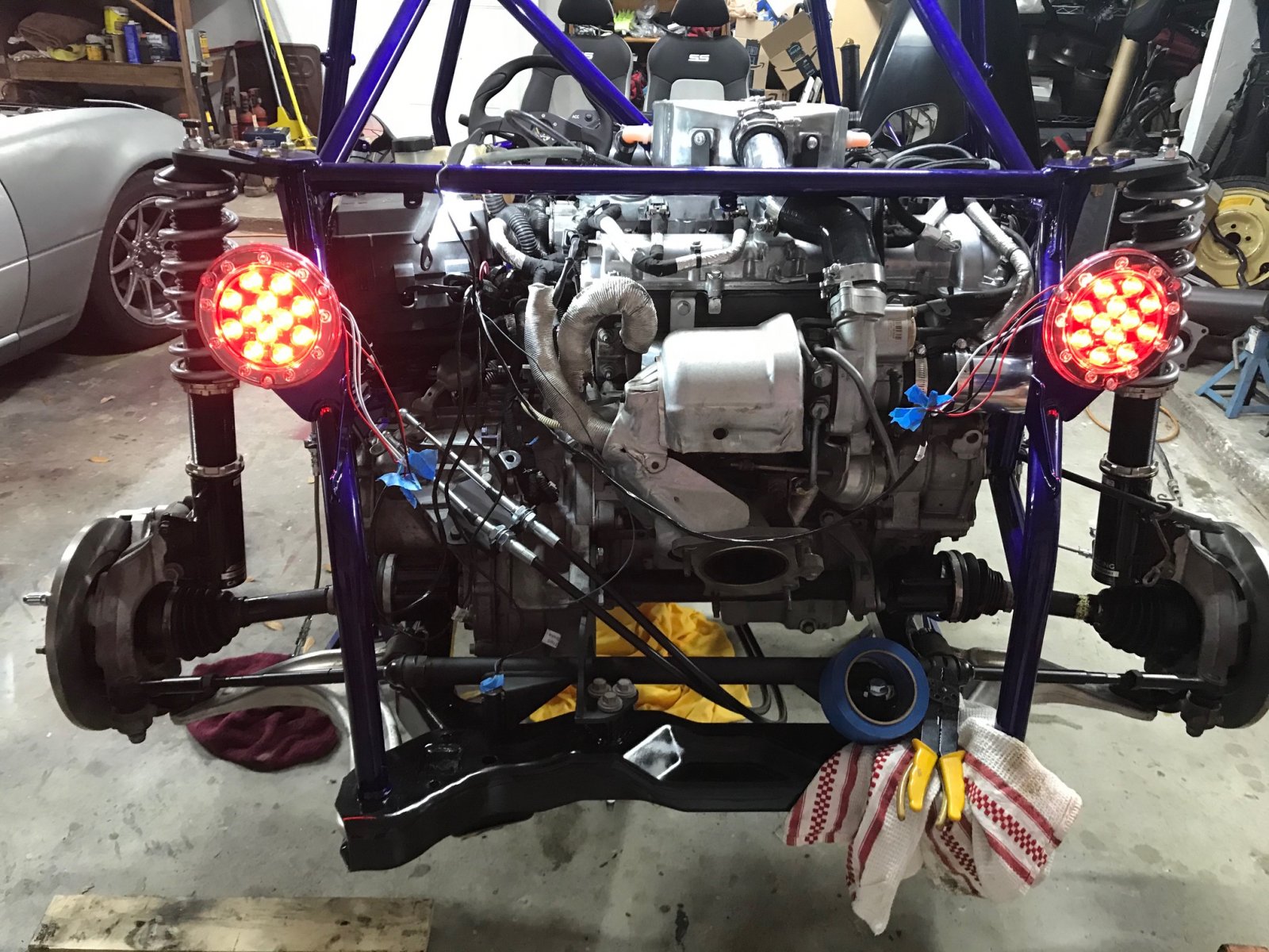

I temporarily hooked up my rear lights. I am getting 12v constant on the green / yellow wires. When I turn on the blinker, they go into the correct blink mode. When I reset the blinker, they go off for a moment, and then back full on. The side mirror signals seem to blink correctly with the blinker engaged. Brake signal issue -I assume? I do not have any brake fluid in the system yet. Is the brake fluid reservoir sensor maybe sending a signal here? There does not seem to be any adjustment on the brake signal sensor. I disconnected the green / yellow wires both sides and running lights are on properly then and blinkers work correctly.
I am using the DF rear lights. Here are my connections at rear:
Harness Maxxima light
black (grnd)---------------both white wires from plug 1 and plug 2 (plug 1 is stop, tail, turn - plug 2 is reverse)
brown (run lt.)-------------black wire plug 1
green/yellow (turn R/L)---red wire plug 1
lt. green (backup)---------red wire plug 2
Anyone see the issue here?
