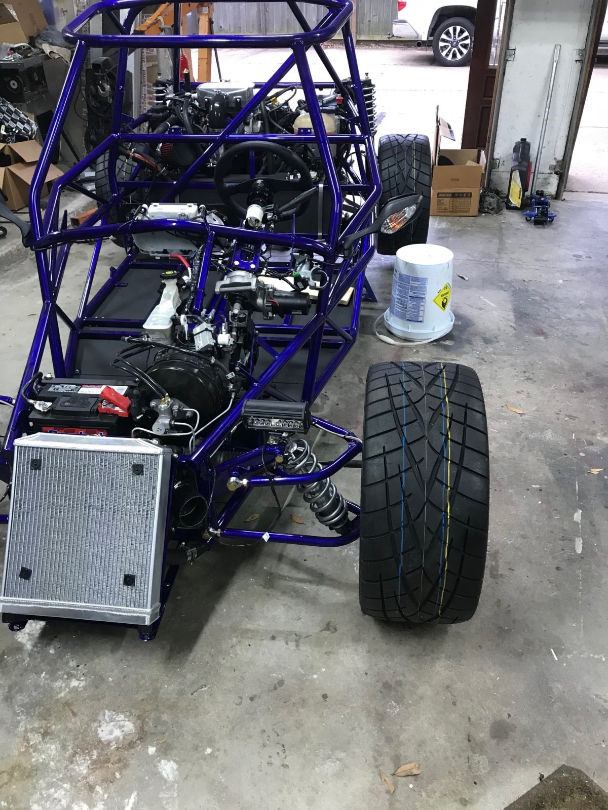

V1 Jason in Texas - ext. track - 09 SS/TC
I temporarily hooked up my rear lights. I am getting 12v constant on the green / yellow wires. When I turn on the blinker, they go into the correct blink mode. When I reset the blinker, they go off for a moment, and then back full on. The side mirror signals seem to blink correctly with the blinker engaged. Brake signal issue -I assume? I do not have any brake fluid in the system yet. Is the brake fluid reservoir sensor maybe sending a signal here? There does not seem to be any adjustment on the brake signal sensor. I disconnected the green / yellow wires both sides and running lights are on properly then and blinkers work correctly.

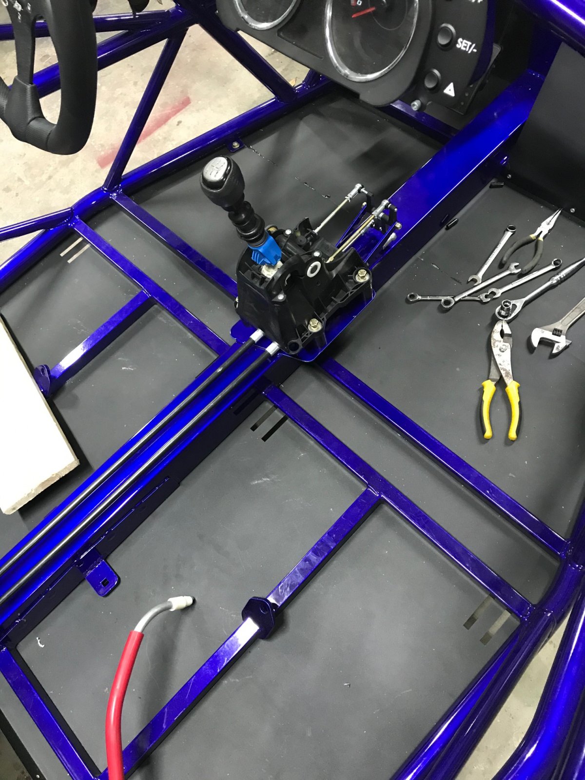

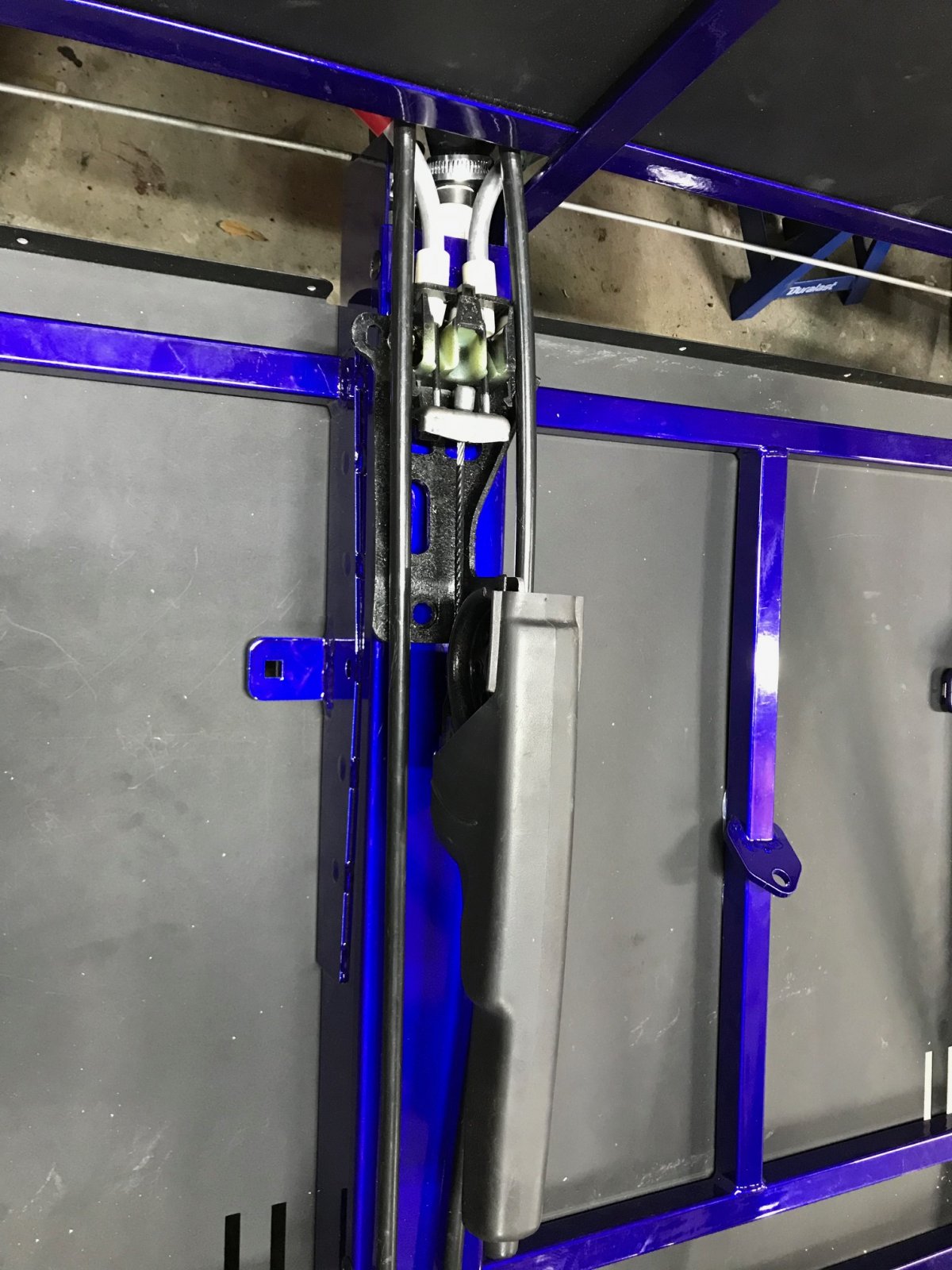

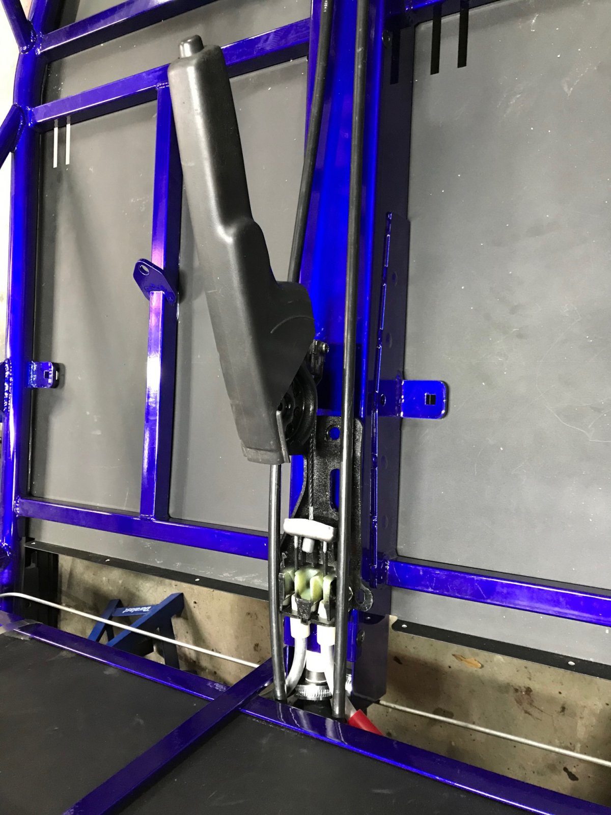

Finished the shifter linkage, parking brake, and sealed the tunnel cap.

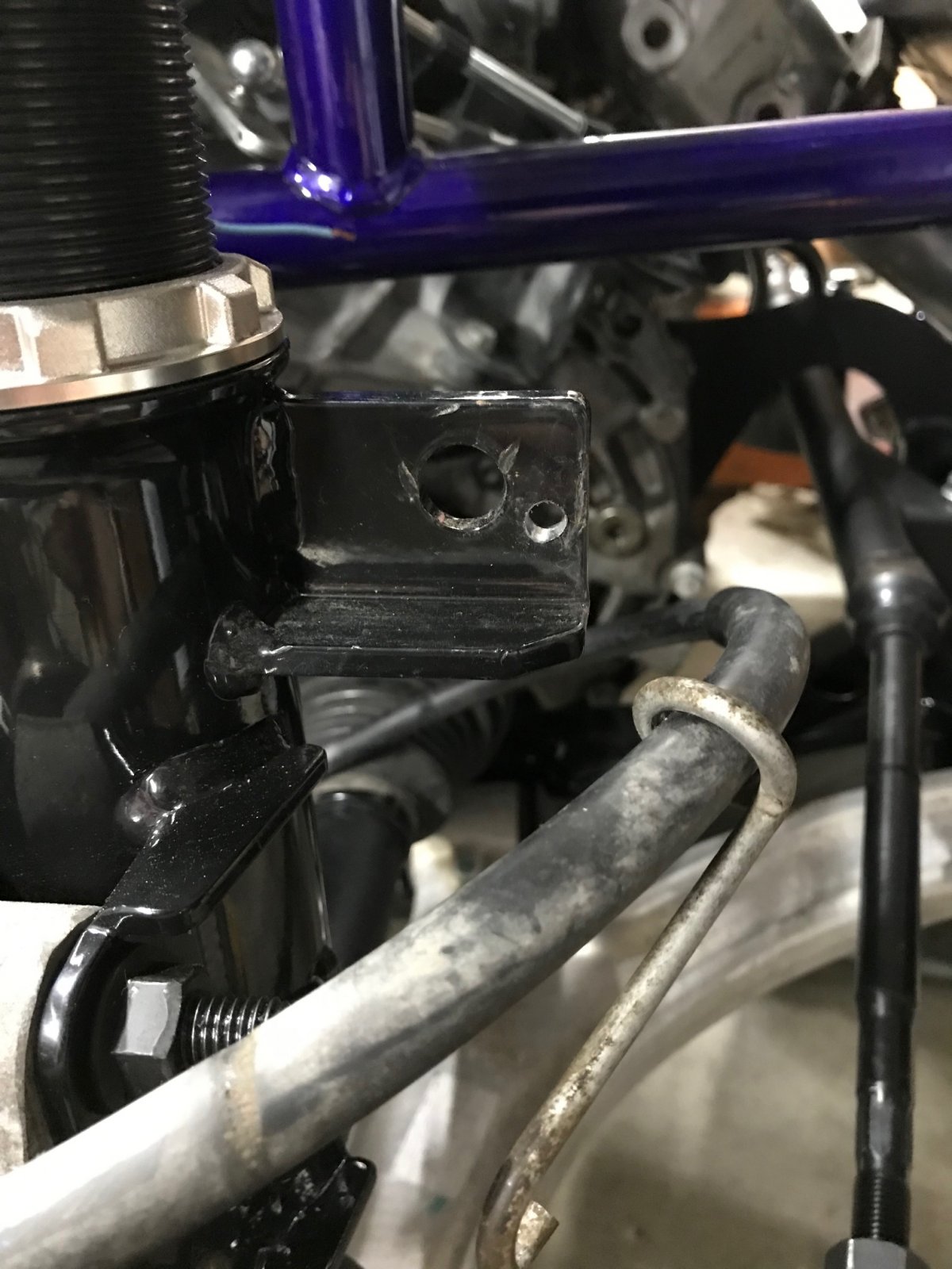

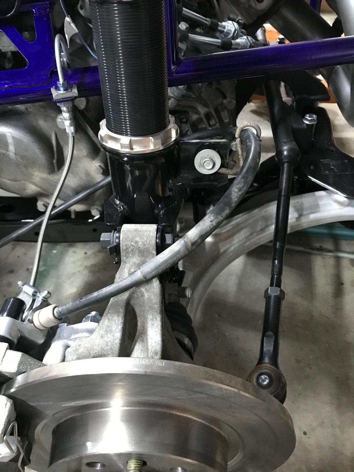

I reused the metal hanger at the shock tower. Drilled a new hole to orient the hose away from the inside of the wheel.

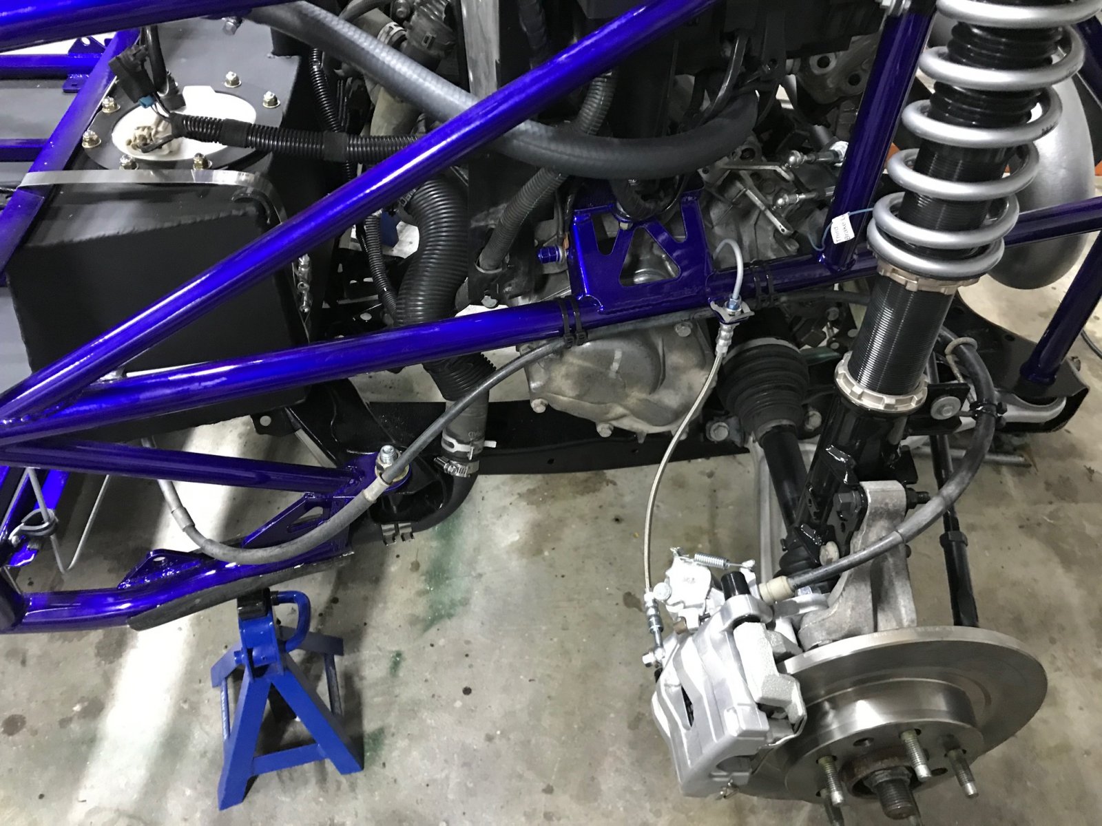

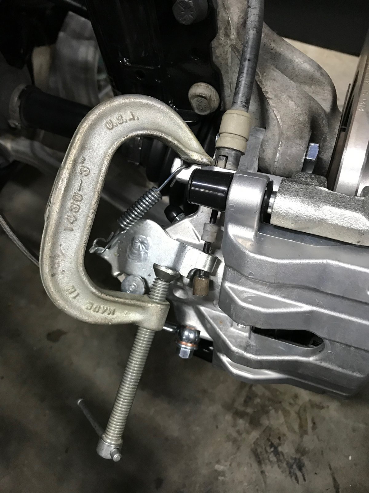

The back of the parking brake mount bracket is 3" from the front side of the angle that the fuel tank mounts to. Compressing the parking brake at the axle allows easy hook up of the cables at the hand brake. Not sure I am finished securing the parking brake cable. Not a lot of choices to route it.
And for those who are installing the parking brake, make sure you drill your holes and attach the brake handle BEFORE you rivet the tunnel cap. Or, you will find yourself drilling out rivets. Don't ask....... :( Sometimes, you get three or four things going in your head and if they get out of order..........

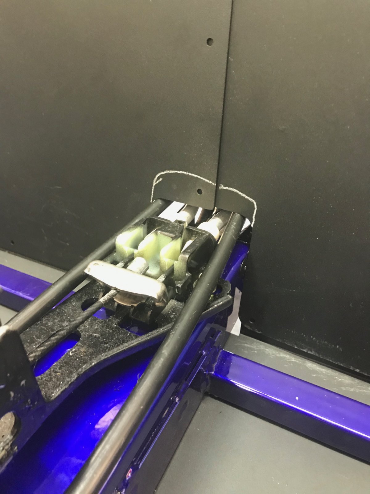

Installed the firewall today. Those rivets on the bottom corner where the panels meet are trying... Had to trim a little around the tunnel to clear the parking brake and shift cables. I went back and covered the sharp edge with a split piece of rubber hose so no possibility of chafing.

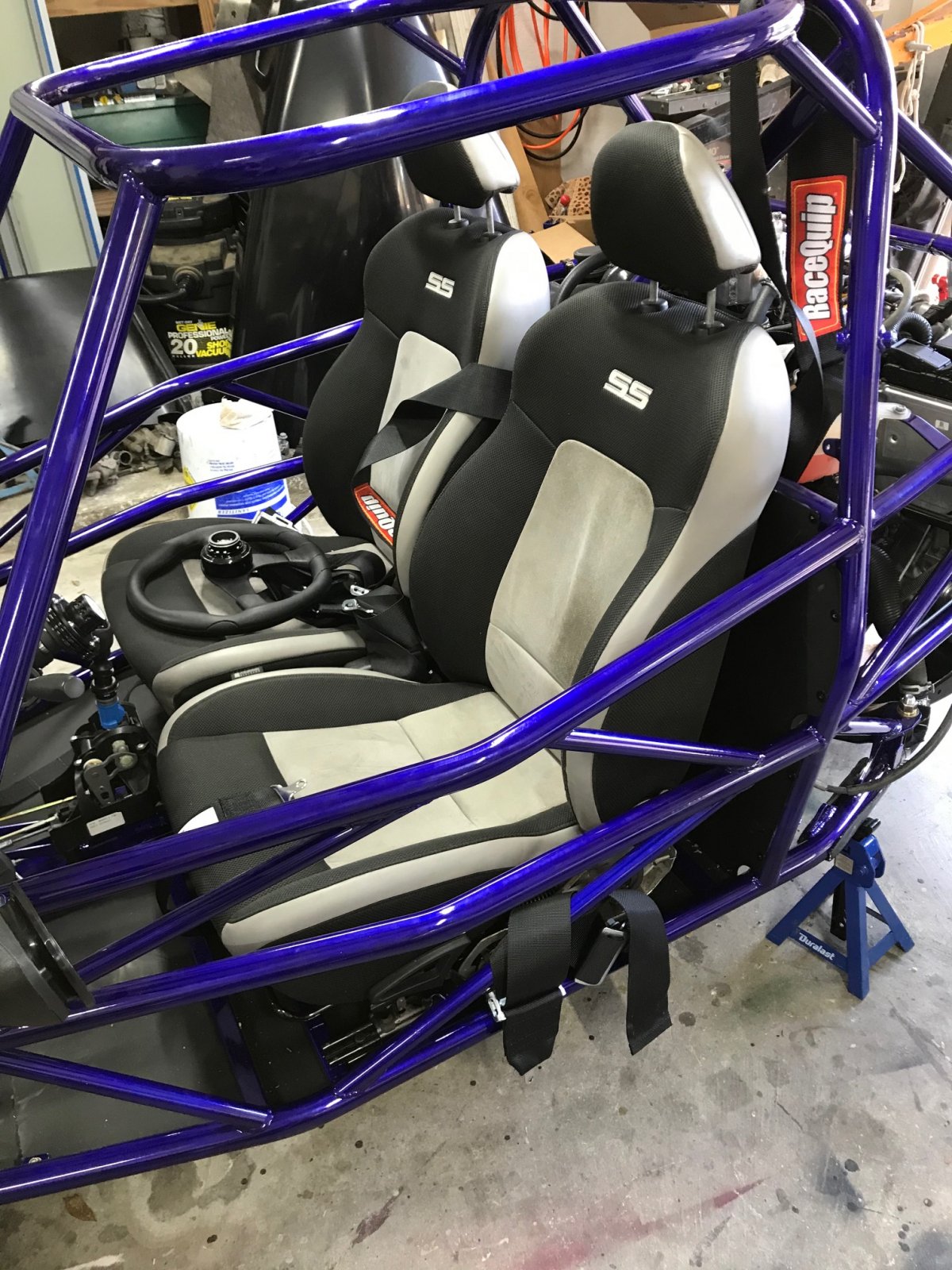

Had my older son help with the seats. I thought they would just drop right in. Nope. Took some work to wiggle them into place. I got the 4" extended chassis. I actually slid the seats up a notch or two. I am 6'-5".
NOTE: The welded nuts in the tunnel for the inside seat belt mounts are 7/16" - 20. This hardware is not included in the kit.
Need to do some adjusting on the harnesses.

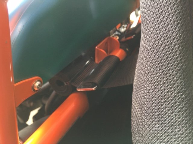

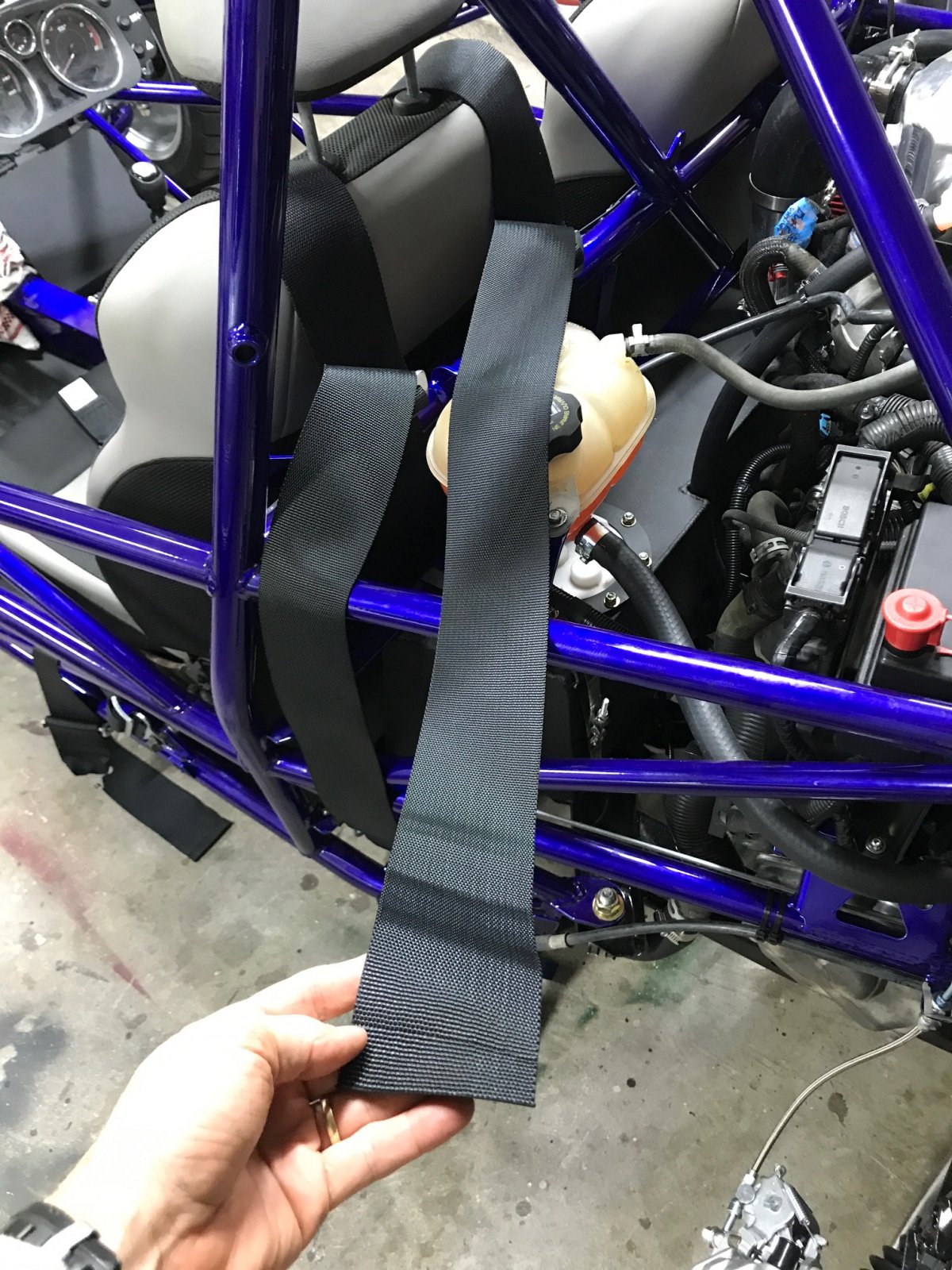

OK all you seat harness aficionados. The Goblin is my first set of harnesses. I mounted them correctly with the proper hardware. I understand how they are supposed to fit up to the body. I attached them properly to the bar behind the seats. Of course, the harnesses come with plenty strap for mounting in different vehicles. Once I get them adjusted, there is a whole bunch of extra strap. What are my options? Roll it up and zip tie it neatly out of the way? If I cut off the excess, will it fail any safety inspections at an event/sanctioning body?
Suggestions and ideas, please.
I think this is what you need:
OK. Those instructions matched the ones from RaceQuip. Thanks.

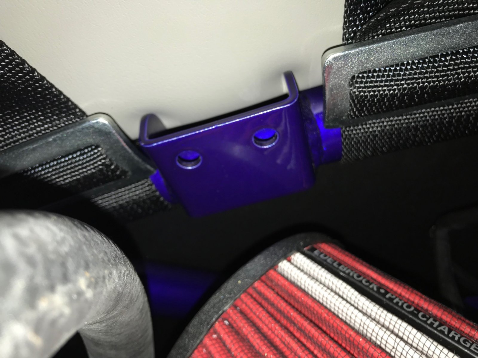

I wrapped them on the bar to begin with. However, I never really asked if these brackets were to bolt the shoulder harness mount - or are they for mounting the engine cover? The harnesses come with hardware to bolt as well. Bolting the harness to these mounts would keep them from sliding around on the bar if they were just wrapped.
So, are the brackets for the seat harnesses?
Indy Lonnie
I honestly do not know what those brackets are for... They are not for aftermarket seats and the engine cover does not mount there. I was going to make a brace to help sturdy up my Corbeau seats, but I haven't yet. I do not use them and I have been driving my Goblin for almost a year now.
Those brackets are for the engine cover. You don't want to bolt your harness to that because it will probably change the lateral angle of how it runs the through the seat holes. That could cause some weird forces and things to not work as designed if you're ever in an accident.
There is actually a lot of science behind the proper mounting of a harness. Most of it we don't really need to worry about to much, but it's really best to not deviate from anything when it comes to safety equipment.

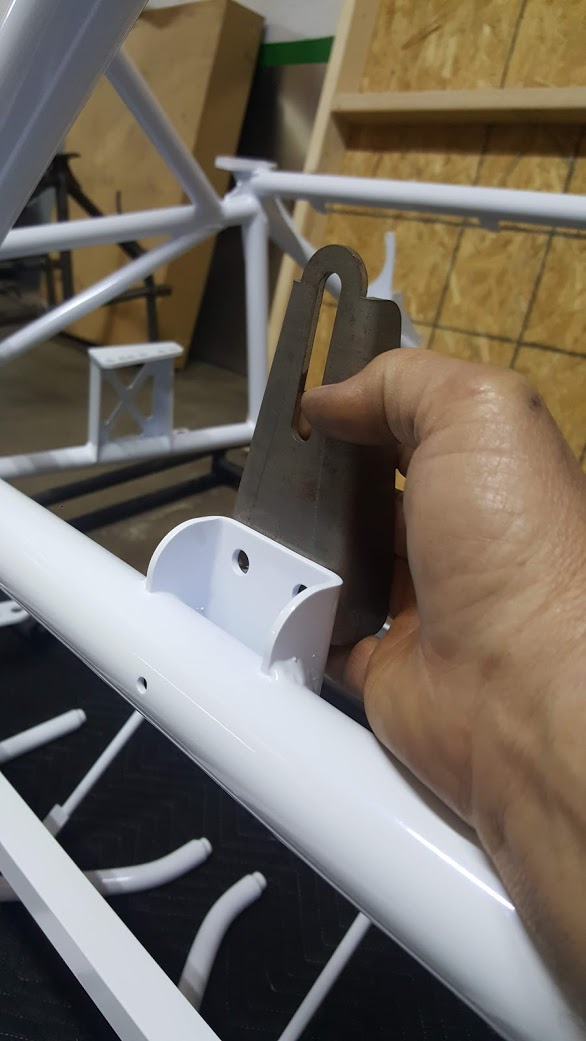

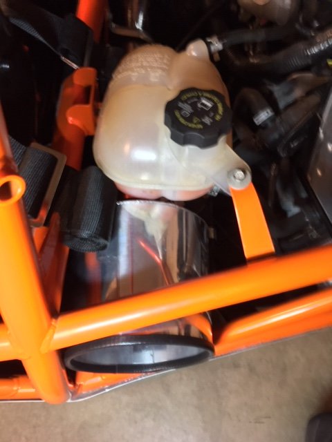

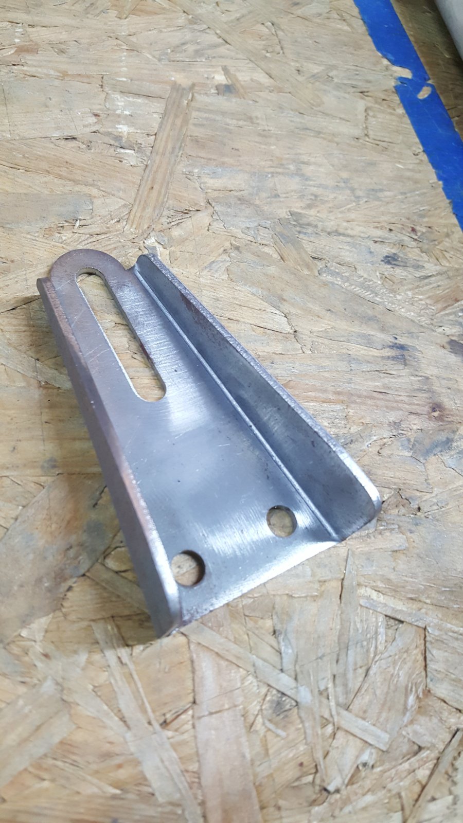

Upper seat mount.
We had made these early on but it doesn't seem like anybody needed them so we decided to hold onto them just in case they are required at certain race tracks. So far nobody has had a problem.
12658
The back of our seats have a threaded hole that aligns with this.
We haven't actually installed one. It was along time ago and it may need to be modified to clear the coolant tank.
Indy Lonnie
Does the bracket angle follow the hood or will the hood need cut? Can the bracket go inside the brace connected to the frame? My seats are sturdy, but do wiggle a bit. I may be interested to if the answer is correct...
