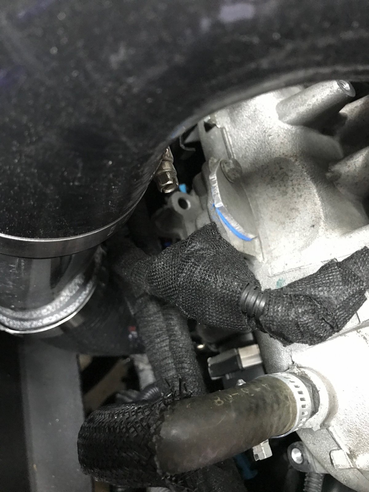

I’m a bone head also, This is what I did to mine, I don’t have a goblin yet to see if I need to squeeze metal together more
It adds character. Mine is intact but it doesn't look quite right. It looks like its off center and stretching to make into the bracket once bolted up. No one will notice but you. There is way too much to look at on the car than a silly "modified" bracket. Plus the hood will cover it if you are going to use it...
I've noticed the ones on the forum that might not like it or "tell you to buy a new reservoir" are the ones who haven't finished and driven (or even started) theirs yet...;) Get to building and once finished, you will be smiling so much you won't remember...

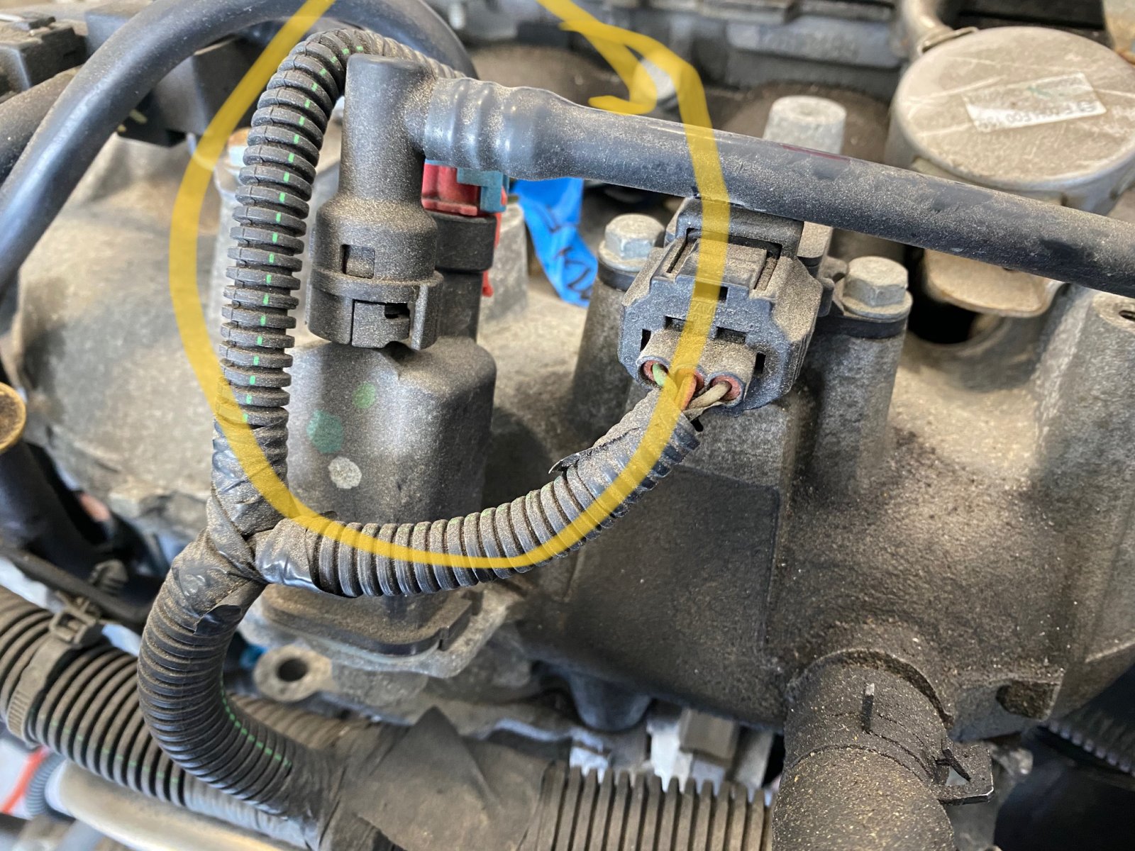

Hate to bother you again, But I think I seen on your site we can take the evac thing off. I guess the wires also. I’m trying to clean my engine up also. Besides the ac wires can we take anything else off to clean up. . If you get time maybe you can shoot me a few photos of how cleaned up you got the wiring . THANK YOU VERY MUCH

I left mine on and capped it with a vacuum cap and clamp. Under boost it will throw the cap off if not clamped. I read somewhere it would throw a code if not retained. You can hear it click with the key on...
Never a bother - at all.
With the evap valve removed, I just made an aluminum plate to cover over the port where it was mounted. As for the plug, I have not removed it from the harness, yet. It is just tucked away and taped over, for now. The harness parts that are no longer used (AC, Evap) can be removed if you are re-working the engine harness. I think Lonny said you could also just cut those specific pigtails from the harness and seal / tape up the ends (may have some powers in there to seal) if you did not want to unwrap the entire harness. That would be a little cleaner than what I have done so far. I kind of skipped through the harness part faster than most others by having DF rework the main part. :)
you left the Evap valve connected to the harness? Even though it was no longer connected to the engine?

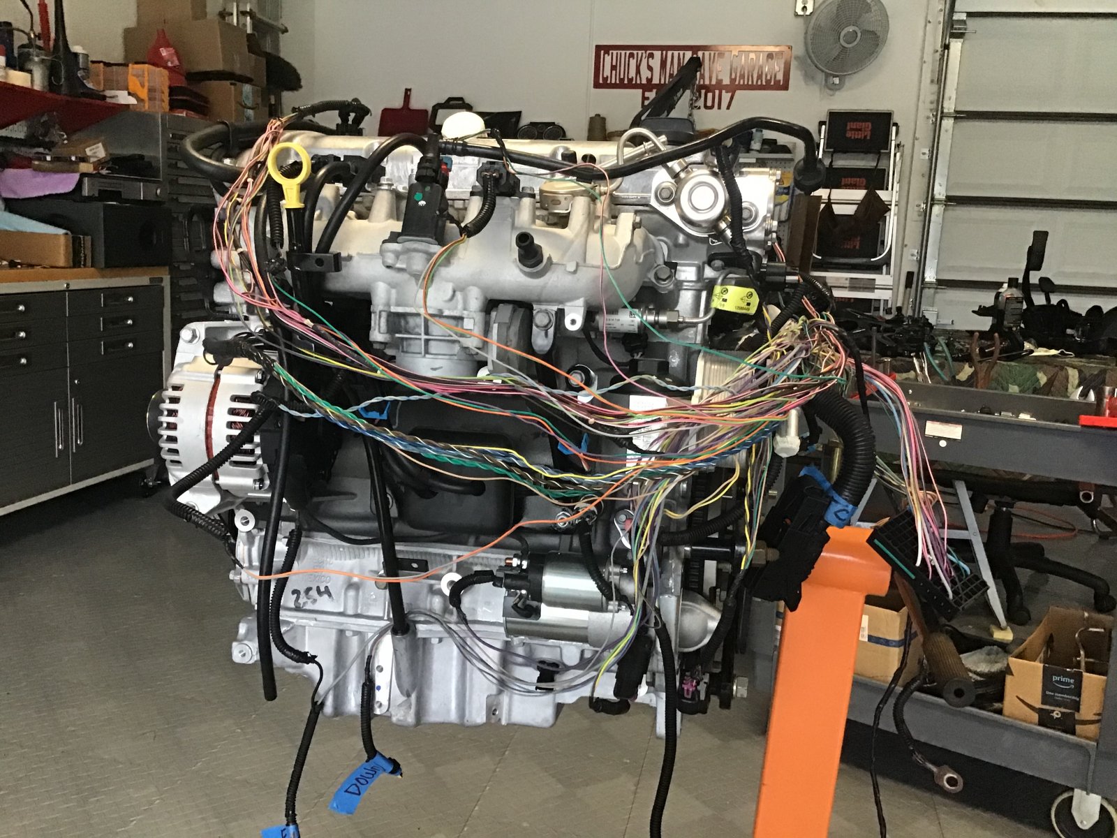

I took the AC wires out of the engine harness and figured I would take the evap wires out also sense I’m already into it. I don’t have anything left to do. I had DF do my harness also. Still waiting on 189 to be shipped. Clutch came today but I don’t want to take engine off of stand to just put that in will wait until I can put in GOBLIN AND DO IT ALL AT ONCE.
I had labeled 2 wires AC but I only cut out the one that matched up to AC, Don’t know why I would label 2 AC wires I’m nervous about cutting other wire labeled AC
I also hit a time where I was done prepping and still did not have the kit. Kind of stinks once you get rolling along. ;) That was when I started cleaning my intake valves. Excess time allows one to do some things that really weren't planned....
You better remove the wires from the harness "properly" to go with that beautiful spotless engine!!!!!!!
The clutch only takes an hour or so. No biggie there. I hope you can get your frame shipped soon!
Yes, I read somewhere on the forum that it should be left. When you turn the key, the engine will go through a start cycle. During that time the Evap solenoid will cycle, you can hear it. It was my understanding it will throw codes if not plugged in and allowed to cycle during startup. I could be wrong, but my Goblin is running great without any engine codes.
Yes, I read somewhere on the forum that it should be left. When you turn the key, the engine will go through a start cycle. During that time the Evap solenoid will cycle, you can hear it. It was my understanding it will throw codes if not plugged again and allowed to cycle during startup. I could be wrong, but my Goblin is running great without any engine codes.
interesting..... I do have the code - no biggie with all the other codes from the deleted systems as well. But, the engine appears to be running fine as well...... I recall Lonny saying just leave it off.
Anyone know what the possible implications are with the valve missing? And how the engine should/would/could be affected? Maybe there are some implications I missed.
