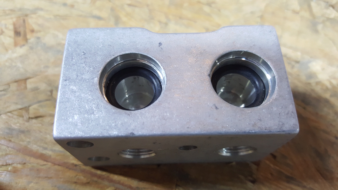

OK. I had a frustratingly slight seep under my brake reservoir. I wrestled with the brass fittings and getting them tight AND pointed in the right direction. Even went back and used sealant there. Unfortunately, it was not those causing the leak. Lonny sent me some new o-rings thinking maybe they were the issue. After changing them out and bleeding the system (again!), Lonny sent me a pic with one of those "dumb" questions. Well the pic showed me my error. DOH!.......... Unfortunately this is one of those details not yet covered in the present video series.
The pic below shows the PROPER placement of the o-rings prior to inserting the reservoir nipples. Deep down inside. NOT on the shoulder just below the surface.......
Learn well grasshopper....

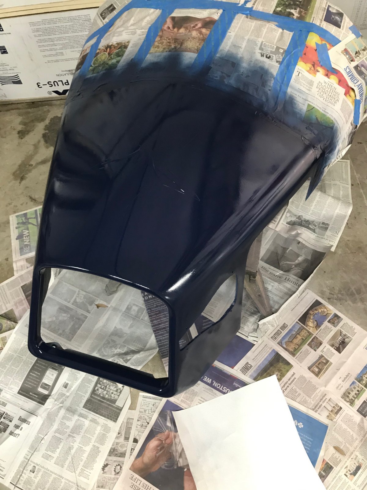

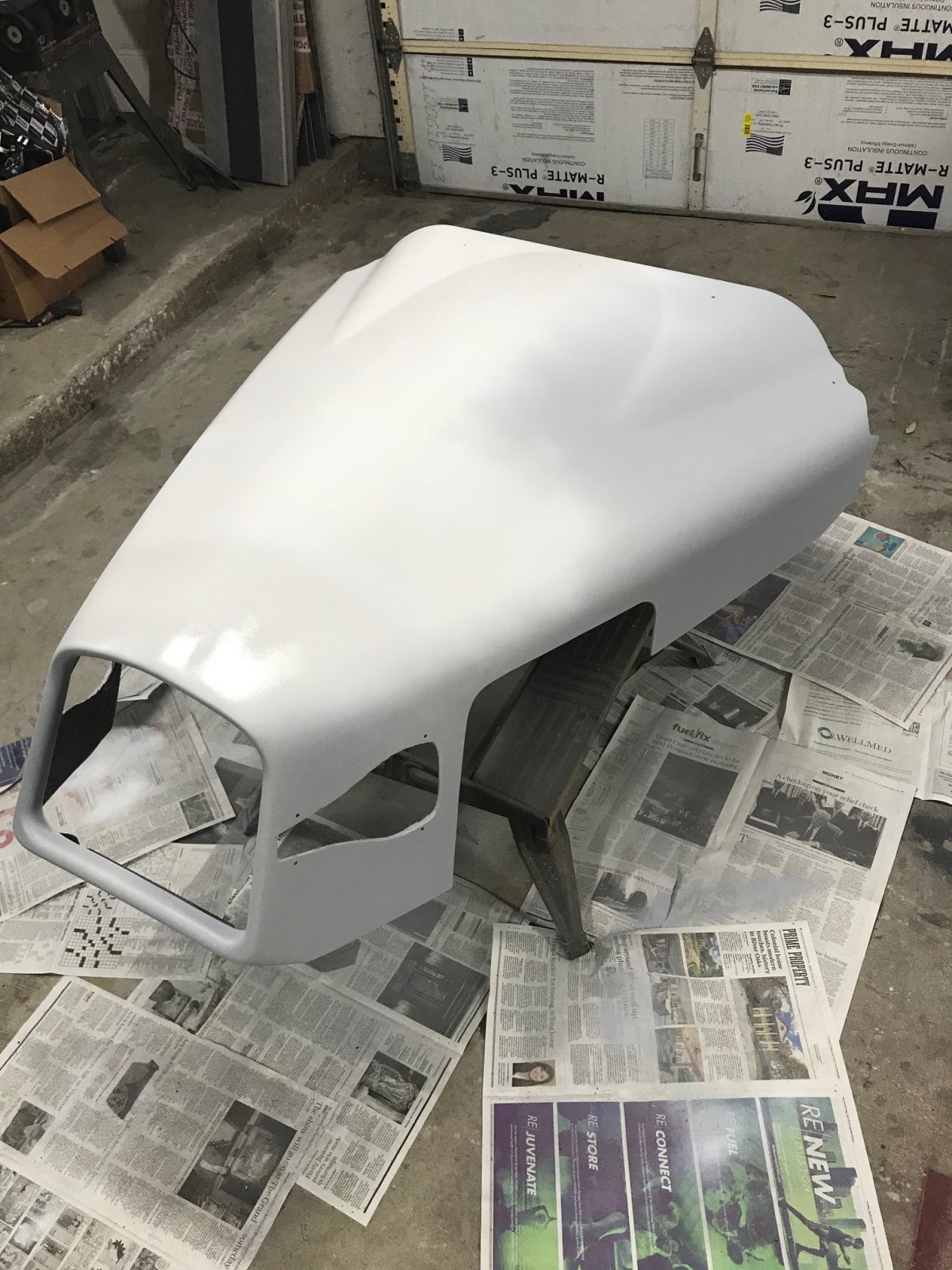

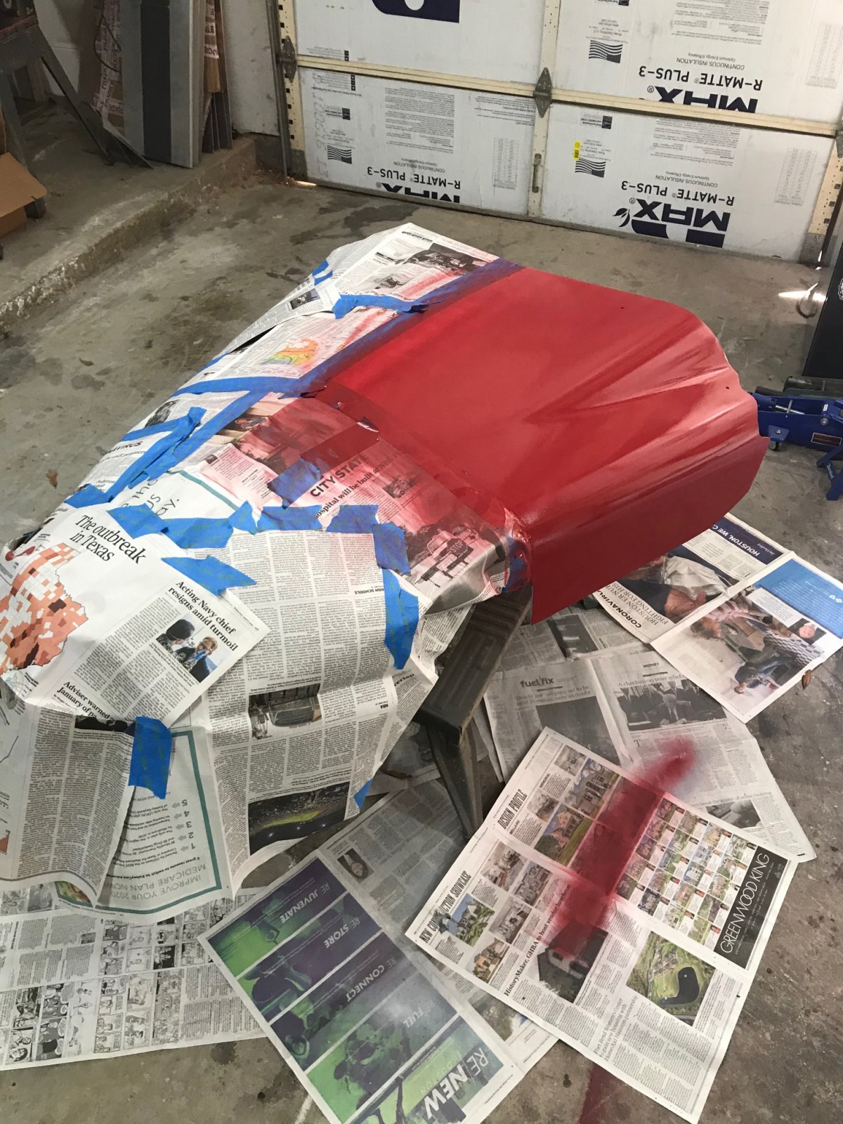

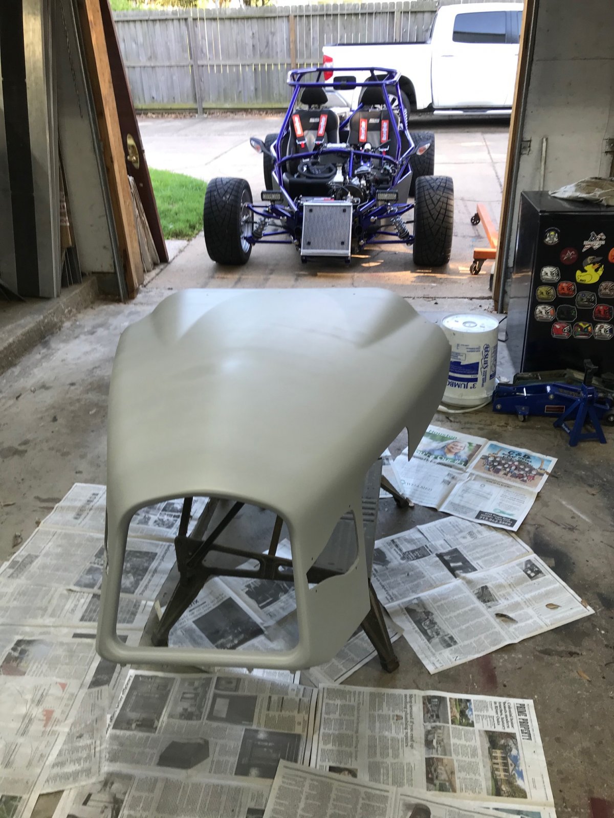

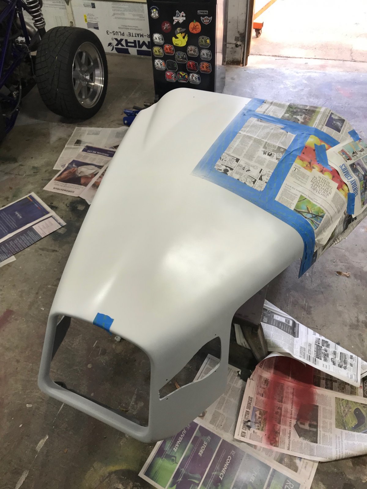

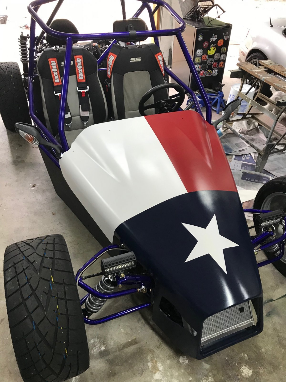

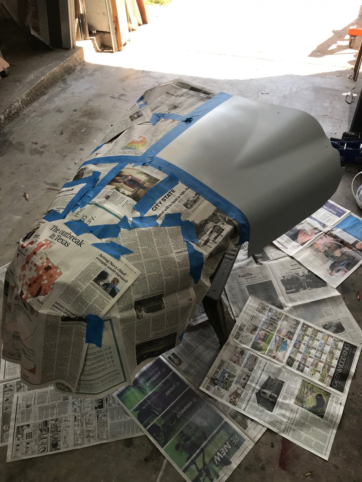

So, the Bentley Blue painted frame needed a finished hood. Kind of the last big part of the project. Painting is not really an exciting part for me. I am too impatient waiting for things to dry. Sanding and taping things also are not really that fun. But, I thought I would at least give it a try myself. I knew if I really screwed it up, I could pay a true expert to wrap it and cover up my mess. I think it turned out pretty well.
Footwell cover info here:
On to the windshield - and a test drive to make sure the hood works..... ;)

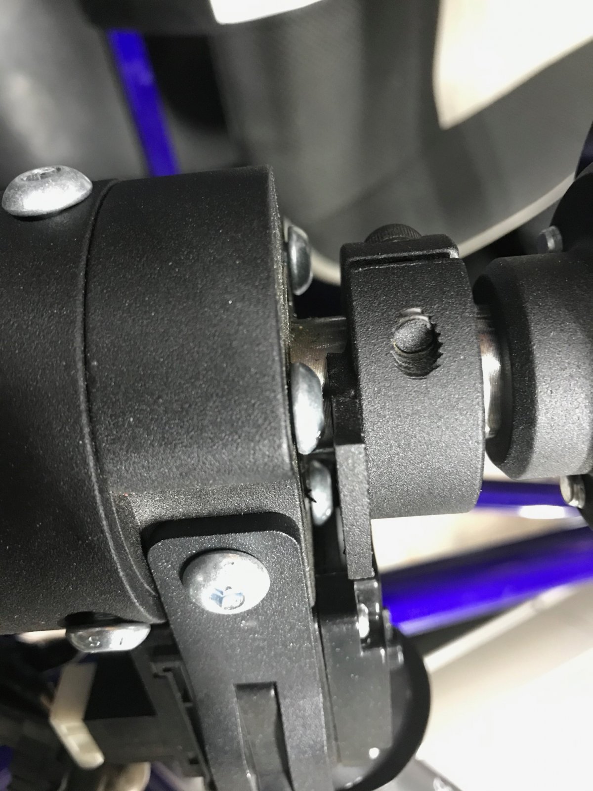

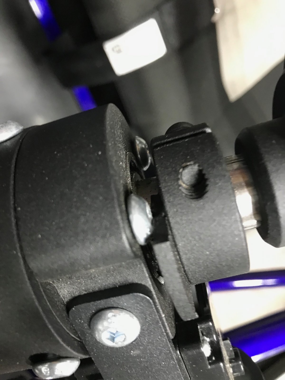

OK. Steering "catch" solved!!!!
The blinker reset ring gets clamped onto the steering column. This is another one of those items that might have shown up in video 25 or 26 (that never quite got posted). The tab gets aligned after you know your steering wheel is centered so the blinker gets reset properly after the turn. However, I failed to notice that the tab did NOT completely clear the round head hex bolts completely as it turned. It would catch ever so slightly and then ride up and over the bolt head. Doh!$@&*!! Face slap. The second pic shows the position after adjustment where there is a 1/16" clearance now.
Check that minor issue off the list......... :)

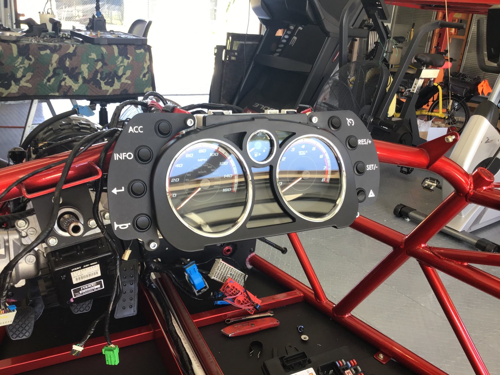

Is there a video on how to install accessories buttons that go around speedometer for install that you know of.

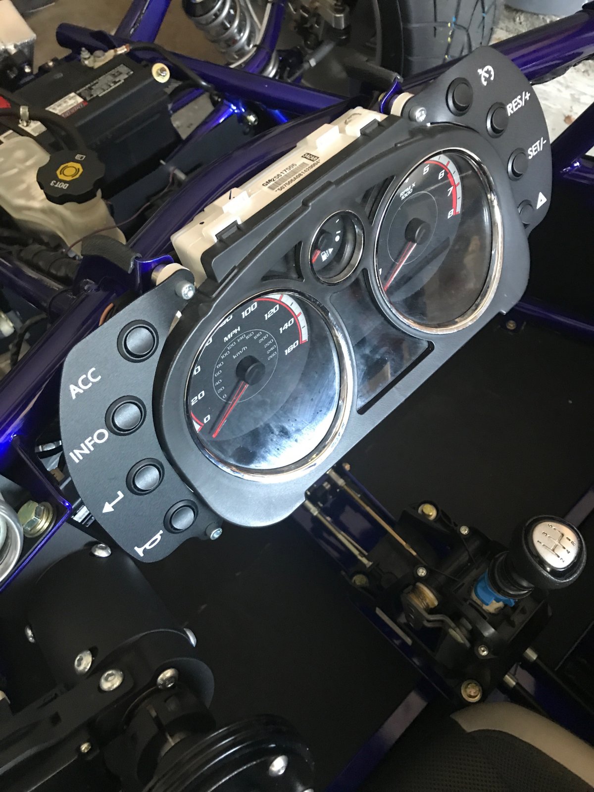

This is what I posted in another thread
Top shorter bolts:
panel, short spacer, cluster, short spacer, frame, nut
bottom long bolts:
panel, long spacer, cluster, short spacer, frame, nut
and attaching one of Jason’s pictures

If I could add one or two thing is drill bottom hole out to 9/32 or the long bolt want go the threads will but the shank is wider so you need to drill out before you install in goblin. I installed top bolts and found out the bottom want fit so drilled out in goblin, It would be easier to do before and if you get these buttons soldier the wires together before you install speedo a lot easier.
