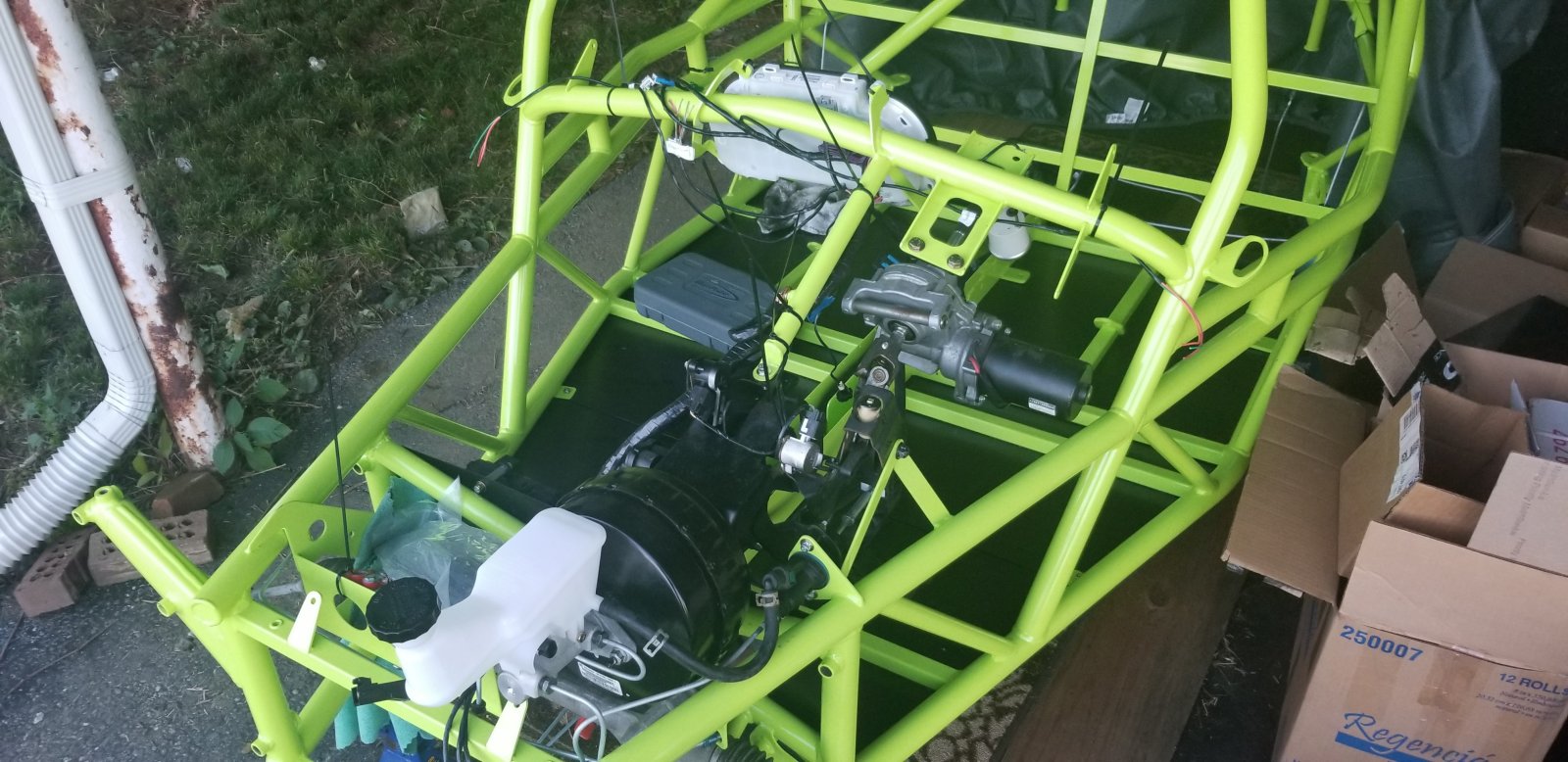

No instructions that I could find. I just went by the pics.Where does one find instructions for relocating the brake resevior? I see a photo album in a thread where there is a machined block with brass fittings/nipples and extra hardware, but this is not in the stage1 hardware box. Is this because its not part of stage1?

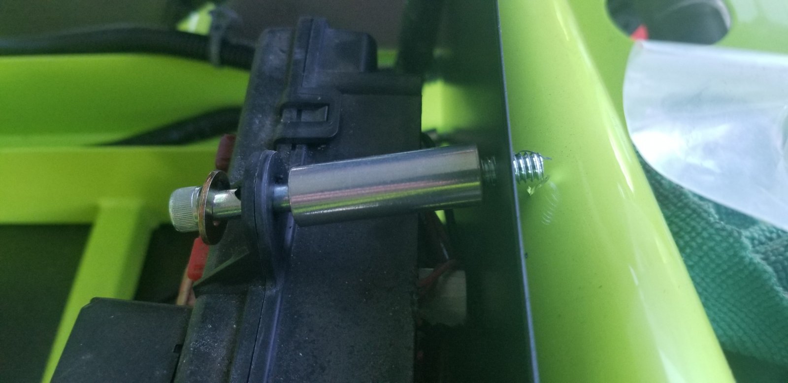

A large and small spacer? Well now I dont have enough bolt for that to happen. Guess I shouldve thought about the kick plate too before cutting the bolt down.You're missing a small spacer there.

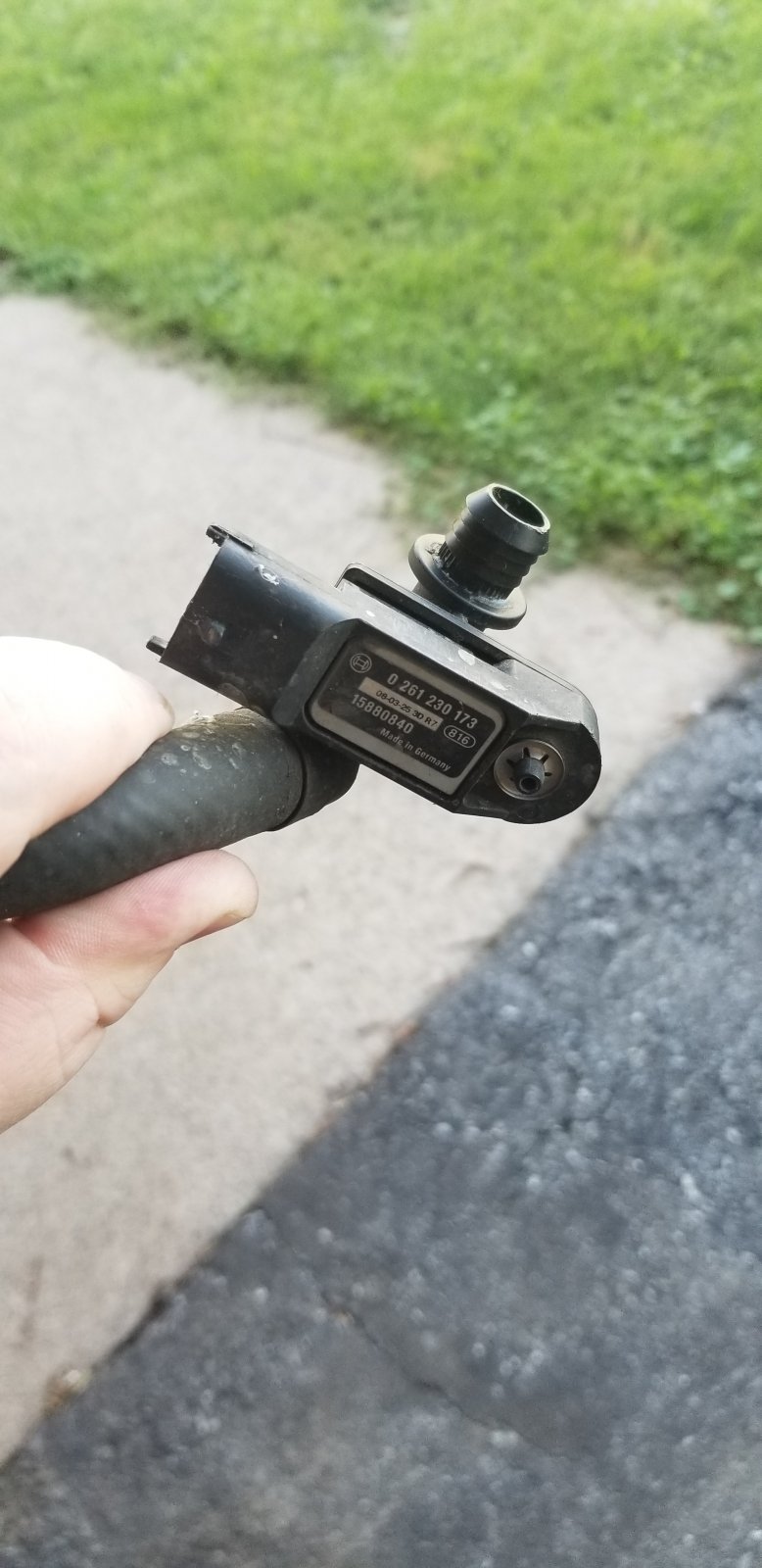

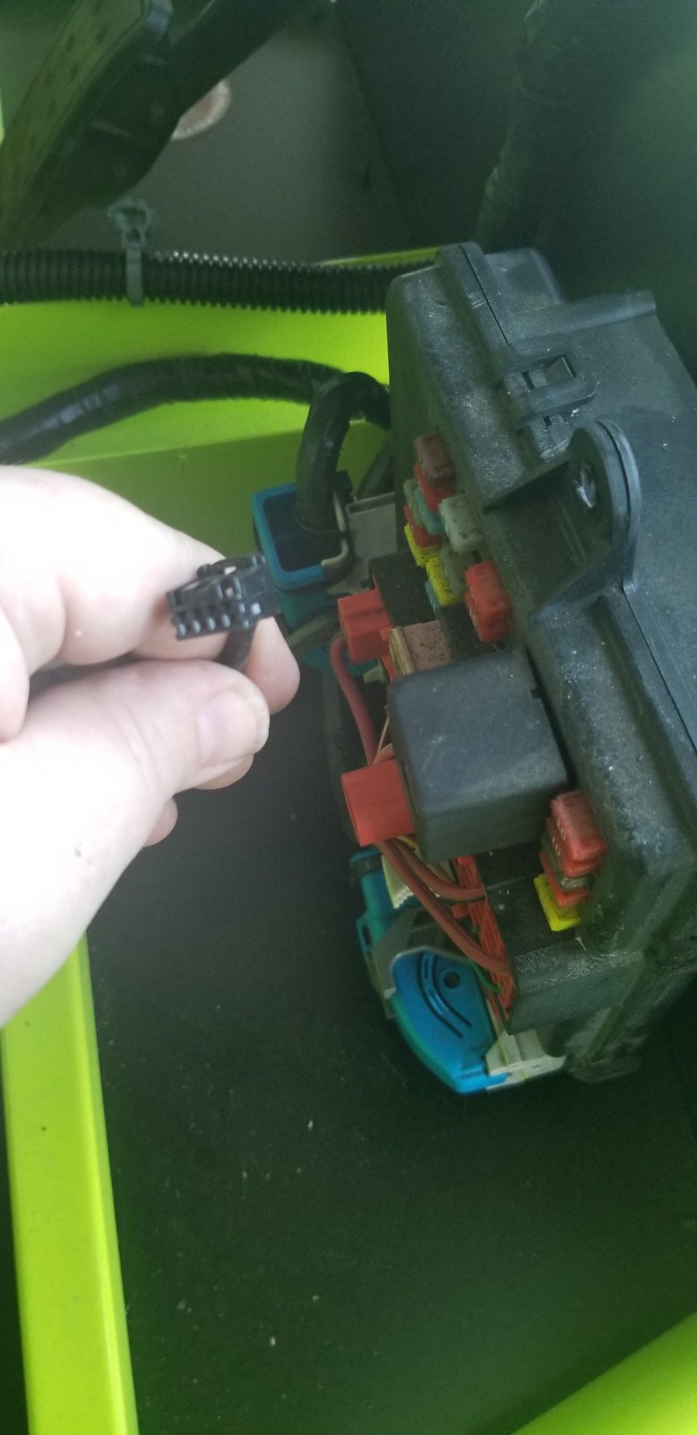

Any idea what this little guy goes to that is tied up with the BCM wiring?

I cut the bolt down, the nut still hits the frame.

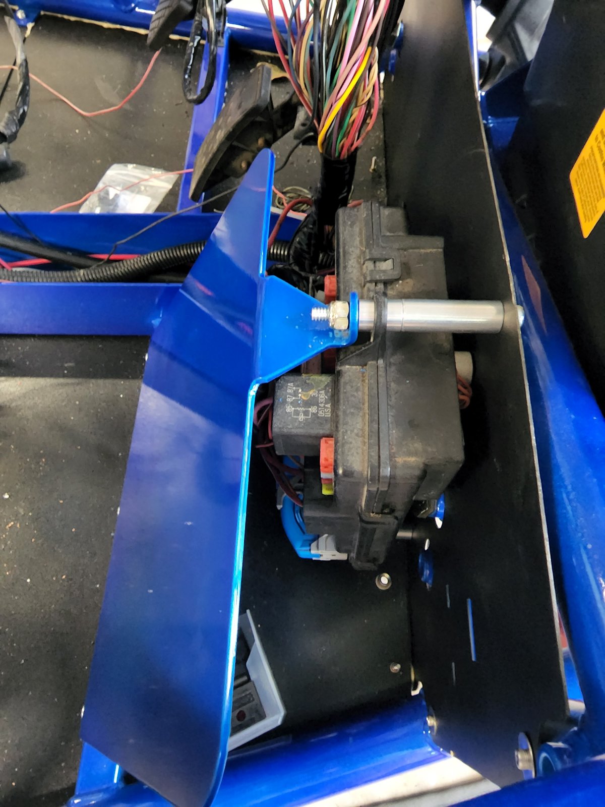

I did the sameI just did that step today. This is how I did it. Might not be correct, but seems to work.
Instead of using the small spacer I used a nut. Then when you take off the kick plate it just one nut to unbolt instead of a nut and allen wrench.I just did that step today. This is how I did it. Might not be correct, but seems to work.
I drilled the firewall hole a little bigger and reversed the bolt as the head is smaller diameter than the nut. add all the spacers like the other link shows.Any idea what this little guy goes to that is tied up with the BCM wiring?

What am I supposed to do with this?Hardware baggy says it had exactly what its supposed to have.
This little guy goes to a key fob and TPMS receiver. Ill have to double-side tape this guy somewhere local.
You have a turbo donor, what did you do with the check valve at the brake booster?You can skip the TPMS/keyfob box if you want. It's not mandatory.
