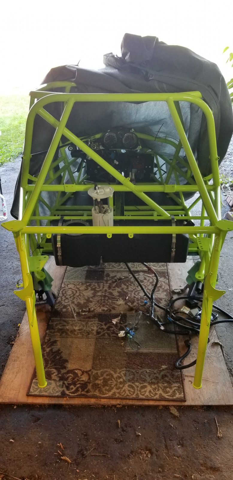

Got the tank installed today. Fuel neck cut down and bolted in. I noticed that the rubber fuel filler hose is quite large for the metal filler neck. I didnt get to close up the clamps as it was getting dark. It gets dark so quick lately and I know its only going to get worse. Still hoping to get the motor and trans bolted together and in the car in the next few weeks.

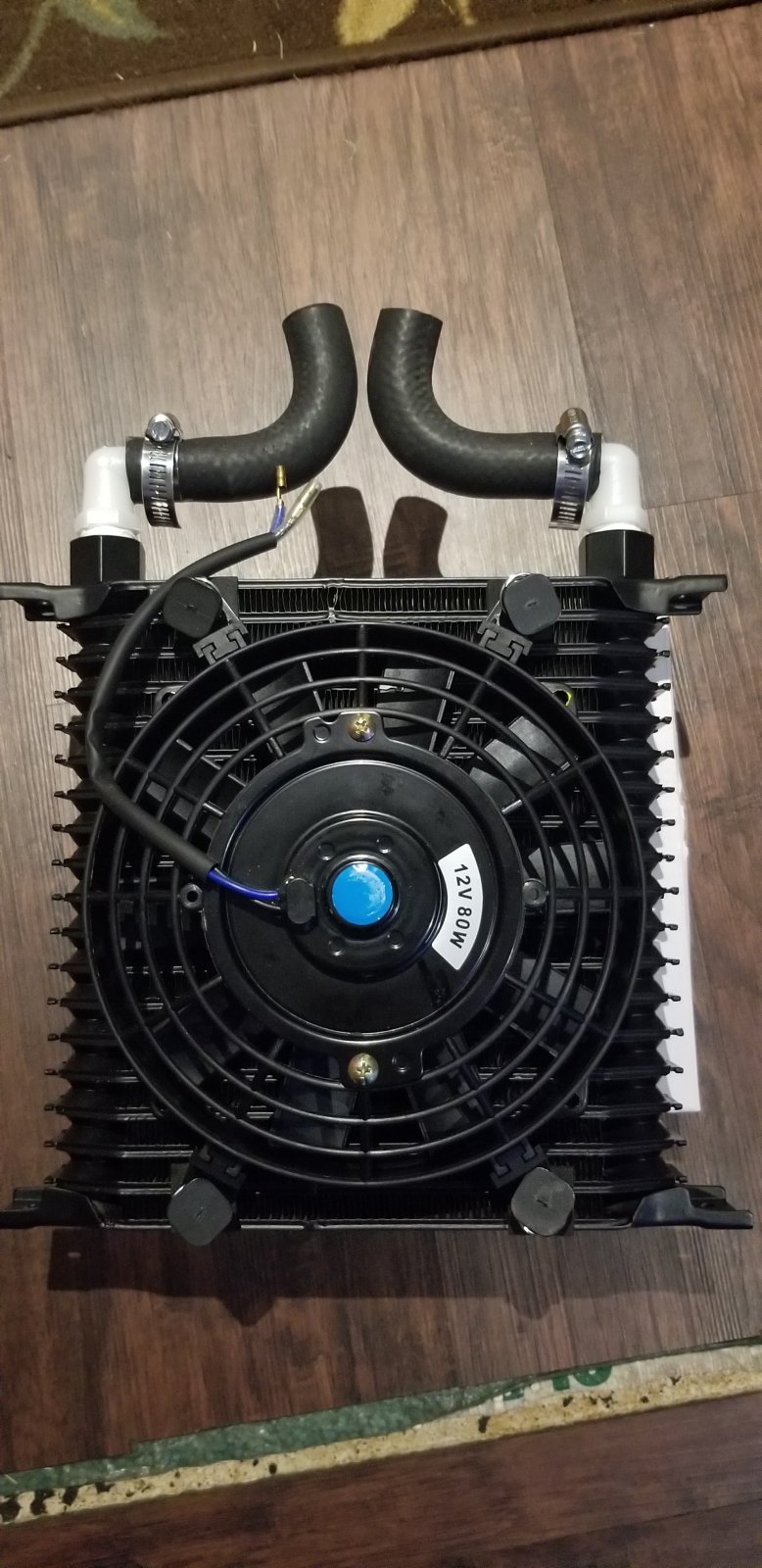

So Ive been having a hard time with what goes first, not in a build sense but in a logical sense and not wanting to do things twice or wanting to work in cramped areas if I can think and avoid it. So Ive been over in the SS/TC area gathering info to mount the heat exchanger and fan before I mount the main radiator/hoses.

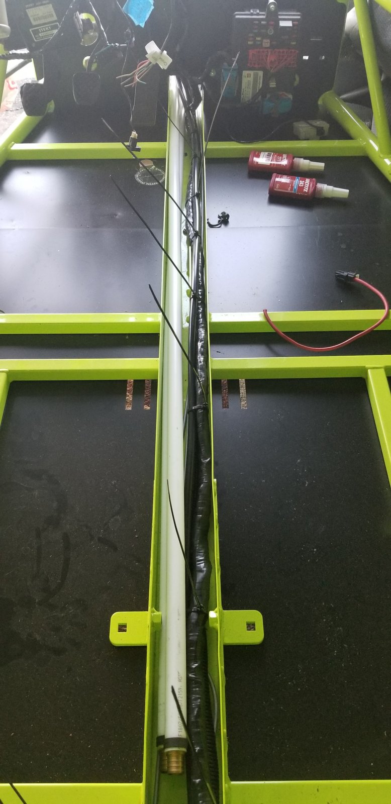

Doing this requires my tunnel to be in order and to dive into stage boxes that Im not necessarily ready for.
I've got all of my front end heat exchanger parts in order and will be installing over the next couple days. Heres so pics of my tunnel and where it sits atm. As you can see, its tight in there. The very front and very back are the most snug and Ive yet to fit the shifter cables in there.
