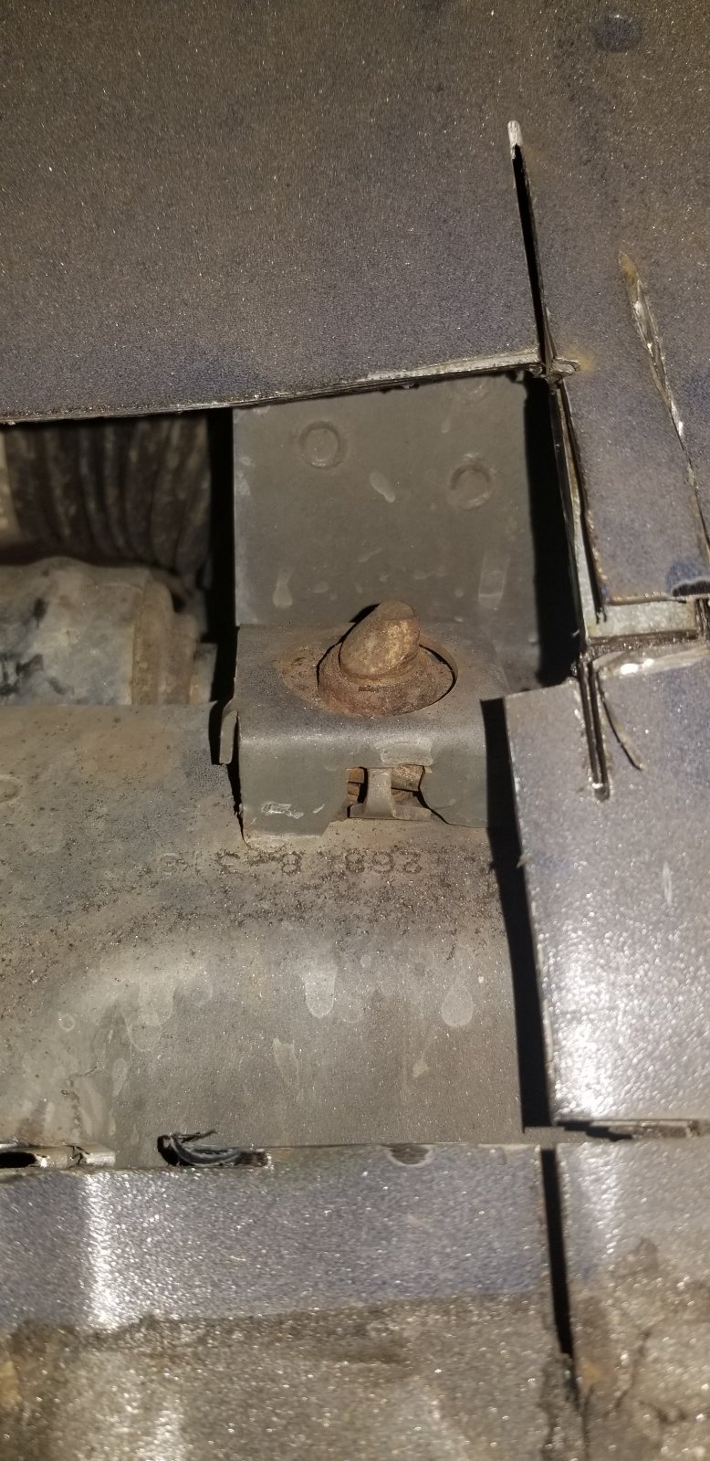

comegetjoe
Noooooooooooo!!! It happened to me!!!
The dreaded passenger floorboard subframe nut broke free and the bolt wont come out!
Ive seen it happen before but everything else has come off of this car so easily, i figured I was in the clear.
A minor setback really, but dang!
Other news, its a G85 car and I wont be using the F35, so that will recoupe some funds also.
Metal Mech
Is the bolt all the way down and won’t come free or started spinning as soon as it broke loose? Mine I had to wiggle the control arms around to get free.
Did you buy a F35 transmission extra to upgrade?
comegetjoe
Check the bolts they say...
Make sure its not already out they say...
Are you sure its stuck they say...
What an adventure. I just spent 6hrs cutting holes in the floor and chasing a "spun nut" in the passenger floor board of the subframe only to have a friend come over and work with me for 5minutes to tell me to tighten the bolt, I thought this odd, but complied. Wouldn't you know, the subframe tightened up against the body. No nut was spun, just a bolt that didnt fall when it was undone.
Im not mad. Ive spent time better, but Im not mad. :rolleyes:
