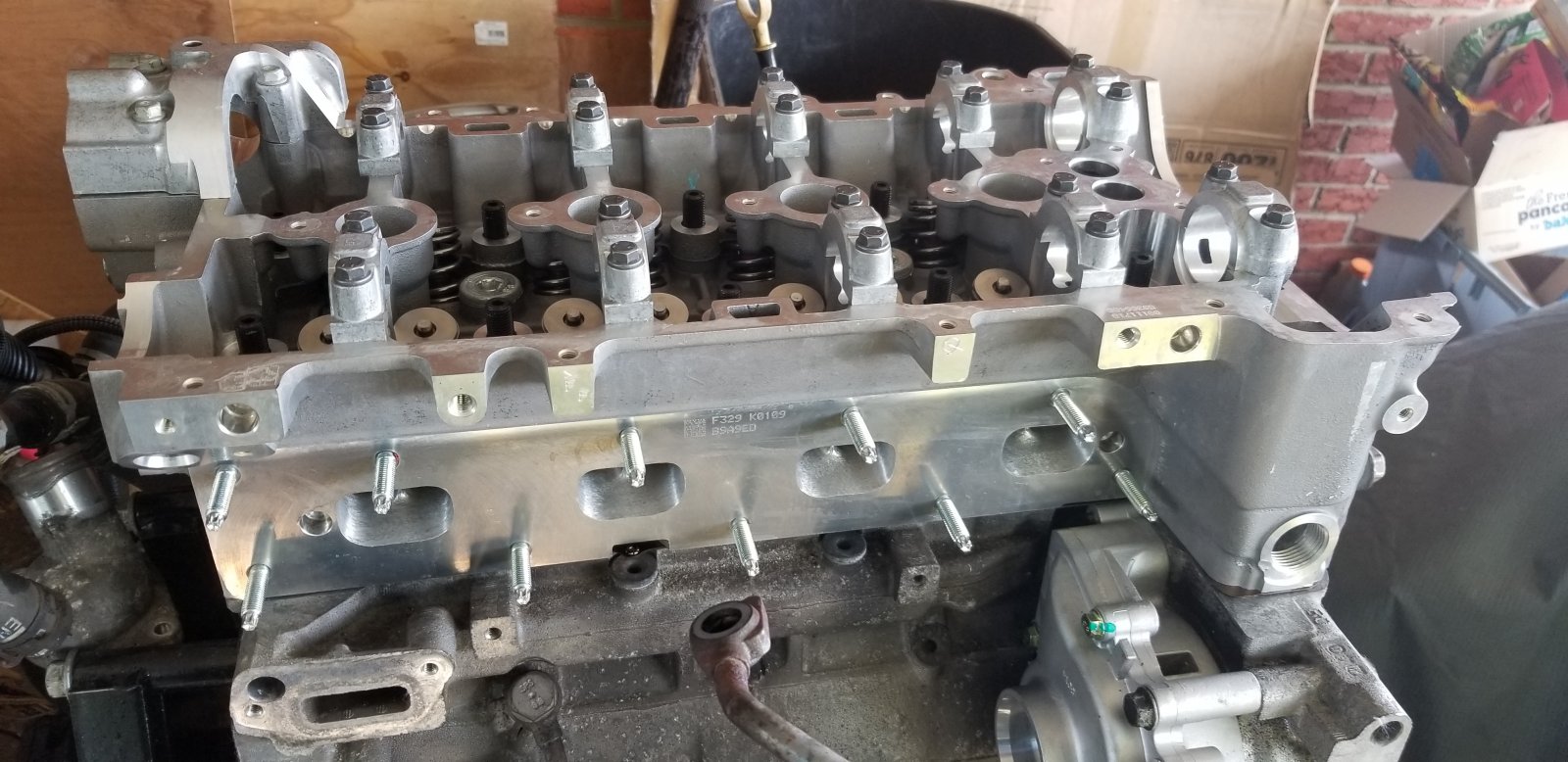

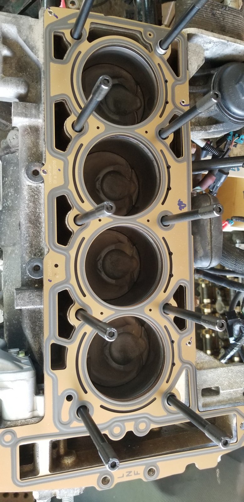

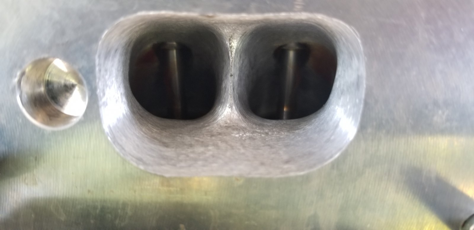

Not much motivation today, but I got out to the carport and pulled the head off of the motor, cleaned up all of the surfaces and gave everything a good cleaning in preperation for part install this coming weekend.
I like UPS, they get my parts here on time or earlier than expected. Fedex and USPS always leave me hanging and disappointed. Waiting on the water pump and balance chains to continue reassembly. I have to clean up that ding in the head previously mentioned, also.

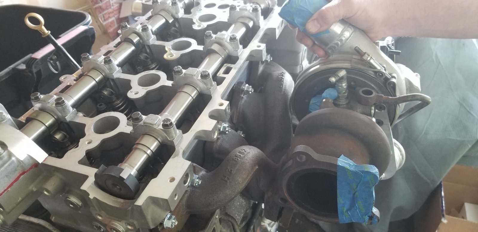

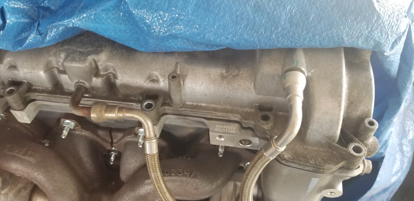

My only issue today is where the oil for the turbo mounts to the block sits behind the water pump feed tube, I have to figure out which tube (oil/coolant) goes where before i put that all back together. Its gonna be a good day :)

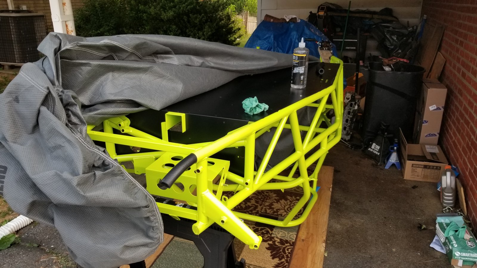

Installed floor pans.

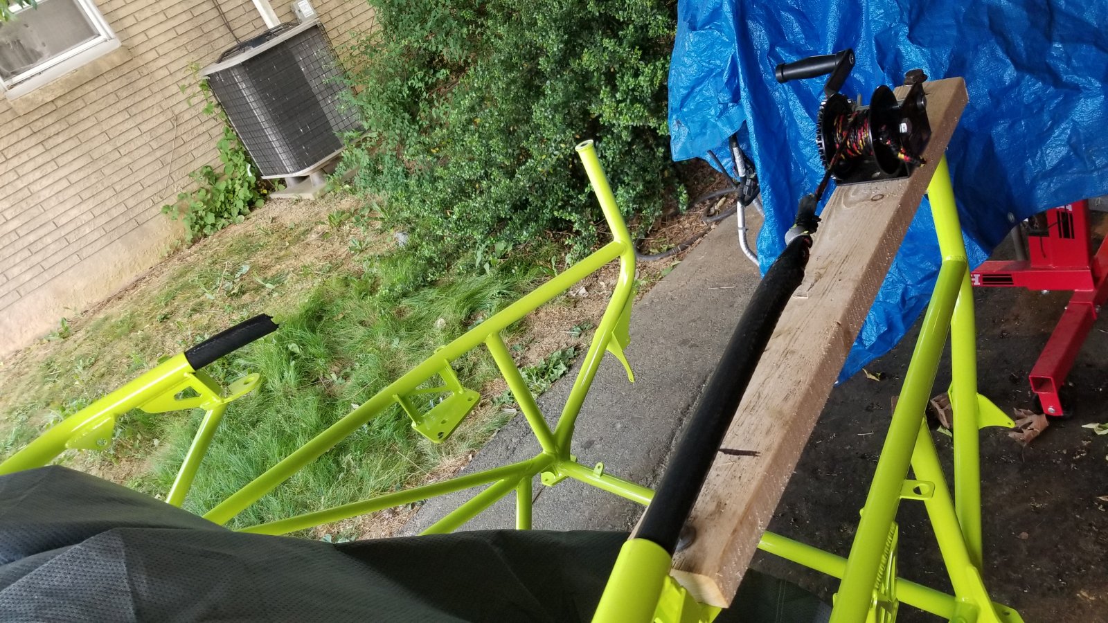

Pulled coolant hoses. I admit, I was super excited that I only had the hose break once, so on the second time I forgot to let the winch out before I cut the hose and now I only have 2.5" of hose on the rear driver side after it shrank. I think Ill be fine. Its still enough to connect a coupler to.
This is what happens when Im left to caffienate and work on car stuff.
It is. I think mine are about 3” long after trimming. All you ‘need’ is and inch, maybe inch and a half for half of the coupler to slide into.
Of course a little extra is always nice but work with what you have.

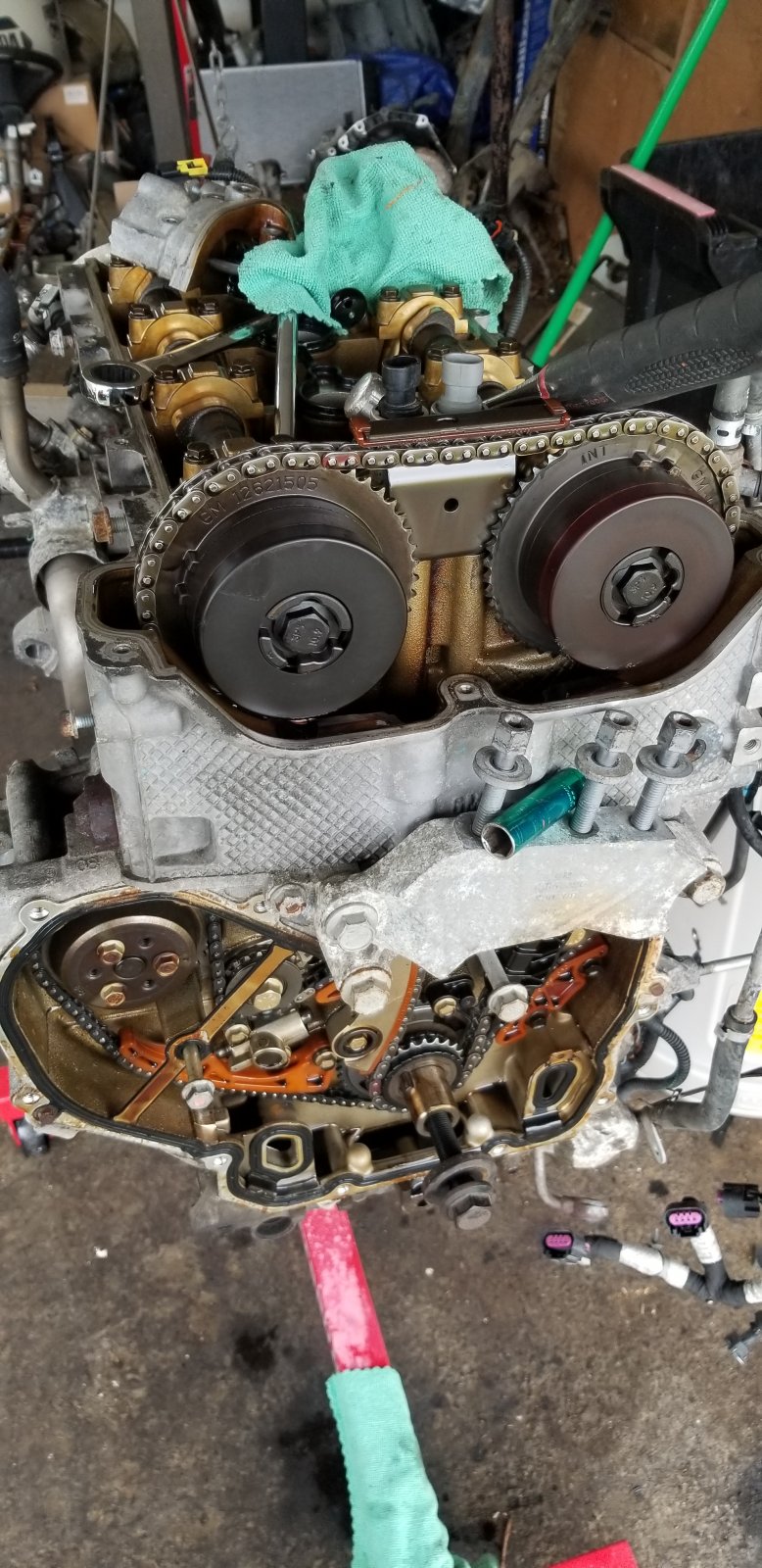

Cams installed.
Nuetral balance shafts installed.
Timing set installed.
Engine in time and buttoned up.
