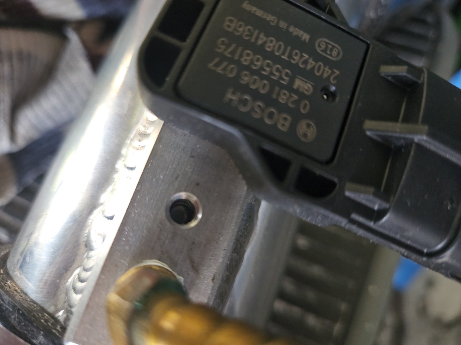

Its a MAP sensor.
Between the top mount intercooler and the throttle body. Its the second hole where a factory MAP sensor would bolt to.
I guess I’ve forgotten what sensors are on the LNF. It’s been 5 years and I really haven’t had to do anything on mine in that time beyond the ECM replacement. I forgot we had two pressure sensors.
I have a bolt in that hole. Don’t remember if it goes all of the way through. Either plug it or take a small piece of wire and see if it goes through.
But it probably isn’t big enough to bleed if a lot of boost but I’m just guessing.

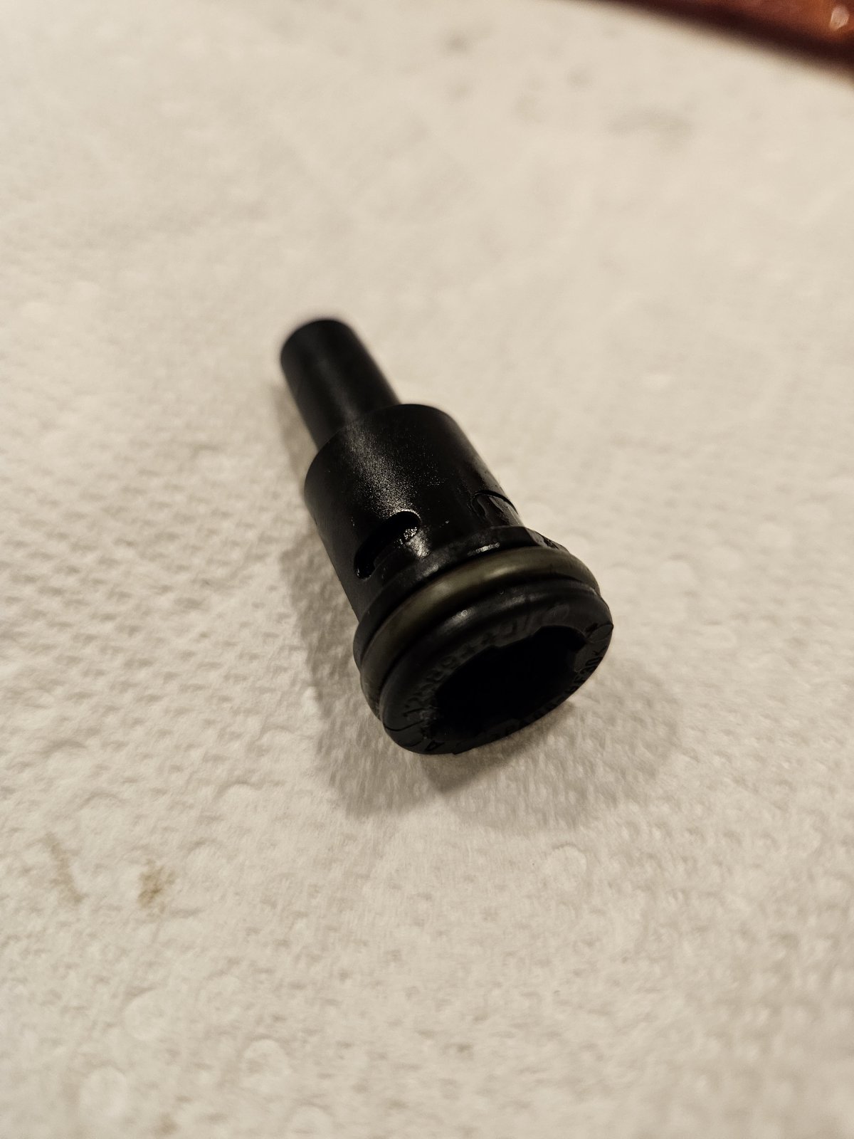

*edit - Yes. Old one blows air easily both directions, new one in the box is dead one way and open the other. Super stoked, this could be my boost leak.
PCV valve.
This is only supposed to blow air one direction?
That PCV is a low pressure valve. It may not seal tight when closed, but drastically reduce air movement in one direction.
I agree to see if it goes through or not. I disagree with the second, any hole is big enough to leak boost. Of course, a bigger hole is going to leak it faster but this hole looks big enough to bleed a good bit. This is all assuming it goes through completely.

No change in how it runs with the new PCV, that hole in the MAP sensor flange plugged. I made a trip with the MaF unplugged like its been and it ran better that the trip with it plugged in.
