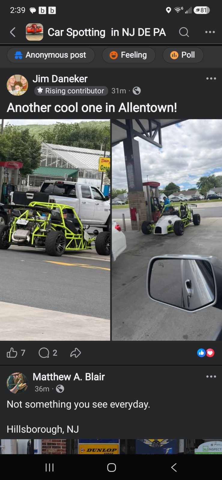

Today... I was caught in the tri-state area car spotting group...
