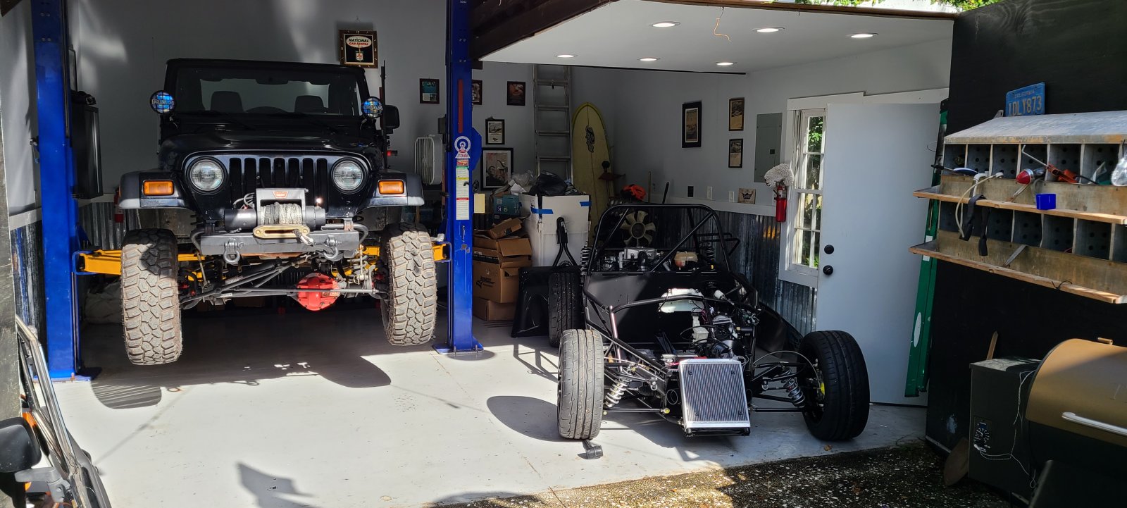

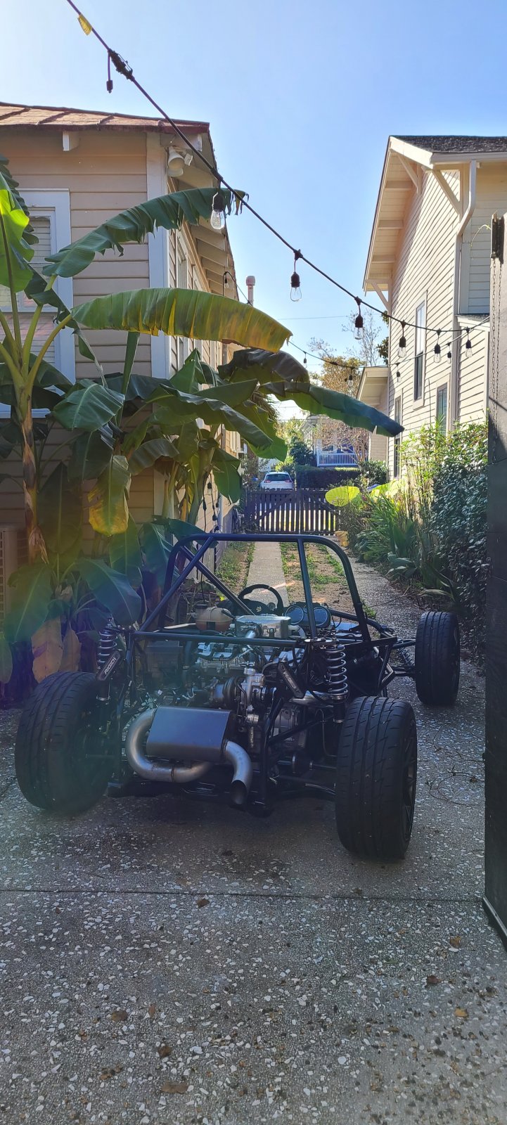

Big day!! Was able to roll the goblin out of the garage and actually get some work done on my jeep now that the lift is freed up!!

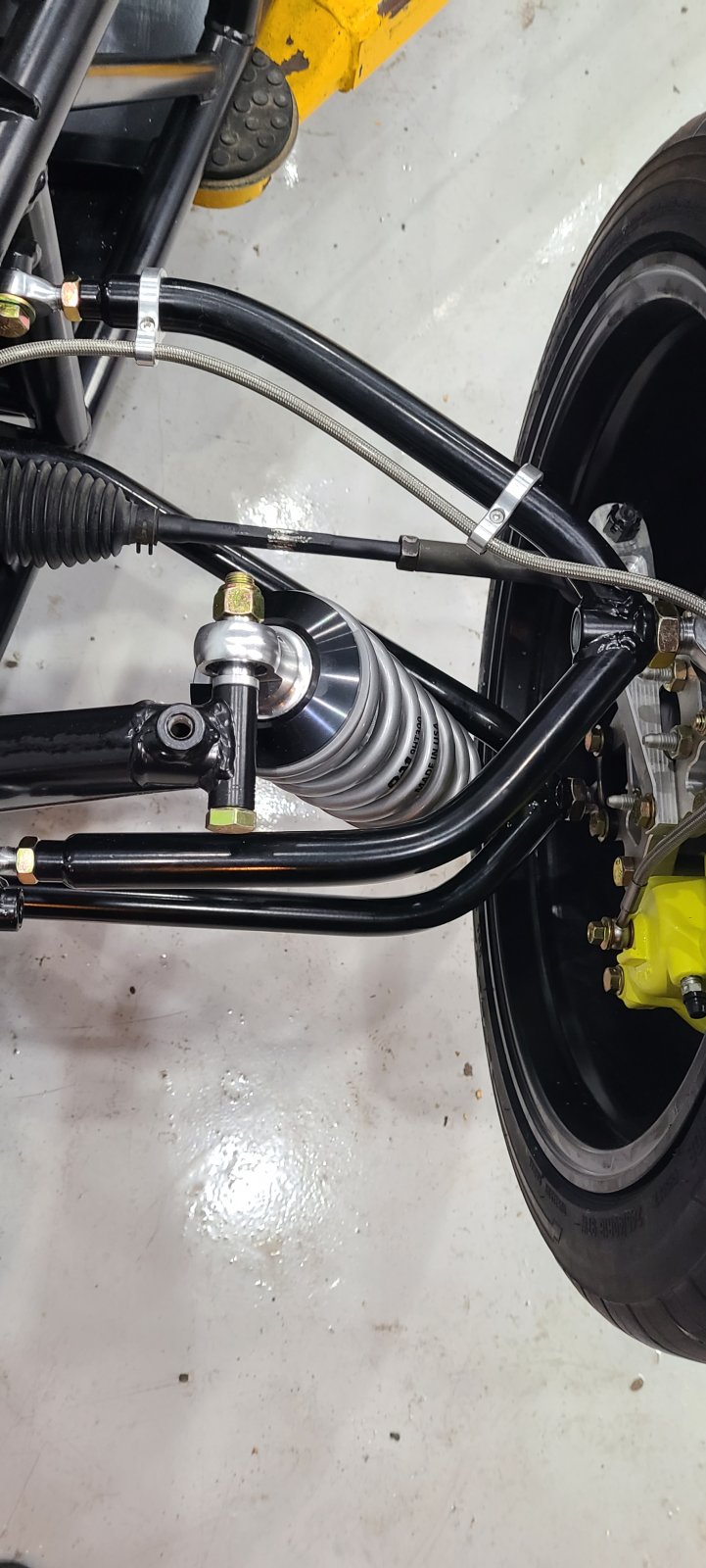

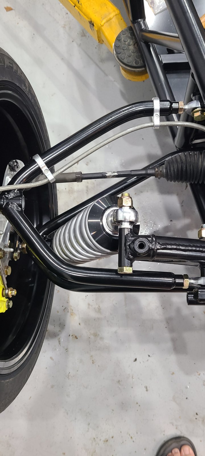

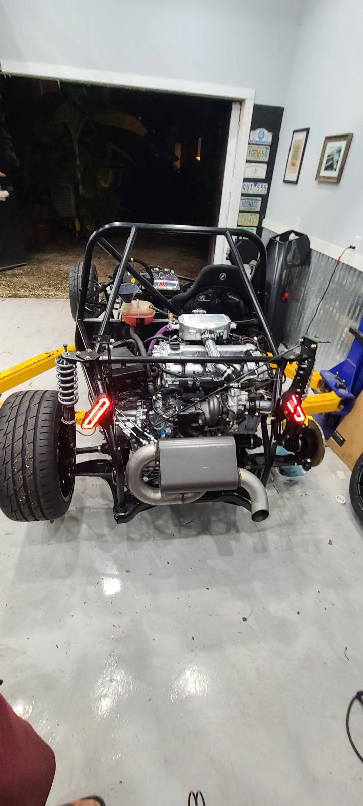

Bought these brake line mounts and love them!! They were a bit pricey but no drilling into my control arms so I was happy. Also got the brake lights and intercooler pump working.
