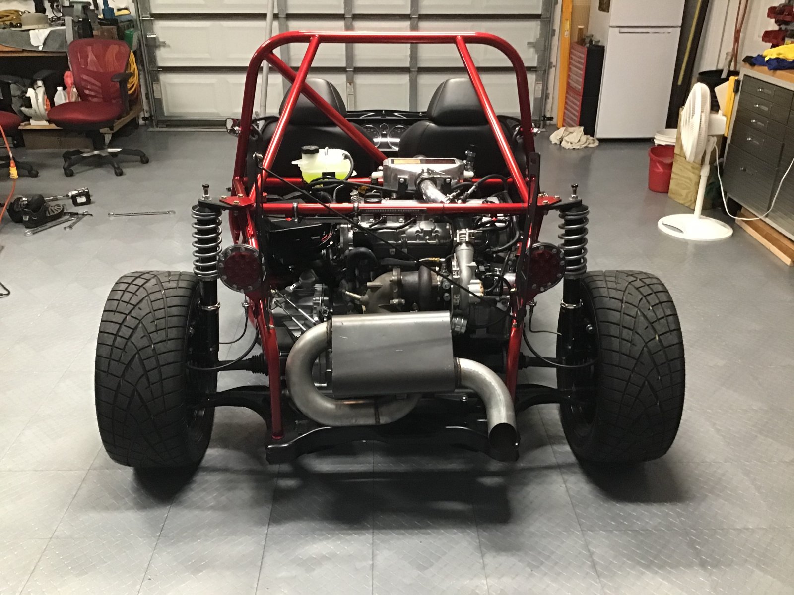

First off HUGE Thank you to Ark! Man those sub frame bolts were such a help! Second. Got the sub frame in "permanently" and torqued down. That front solid trans mount is a SOB! But with enough loosening of the engine and other mounting points we were able to get that to line up. Also swapped the fuel lines I had installed for the brake reservoir and replaced with the vacuum lines per everyone's recommendation. Car is really starting to take shape.

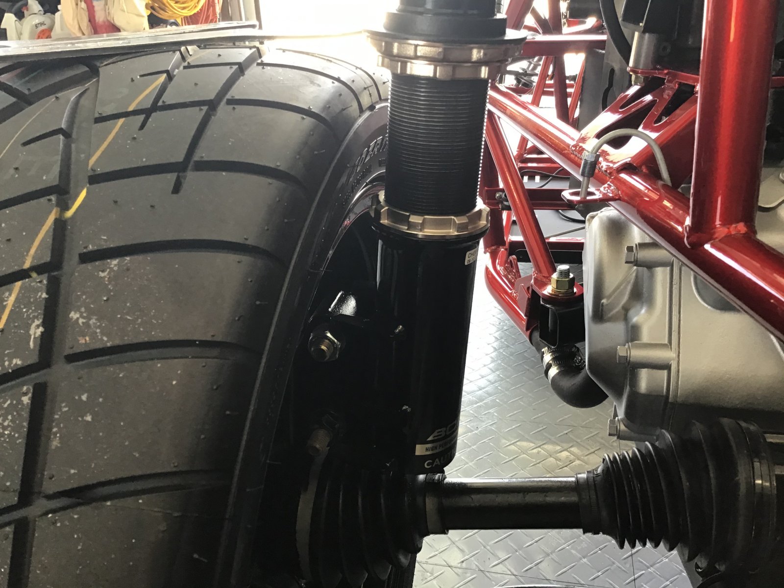

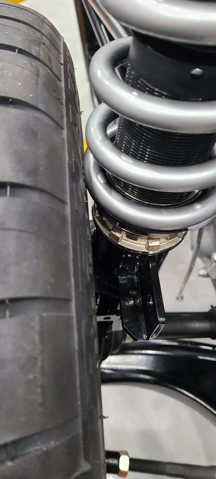

NOOOOOO. went to install my rims and the tire hits the rear spring.... I am hoping a set of wheel spacers will do the trick but CRAP haha
Zoom Zoom

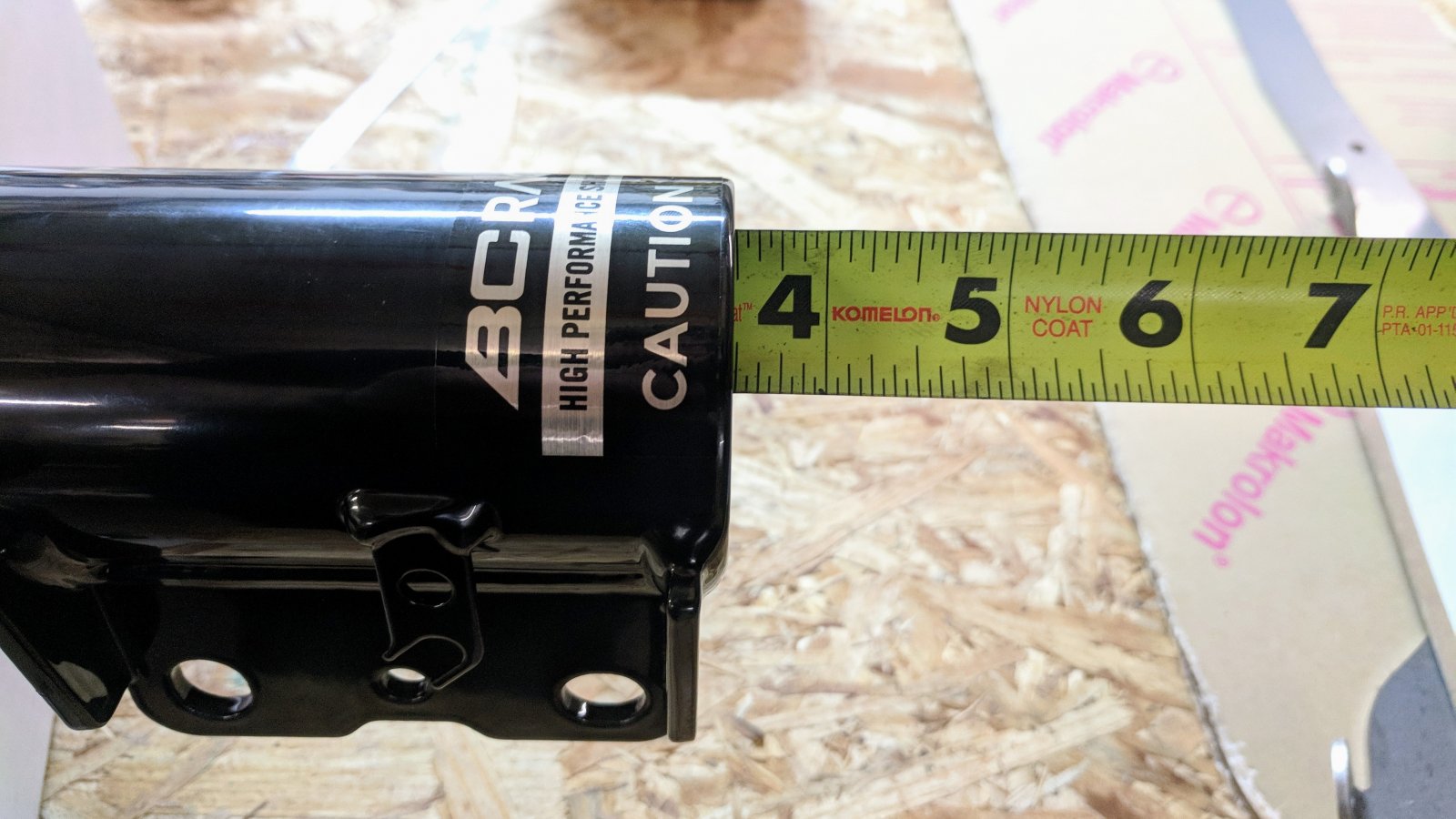

That shock screws into the bottom bracket, stick a measuring Tape up through the bottom and adjust until you have 3 1/2 “
mine was way off
had like 1”
