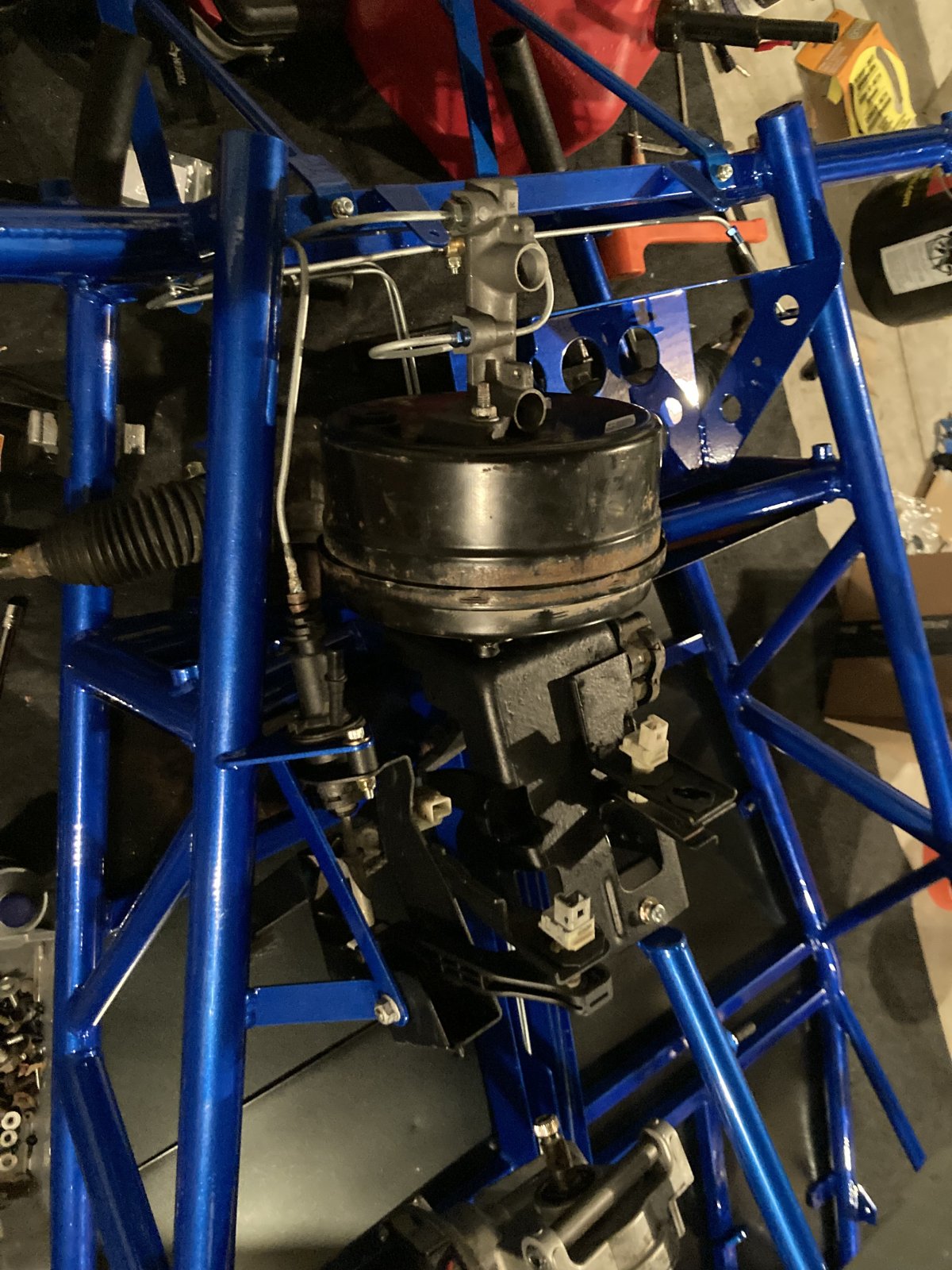

Clutch pedal installed. Brake booster installed. Lines ran into brake booster. Removed brake reservoir.
35865
I am missing the clip that attaches the brake pedal to the arm of the brake booster, anyone know where to find that?

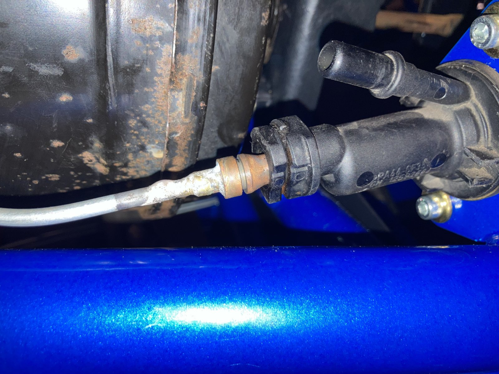

Got the clutch master cylinder installed:
35864
I seem to be missing the clip that attaches the clutch master cylinder line to the clutch master cylinder. Anyone know where to get one?

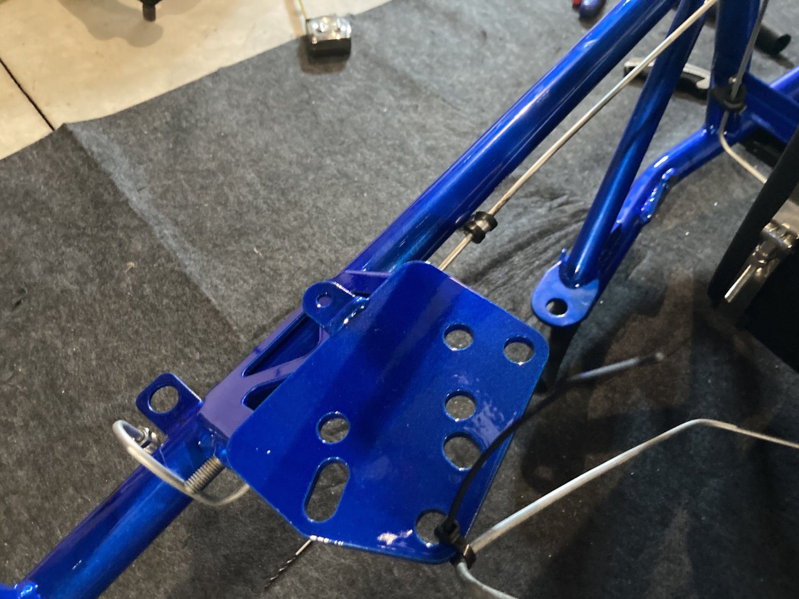

Test fitted the radiator mount and figured out that the bottom holes got powder coated so those will need to be tapped:

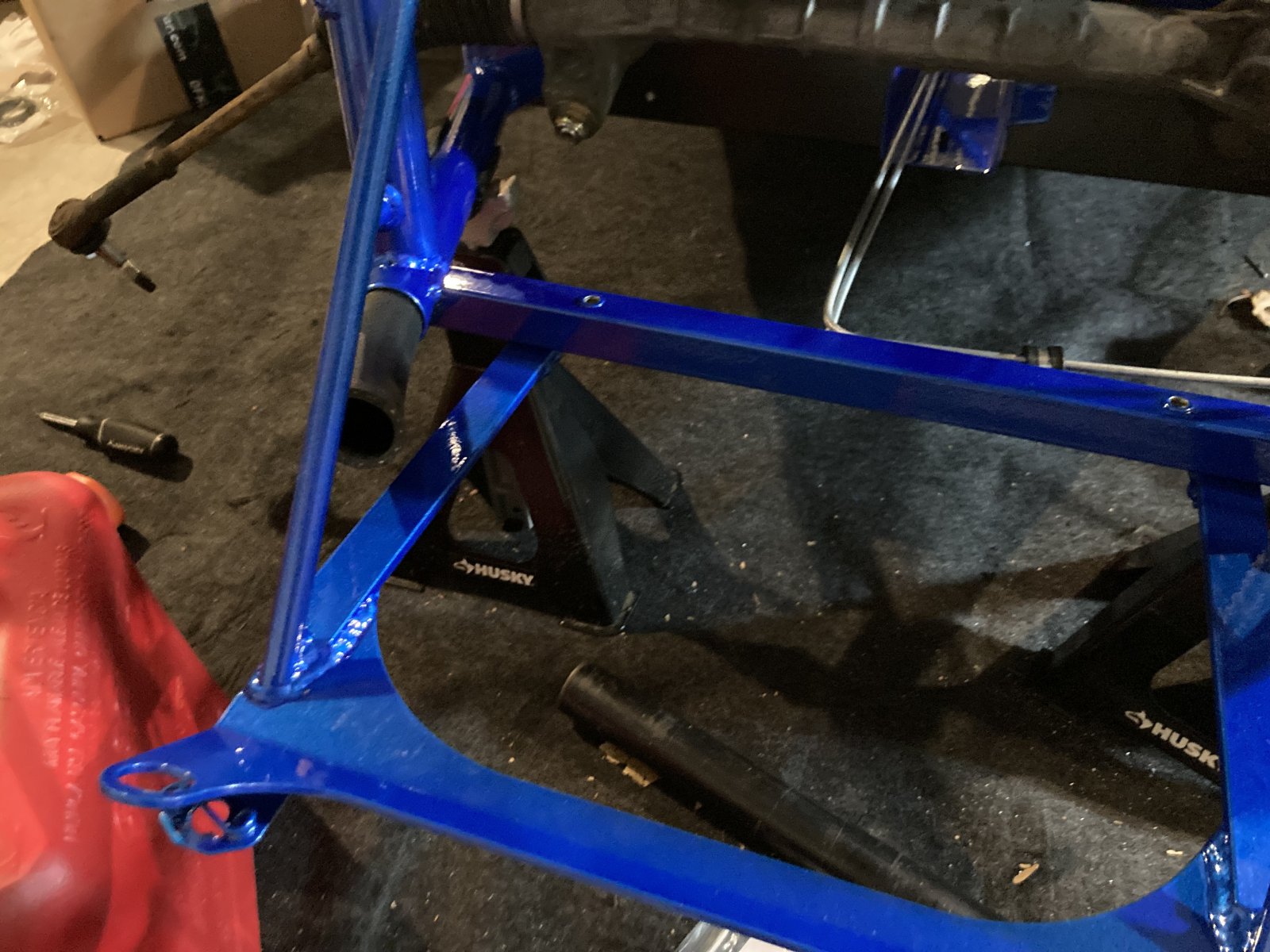

Secured the brake lines to the frame:

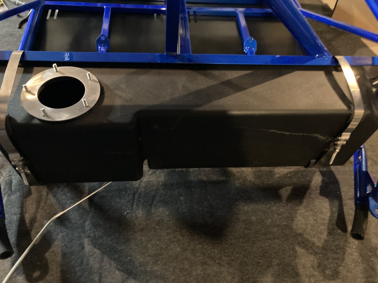

Got the fuel tank installed:

I think ZZP sells the little clips. I may have had 1 extra (somewhere) but ZZP will get them to you faster.
When you put the clips back in, remember that this is the orientation. The male end will not go into the female port with the clip wrong. I spent hours and many attempts trying to get the clutch to go in, 2 minutes with it in the right orientation.
