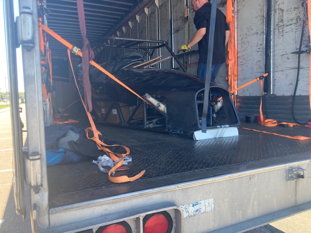

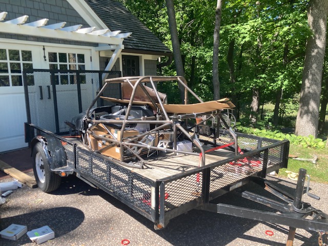

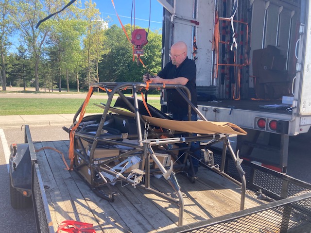

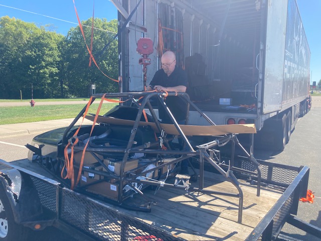

Got the kit delivered today! (with a minor (possibly major?) hiccup). I had Jeff from Stewart Transport drop it off in a parking lot and put it on my trailer and we drove it home:
35403
35404
35405
35406
35407
The hiccup we had was that while picking the kit up one of the straps snapped and the kit landed back down into the truck. Luckily it was probably only 1 to 2 feet high and we inspected for damage and didn't find any. My only worry would be that there are some very precise things that got thrown off slightly which might be an issue for us later. The kit was pretty nose heavy so it hit its nose first and then hit its rear. Really hoping this wont be an issue.
We are going to ensure the packing list is all correct tonight and hopefully drive it to Mankato tomorrow to be powder coated. They only do steel powder coating so we will have to find another place that does other things like the cast iron calipers and some of the aluminum parts like the wing.
The only things I can imagine that might've been damaged in a drop are fiberglass or sheet aluminum. Everything else from my kit was incredibly well packed. I wouldn't worry about it. Looks good!

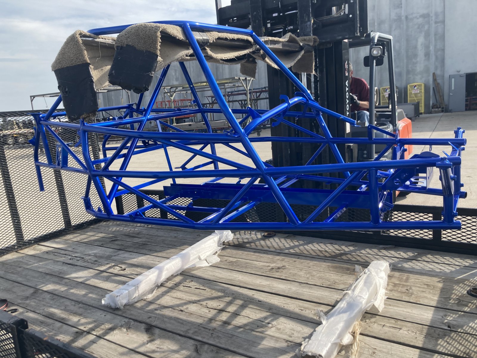

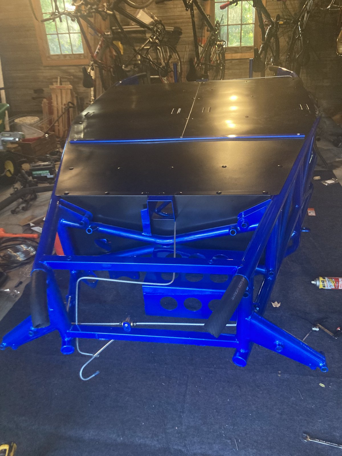

Frame got powder coated:
35795
I absolutely love the color, it actually looks that saturated in real life as well!

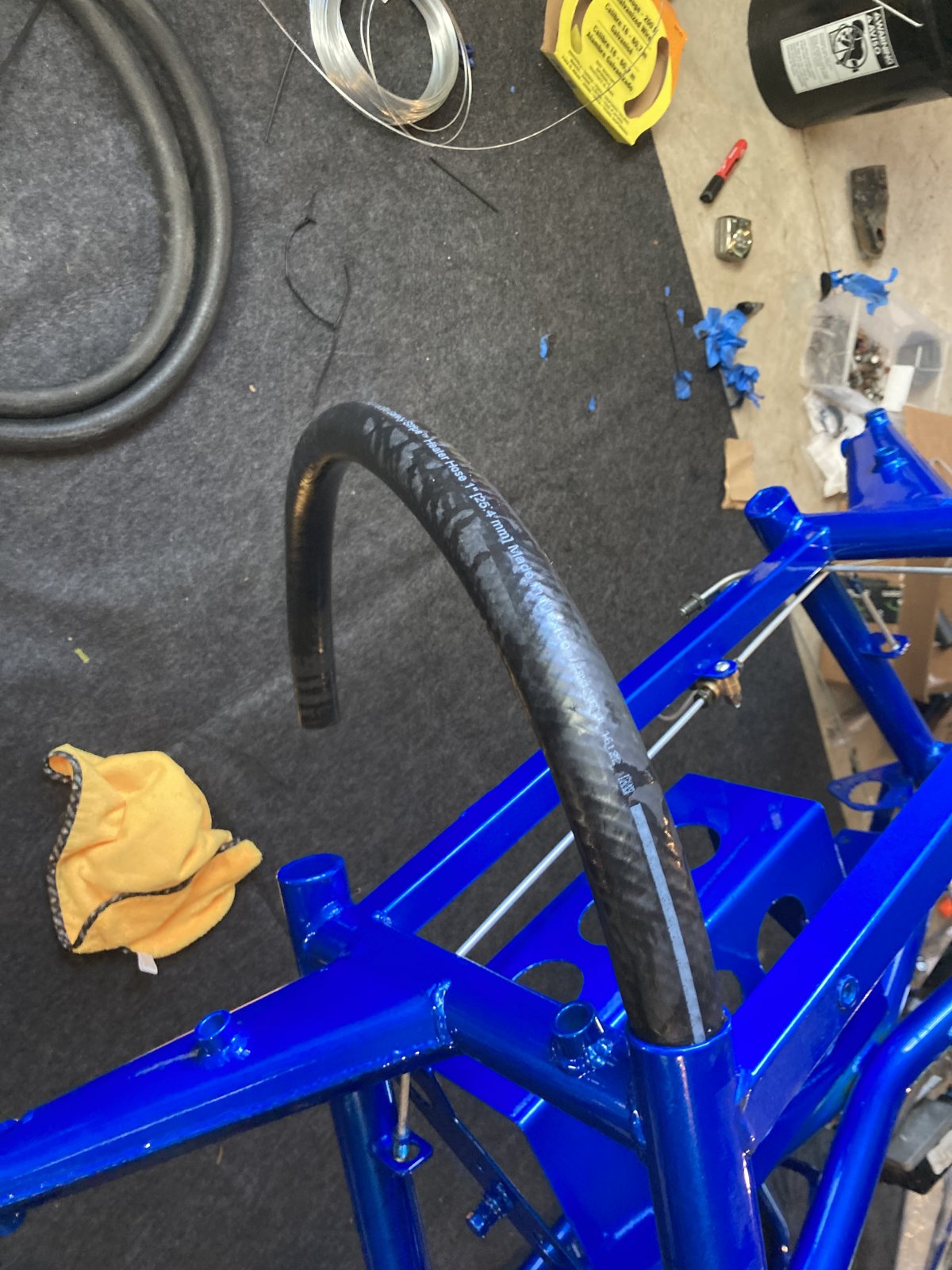

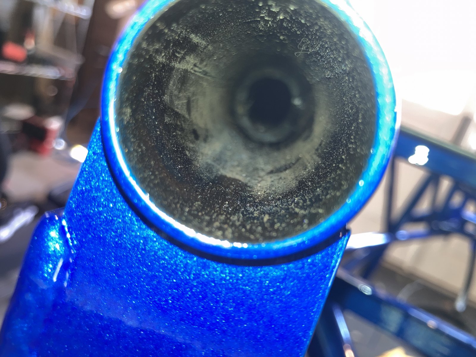

Once the frame was coated we couldn't do much because we were still waiting on the aluminum panels to be done but just yesterday those were completed. I spent today installing them and running the main coolant hoses through the frame! The aluminum panels werent too hard besides having the manually rivet which sucked but I got through it. Pulling the hose was an ordeal. The first hose I pulled snapped the actual hose so I had to yank it back out and re-attach it. The second hose stayed together but there was a lot more friction and the rope I was using snapped and almost hit my face, luckily I had thought about that and put my hand up and it hit my hand instead. It didn't hurt that bad but if it had hit my eye that would have been a bigger deal.

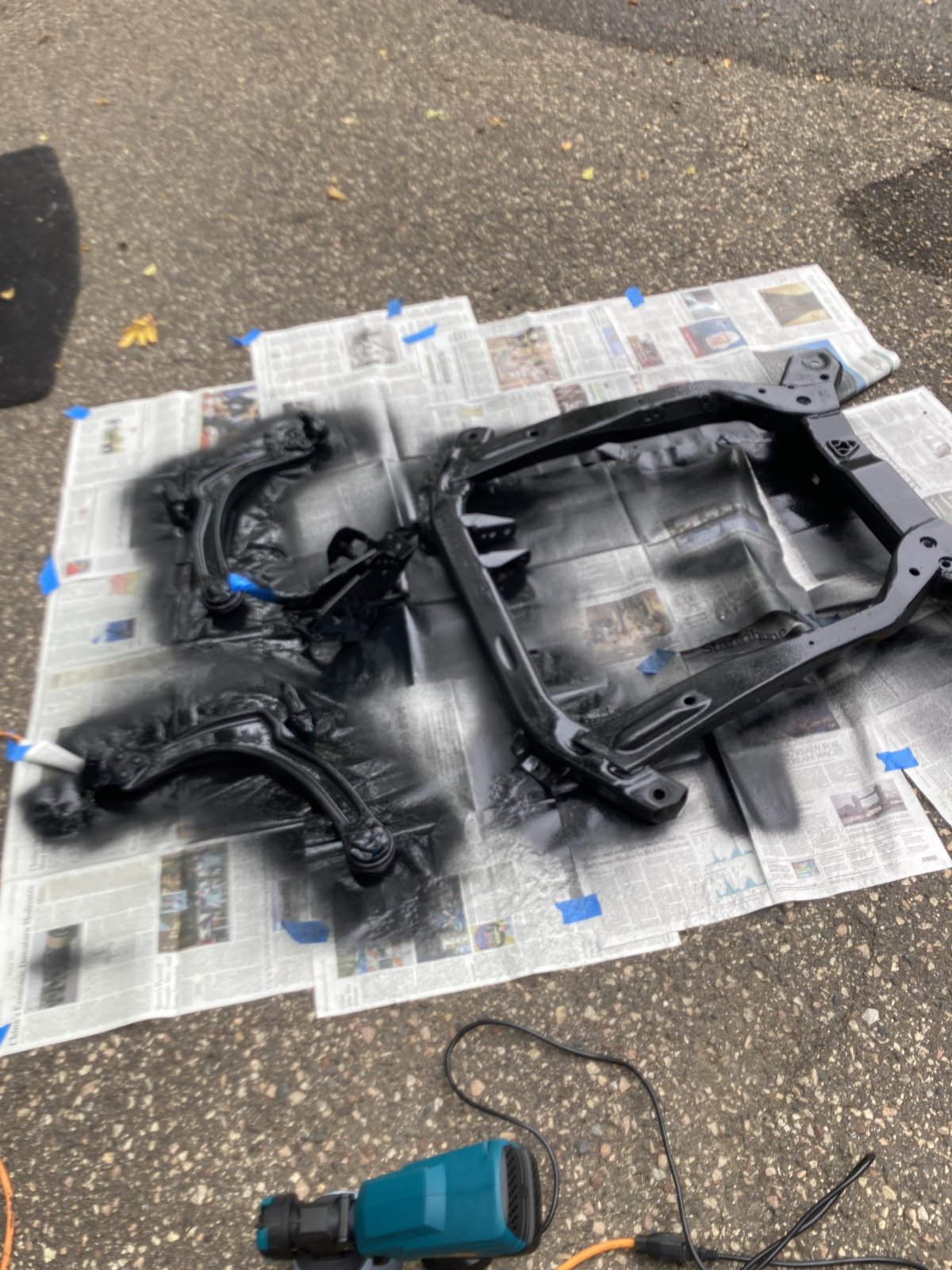

Painted the donor parts:
35796
I liked what Robinjo was doing in terms of tracking the days and hours of his build so I thought I would just post my hours in bold. So far 5 Hours of work have been done.
I like that color a lot. Nice choice.
On the hoses, are you using the crank winch that is mentioned? Once I got the right hoses, used a lot of silicone spray and warmed up the hoses in the sun they pulled easily. I did have trouble until that combination. The first set I pulled in the heat of July went soooo easily. Heat is key!
K
I did not have heat but I was using the exact pulling tool mentioned. All except for the specific rope they used. I guess heat is the trick, it was probably around 60 degrees when I pulled mine through.
After I let my replacement hoses warm up all day in the sun, they pulled much easier. I had a very hard time until I did that. I also sprayed silicone down the tubes from the rear, that helped some.
